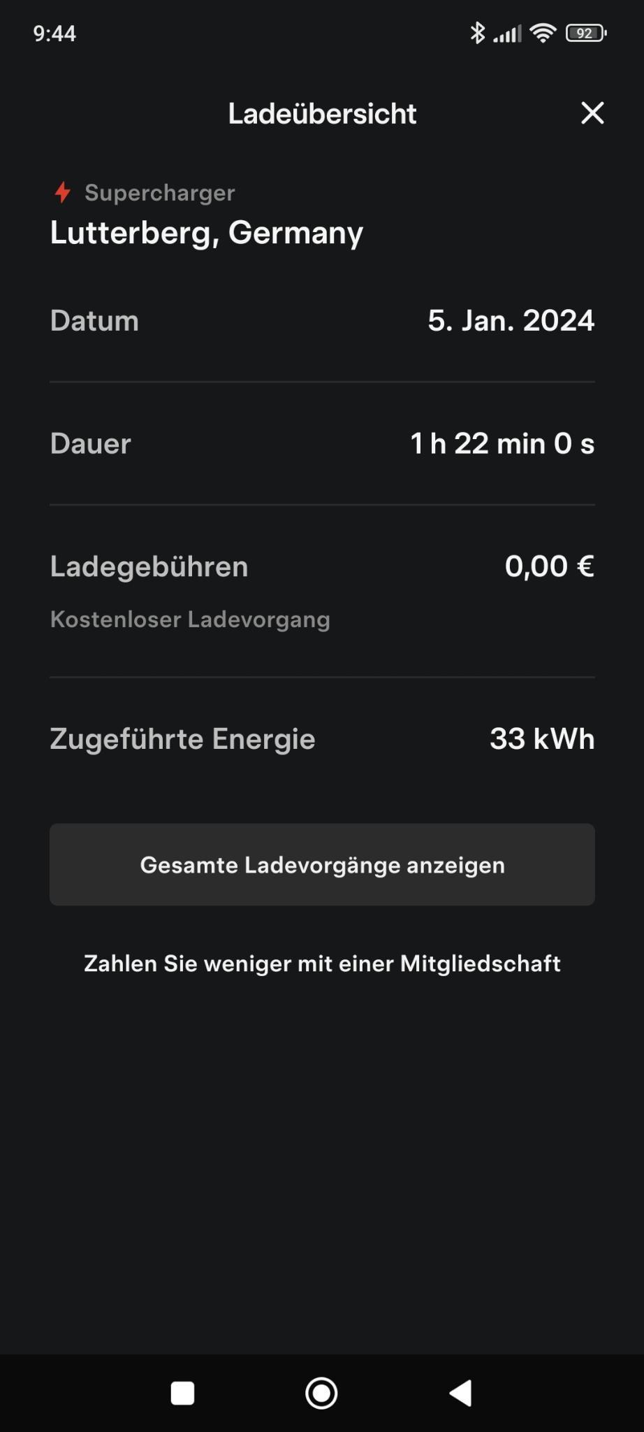

Thanks to our little project here I was able to snatch Elons free energy yesterday
Was in the process of doing a captest of the Nissan battery so that was very convenient

Re: Develop a QCA7000 board?
"Zahlen Sie weniger mit eine Mitgliedschaft"!?
do you get money back then?
No, you need to sign the membership before the charging, normally. But we have "Special days" until today: First charge of a new user is free.
