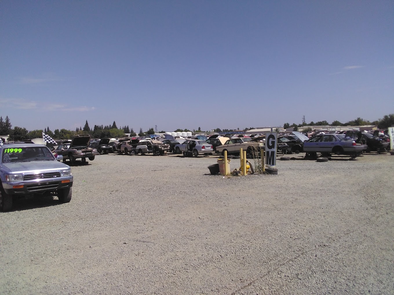

we send our Field Correspondent EV Greg to Rancho Cordova, California (conveniently located completely on the opposite side of town from me) to find out:
Fun Fact: PnP charges a $2.00 American dollar admission fee, and you must be at least 16 years of age to roam the yard.

this place is massive:

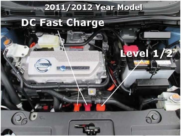

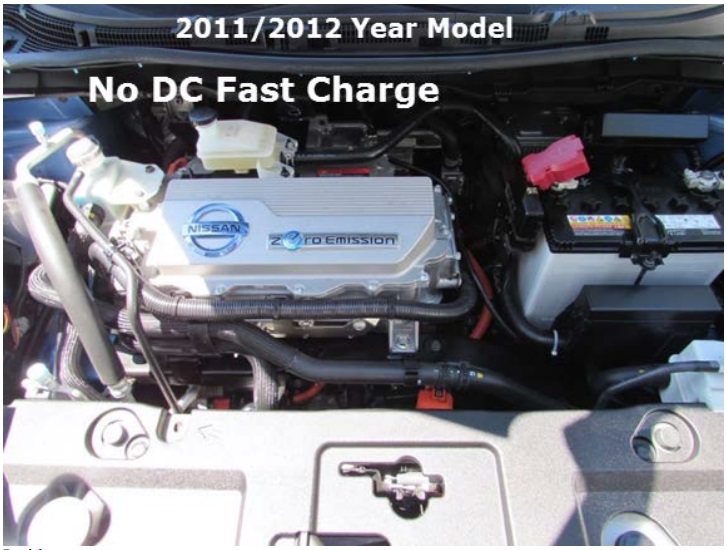

Alibro wrote: Sat Jan 06, 2024 10:56 am If you go for the parts from the 2011 Leaf, the motor and inverter are connected via a cable which makes it much easier to fit into a different car. The cable doesn't have much flex but enough to let you move things around a little. Also the ac charger (ac only) is in the boot so the stack is that much smaller anyway. I've heard the Gen1 motor can handle over 300kW but don't quote me on that.
I believe the Zombieverter can drive it but you would need to confirm that. I'm using a much earlier version that Damien built specifically for the Gen1 Leaf.
You would need to source a different charger and dc to dc converter. The dc to dc in the Gen1 Leaf is huge although I believe some folk have cut them down to make them more managable but the ac charger is unreliable and I don't know of anyone getting it working.
Oh and $475 would be very cheap here in the UK
I can't thank you enuff for this feedback, you literally read my mind and answered all my questions and more. Not being able to use 100% Leaf components from this generation makes me want to look at other options now.

Gregski wrote: Sat Jan 06, 2024 4:01 pm I can't thank you enuff for this feedback, you literally read my mind and answered all my questions and more. Not being able to use 100% Leaf components from this generation makes me want to look at other options now.
You're welcome. ;)
If you take a look at Fiachra Cooks and my older videos you'll see what I mean. We are both using the same Gen1 Leaf inverter and motor.
If the Gen2 stack fits your car then I think the Zombieverter controls pretty much the whole setup but don't quote me on that.
