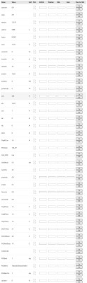

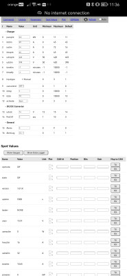

I test bench a PCS with Damiens controller, all I could get to work is the dcdc, charging over 14v (tryed to set at 13v but still charges at 14v). Anyway, the charger is in iddle, or off state, with 12v on input1, grounded chasis, all wires double checked.
Oh, and no input type setting, just manual.
I am using a granny cable/charger wich does nothing when I connect it. No errors, just does not trigger to start charging.
Have I done something wrong?
What should I check next?
I have some screenshots:

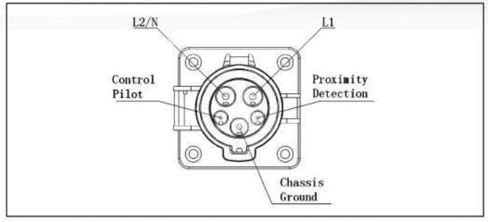

Yeah, the bottom pin of the J1772 port, labeled chassis ground in this image, should connect to the case of the charger and to the chassis of the car.

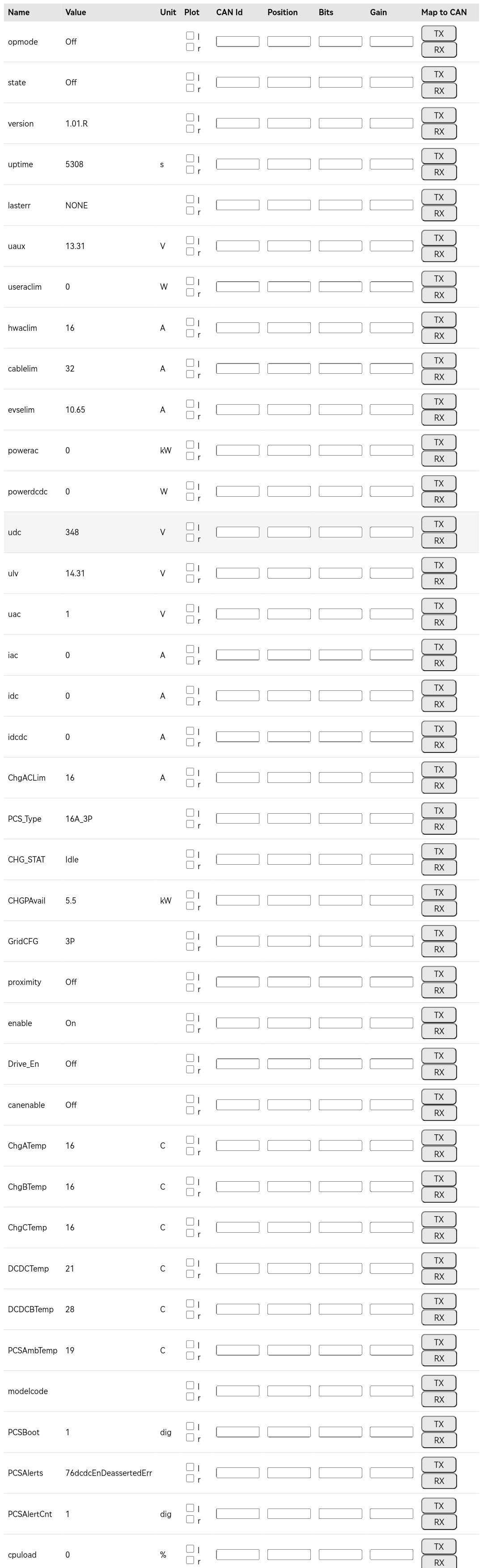

Here's something else to check - in the webinterface, is it showing the correct AC voltage present?

I'm in Europe, I have type2 but that PE would be the ground you are talking.
As for the voltage value, it s not present, but I first tested with no Control Pilot and Proximity pilot, just plugged the N and L1 to wall socket and it read 230v, and experienced the same Off state

When the granny cable is plugged in, are you saying the CP and PP don't change anything in the spot values (proximity never changes to 'On'?). Did you try other cables to rule out a bad cable?

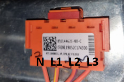

if its a 3-P PCS, are you wiring to the wiki image: I'm wondering if that labeling is correct, I need to check something tomorrow
