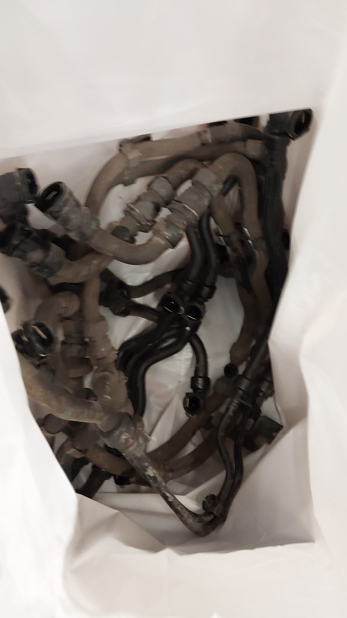

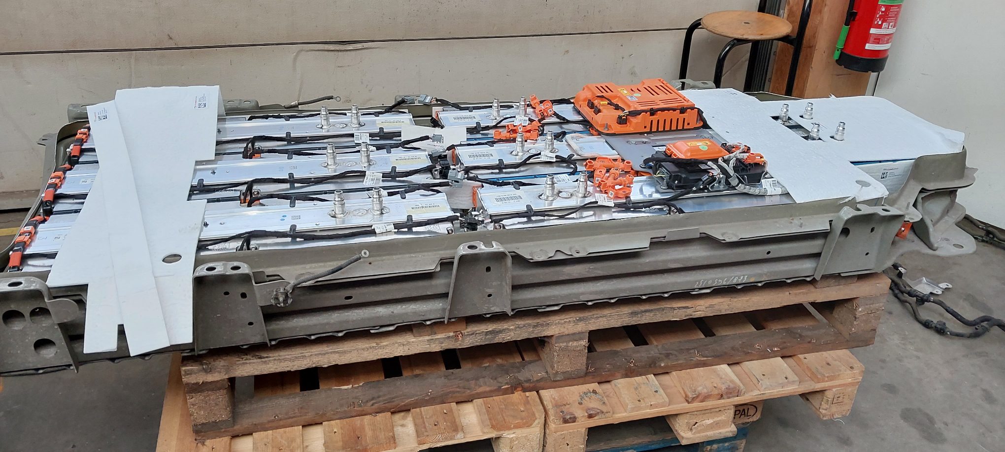

So I opened the pack...
CATL modules and BMS
seems like every other module has a CMU that also reads the next module
nice watercooled blocks with 4 modules (plus one with 2 and one with 1 module)
4s / 2.73 kWh / module

More!!

Re: Opel Vivaro-E 75 kWh battery (PSA)
Those are are really good looking modules. All that lovely aluminum, hardly any plastic in sight.
