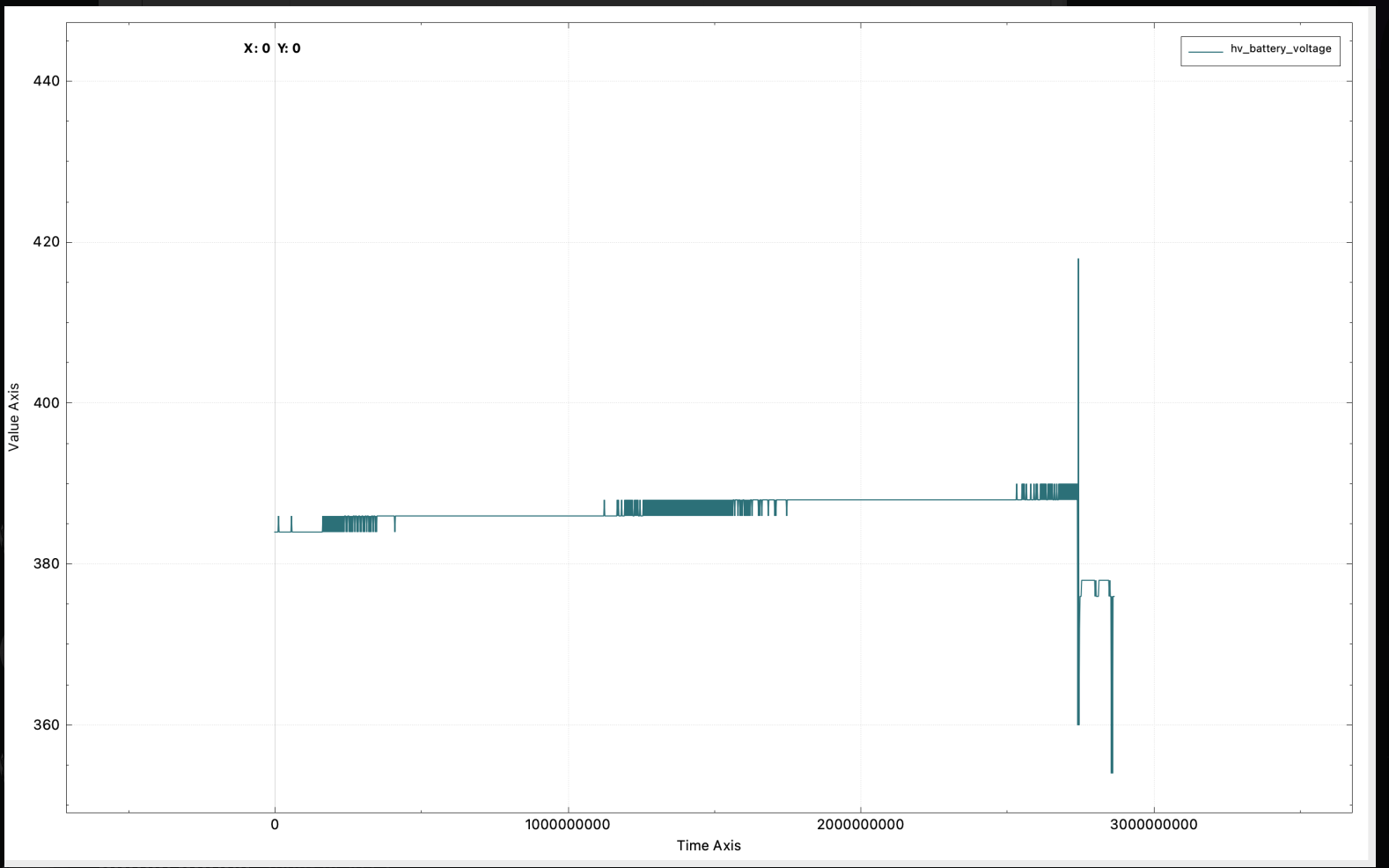

The plot thickens!
First I want to thank you guys for your help and support with this but I think the charger is OK and not the problem.
Today I started a charge and a CAN Dump with SavvyCan, around 20 minutes later I climbed into the car and tried something which caused the car to cut out a couple of days ago while driving. I turned on the headlights.
Immediately I heard what sounded like the clunk of a contactor and the charge stopped, the coolant pump briefly changed tone but then went back to normal, I didn't see the change in low voltage but if a contactor was turned off briefly then this makes sense .
I tried turning the headlights off and on again to see what would happen but nothing so this is intermittent.
I have attached the CAN Dump anyway but I think I'm looking for a stray voltage, a poor ground or a bad connection.
I feel a redesign of my LV connection box coming on as the current tangled mass of wires makes diagnosing faults extremely difficult.

Re: Mitsubishi outlander charger and DC:DC
Contactors are opening
You can see the voltage suddenly jumps to the max, the charger errors out.
Your DCDC seems to be fine, you clearly have some very dodgy wiring/12V power faults.
Yes, agree 100% with you guys, thanks for showing what is happening.

Talking about cutting out I discovered something big today.
I wanted to see which contactor was dropping when I turned on the lights, and today it happened every time whether I was charging or not.
I only needed to wait for a few minutes after turning the car on if I turned on the lights it happened.
So I put a meter across the neg contactor and a second across the pos then turned on the lights and discovered it is the pos contactor dropping. The thing is it's not coming back on as I thought. This confused me for a bit as the dc to dc was still operating and I still had 14V which was why I presumed it was bouncing off and on.
Turns out the precharge relay is still active and was keeping HV to the dc/dc through the precharge resistor and a very light cable.
I think that's another thing to change.
I was about to say
"It looks like the issue is a faulty contactor."
I put a meter across the 12V supply for the positive contactor and when I turn on the headlights the contactor opens and stays open even though the 12V to it doesn't change."
However it wasn't quite as simple as this.
I used a different multimeter to watch the voltage and noticed it flicker a tiny bit so decided to try changing the supply source for the contactor from the ignition switch to direct to the battery and this helped to the point where I thought I had it sorted. I was about to put the lids back on when I did one last flash of the headlights and it failed again.
So after this I tried flashing the lights with the contactor already stuck open and noticed a faint sound of a relay clicking so I new something else was going on.
I got my daughter to mess with the lights while I watched what was happening and It turned out that the timer module I am using to drive the positive contactor (from the switched neg supplied by the VCU) didn't like the fact I had several other devices using it's positive wire and when I flashed the lights the relay was sometimes flicking off. The thing is it was so briefly it caused the contactor to open and lock open.
So after more time running individual wires to the various devices involved I tested it again and couldn't get it to fail. I'll try again tomorrow but hopefully the issue is resolved but even better it may have resolved my cutting out problem while driving.
Once again a huge thank you for the help in tracking down this issue. I don't know for sure if it is resolved yet but at least I think I know where the problem is.

On the subject of Outlander chargers I called into a Tesco carpark last night and plugged in. After around 20 minutes I had added 1kW to my battery pack so it seems to be working.
The only thing I changed from the previous failed attempt was reinstating the 220R resistor between PP and ground however I was at a different model of Pod Point so I still need to try again at the charger that failed last time. I will do that some time this week to confirm if other Pod Point chargers are happy with the CAN messages my Due is sending.
