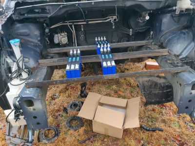

I just got the new batteries. unfortunately I had to go with Lithium batteries because they are lighter and can do 3C discharge rate.
I also ordered from China some fiberglass separators between the batteries.
They wil be
mounted in the front. Engine + transmision was 240Kg and 41kw of batteries are 258Kg.
on top of that the exhaust pipe with cathalitic converter are about 25kg, and the Gas tank 16 Galons is about 50Kg.
overall the car will be lighther with this batterie. the other option was the 140Ah batteries but they were 192kG.

This is 6.8Kw, 16S pack. I will have 6 of these.

This is 2 rows with 32 batteries each. I have to add another row on top to have 96 batteries.

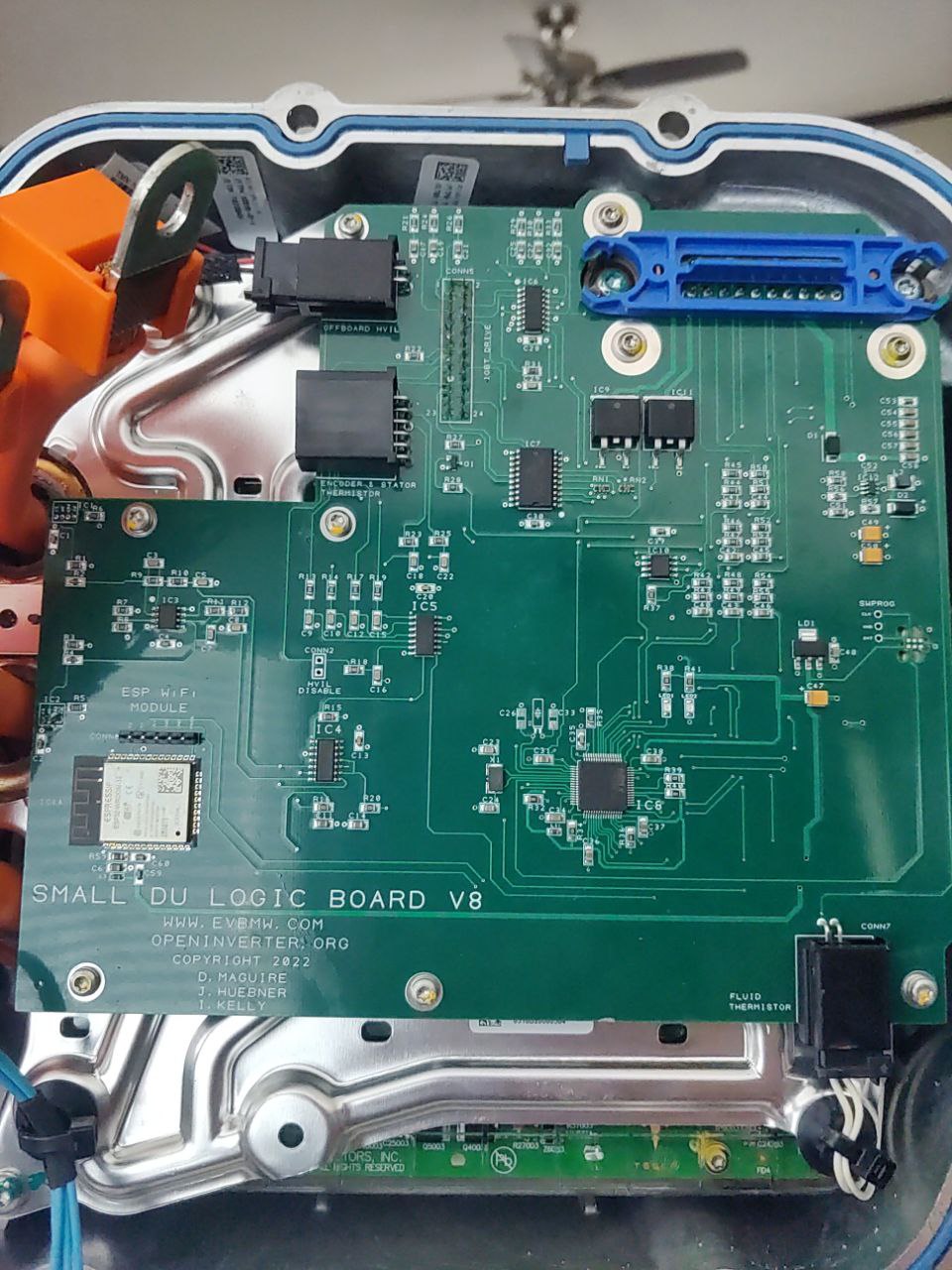

Conversion is complete but does not work because connected the 12v battery in reverse which caused some fuses to blow up but also I am guessing damaged the board and possibly the Tesla inverter.
Been thanked: 1918 times
Congratulations :) (to finishing of course)
I don't think the Tesla inverter took damage as it has reverse polarity protection, both the logic board and the power board.
EDIT (after watching the video):
Do you have a solid ground connection to the inverter? The contactors will pull a surge from ground and if that isn't stable the inverter might loose power.
The OI BMS is available in case you want to use it
Re info from PM:
You have fixed the motor case grounding which is good but it seems power supply to the inverter is not stable. How much current does your contactor consume?
5.32.R gives the BrakeCheck status because cruisemode != Off so it wants to see the brake pedal once at startup. After that you will loose the web UI anyway as that is caused by the contacto surge

After work I will load 5.27R since that was the software that worked before, and I do not have a wire from brakes connected to the board. and load the default parameters for 2.19R. Those are the last default parameters published.
I will also use clean power and disconnect the car from the 12v battery, so only the Tesla board is connected.
the power supply will show me how much power is used by the board.
https://openinverter.org/parameters/view.html?id=27

If you disconnect the relays from the inverter does the web interface then stay alive?
Proton
Posts: 366
Location: Georgia/US
Has thanked: 227 times
Been thanked: 57 times
Post by Proton »
If you need I can upload the video.
I disconnected the 12v from both precharge an HV relays and both went off. refreshed but data was not populating.
All this time the computer stayed connected to the inverter. Double checked that.

Post by Proton »
So..... do not connect the battery in reverse.
I had a remote session with Johu and it looks like some mosfet(s) got fried. KNB2804C
I was not able to find the same online but another one that will fit.
It is going to take about 3 weeks from amazon to ship it. hopefully that fixes the problem.
