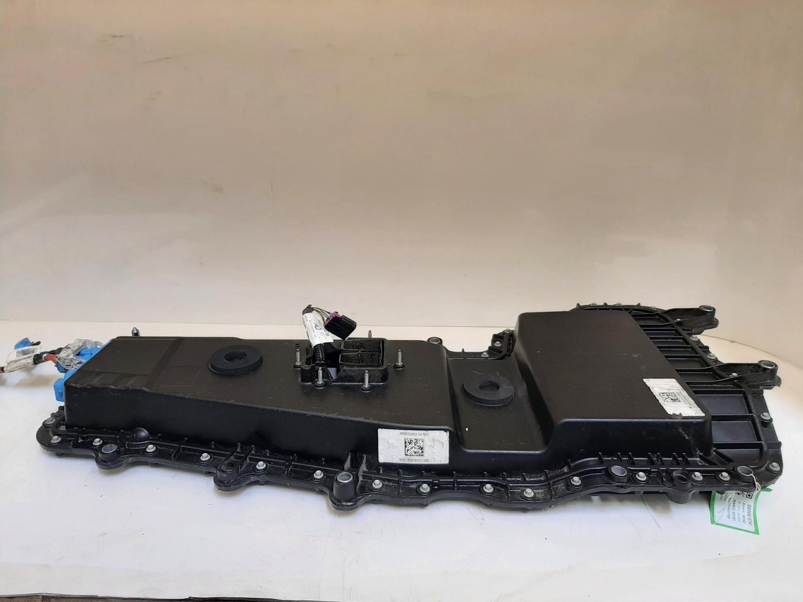

Has anyone got a picture of the battery in the 2018 LAND ROVER RANGE ROVER SPORT EV/Hybrid High Voltage Battery 48V pack please?
There are a few for sale on Ebay but I cant find any pics of the actual battery just the whole battery/dc-dc etc.
Info says its 48v and 15kWh which is fine for my purpose but what is inside the assembly ??
I just cant see how its 15kWh in such a small size !
Any help appreciated please. Thanks. Peter

This is from the mild hybrid so as far as I can tell the capacity is 370W/h ( 8Ah, 46.2V ). Search for K8D2-10C784-A to get some pictures.
