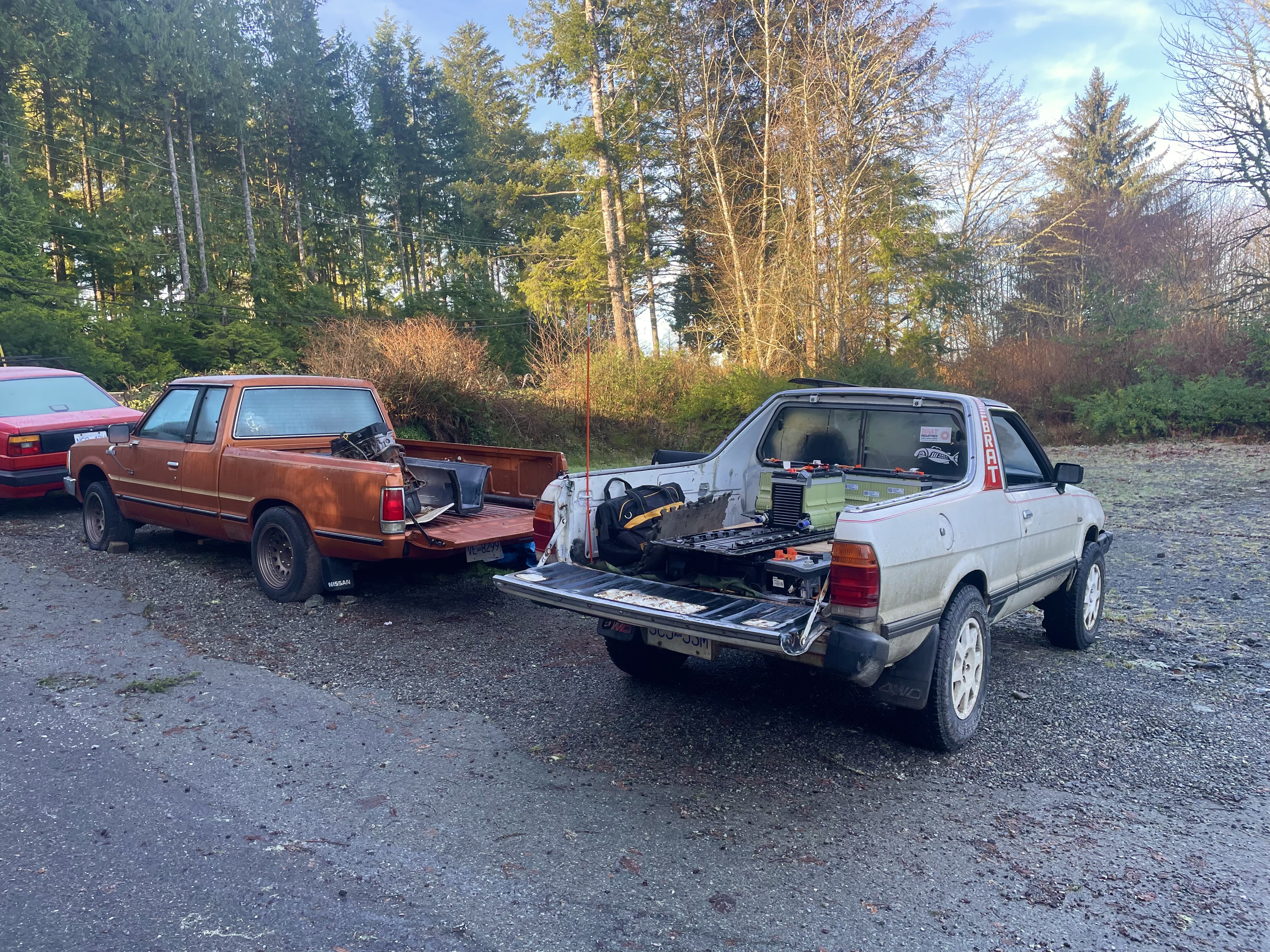

So! Amongst being extremely busy, and between 3 towns all 300km ish away from each other…. I picked up a rust free 5speed Nissan/datsun 720 king cab with a blowen engine…. It was too perfect to pass up!
Only problem: it’s in the port albernie valley, and the closest place I can bring it to was the coast( where I live part of the time)
There is no garage space, and it’s middle of winter. And my collection of ev parts are about 300km away between Vancouver and Victoria.
So here’s the pan:
I’ll tow it to the coast, pull the engine, bring over the ev parts, swap it on the side of the road, and drive it 300km back to the shop, strip it down then rebuild and restore.
so let’s get to work!
Towed it back to an empty lot in town, and borrowed a friends engine hoist and got to de icing.
Just as I got the engine out it started to rain. Good timing! It’s been a long day.

Re: Leaf swapped Nissan 720…. On the side of the road!
pickup the volt battery, zombie and miscellaneous wiring/cooling parts.
Got everything situated, then 2 weeks of heavy rain.
Sun finally broke this week, and quickly got to work. With some scrap metal made some brackets and strapped everything down.
Let’s go for a drive!
Just like the cabriolet, very little torque in reverse. Couldn’t move the truck in first gear.
Runs smooth, needs new shocks.
And the pdm is a dud. no dcdc and charger. The leaf stack was 350$ cad, so still wining in my books!

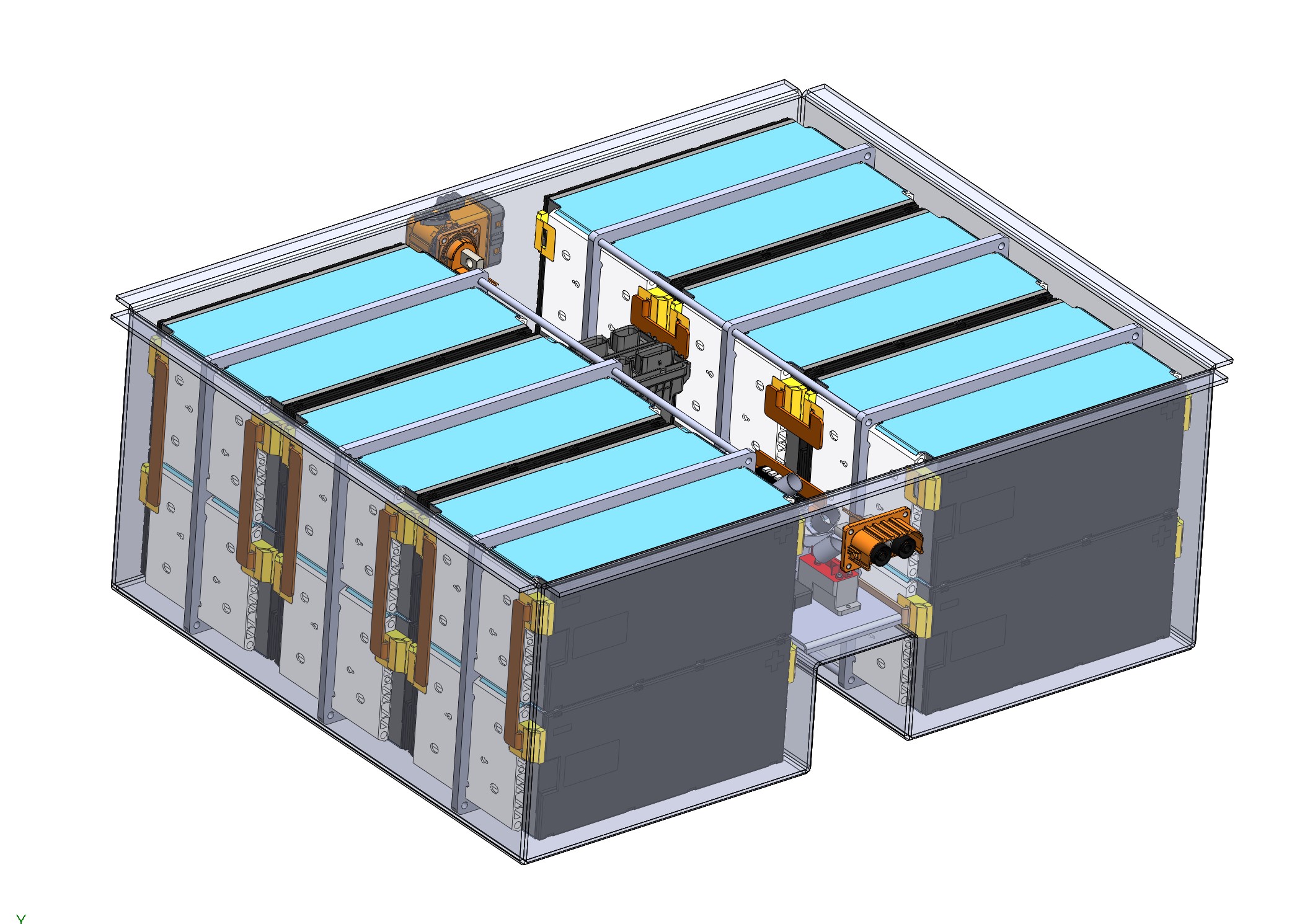

Started roughing out a battery box for under the bed of the truck, for the 35kwh e-golf pack.
The pack layout is setup some there’s an upgrade path to 96s, as the egolf pack is only 88s.
The modules follow an industry stander layout, so can upgrade to id4 modules, etc if desired.
Posts: 2753
Location: Bristol
Has thanked: 264 times
Been thanked: 717 times
Nope not upgrade able. ID4/3 /MEB are VDA599 and the EGolf are VDA355.
Ipace are not VDA355, they are slightly longer. Alot of other cars are almost VDA355 but longer.
Posts: 1080
Has thanked: 222 times
Been thanked: 413 times
tom91 wrote: Fri Sep 06, 2024 10:00 am Nope not upgrade able. ID4/3 /MEB are VDA599 and the EGolf are VDA355.
Just saw an id pack, and yeah totally miss calculated. Thanks for the clarity
It’s just some calb modules that are VDA355 so it appears

in spare time been designing up a battery pack that mounts between the frame rails/cradles the drive shaft. Designed some mounting plates to hold 4 full modules, which 6 of these assembly's making a full 24 module pack. as i was planning on finding another egolf pack and ditch the small modules to get to around 38kwh....so some of the packaging i started to land on resulted in:

the truck now will use half of the ioniq 5 pack (16 modules) for a total of 38.4kwh 96s.
they are 811 NMC. lots of Nickle, so pretty power capable cells....and volatile. No sweat running the peak 80kw leaf motor.
i was tempted to use the 64kwh kona pack but big range is not the goal for this truck. it will likely live on a stretch of coast with no more than 50km of rural roads.
