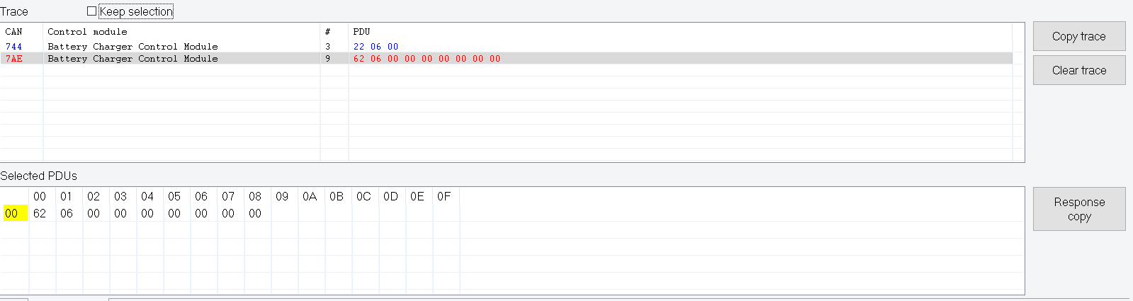

You could try to read the coding data with uds service hex 22 06 00. Does the ODIS show the coding data and maybe parametrization date? Does it show identification data like part number, software version?

I think I managed to figure out sending that in ODIS, here is the response. I can't get much from ODIS at all, it can connect and pull some data, but nothing like coding parameters etc.

This means: the response of the "read coding 22 0600" is 6 bytes with value zero. Nothing coded. We either need a description, which is the meaning of each coding byte, or to read out a correctly coded unit, or, in worst case, just write random bits and see what happens.
Writing of the coding should be possible with "write data by identifier", in this case 2E 06 00 112233445566. Most likely needs some preconditions like extended session, security access and writing the workshop code.
