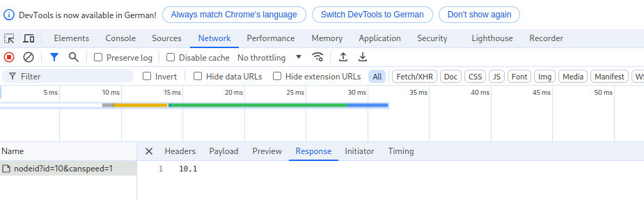

Hello,
I just installed the latest version on my esp 32 can lite module so now i have the button to change the CAN speed just under the node ID, amazing.
Problem is that it seems to not work, as in the can speed doesn't change when i change it on the button. regardless of the can spee displayed here the web interface remains with what it was initialised with ie 500kbps.
so i can't change the can speed of the focci box to 250kbps and then change the can speed of the web interface to 250kbps. I've tried to change the default speed in the code of the web interface to 250kbps only to discover that it still doesn't work.
by it doesn't work i mean that the web interface isn't comunicating with the focci box.
HW V4.5a
What am i doing wrong ?

Have you also updated the ESP firmware or only the web files?
When you open dev tools (F12 in good browsers) you should see the request going out and when selecting it and viewing the response should see something like this So two comma separated values, not just one
