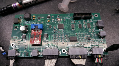

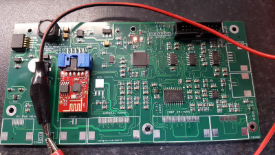

First power up and program test on the V4B Large DU logic board looking good.
Only one mistake from me this time : D1,D2 reverse polarity.

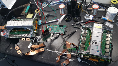

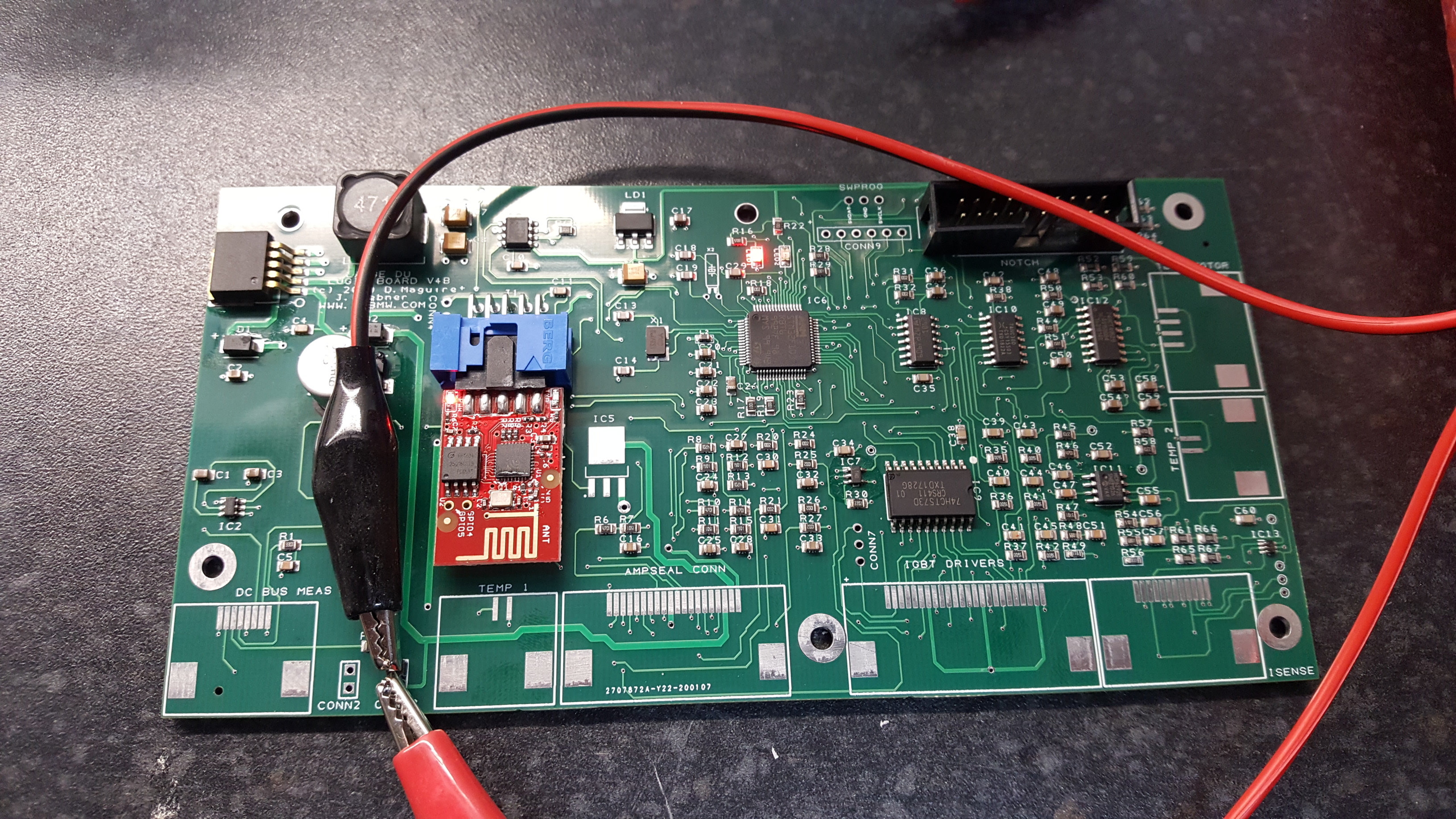

Running the first V4b large drive unit board from JLC through it's paces on the bench. It just works
