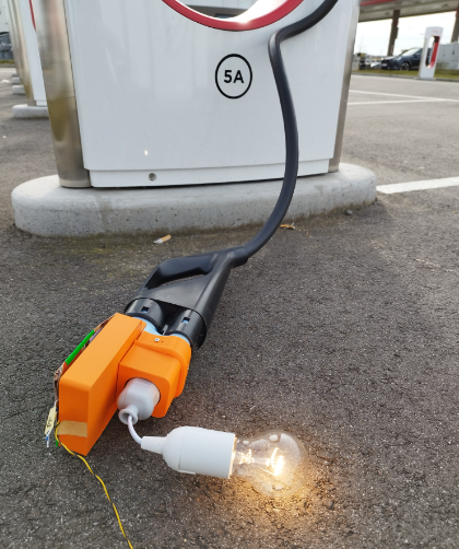

Finally (hopefully really finally
) the light bulb demo works on the supercharger. The root cause why it did not work sounds strange, but I have no better explanation. It was hanging in the cableCheck loop. Why? Because the SuperCharger seems to monitor the voltage on the PP. After correcting the pull-up-circuit to 330 ohm and 5V, and 3k pull-down, it nevertheless did NOT work. I scoped the PP line, and found that there are strange "ripples" of ~100mV on this. Where do they come from? Because also on the 5V supply there are the same. Why? Finally I found, that the LED driver transistors were the wrong types. Instead of the NPN with integrated resistors, they were normal NPN. So the controller pushed a lot of current to the basis, and this lead to voltage drops of the 5V, in the rhythm of the blue LED blinking during cable check. After replacing the transistors, the 5V and the PP volage are stable, and the supercharger is happy.
So the conclusion is: Just make it right, then it will work
Logs from the todays successful runs on five different types of chargers here: https://github.com/uhi22/clara-logs
BTW: All five chargers were happy with the new "locally administrated" MAC address.
[Edit] Also number 6, a quite old Efacec triple, accepted the MAC.

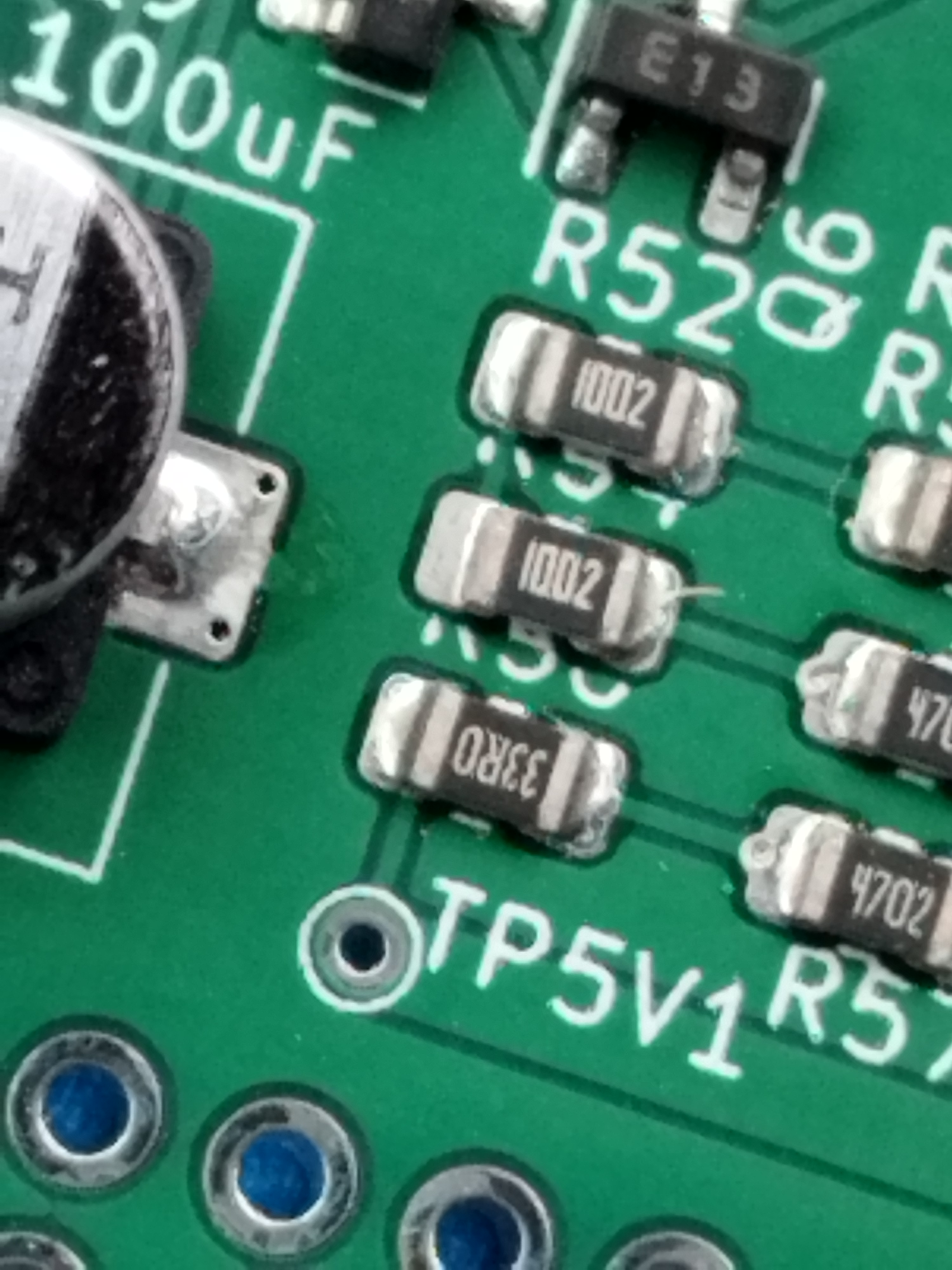

Got a parcel today. But: "330" is not 330ohms, beginners fault.
