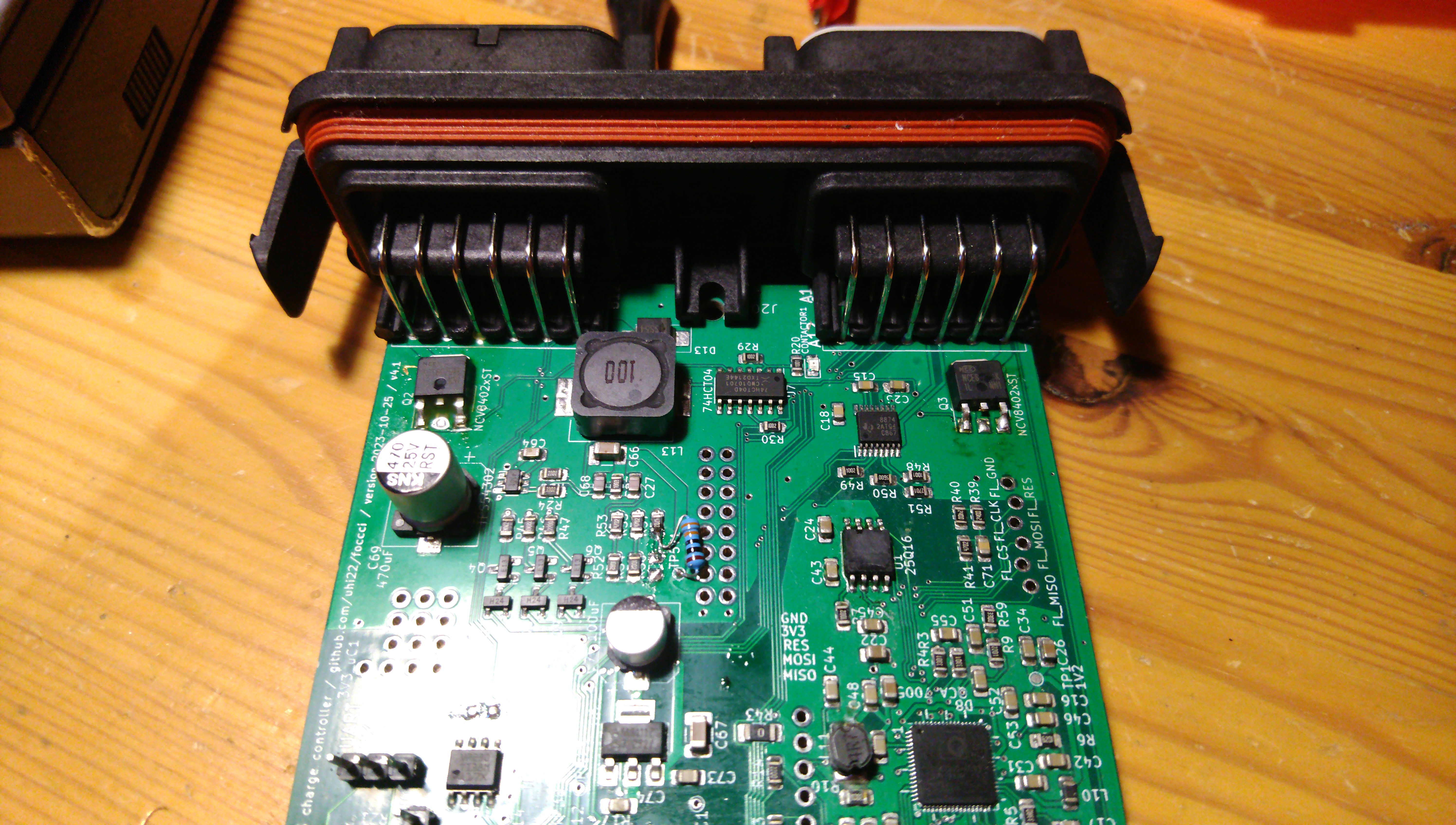

I have bad news. I think I fried my Clara's NCV8402 contactor drivers. When I set ActuatorTest to 3, the contactors clicked on, but when I set it to 0, they never opened. Then I noticed Clara was heating up a lot.
Now the contactors are powered even if ActuatorTest is 0, and at the same time the multimeter measures the contactor driver control pin at 0V.
The contactors are the classic uneconomized GV200s that you get from Model S battery packs - essentially the good stuff that everyone should be using for everything.

Hm, was assuming that the contactor drivers are able to protect theirself. Seems not. One possible topic: If the contactor is driven by PWM, the turn-off leads to high voltage (40V?), which is clamped by the driver. The driver is designed to do this, but of course it produces heat. The idea is to use a diode in parallel to the contactor coil, which carries the current while the driver in the off-phase of the PWM.

Well I certainly didn't add any diode. I think it should be on the board itself, if the board needs it for the features that it provides. It's very inconvenient to provide diodes externally.
EDIT: I now have two NCE6020AK MOSFETs waiting to be put on the board. One should be able to even drive both contactors in parallel or to burn the 10A or so fuse supplying this board and the contactors, in case of short circuit, so it doesn't need built-in protection. I just need to grab a freewheeling diode and see where it will fit on the board. 12V seems to be pretty far away from one of the transistors but close to the other one.
EDIT: Grabbed some US1Ms from a donor board for freewheeling diodes.

Well, the idea to NOT use free-wheeling diodes on the board was explained here: viewtopic.php?p=58526#p58526
I do not have an idea how to bring all aspects into one solution. Maybe a separate 12V for the high-power, which only is connected to on-board freewheeling diodes. Then it is up to the integrator to wire it correctly, that the freewheeling works and the unit is NOT powered reverse by the contactors.

Yes that is going to be a problem in my V4 board when I add the diodes. However isn't the next version going to have an internal 12V switch (or regulator with shutdown capability) to power itself off even with permanent 12V connected (even if it's through contactors)?
I simply don't like the NCV8402. It's a very bad switch for the money. Just look at the on-state resistance, it's about 200mOhm which is simply bad for a low-side switch that costs almost a dollar.
EDIT: If I'm allowed to suggest a modern cheap MOSFET, look at the WSP6956. It's a Chinese chip available on JLC. You get two N-channel MOSFETs in one package, for $0.25, with 10A continuous rating and sub 20mOhm on-state resistance. And you can control it using 3.3V just fine, the resistance just goes a bit above 20mOhm. And even this one is excessive, as it can handle 60V, but at least it won't break if there are large spikes. There are similar western ones like SQ4946CEY (that's SO-8 vs. SOP-8 though... don't have time for browsing Mouser right now)
EDIT: Also, I should say, if you look at the overall system design and not just the BOM cost of this circuit board, a high side switch would be a much better design. It naturally allows not having the board powered by the contactors and you can connect the other side of the contactor coils to a chassis ground right next the contactors, reducing voltage losses in wiring and the cost and complexity of wiring. You also won't have to split the 12V at or after the fuse box to go separately towards this board and the contactors.
EDIT: Board is very officially mine now:

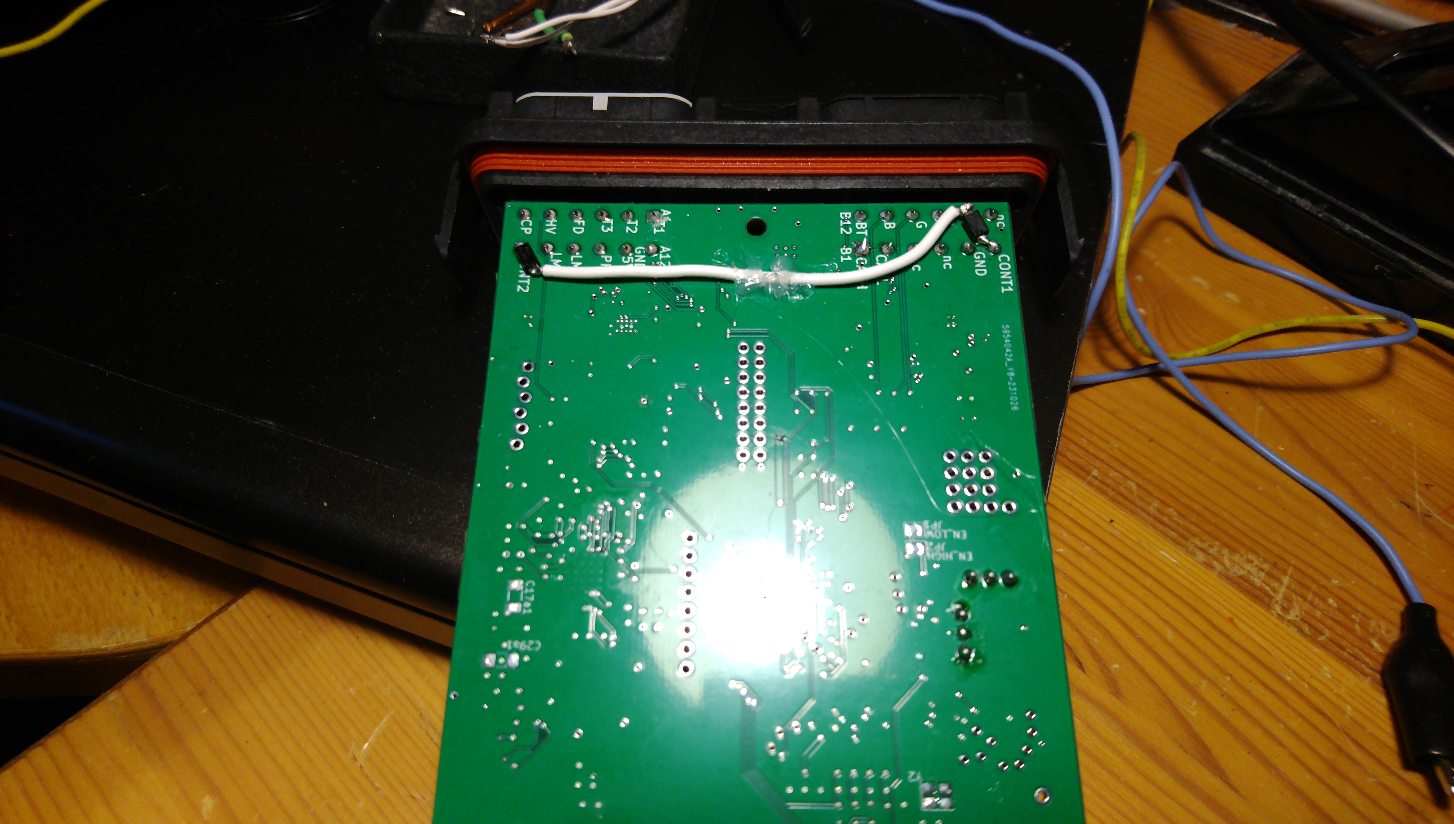

Just testing the newly arrived v4.2 boards. On first look, quite good, the SMD transformer works, demo-charging on the desk is fine. But: The intended improvements regarding PP and IPROPI went wrong, there are missing tracks. Seems I fully ignored the "unconnected" errors in the design rule check. Sh*t. Can be fixed with wires, but I do not propose to order more of the version 4.2.
Collected the currently known issues here: https://github.com/uhi22/foccci#v42-2024-02-06
