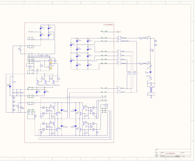

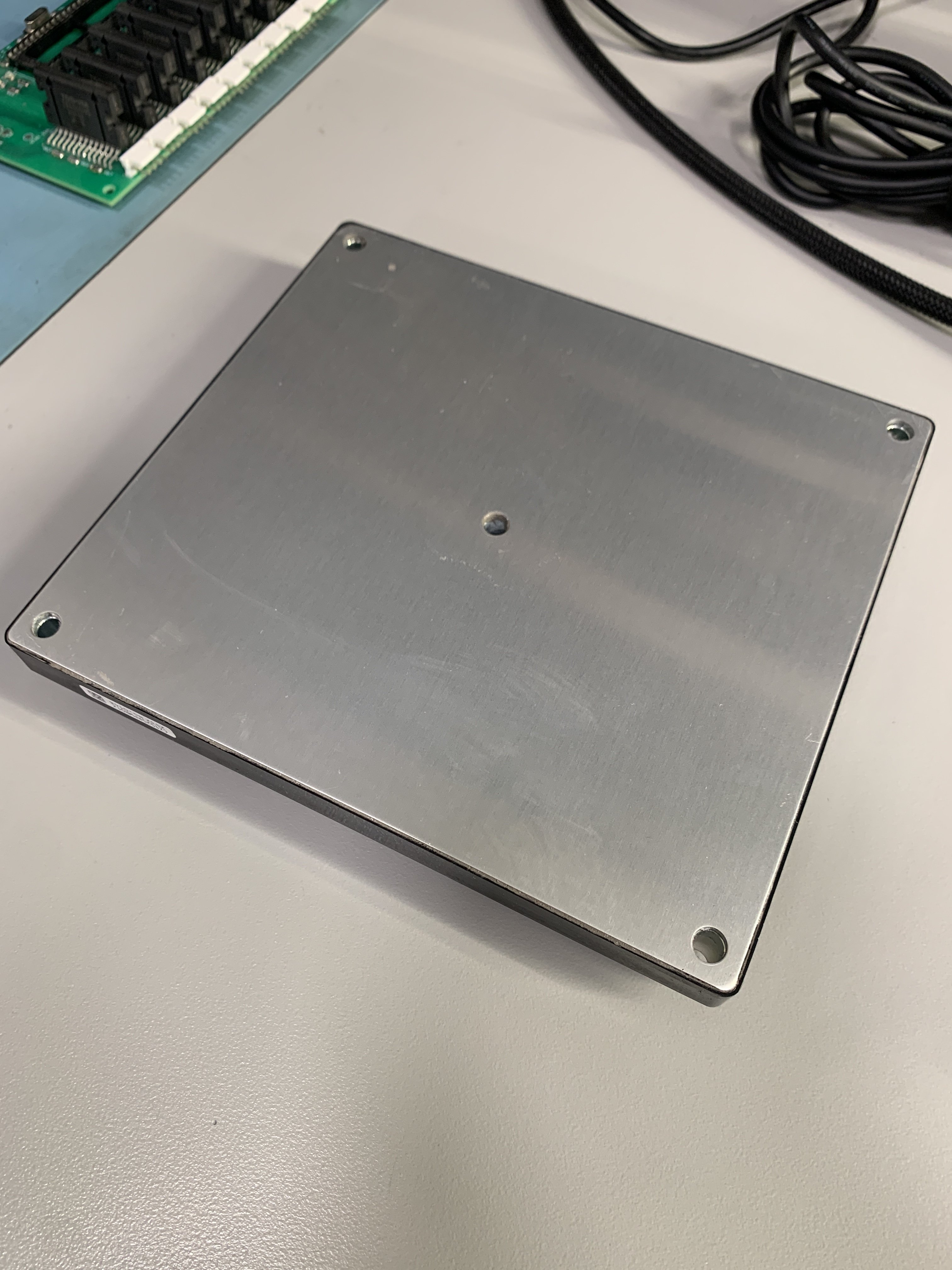

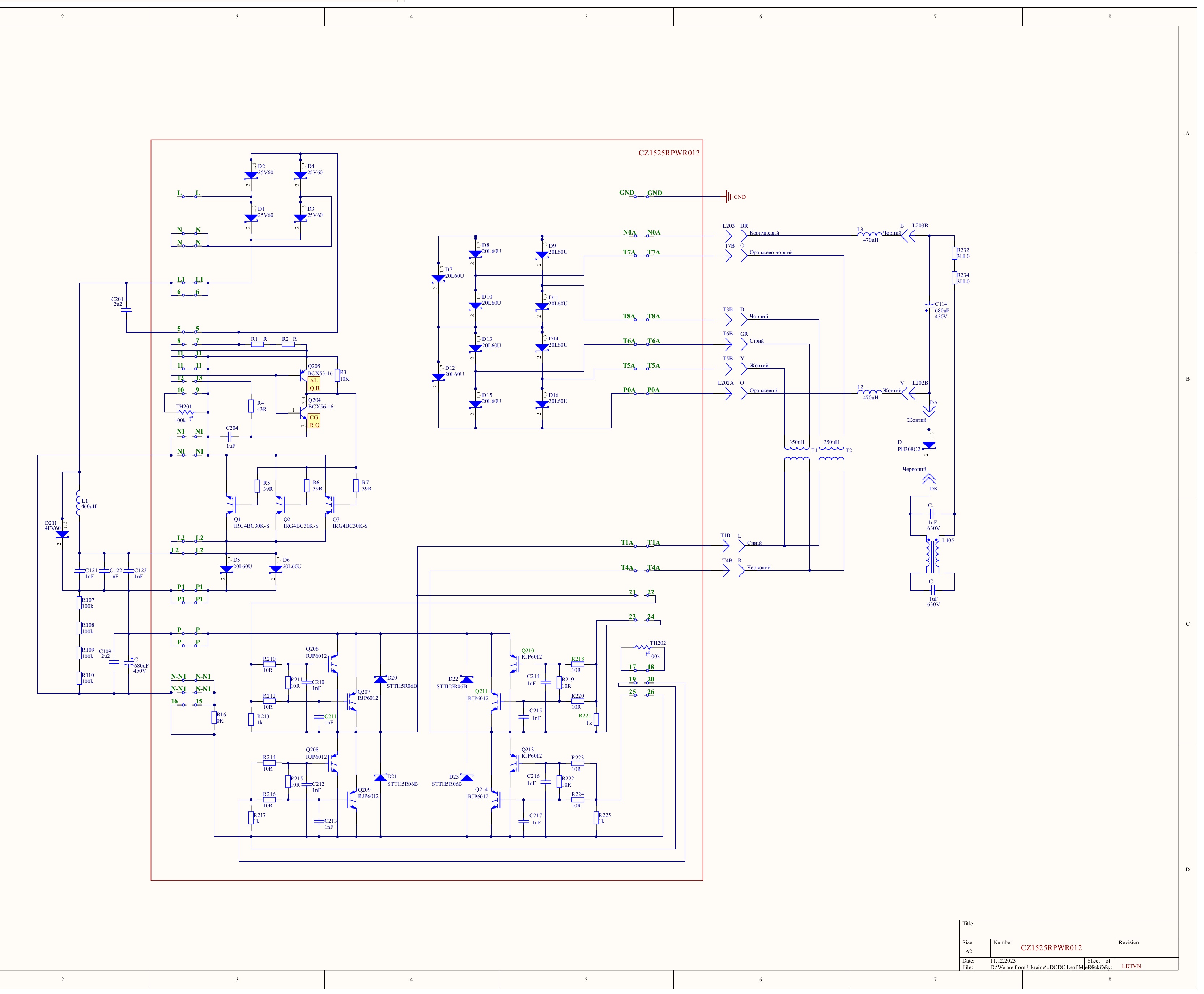

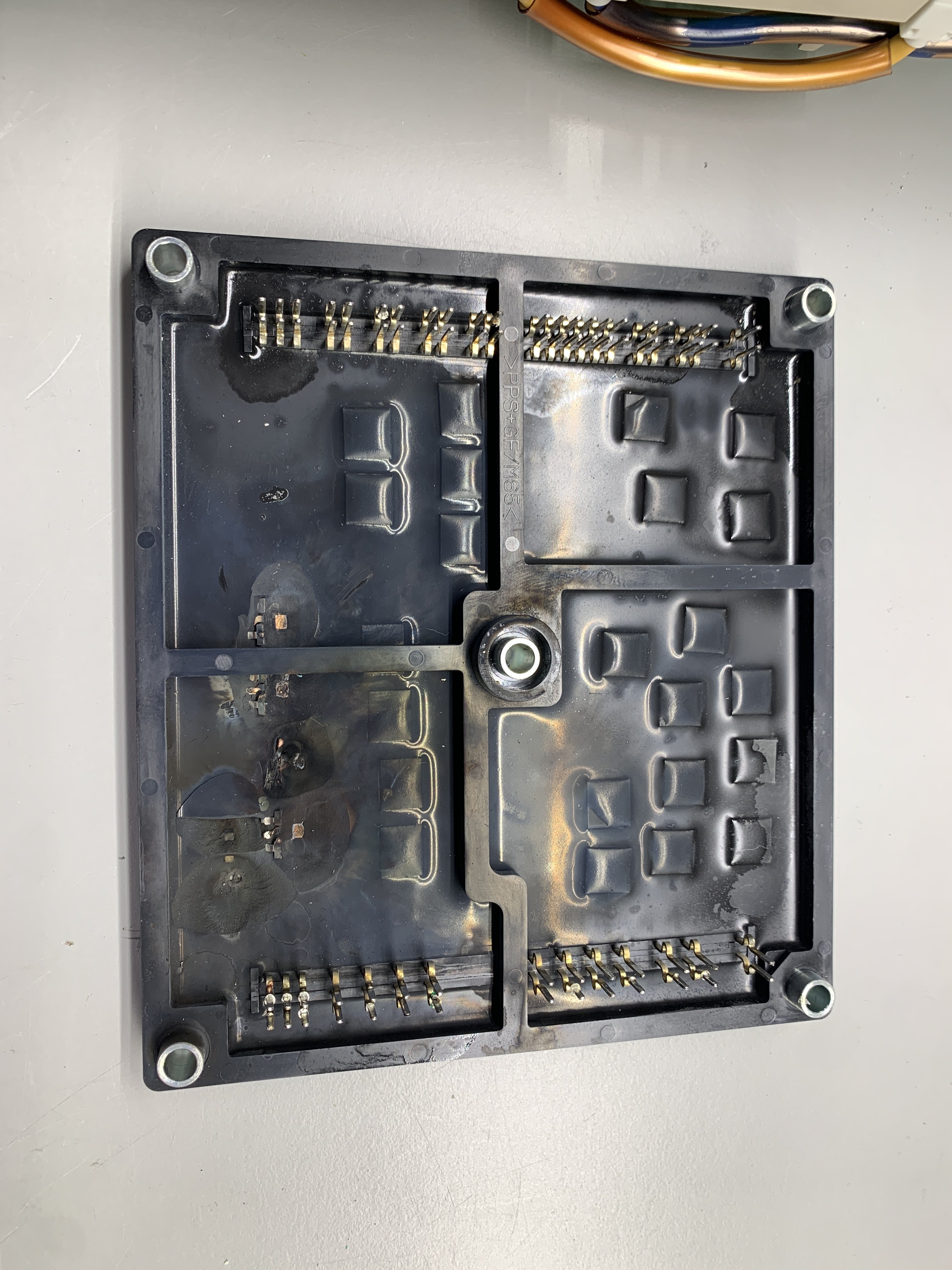

Hi all, the picture attached shows what people call a "waffle plate" which is found inside the Nissan Leaf's onboard charger. This part is known to fail and unfortunately very difficult to find a replacement for or repair. The PCB is potted with epoxy, which at this point is completely hardened and basically impossible to remove. Some people have x rayed the piece and have come up with schematics for the board. Attached is also the schematic. I can draw the schematic myself in KiCad, but there are a few things I don't know how to do. For instance, the bottom of the board has an aluminum plate(wiped clean in the picture), that is normally coated with thermal paste. I have no idea how this plate is attached to the PCB? on the top side of the you can also see some spacers(one in each corner and one in the middle) which seem to be pressed in? My questions are:
1. How is this aluminum plate attached to the PCB? Is it a normal manufacturing process that can be requested at the time of the PCB fabrication?
2. Does anyone know what type of pins are the ones sticking out of the epoxy on the top side? these pins are inserted and soldered into another PCB normally stacked above this one.

Is the aluminum very soft? Any chance it's a single layer aluminum PCB?
The tubes look to be smd standoffs. If the aluminum plate is separate, they could be pems standoffs but it doesn't look like a normal pem standoff.
The male headers look like a board to board spacer header with a spring in the middle. Might be OEM over engineering for vibration.
Looks like the injection molded "spider" slides over the spacer tubes to hold the potting compound.
Do you know what starts the failure? Looks like heat / bad connection.

celeron55
Posts: 804
Has thanked: 38 times
Been thanked: 136 times
Re: Reverse Engineering an onboard charger PCB
Post by celeron55 »
It seems this part can be found in the gen1 Leaf, in which the OBC is located behind the rear seat. The ones after 2013 or so which we call gen2 have the PDM under the hood, which contains the OBC, and that doesn't have any potted transistors, it's all quite repairable.

jrbe wrote: Sat Feb 24, 2024 2:15 am Is the aluminum very soft? Any chance it's a single layer aluminum PCB?
