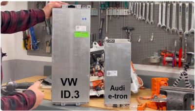

just wanted to show the Audi e-tron battery sum luv
I will build up this post a little over time, please feel free to contribute

mandatory stare and compare
Volkswagen ID.3 battery module compared to the
Audi e-tron

by arber333 » Thu Nov 16, 2023 6:35 pm
Gregski wrote: ↑ Thu Nov 16, 2023 5:02 pm
Audi e-tron
Not nothing to compare. ID3 is 12S module and E-tron is 3S but is 4P3S so the energy is a lot...

by modellfan » Mon Dec 11, 2023 1:38 pm
Any CAN log files, any DBC or even running code yet? Is there any chance, they a using the same messages as ID.3 ID.4 ?

by boekel » Wed Feb 28, 2024 8:29 pm
modellfan wrote: ↑ Mon Dec 11, 2023 1:38 pm
These e-tron CMU's speak the same language as the VW e-golf and e-tron batteries, but they don't update the values unless we powercycled the cmu's and we never found out how to make them update.
note that there are now also audi-etron models that use the MEB battery platform.
