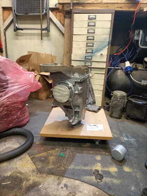

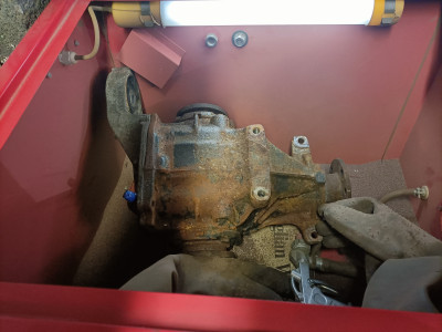

since it was a little moist outside I treated the diff to a spin in the media blaster and a few coats of paint
just need to drop the old one and swap them over the slightly better ratio was hardly worth bothering with 3.45 to 3.38 but every little bit helps

Diff is in and it was an absolute pig the bolts were really hard to access and some idiot (me) put them in really tight with threadlock, but its all in just need to refill with oil and torque up the driveshaft bolts

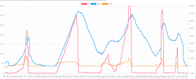

Posts: 2410
Location: Bristol
Has thanked: 209 times
Been thanked: 572 times
Re: [WIP] BMW Z3
Over 300A :) Can you get a Amp and UDC graph at some point? Things are starting to look good.
Wonder how much more the limit can go up by. ;)

Re: [WIP] BMW Z3
Post by andybpowell »
tom91 wrote: Thu Mar 07, 2024 11:43 am Over 300A :) Can you get a Amp and UDC graph at some point? Things are starting to look good.
yes no problem that plot was with throtmax at 50%

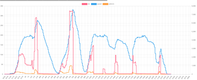

Is this any good for you
Still juddering at low throttle not sure why yet

Peaking around 350A! Great work, did you tweak thrormax at all?
Posts: 2410
Location: Bristol
Re: [WIP] BMW Z3
From those plots it is now hitting the 100kW limit as I set in the code. Will need to look at tweaking things more once your car is more sorted.

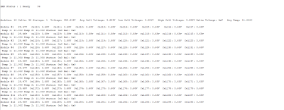

I'm slowly chipping away at the outstanding jobs, charging is now working properly and it's currently on charge, the bms is working (90%) well enough so I can have some feedback during testing, and all of the important data is being shown on my nextion display so just the rev light and tidy the wiring

I have a SimpBMS and just got a 24kWh X5 pack too. Are there many changes to the BMWPhevBMS to get it working with the X5 pack? Is it mainly around identifying the extra modules on the CAN bus?
andybpowell
Posts: 333
Location: Southend,essex,uk
Has thanked: 217 times
Been thanked: 257 times
Re: [WIP] BMW Z3
nkiernan wrote: Wed Mar 13, 2024 7:53 pm I have a SimpBMS and just got a 24kWh X5 pack too. Are there many changes to the BMWPhevBMS to get it working with the X5 pack? Is it mainly around identifying the extra modules on the CAN bus?
I did have it all working when it was all laid out in my garage thanks to Tom De Bree, this is the information he sent me
In code
https://github.com/Tom-evnut/BMWPhevBMS ... hevBMS.ino
void sendcommand() //Send Can Command to get data from slaves
///////module id cycling/////////
if (nextmes == 6) {
6 is the modules amount, so change it to 12 as the modules are 0 to 11 .
But I'd hacked the code on my simpbms so much I decided to start again but now with it in the car I'm having some problems it seems to work fine when charging but when driving it seems to have some issues I need to investigate it further it may be down to all of the other canbus traffic on the same bus when in drive mode

Slight issue with this is that the final XOR for making the command correct for the numbers above 6 wont be correct, but if Andy has gotten the modules reporting the info this is all good.
It is possible that balancing will not work, this has not been proven yet.

I didn't look in depth at it to be honest it's reporting 96 cells and high and low voltages I'll have a closer look tomorrow if I get a chance

tom91 wrote: Wed Mar 13, 2024 9:58 pm Slight issue with this is that the final XOR for making the command correct for the numbers above 6 wont be correct, but if Andy has gotten the modules reporting the info this is all good.
had a quick look from what i can see it looks fine no idea about balancing though

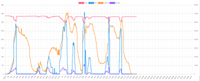

logged some more data as I was out driving the first 2 peaks are uphill the 2nd peak is a hill start
