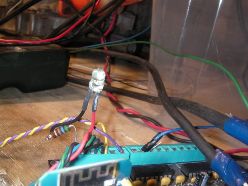

Posts: 3567
Has thanked: 134 times
Been thanked: 336 times
Re: Toyota Prius Gen 2 Inverter Controller
MattsAwesomeStuff wrote: Sat Mar 23, 2024 7:54 pm Count... one physical location?
And then... do what with that number? Is that my numimp?
LED will blink when encode moves beyont the next step. Here i used 60 slot single channel optical encoder and it worked with ACIM really fine.
https://mazdamx3ev.wordpress.com/2015/0 ... er-senzor/
Yes "numimp" is actually number of impulses on one channel along one rotation. So if you see your encoder stating 64ppr this is 64 pulses per rotation. But inverter sees it as 256 signal for determining speed and direction of rotation because A and B differ in phase. When signal A is 1 B is 0. Thats your AB encoder. Mine was just 60pr without direction data. To do that my inverter switched phase count in software directly. So my motor could simply roll downhill and inverter never knew. Yours could apply a "hil hold" function i guess...
Can you state the P/N for your encoder and some photo of its sticker?

Ok, then your best bet would be to put a wheel (a handle) to the shaft and count LED pulses from channel A for one revolution. If there are 64 pulses then so be it, but i am inclined there is more...
Posts: 1017
Has thanked: 403 times
Been thanked: 260 times
Post by MattsAwesomeStuff »
That was a great link, it was explained the right way for me to understand.
80.
80 pulses per revolution.
I set NumImp to 80 et voila. Zero means zero. A plot of angle shows exactly 1 revolution when I complete one revolution.
