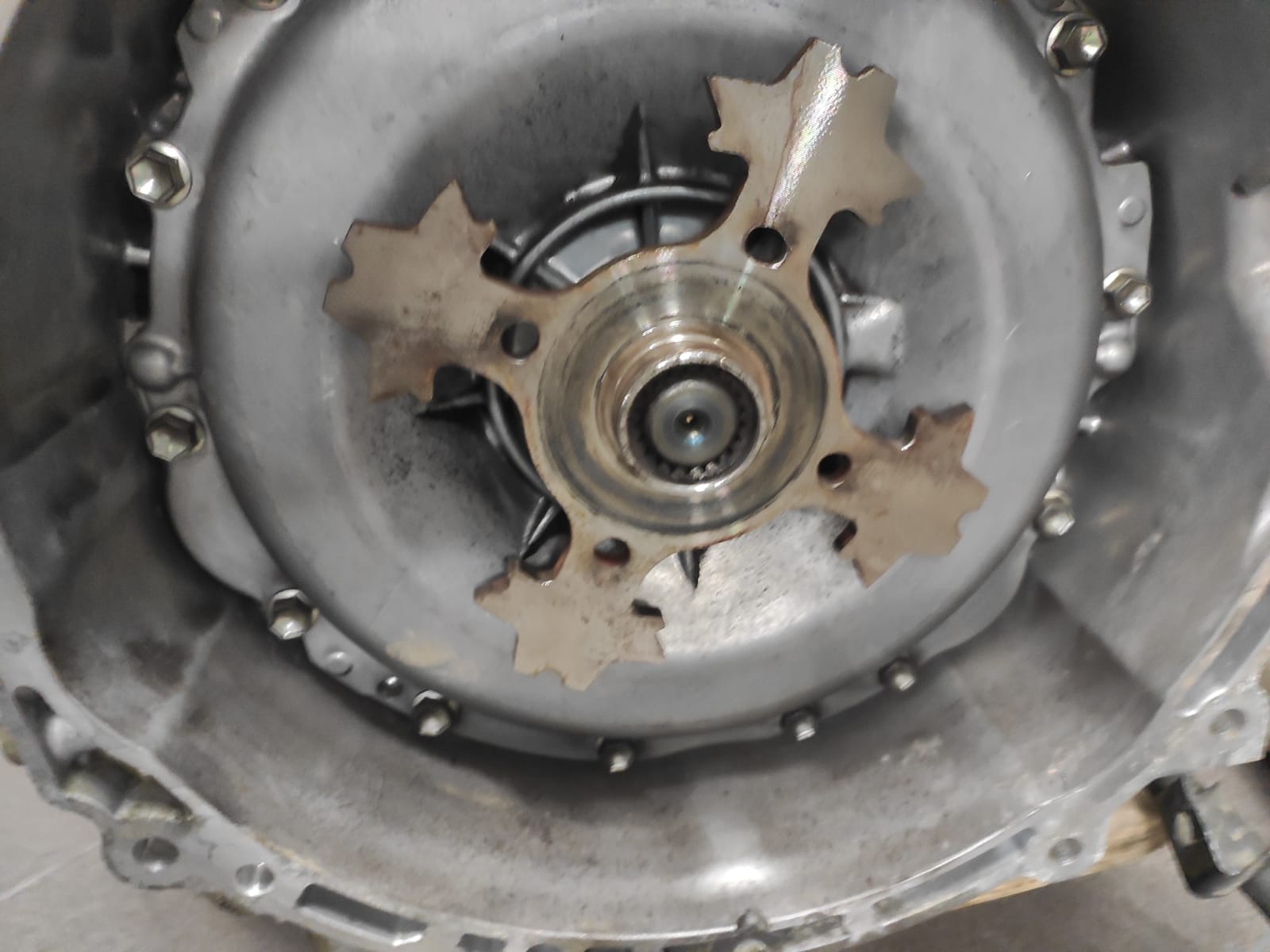

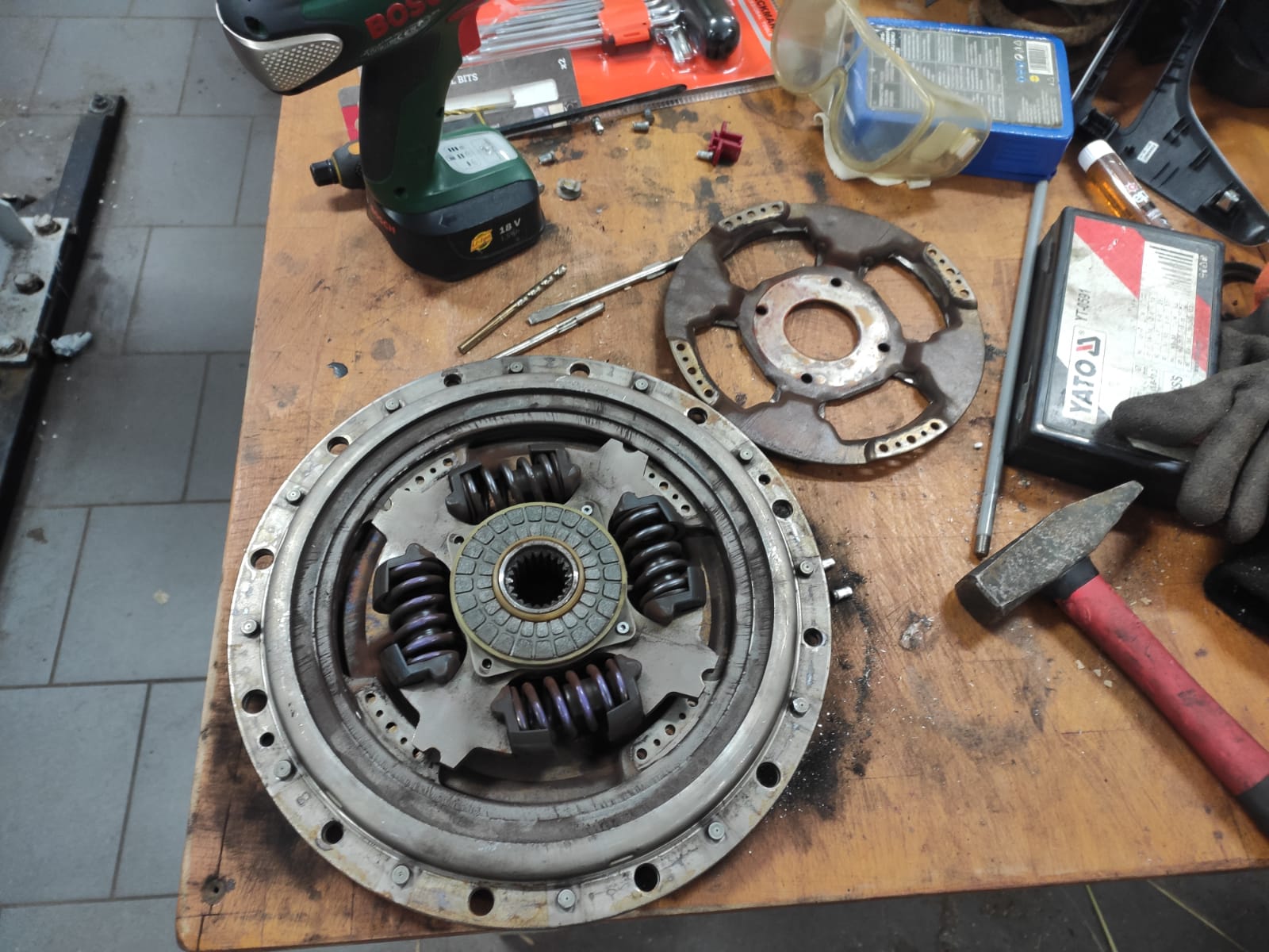

Got some updates here, working on the clutch to get the shaft locked in place and doing some soldering on the VCU. Speaking of which, I was supposed to solder three Mosfets onto IC27, IC28, and IC29, but I ended up losing one of them :( So, now that I'm checking the ones I've already soldered, they look to be MIC4422YM, but according to the BOM, they're supposed to be FAN3122C. They've got the same pinout, but I'm not totally sure they're interchangeable or which one I should go grab. Any thoughts?

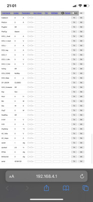

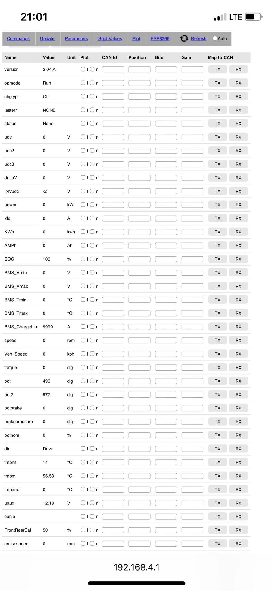

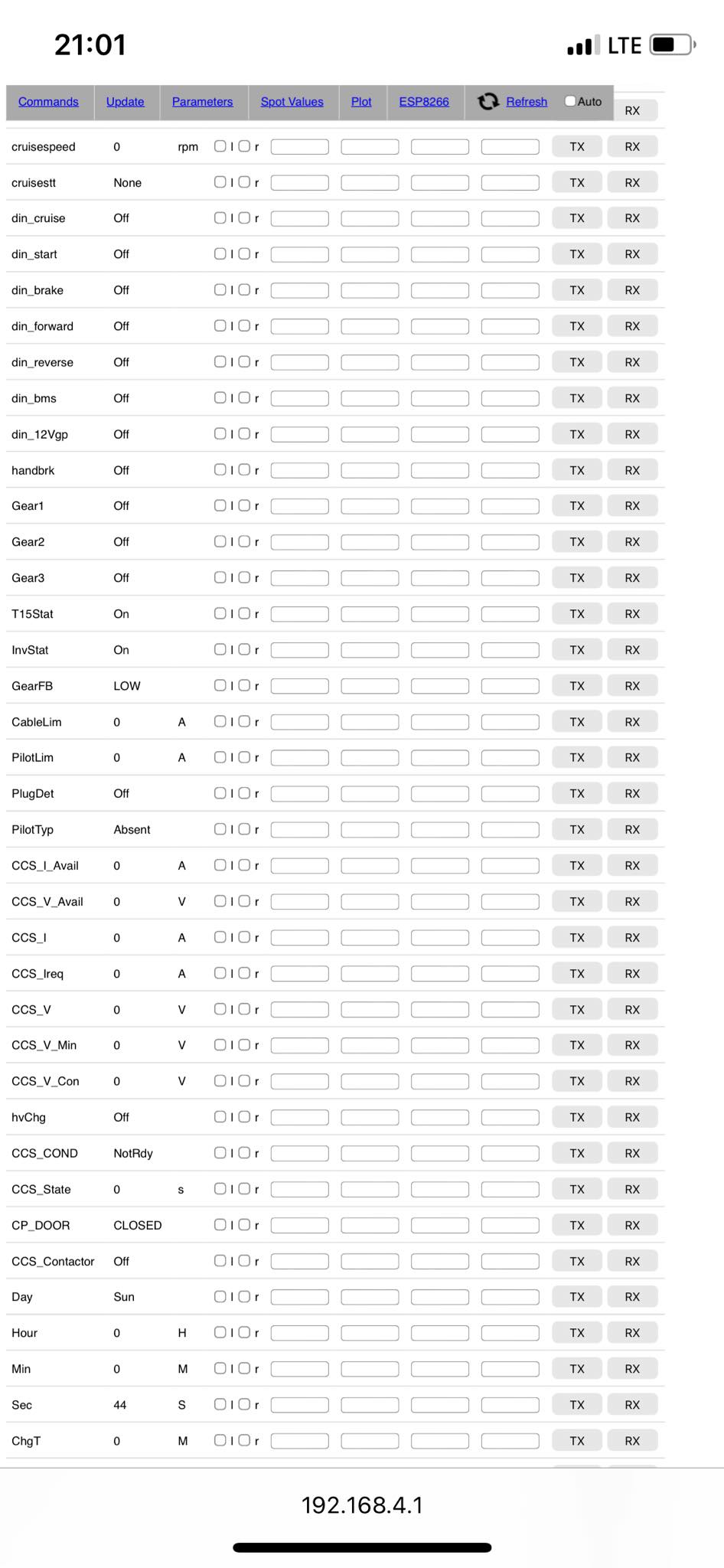

A new week, new progress but currently stuck. After connecting everything needed and adjusting the pedal parameters, etc., the motor shaft won't turn; it seems something is blocking it, when we press the throttle, the motor moves but just initiates the spin and stops like it was blocked. It rotates smoothly by hand, and we've connected the wires from the Shifter Connector, P to HSDN on the inverter, R and D to pins 53 and 54 on the VCU. I'll upload soon a video to show this. Below is the list of connected wires:
ZombieVerter ver 2.04A

Spot Values:
Posts: 2432
Location: Bristol
Has thanked: 211 times
Been thanked: 588 times
Re: Jaguar XJ6 V12 will be electric!!!
There is a new version https://github.com/damienmaguire/Stm32-vcu/releases
Can you post your parameters please. Also no udc or INVudc shown in your spot value screenshots.

Post by Tachopis »
I don't have a screenshot of the parameters but the throttle works fine, the Udcsw is set to 0 as I'm not using ISA Shunt yet. The inverter is winding. I will try tomorrow to upload this video.

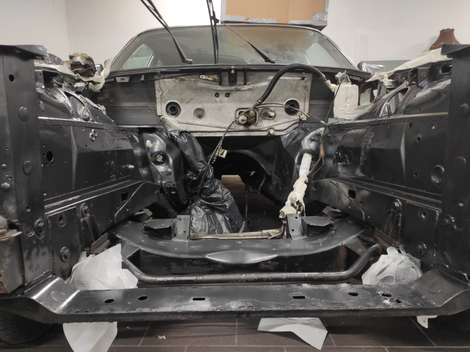

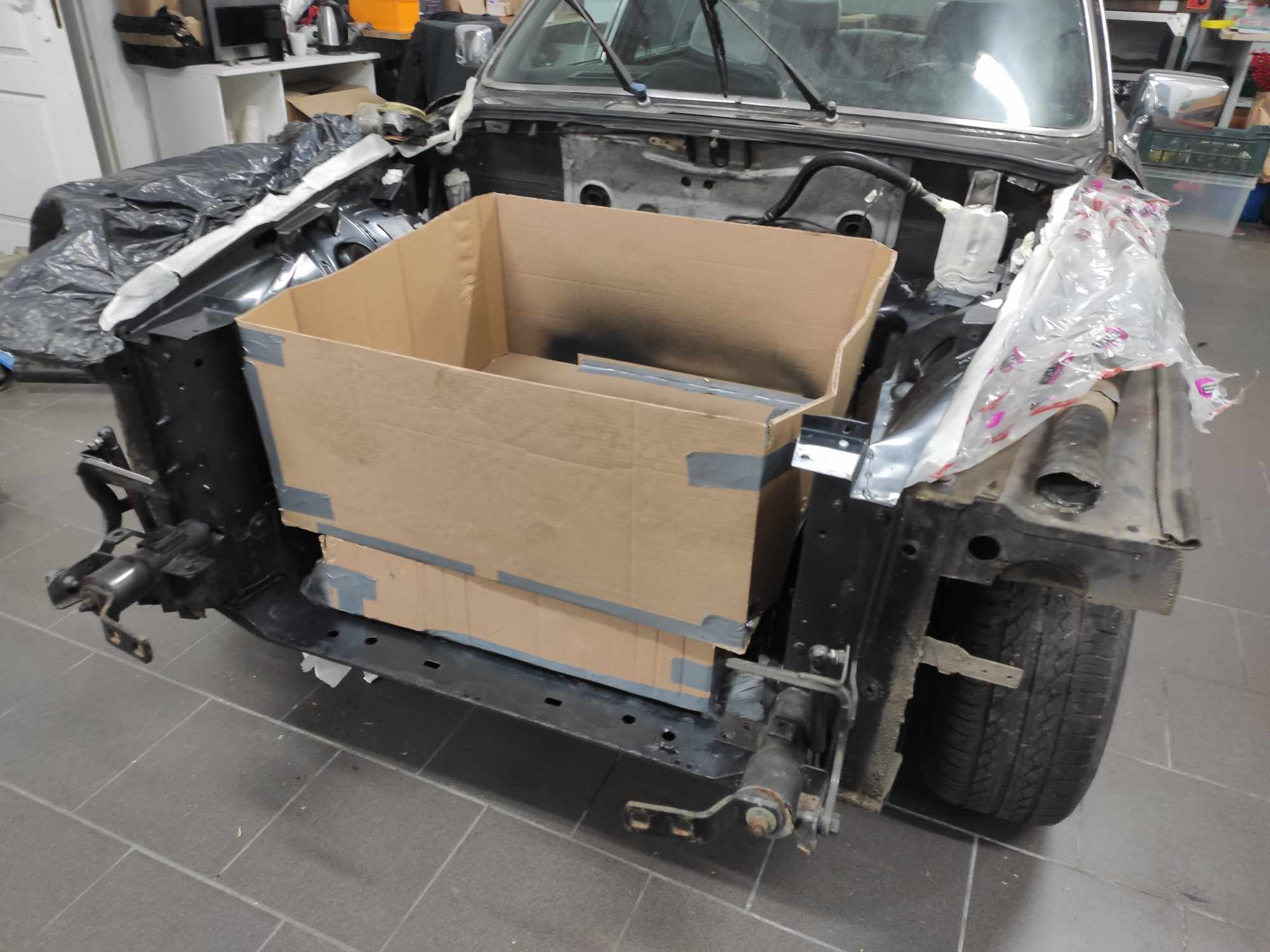

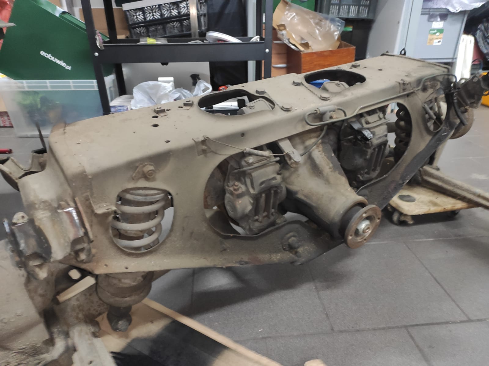

Hey there! Incredible, I hadn’t posted any updates since April. Well, it’s not like I’ve had much time to work on the car, but I’ve made some progress after testing the transmission with the Zombieverter. The main focus has been making advancements on the vehicle itself.

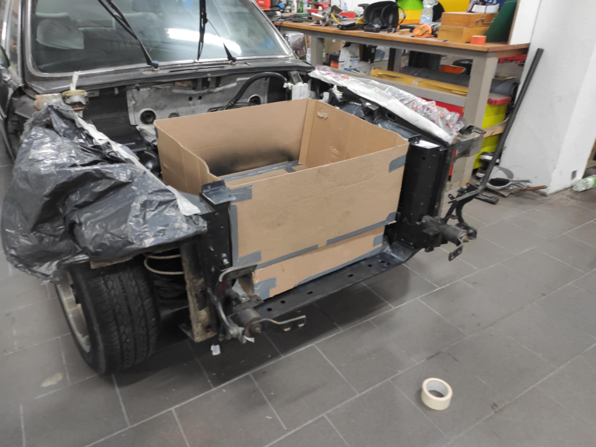

In May, I pulled out the engine, which wasn’t an easy task. I don’t have much mechanical knowledge, so I’m learning step by step. Luckily, I had some great help to get it done. (Here’s the link to the videos Michal is recording for me, he’s the one helping me with the transformation)

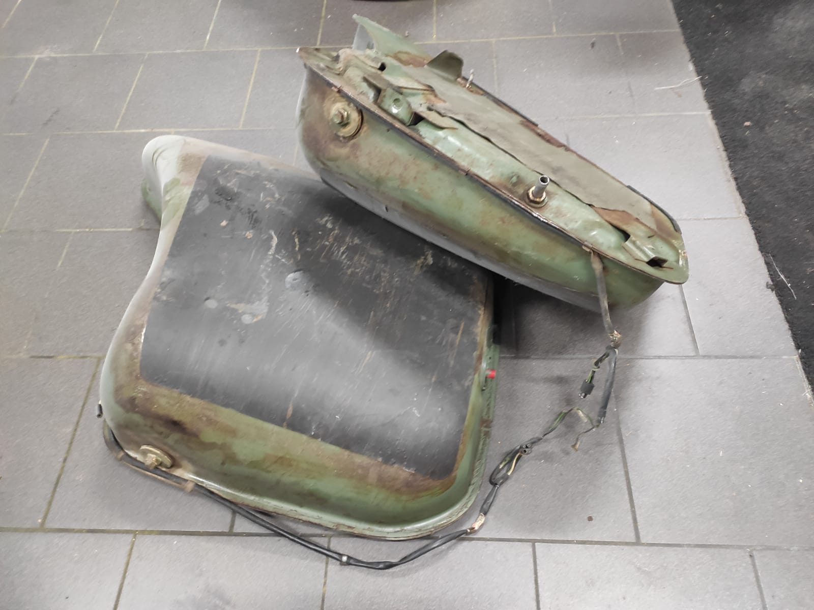

I also took out the tanks, ufff I really don’t like being on camera :p
I had a 3-month break while traveling around Europe in a campervan. Well, and also thinking about the conversion, of course :p

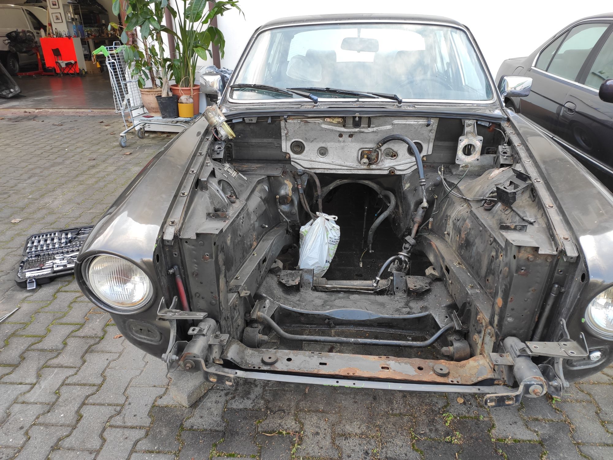

From September to October, I’ve been buying some components and getting the vehicle ready. Using a sandblaster, I removed the rust and old, damaged paint from the engine bay. Then I treated the rust and spray-painted it with the car’s original color. It’s not a professional finish, but as someone around here would say... It’s good enough.
From this:
To this:

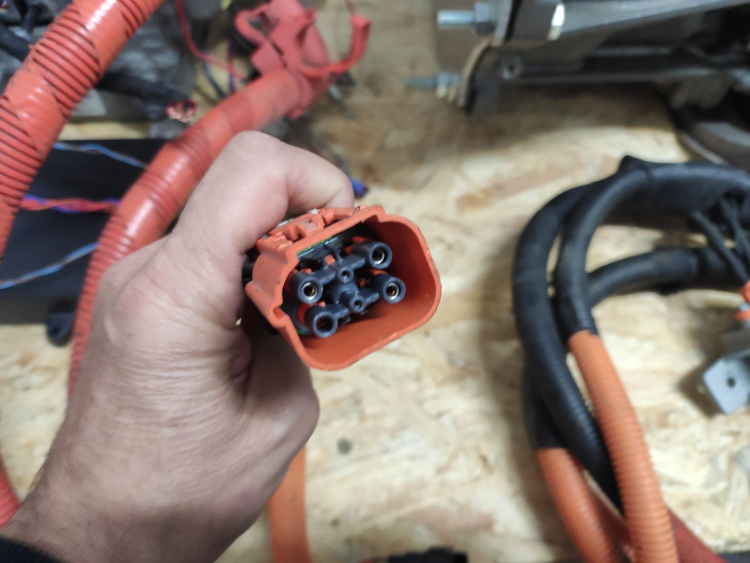

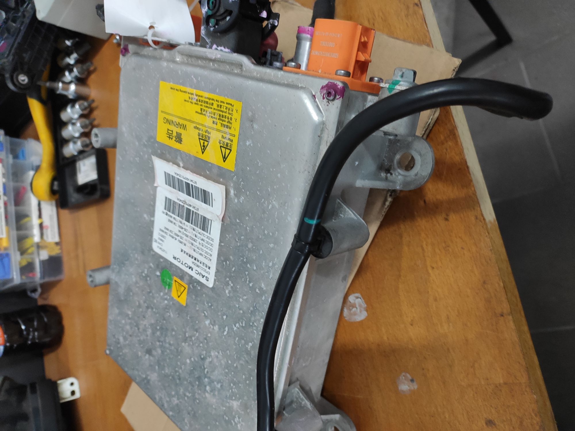

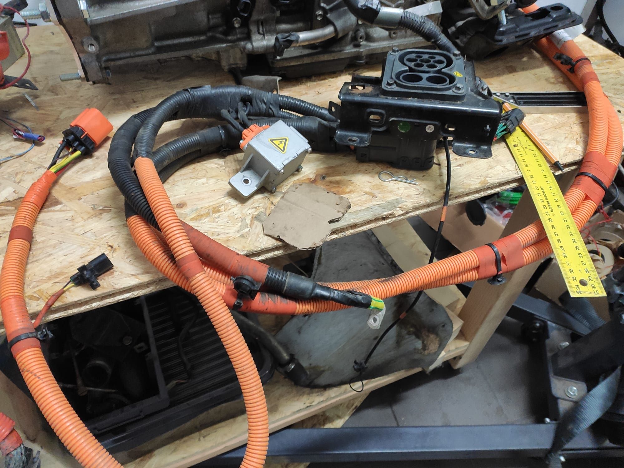

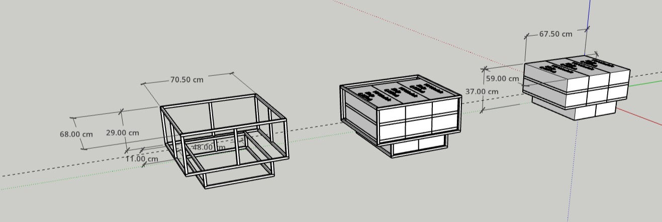

I’ve decided to buy the charger from the MG ZS—I like how compact it is and the fact that it has V2L capability. I also got the MG fast-charging socket, though I had to buy the connector separately since they’re from different model years. At this point, I’m still undecided about whether to buy the MG junction box as well—it looks very compact, which is tempting.

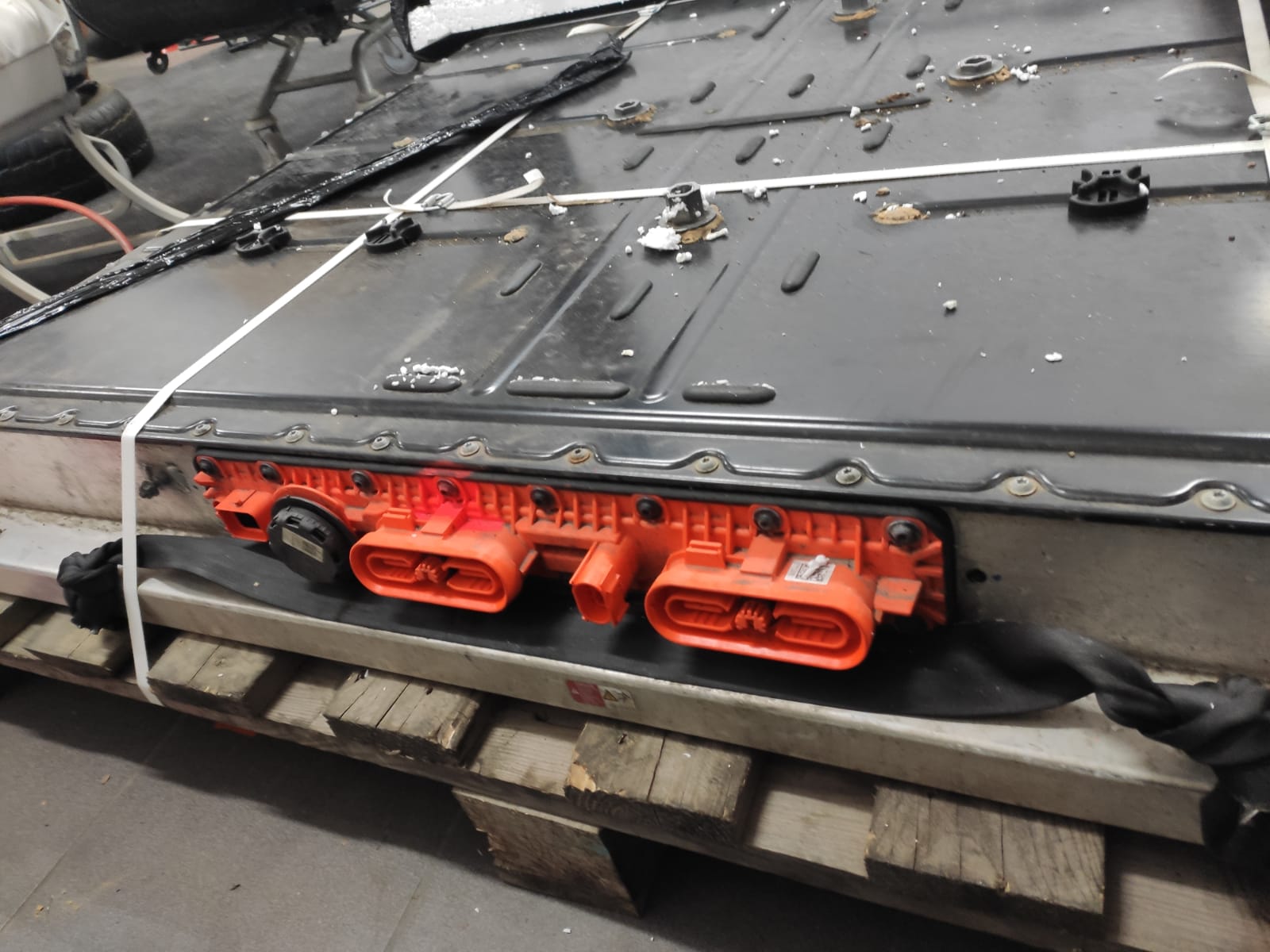

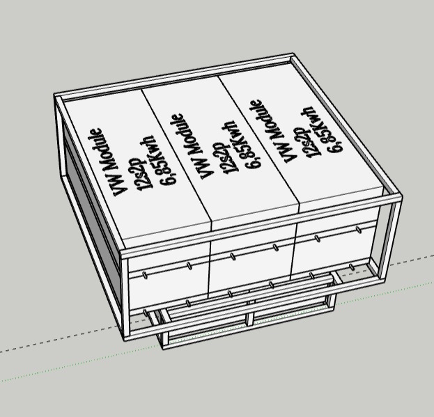

Now that the car is finally in the garage, I’m starting to think about the battery setup. I’ve decided to go with 8 modules of VW 12S2p batteries from the VW ID.3 or Cupra. And yes, I know cardboard boxes can handle *anything* :) I’ll try to scan the inside of the engine bay for better precision. I still need to figure out which mounts to use to keep the battery box stable and secure. I’d definitely welcome some help with that!

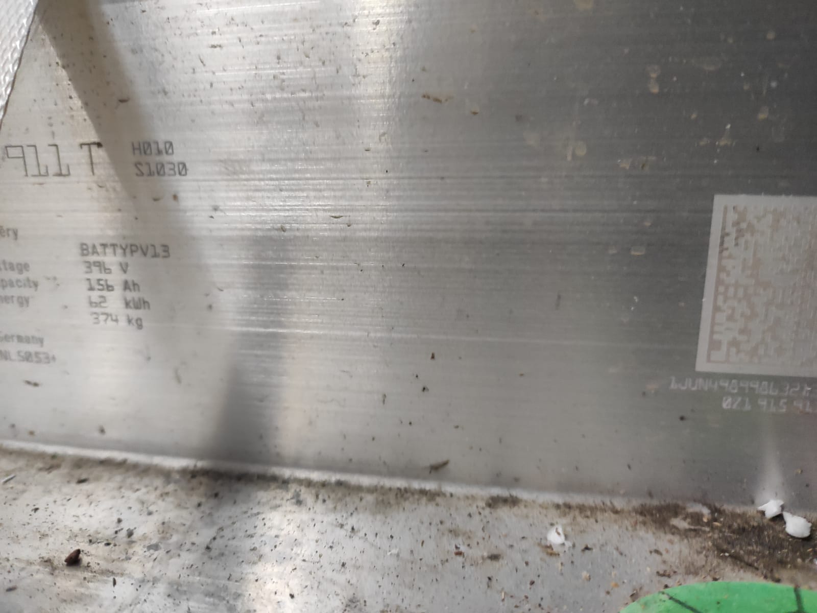

In November, I bought the battery, as mentioned—a VW ID.3 62kWh. I’ll only be using 8 modules, which gives me 55kWh. While waiting for the battery to arrive, I started dismantling the IRS. After 40 years untouched, it definitely needs a refresh.
The battery arrived last week, but for now, it’s staying put until I finish with the IRS and clear out space to work on it safely. Hopefully, the modules are in good condition!

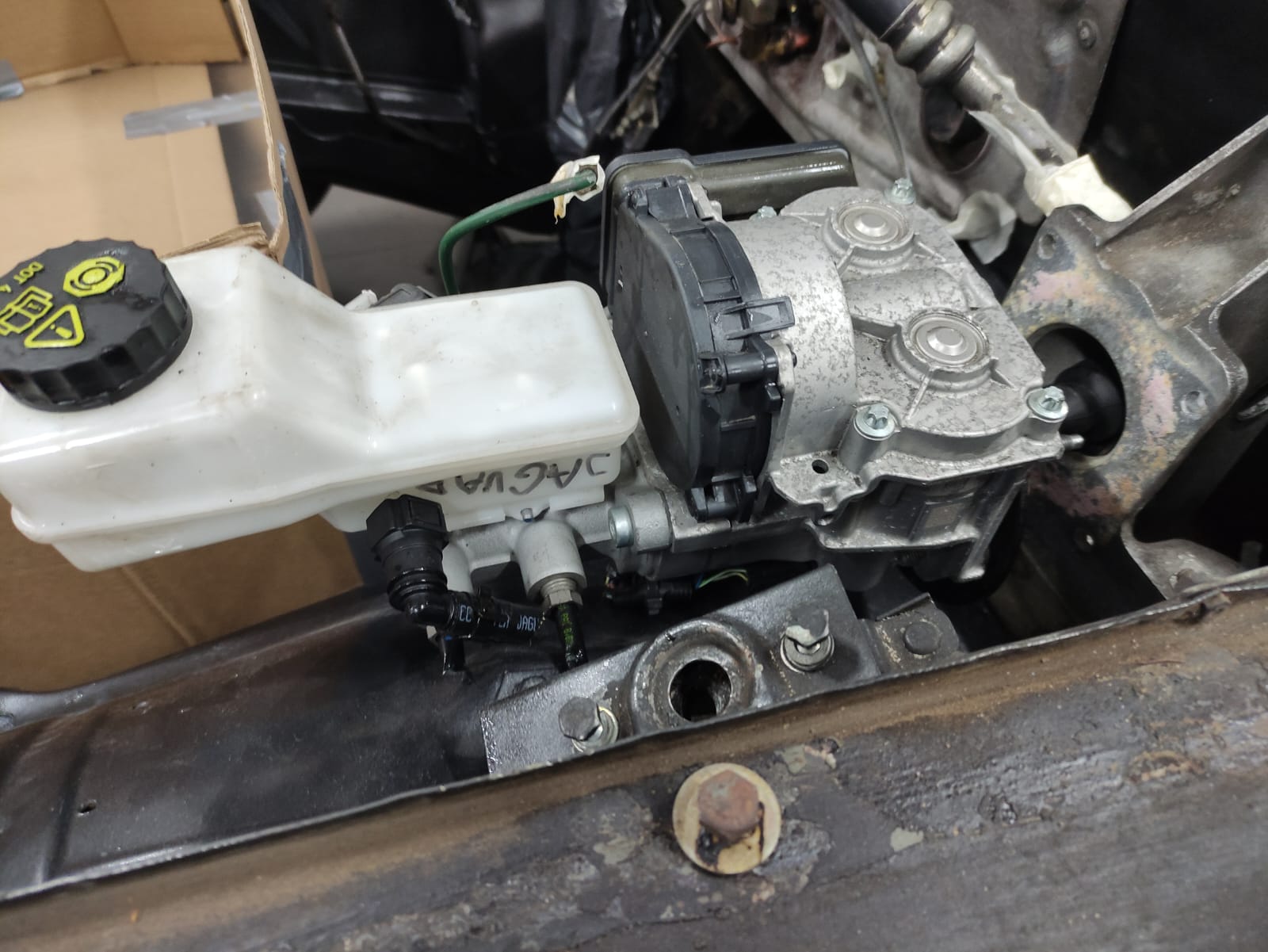

Post by Tachopis »
New day.. new challege

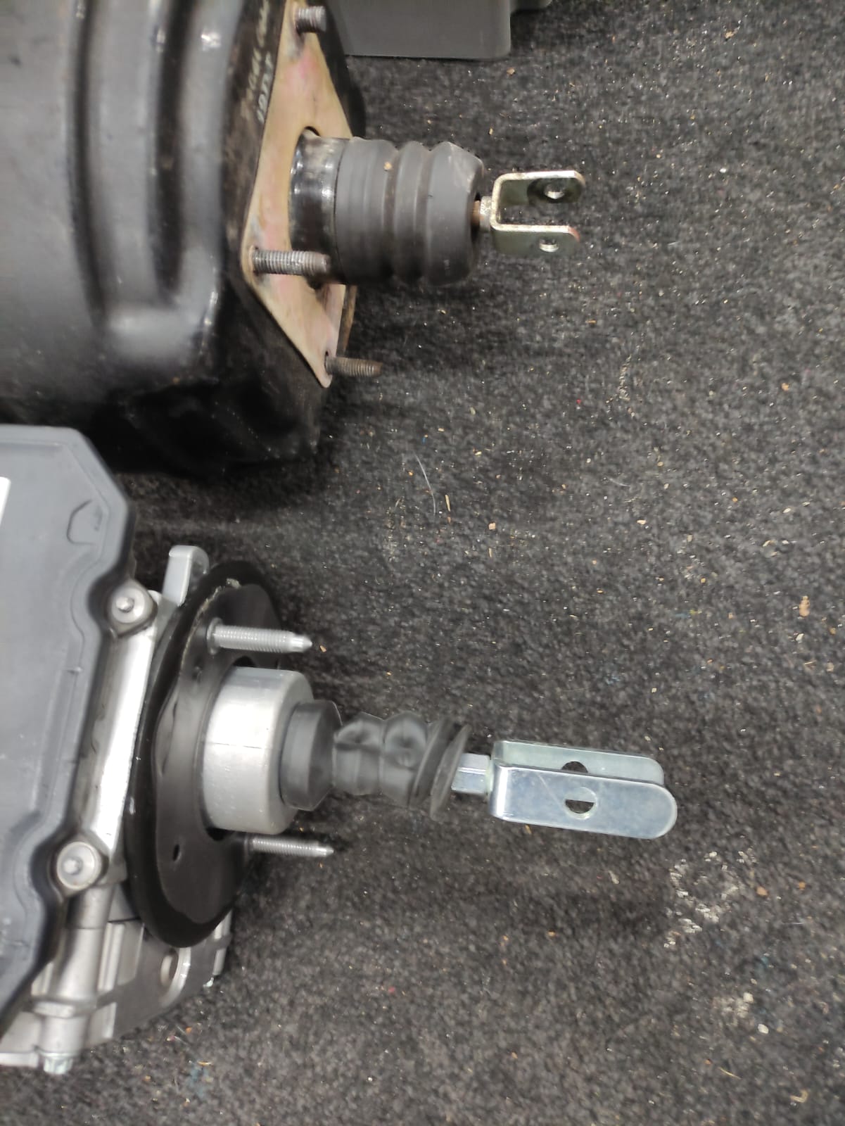

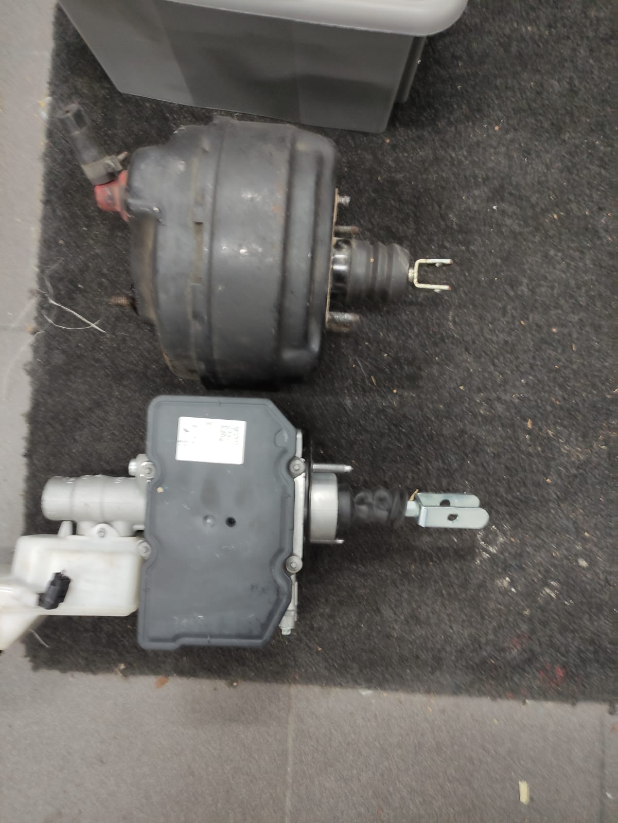

I bought the new Jaguar brake booster but, the Pushrod to pedal is too long. Now, I should swap the original one with the new one but I have no idea how to open this 😃
Post by DVD3500 »
Is there space under the hood/bonnet to use spacers to move the whole cylinder back a bit?
Post by Tachopis »
Although I don't have the hood installed, there is space above. The problem is behind and underneath, where the wheel arch is. I'll check it carefully.
Post by Uppertown »
Have you looked at Lar's web site? Lots of useful information on the I-booster
https://www.evcreate.com/installing-the-ibooster/
See this too from Greg;
viewtopic.php?p=50084#p50084
Tachopis
Posts: 55
Joined: Mon May 08, 2023 5:35 pm
Has thanked: 5 times
Been thanked: 13 times
Post by Tachopis »
Thanks, yes I actually took the info of the part from him, very great blog. And Greg is also aware of the part I have. I just have to figure out how to reduce this Pushrod.

Other option will be use other booster :) a smaller one

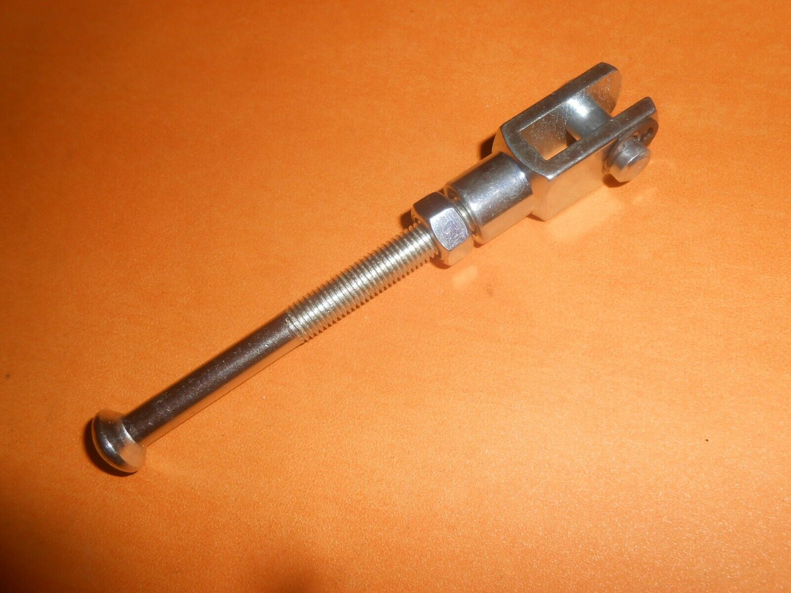

Post by Uppertown »
Tachopis wrote: Tue Dec 10, 2024 2:44 pm Thanks, yes I actually took the info of the part from him, very great blog. And Greg is also aware of the part I have. I just have to figure out how to reduce this Pushrod.
The push rod should look somewhat like this;
just unscrew the clevis Cut off the amount you need ( you might have to thread a bit more of the rod) then screw the clevis back on. Adjust the length until you need to depress the brake pedal very slightly before the clevis pin will go in to ensure the master cylinder piston can fully return. Before you plumb it in check the cylinder runs out of travel before the pedal.
Post by Tachopis »
Great, thanks I will try that. Probably I will change the clevis for the old one if fits. I will keep posted my progress. Thanks again ;)
