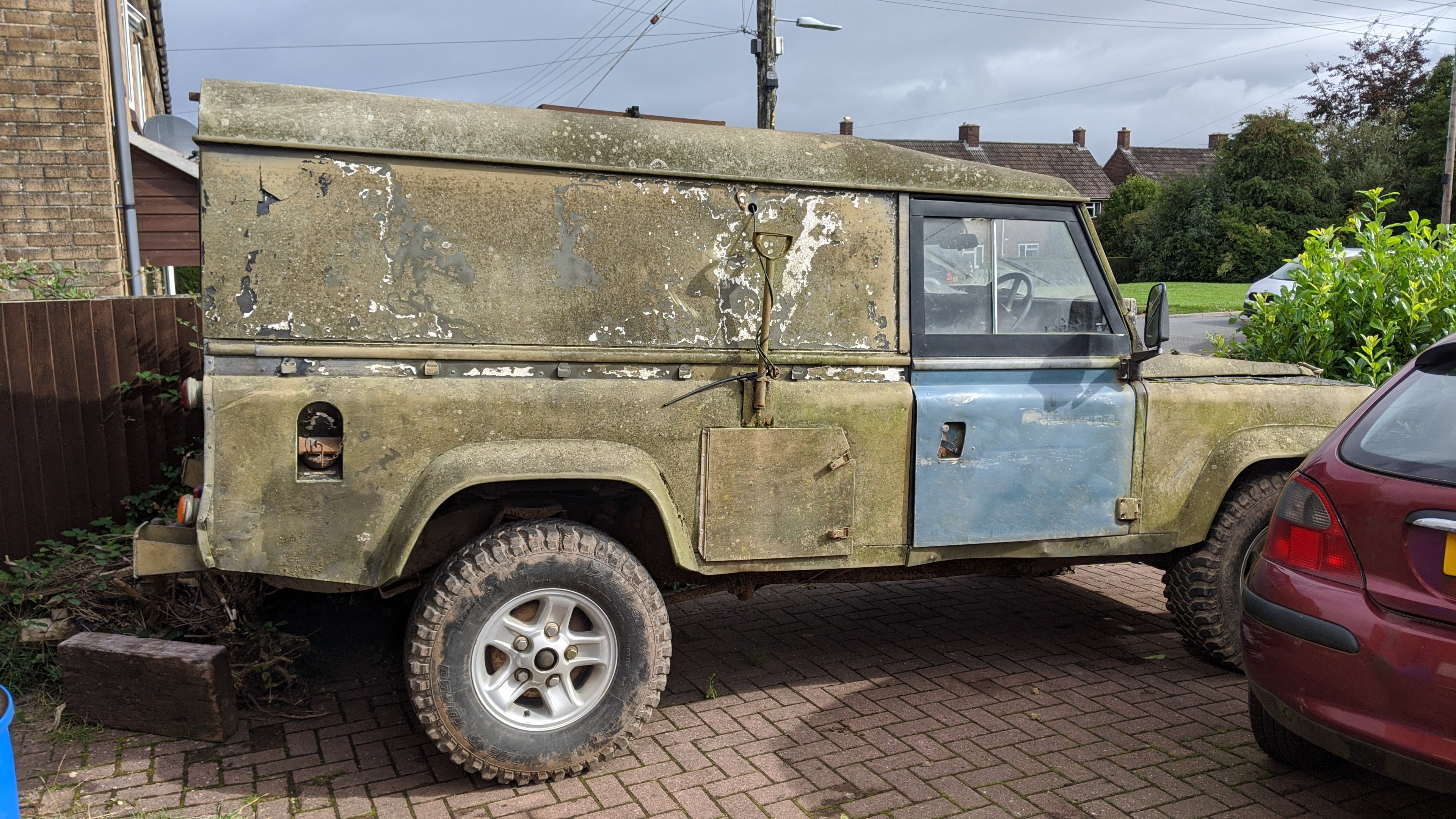

This was pretty much an impulse purchase in the middle of Covid way back in 2020, I was still half way through the MG so had no intention of doing an EV conversion to this. Originally I was going to transplant in an L series Diesel engine from the Rover 25 you can see in the side of one photo, then do the NC500.
It had been sat in a wood for two years previously, but started up and was cannonballed home (luckily only a few miles). I managed to get it through an MOT with only a bit of welding to the rear crossmember and some new spring turrets. It also needed a bit of rewiring just to get it functioning again.

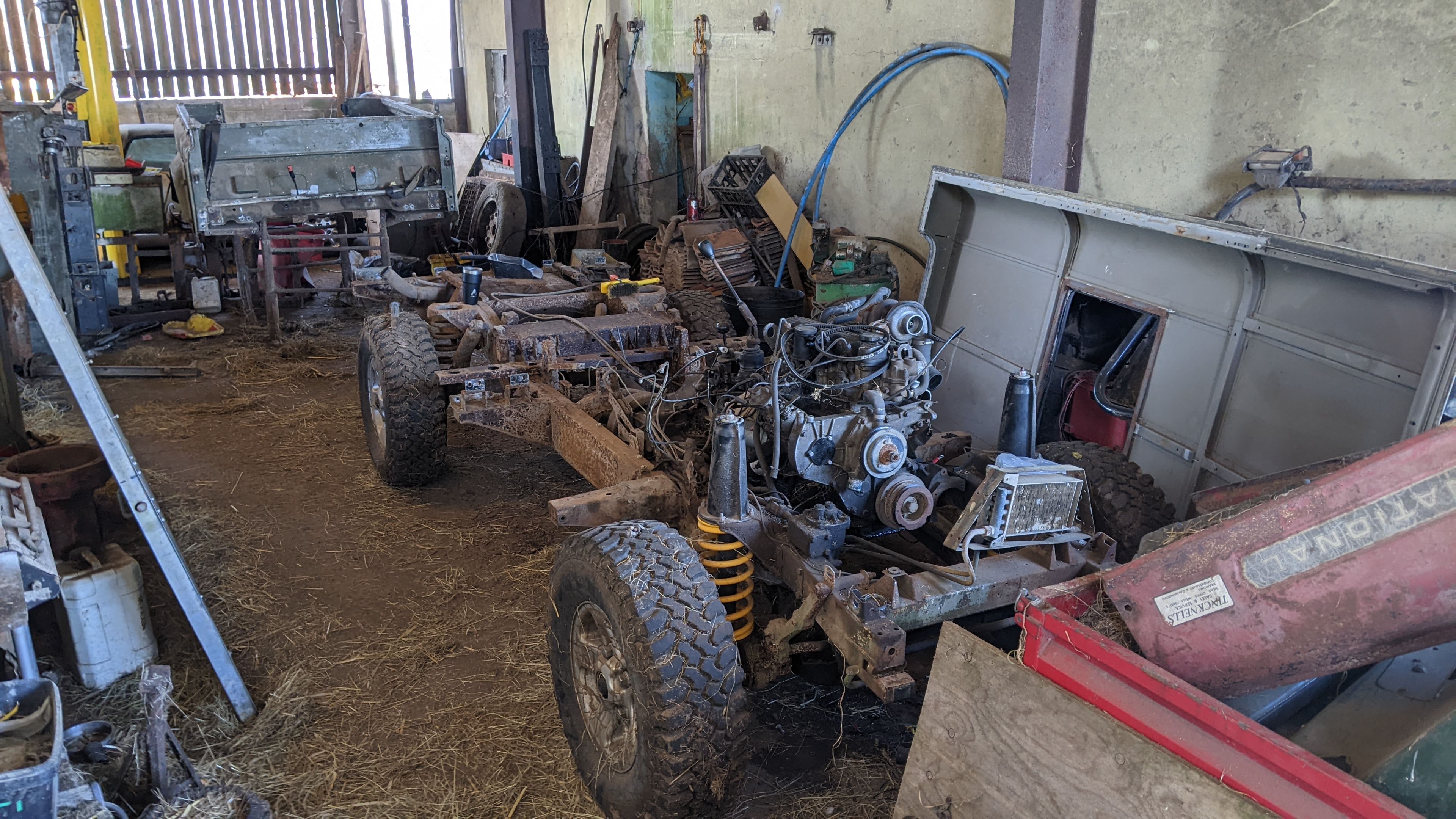

I didn't drive it for long before storing it at the farm. In 2022 I made a start stripping it down for a nut and bolt rebuild. Still intending to ICE swap it and just make bits of progress when the EV conversions were waiting for parts etc. This was when the chip shortage was still in effect.
This above photo is the rough plan I have for the aesthetics. I want to go with a sort of Mad Max/beach buggy look. With a roll cage, bikini soft top and the option to push the windscreen down. Obviously this is the ideal setup for the UK weather. I haven't decided if I want to keep the original patina or nato desert brown paint.
I have some ideas for a bit of decoration down the sides of the chassis rails, I have the military records of this vehicles so I was thinking regimental cap badges where this was used down one side and then maybe something to represent the three civilian owners down the other. Not sure about this though.
This is the stage where I left in back in 2022, last year I sold the engine and bought chassis repair parts. Now it's covered in the usual farm accumulation. Last year I also made the decision to just skip the ICE swap and convert it to electric.

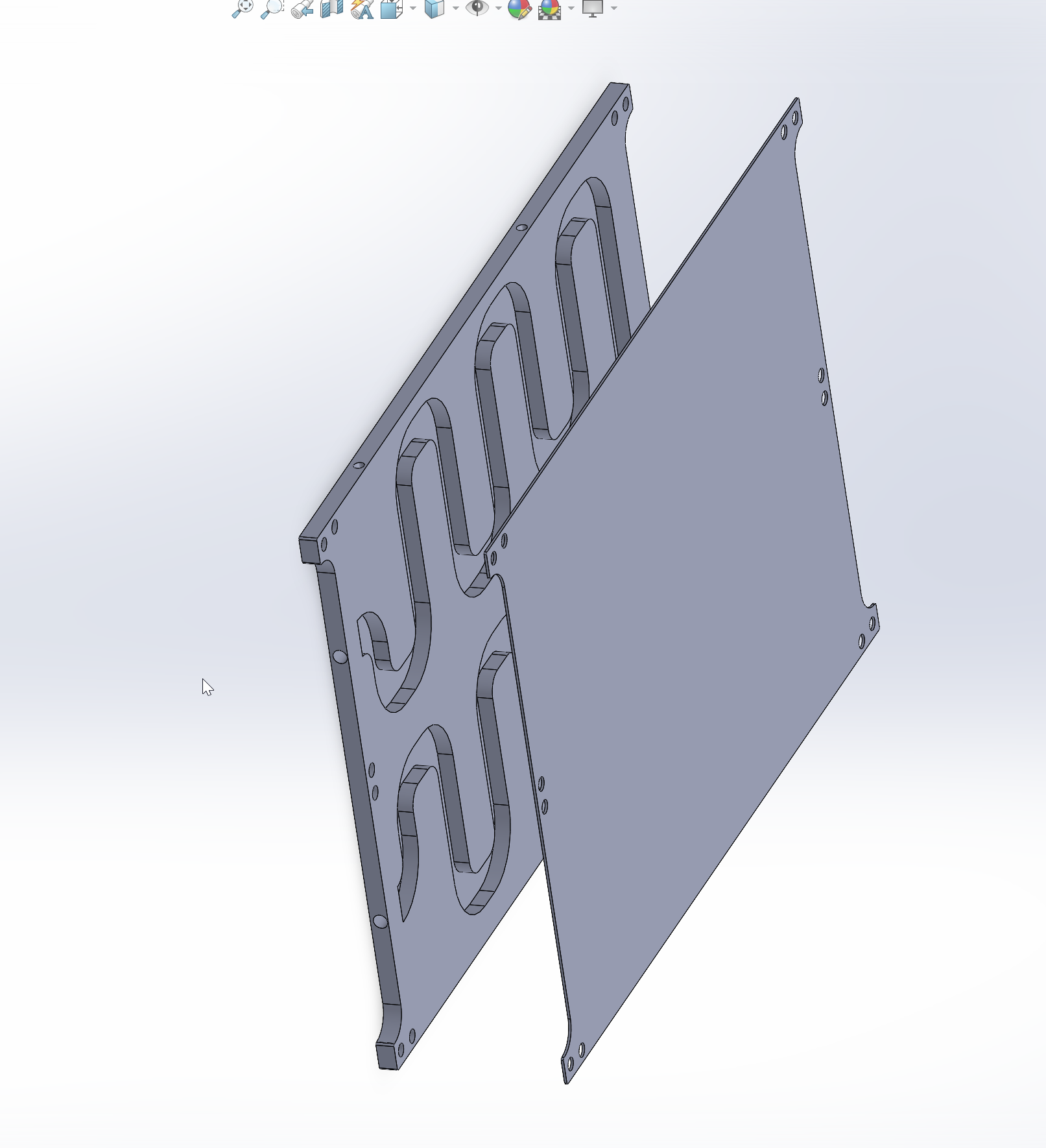

rstevens81 wrote: Wed Feb 28, 2024 7:45 am coolplates are defo a unicorn item for diy because of their cost
I'll post a screen shot of the design later on, It's a big plate of aluminium with machined out spaces for pipework to be pressed in. Each plate can support 4 modules, two each side. So I'll only need two for the whole box. Less plates also means less coolant connections and potential for leaks. I'm hoping the cost of manufacture won't be too prohibitive.

Re: cooling plates, one thought I had was aluminium sheet sandwiching a 3d printed piece with channels for coolant. Might be a cheapish DIY option

This is where I am currently with the chill plates. holes for bolting in four modules, plus some extra tabs on the end with a couple tapped holes along the side to aid with securing.
Currently with a lid, perhaps it could be secured by a ton of counter sunk screws to the main plate and sealed with silicone. Not 100% keen on this idea.
If I get them manufactured there is potential for stir welding them on, might have to buy quite a few for that but it could work.

What might work would be underfloor heating pipe ... Cut a groove in the al heatsink, this can be done with a router with ali

rstevens81 wrote: Wed Feb 28, 2024 10:20 pm What might work would be underfloor heating pipe ... Cut a groove in the al heatsink, this can be done with a router with ali
Yeah this is something I'd also considered, you just need to find a panel of the right dimensions for your battery.

LRBen wrote: Wed Feb 28, 2024 5:40 pm This is where I am currently with the chill plates. holes for bolting in four modules, plus some extra tabs on the end with a couple tapped holes along the side to aid with securing.
My idea was to simply cut a straight passage where one cell would lie and then add an obstacle on the inside to obstruct the flow somewhat, to swirl the water. Two plates in sandwich with countersunk screws still apply. I am thinki9ng on how to do this by simple method of jigsaw and metal blade with lots of WD40. In the past i have proven it can be done with 8mm plate. Outside plates need to be at least 5mm for even thickness and eventual welding of the end pipes. This is the only part i cant do alone. An expert should do it not to overheat and bnd the plate. It must keep the seal.
Or if you have professional help you can cut channels in a 10mm plate with an O ring channel all around it and single 5mm plate on the top.

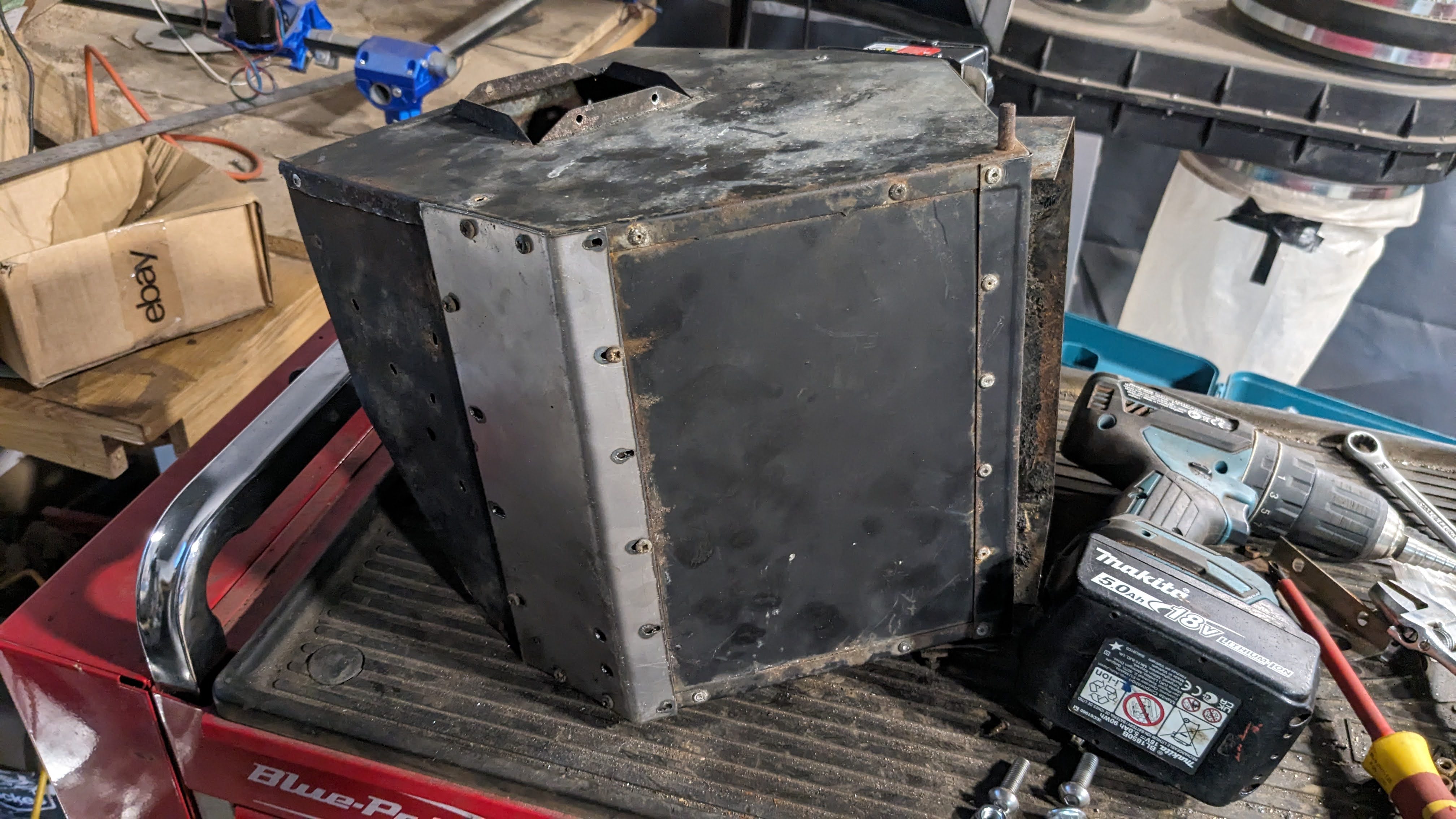

I also stripped down the heater box, the HV PTC matrix from an ID3 fits perfectly in this box, the matrix is bigger than the original so it might actually be able to throw out some decent heat. I'm also upgrading the blower motor with the fan unit from my old Rover 45, it's a bit beefier and moves noticeably more air. I'm also taking the controls from the Rover as well, so the Defender will have a decent fan speed control for a change.

It's good to know that the ID3 PTC fits into the heater box! Can you share the controls?

marlinarnz wrote: Tue Apr 23, 2024 5:09 pm It's good to know that the ID3 PTC fits into the heater box! Can you share the controls?
Haven't gotten as far as controls yet. I am due to take some logs from an ID3 in the next few months though. So that should open up ID3 PTC heaters and AC compressors for everyone once the reverse engineering is done. By that I mean that Tom91 will probably be doing all the hard work and it will end up on a Zombie release in the distant future.
I did get a chance to try the heater box on the bulkhead and I think I will have to mount it slightly lower than originally so the top of the matrix doesn't hit the bonnet lip on the bulkhead. So not completely bolt in but it's pretty close.

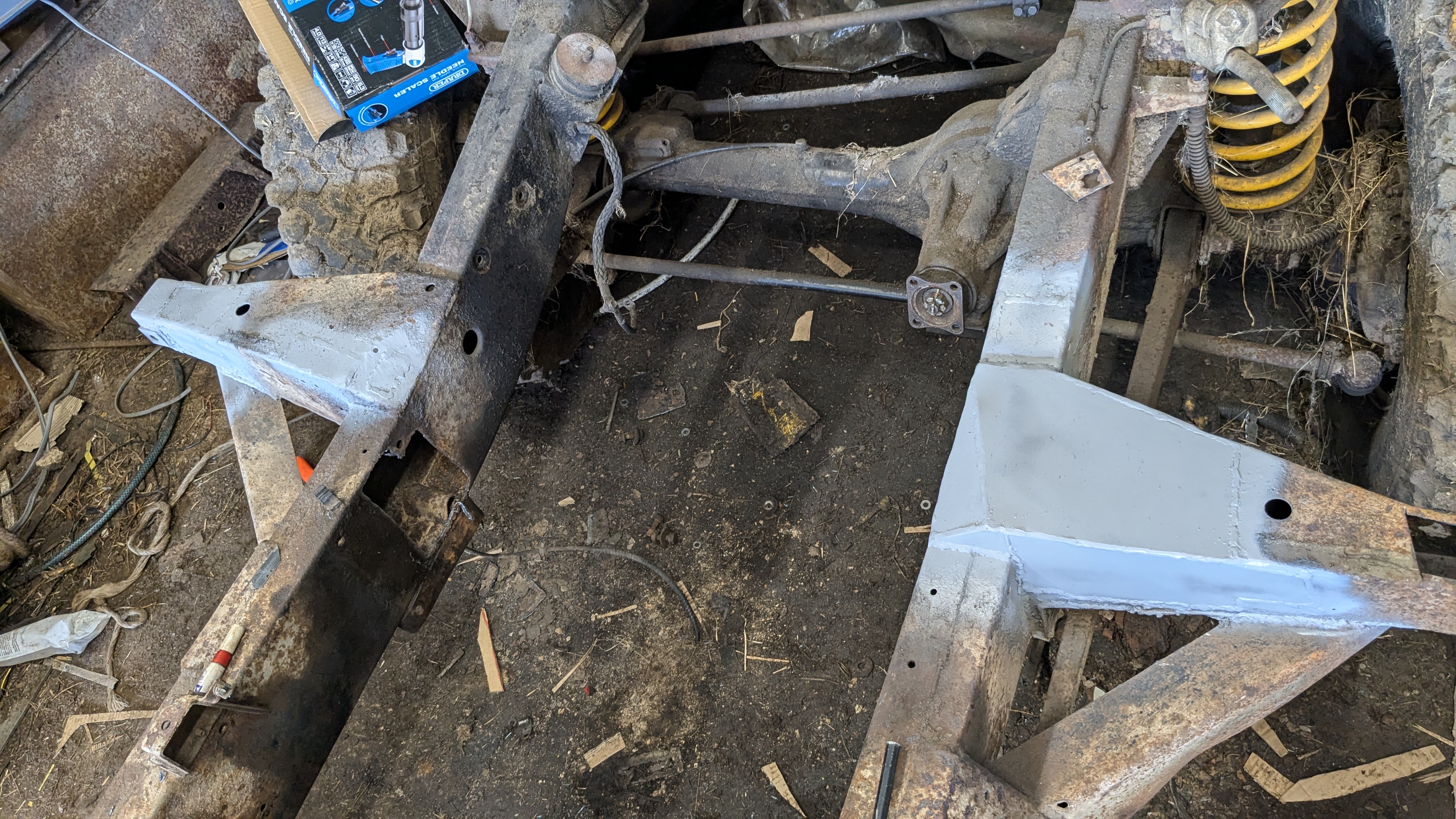

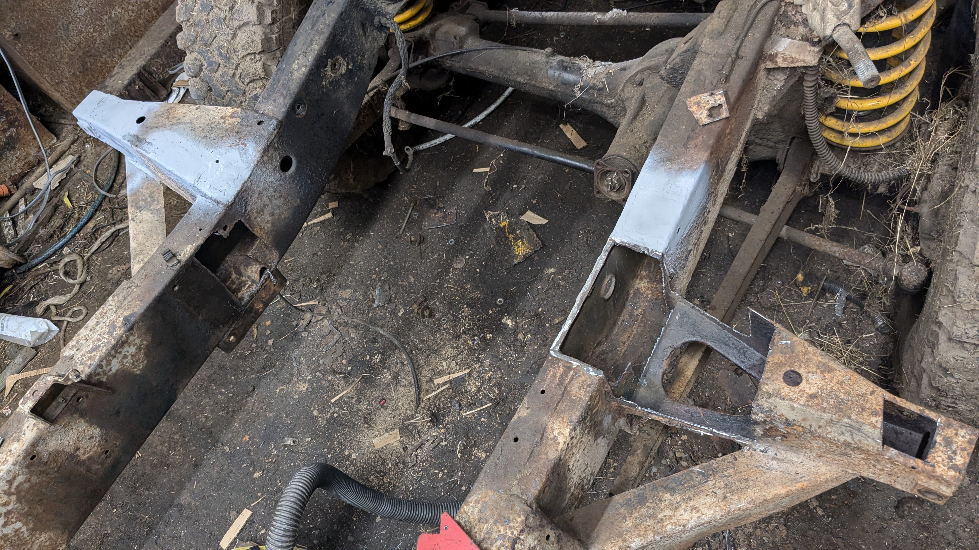

Lots of rust, lots of cutting, lots of welding. Still more rust.
Started to use my plasma cutter for this project and it's made things a bit quicker and slightly more pleasant than constantly filling the air with grinding dust.
Finished with what I thought was the last of the big repairs and was just expecting some patching. However the rear tub outriggers are pretty far gone so I think I will cut those off and weld on new ones. The bulkhead outriggers are also quite bad but have rusted in places that I can patch up. I also found a botched repair hiding under the gearbox cross member.

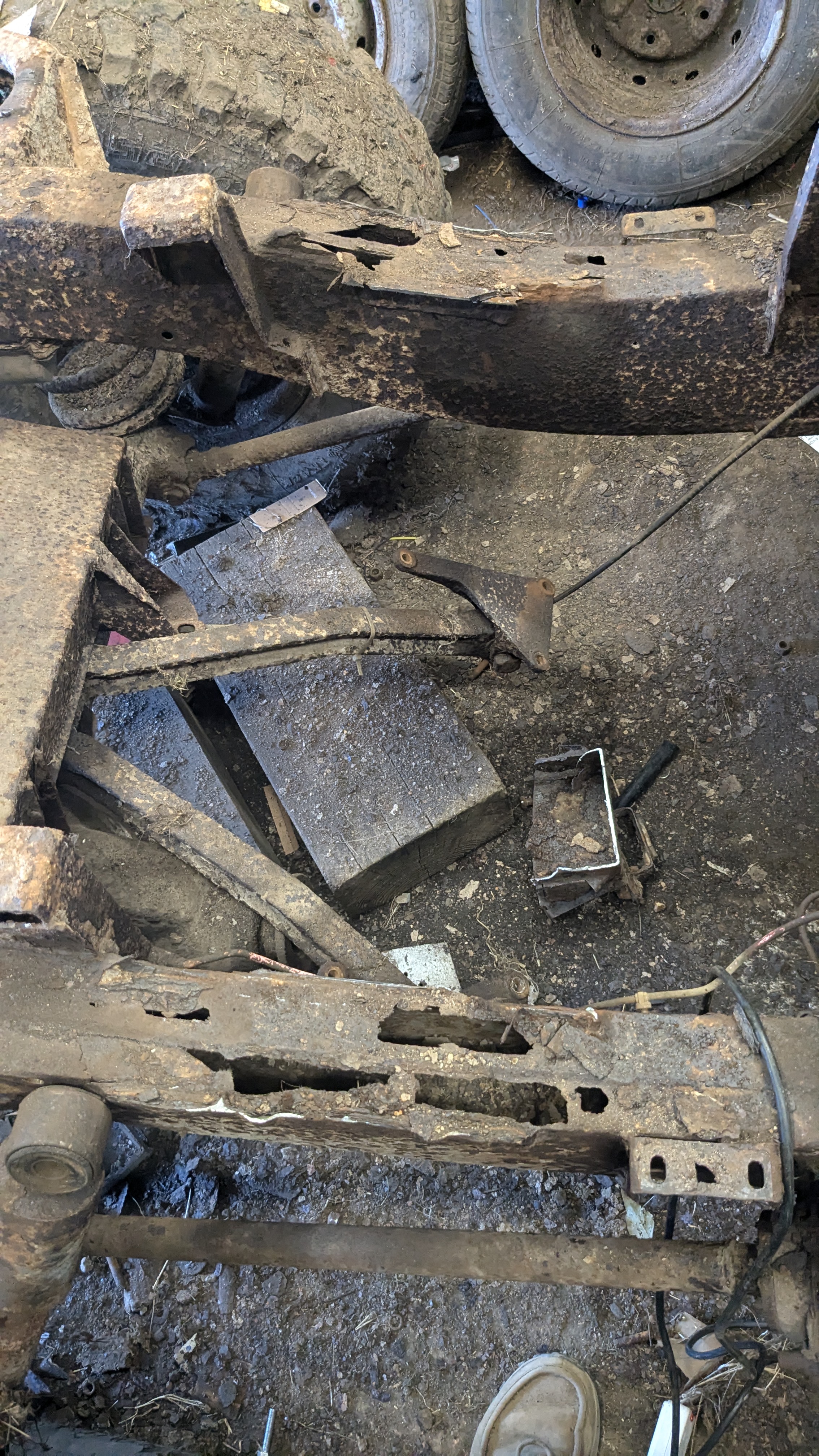

Lots of welding done this month. Rebuilt the bulkhead outriggers, replaced the rear body outriggers, a few more patches done.
I also striped the rest of the chassis parts off so the next step in restoration is to take the chassis of the axles, flip it over and then do a tiny bit more welding of course.

So a tiny bit more welding turned into a tiny bit more. Got it sand blasted and we found a little bit more rust.
All done now though, only took 2 replacement outriggers, 2 new crossmembers and 0.5 square meters of sheet steel for patches.
Taking it for a final sandblast and powder coat on Friday. Then I'll spray the internals fulls of Lanoguard.
