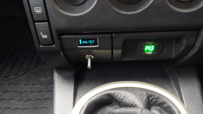

Hm... why not use a relay instead of that switch? Of course you would start relay with PP connected to GND.

Re: [Driving] Freelander EV With Gen1 Leaf electrics and EVBMW VCU
Good question!
I should have mentioned in the video that the switch was already there for a different purpose but was no longer needed, so when I realised the issue with the pump it was an easy way to stop it. I need to do more work on automating charge start and stop along with tidying up the LV junction box so that is on the long (and strangely growing) list of things to do.

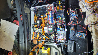

So today I managed to pretty much complete the LV junction box and get the car working again (spinning the motor while in neutral and charging). I made a couple of minor errors with the location of some wires but they were easily sorted and no harm done. Before connecting the battery properly I hooked it up through a 12V bulb to confirm there were no shorts.
In the photo below you can see how I've tried to tidy things up a bit with the fuse holders. As it turned out I'd have been better off with 3 smaller 6 or 8 way fuse boxes than two 12 way as I had to resort to Wagos for wires going to ignition position 1 but it is still much neater than before.
I have been documenting every wire as they were connected so hopefully when I go back to add stuff or make changes it will be a lot easier.
Then to see what would happen I connected the heater up and Woo Hoo, we have heat! Nice warm air coming through the vents with the heater on. Now I need to route the controller through the bulkhead and mount it in the cabin.

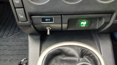

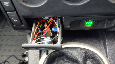

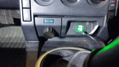

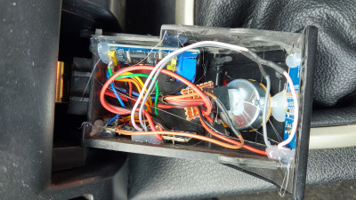

This is a copy and paste from the Outlander heater thread.
Here is a quick update of the heater situation now I have it installed.
It works!
The longer version includes a minor disaster and a change in design.

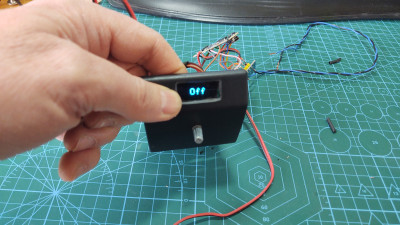

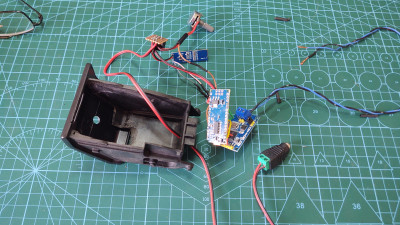

While testing I managed to drop some solder on the board while it was running. This caused the operation to be somewhat sub-optimal so after first replacing the MCP2515 I then had to replace the Arduino and of course it was no longer soldered to the vero board.
Originally I had planned to mount the board under the bonnet and feed wires through to the dash but while staring at the new pile of wires I had an idea.
OK so neat it isn't but this was more a proof of concept than a final installation. In order to tweak the code I will need to remove the Arduino as I didn't give myself enough room to plug in a cable but that can wait a bit. I have plenty of other things to work at in the meantime.
Jamie/TurboPete's code works great however in my application I might need to adjust the temperature difference before the heater switches to half power. It looks like it switches to half power while around 10°C below requested temp. This means if I request 55°C it only gets to around 50°C which is not quite enough. I find myself turning it up to 61 or 62°C to get the desired 55°C.
I assume this will change as we get into late Spring so for now I am keeping the adjustment and code as is. I have a second ash tray that I can use if I decide to use Arber333's code without a POT.

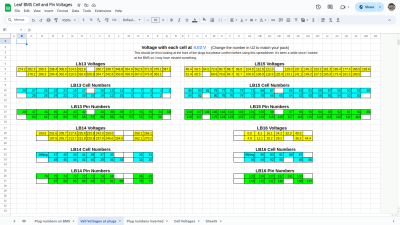

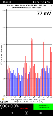

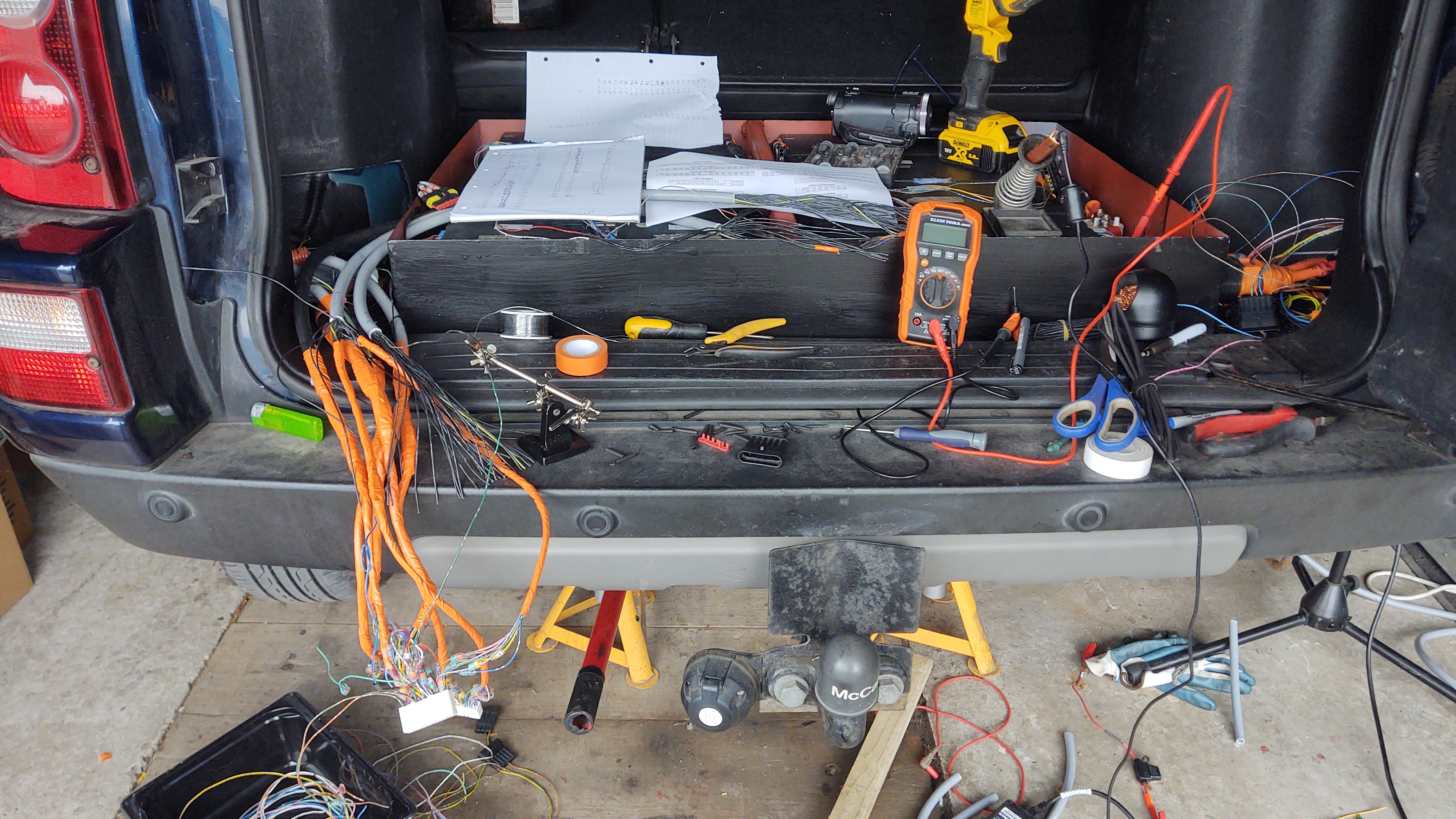

The last few days I've been struggling to get my head around the BMS again. Although it probably won't be able be able to keep the pack balanced it's a good idea to have it working as I can use a simple Bluetooth dongle and App called LeafSpy to monitor the voltages of each cell. Having the BMS working means I'll be able to see if any cells are out of balance and if necessary I can intervene manually. I really should have had it sorted months ago but I knew it was going to be a pain so kept putting it off. I had it connected and working a couple of years ago on the bench but that was with all the modules in one place. Now I have some in the front, some in the fuel tank area and some in the boot so it's not so simple.
During the week I spent several evenings working on it and then pretty much the entire day yesterday soldering testing, pulling apart and resoldering cause I messed up.
This was the mess I was in earlier.
After many cockups, a few poor decisions and some generally dodgy workmanship I think I have it sorted.
Some time ago I made up a spreadsheet to give me the expected voltage at every connection for any given cell voltage. I was able to test all the voltages and even discovered a fault in the spreadsheet so today I'll sort out a 12V supply for the BMS, hook up the CAN leads and hopefully see the condition of the battery pack.
My confusion was caused by the numbering convention by Nissan, they count the most positive cell as cell 1 and most negative as cell 96. The lowest number cell in the boot is 41 so I started there when I should have started at 96. I figured trying to meter and count the voltage from cell 96 to 41 would be too complicated so I metered from the most positive end and managed to confuse myself completely. Eventually I dug out the spreadsheet and once I had this in front of me it all started to make sense.
I got the connection numbers from the Nissan Leaf service manual and it worked before so I'm confident it is correct but another complication is at cell 48. There is an extra negative connection for cell 48 because the BMS is galvanically isolated between cells 48 and 49, to protect it from stray current drain when the HV service disconnect is pulled. Basically if this was not there the BMS would be shorting out the HV service disconnect, thereby maintaining the HV circuit, This would not only be dangerous but if there were a stray power drain it would melt the BMS.
My service disconnect and contactors break the pack at cell 41/42 so I have to try and figure out a way to ensure the BMS is never connected when the contactors are open. I'll probably use a relay to make/break the connection to cell 49 and ensure it is only ever active while the car is in drive mode.
Has anyone ever tried this before? I had heard I am likely to cook the BMS with the battery layout I'm using but I don't have much choice as moving battery modules to the front of the car is not an option without a LOT of work.

You could move the "negative" contactor between 48 and 49 and move positive and precharge to the end of the pack. Don't break between 41 and 42, by Murphys law this can and will go wrong
Alibro
- Posts: 1112
- Location: Northern Ireland
- Has thanked: 504 times
- Been thanked: 323 times
That's a great idea thanks. I already have two contactors in the rear battery box breaking the neg and pos as well as in the HV junction box so it should just a matter of reconnecting the neg.
I was concerned there would be positive voltage on the cable and connector If I broke the pos and neg at 48 but it never occurred to put only the neg contactor in there.
Thanks again.

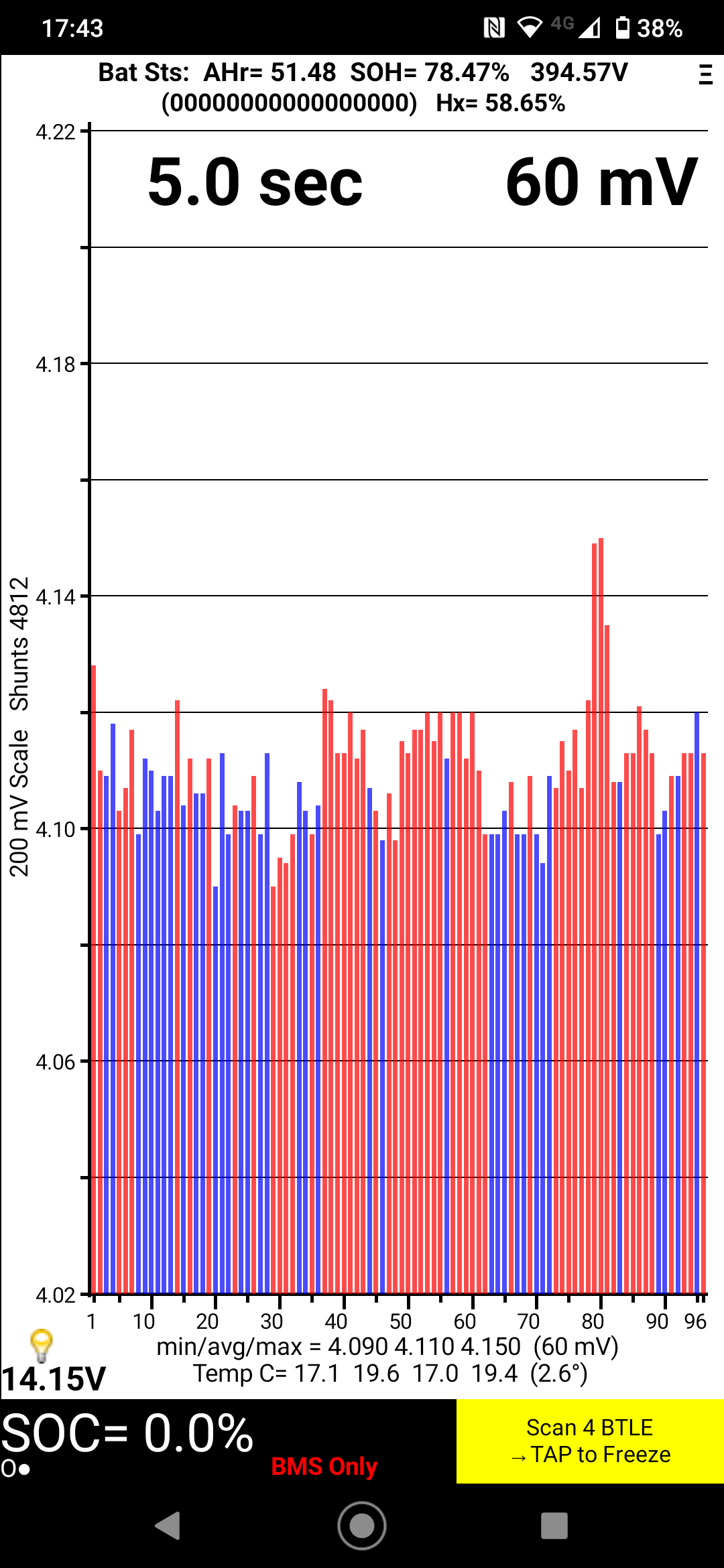

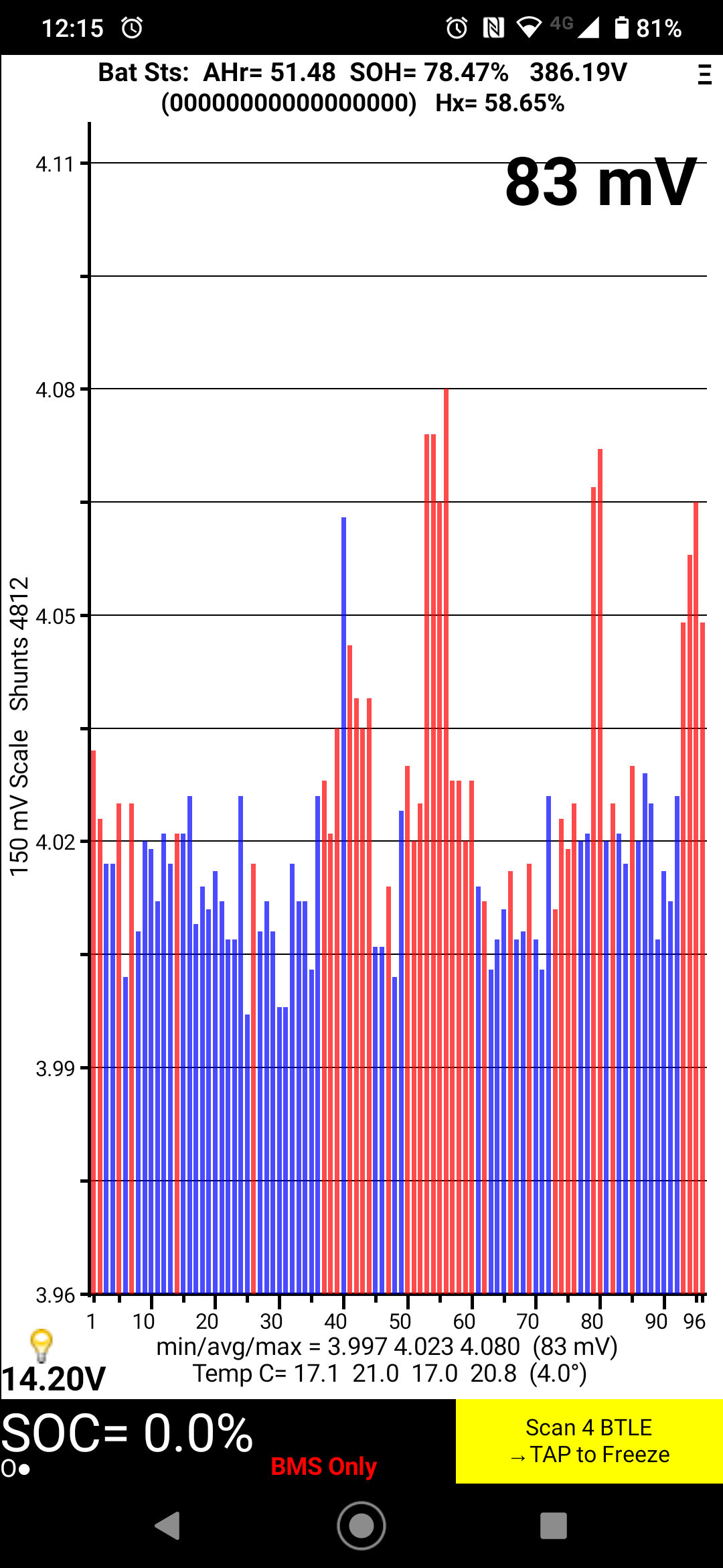

So good and bad news for the BMS.
The good news is it's working. I can see every cell and have been able to manually drain a few that were too high. They were maybe 40 or 50mV higher than average so not disastrous but bad enough to potentially do harm if the pack were fully charged as they could have been slightly over 4.2V. This is not a major issue so long as they don't drift higher and get really out of balance. I'm pretty certain that I've caught them in time.
The bad news is that with my pack layout the BMS can only be accurate at around 0A so I will need to disable it when driving or charging which is not ideal. This is due to the resistance of the contactors cable and fuse in the wrong position as far as the bms is concerned and the length of the cable. I think moving the neg contactor to between cells 48 and 49 will protect it from harm when the car is turned off but can't help when it is on. There should be almost zero resistance between all the cells and I have a measurable resistance between cells 40 and 41 due to a fuse, contactor, manual disconnect and around 5m of cable being between them.
I'll probably fit a switch somewhere to turn the BMS on and off when I want to check the pack but in the meantime I'll just pull the fuse for the BMS once I'm happy the pack is balanced.
This was the output from LeafSpy earlier (While charging) You can see cell 40 looks odd but this is because of the resistance in the cable etc.
Three of the modules are higher the the rest, two 4S and one 2S.
This is it while not charging so very little current and cell 40 is not so odd looking. The voltage of each cell in LeafSpy jumps around a lot so don't take these figures as 100% correct. Cell 95 was much better looking after I balanced the module it is in. And this is it now, I'm still draining the two highest cells with a buck converter set to 150mA so the two higher ones are not there yet.

So you are manually balancing the cells when needed..?
Maybe move the upper and lower limits a bit tighter to allow for more drift in the individual cell voltages?
With slight loss of range, but more peace of mind?

Yes mate, as far as I know the Leaf BMS balances with only 10mA so virtually nothing. I have been trying to drain 50mV from the two cell module using the BMS wires and after more than 10 hours it has hardly changed. I'm using a CC buck converter to draw 150mA so at 10mA the BMS wouldn't have much effect.
- JaniK
- Posts: 404
- Has thanked: 101 times
- Been thanked: 15 times
Oh, them BMS systems really don't hurry with the balancing it seems.

So the manual balancing helped a lot as the imbalance is now down to 40mV when fully charged and 30mV when mostly discharged. I don't know if that is good or bad but at least I now have a BMS so I can keep an eye on it and intervene if necessary.Alibro wrote: ↑Thu May 23, 2024 7:55 am Yes mate, as far as I know the Leaf BMS balances with only 10mA so virtually nothing. I have been trying to drain 50mV from the two cell module using the BMS wires and after more than 10 hours it has hardly changed. I'm using a CC buck converter to draw 150mA so at 10mA the BMS wouldn't have much effect.
