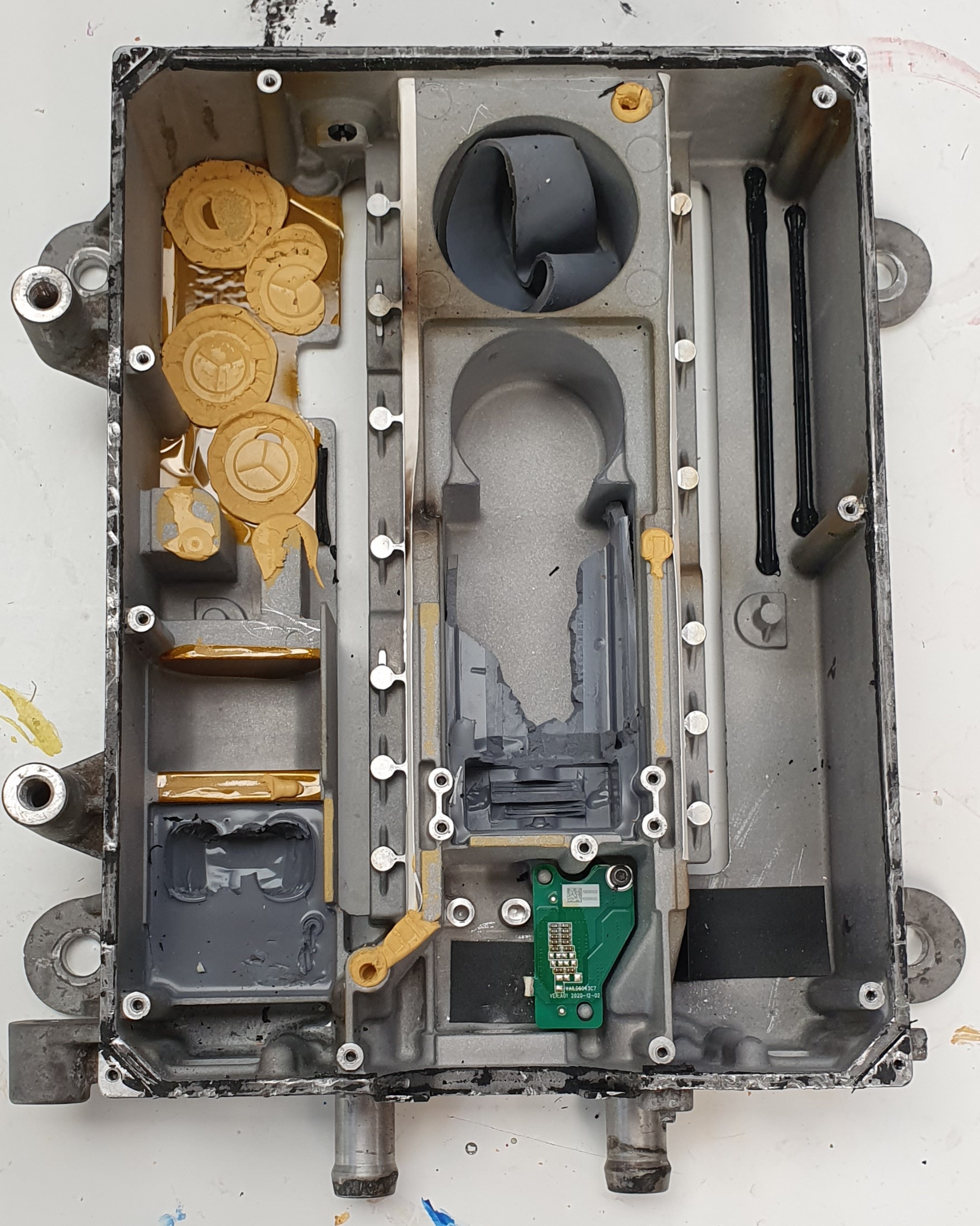

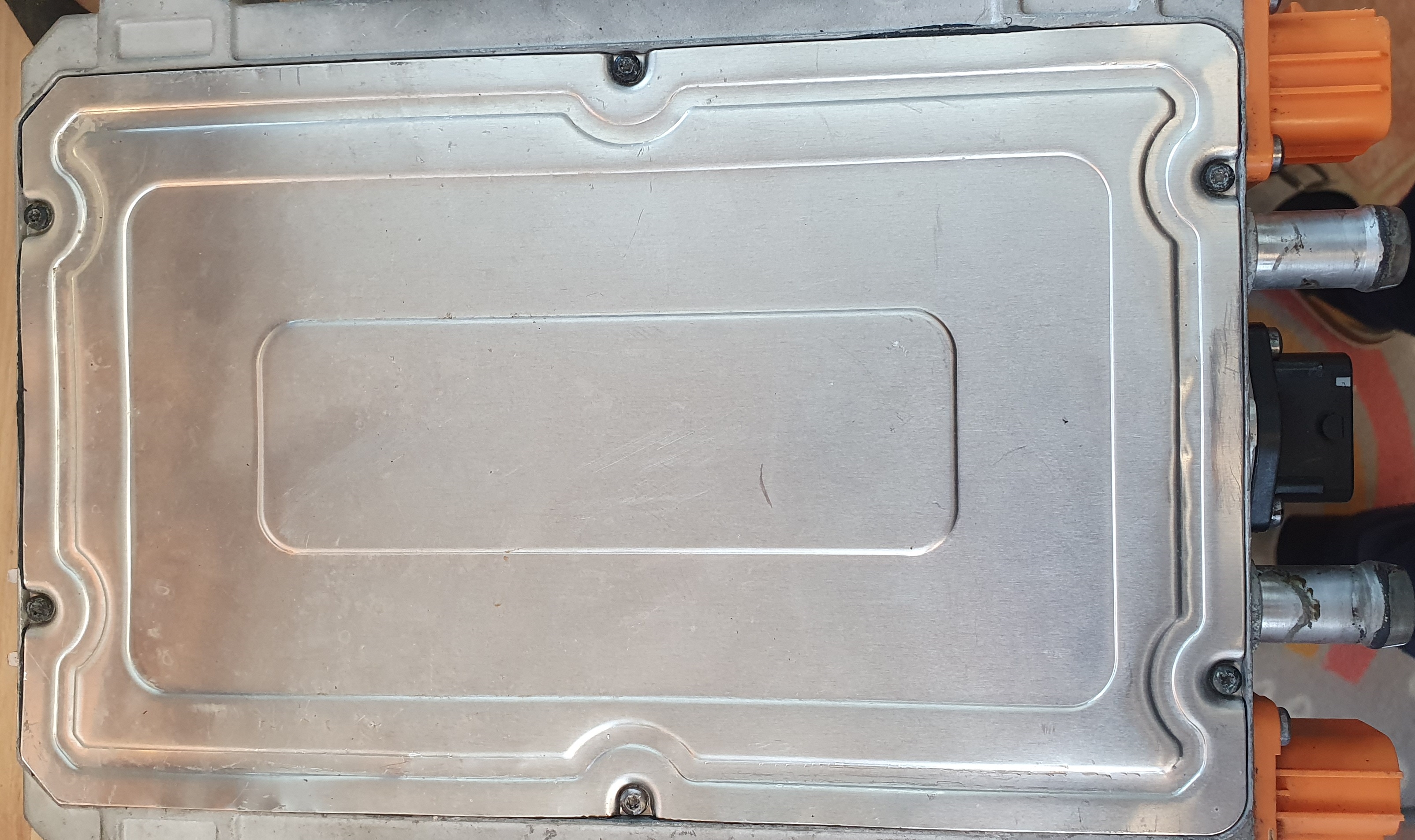

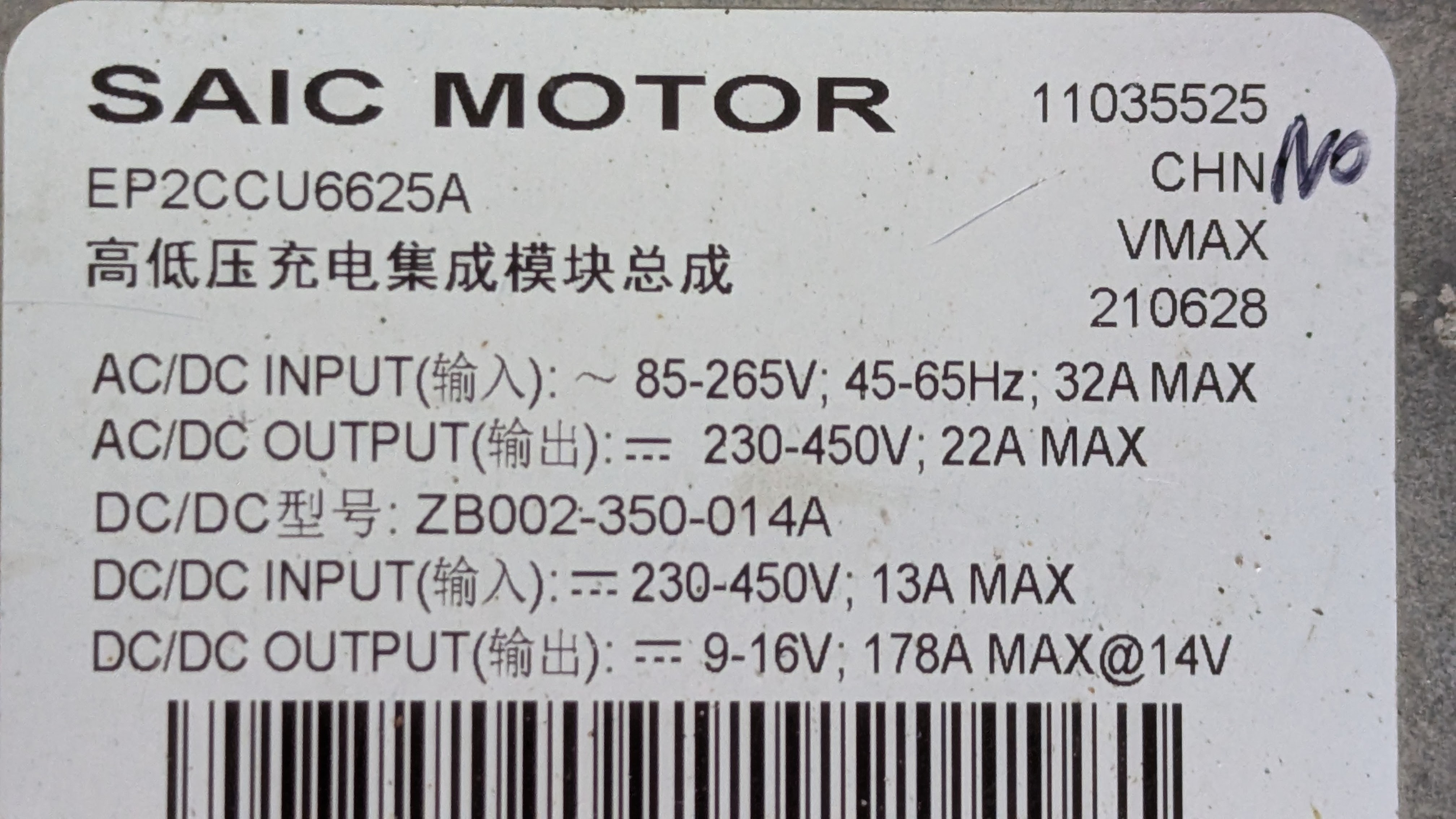

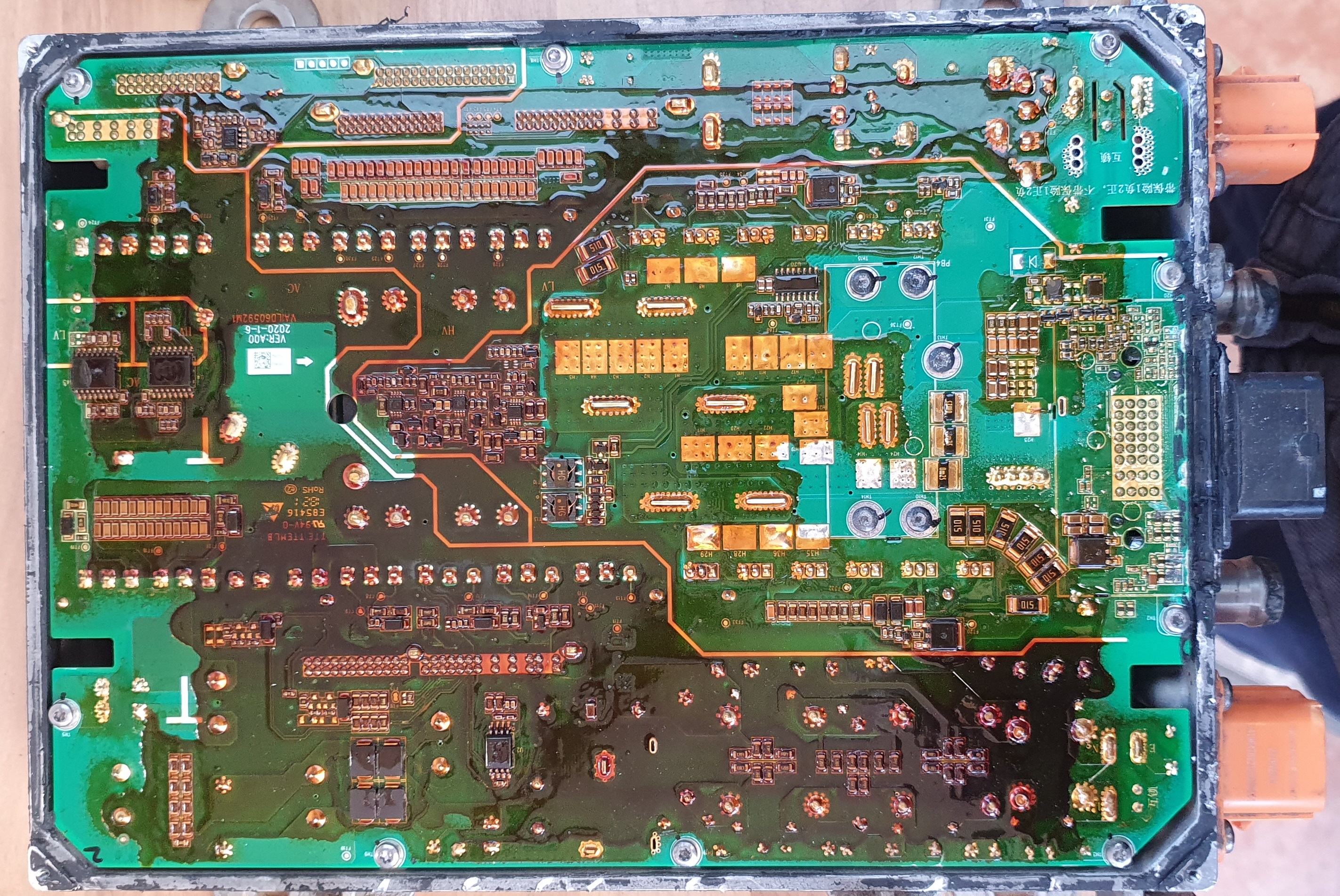

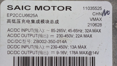

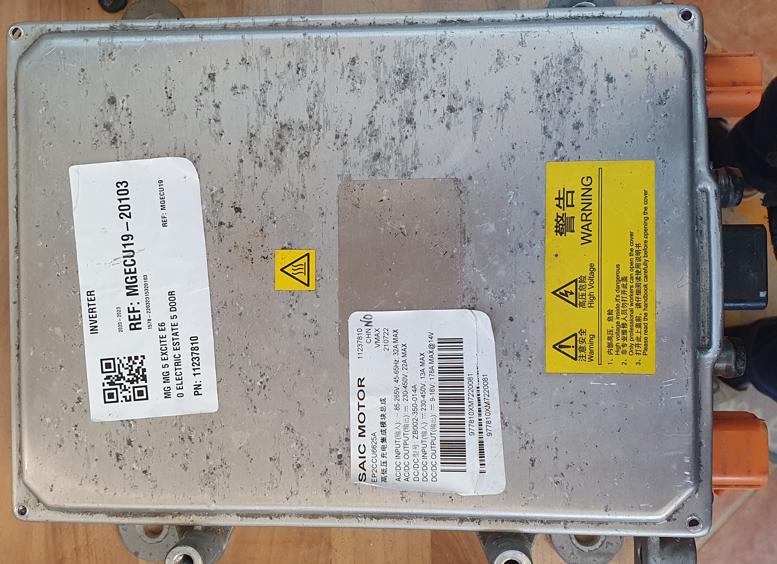

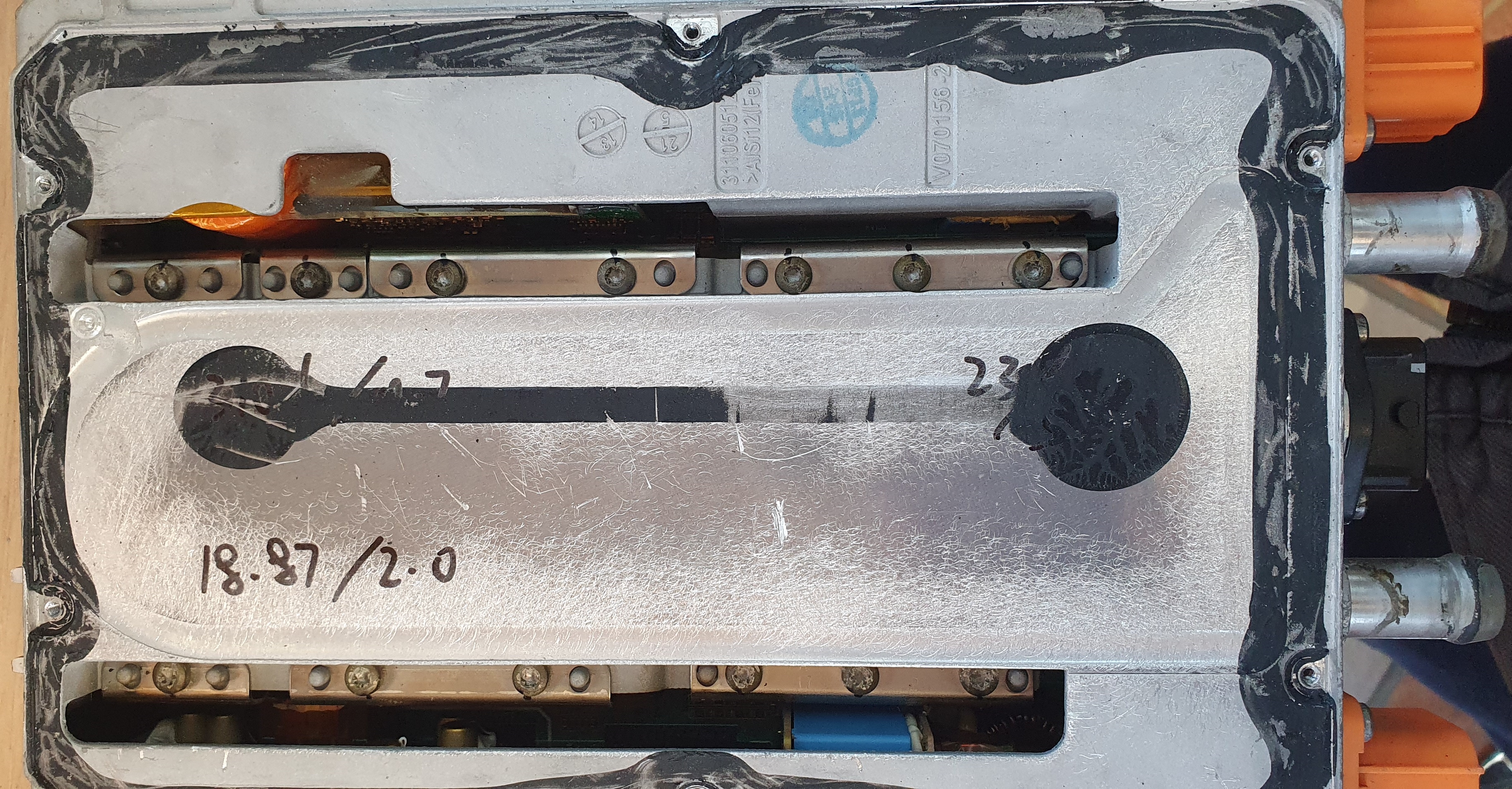

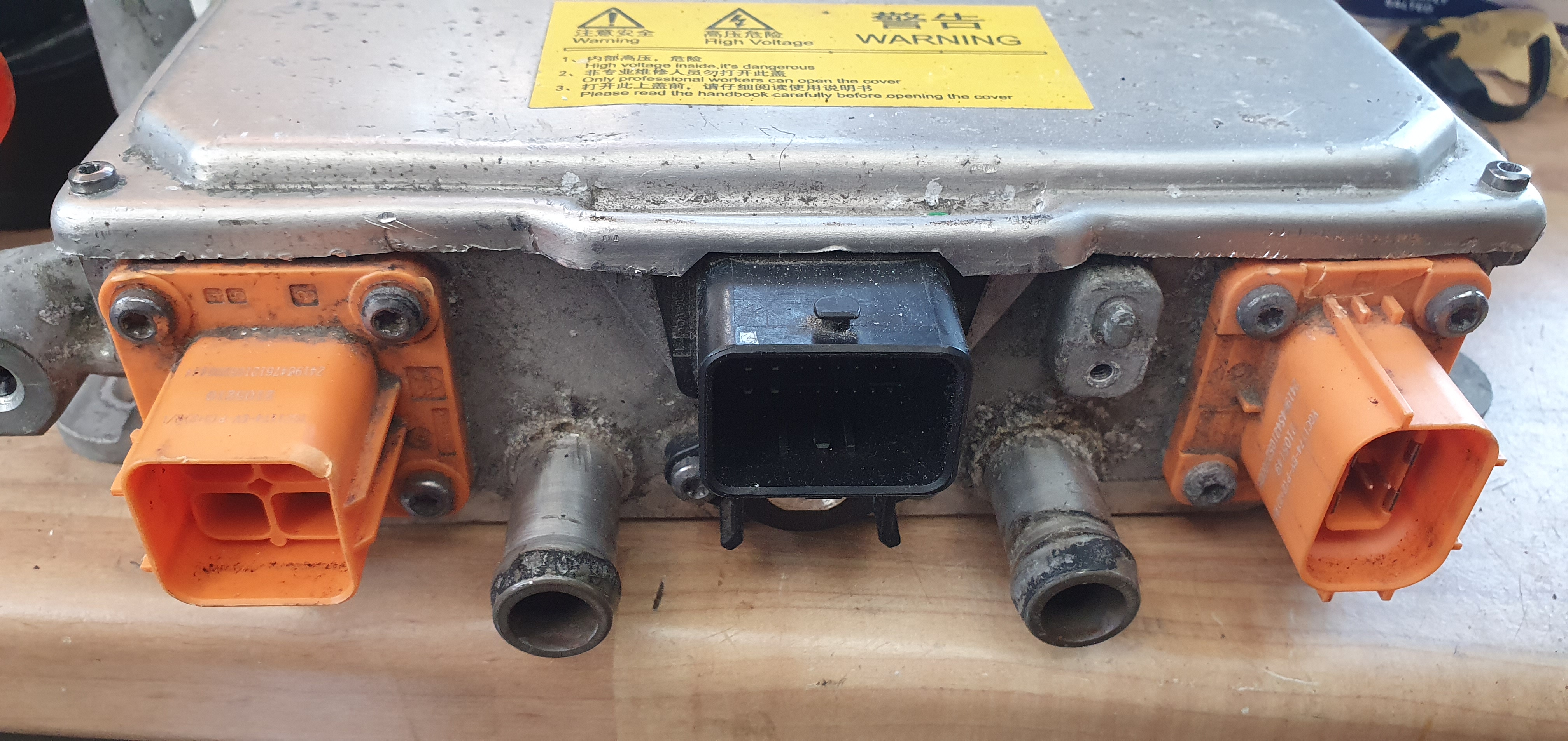

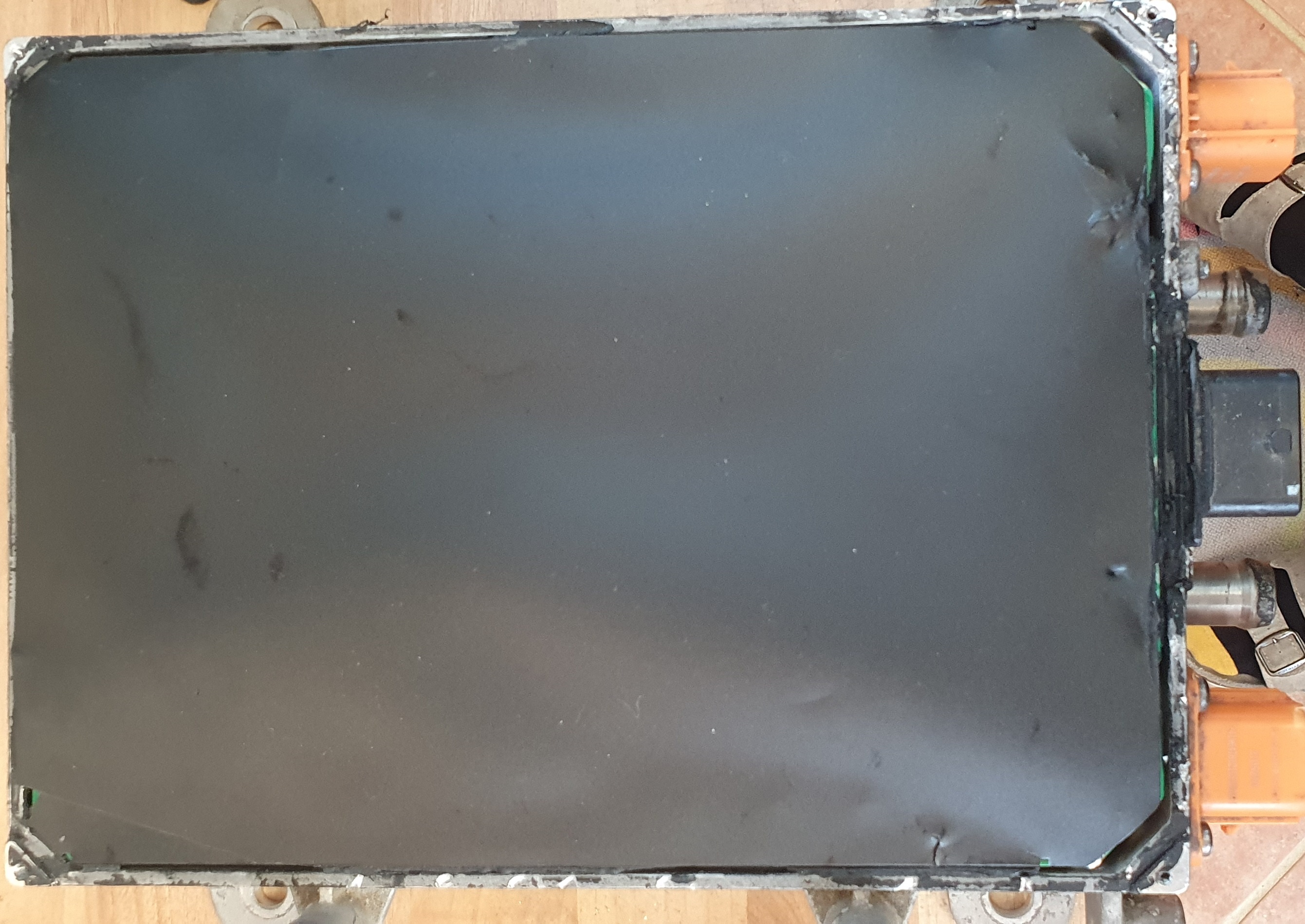

Hi All. I got my hand on "faulty" MG5 on board charger (EP2CCU6625A).
I did not have a way to tedt, so I decided to look inside 😉
Not the best idea ever, as due to the cover being glued on, it was hard work and i have damaged the unit a bit.
So I'm sharing info/pics, so you don't have to repeat my mistake;-)
Just need to upload the pictures...
Bit later I will try to test if any of the functions (charging/DC-DC/V2L) are still working.
Top with cover:
Top-less ;-)
Bottom with cover:
Bottom without cover:
Connector side:

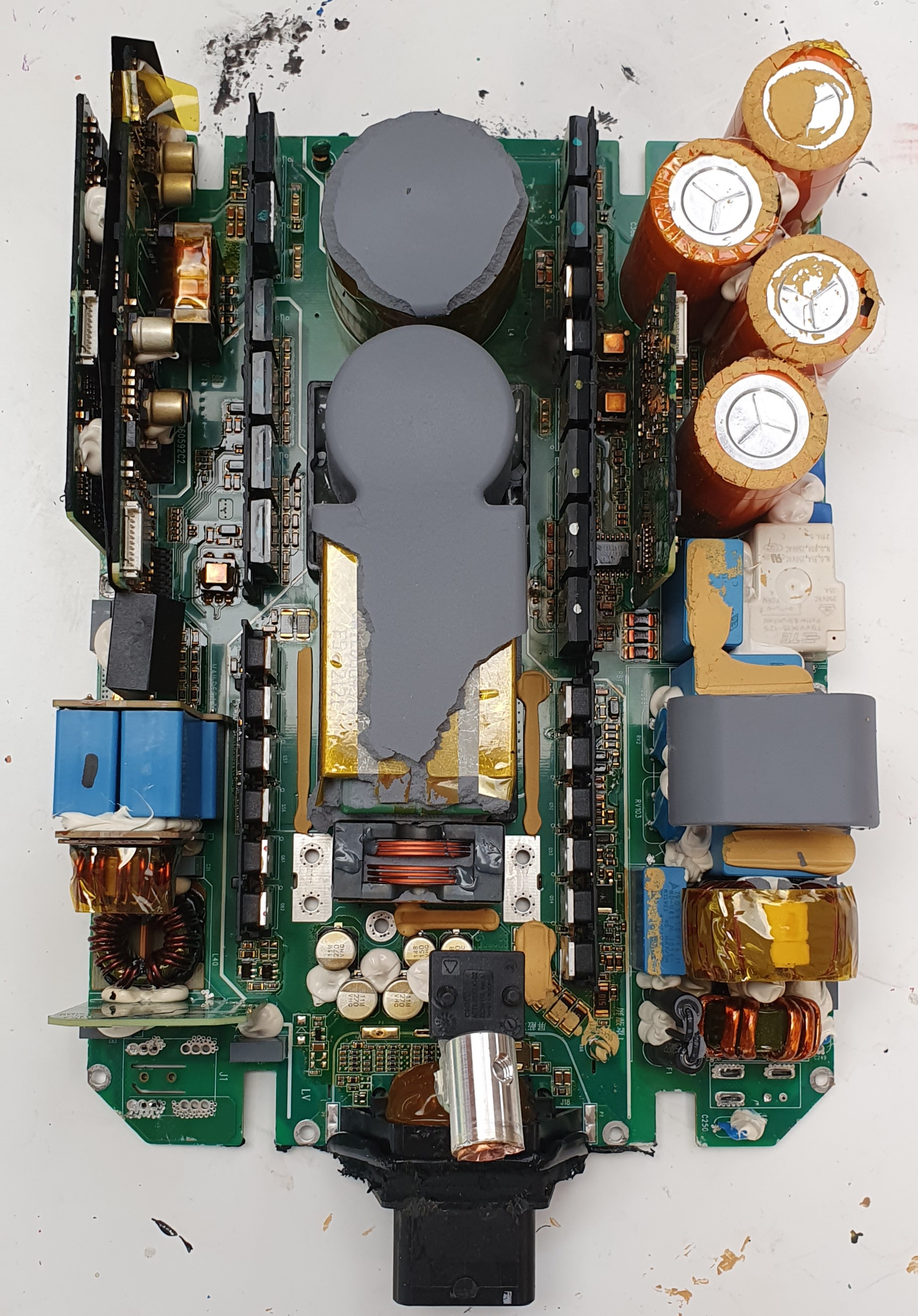

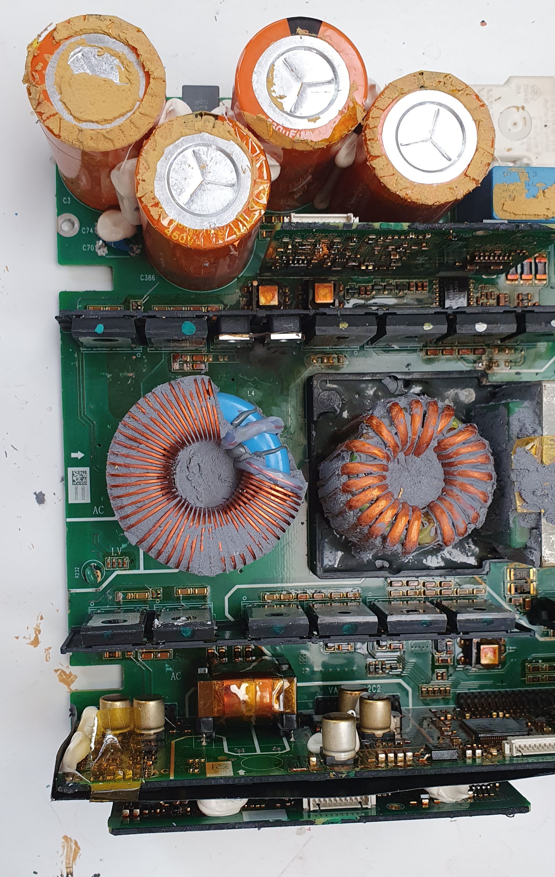

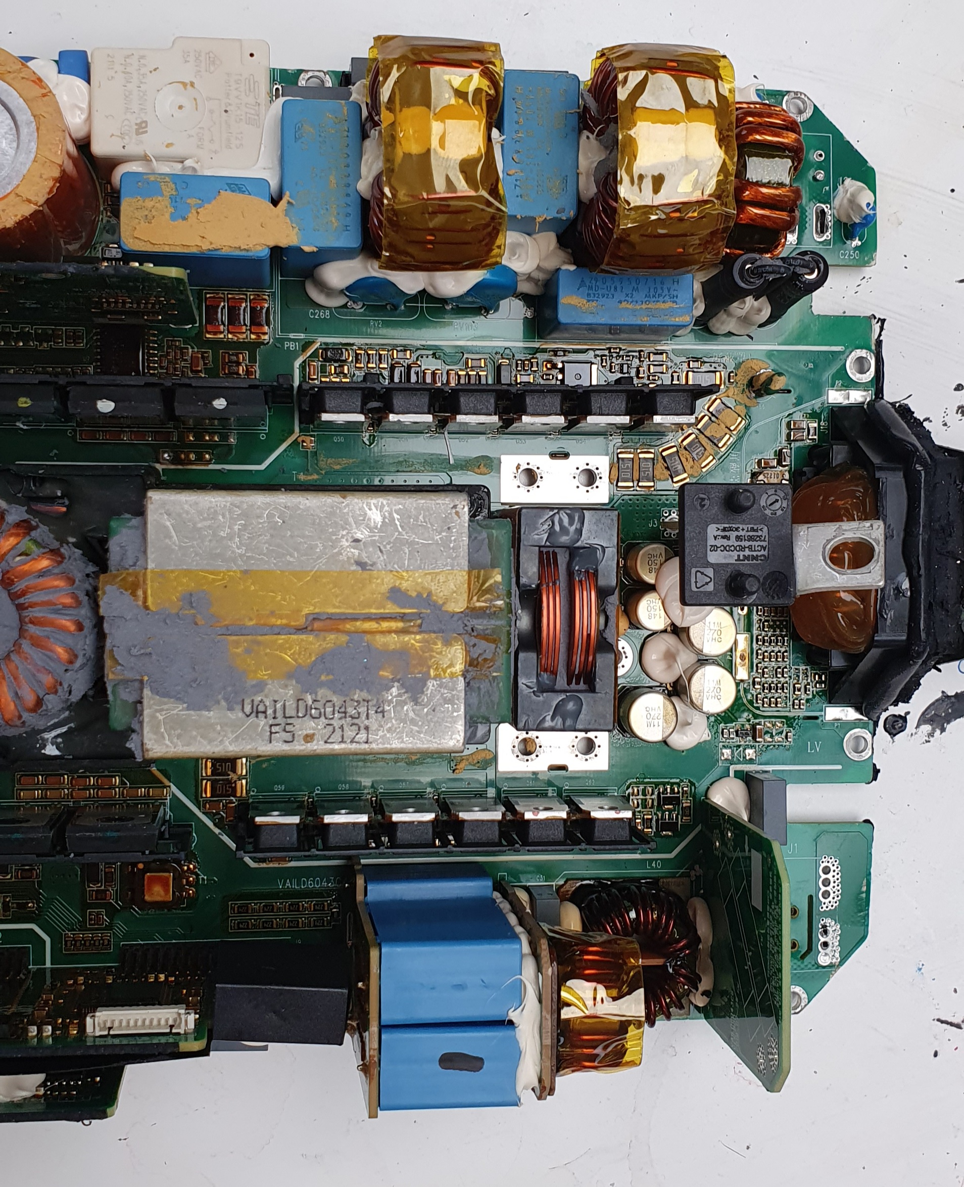

I have decided to take one unit completely apart(it's faulty for sure so..)..
So here are few more pictures..
And yes there is a burn mark next to one of the diodes I guess..
If anyone wants to see specific detail just let me know

Posts: 3796
Been thanked: 413 times
Re: Teardown MG MG5 combined charging init
Matoleno wrote: Mon Mar 25, 2024 12:38 pm Hi All. I got my hand on "faulty" MG5 on board charger (EP2CCU6625A).
Please provide dimensions to put on wiki....
