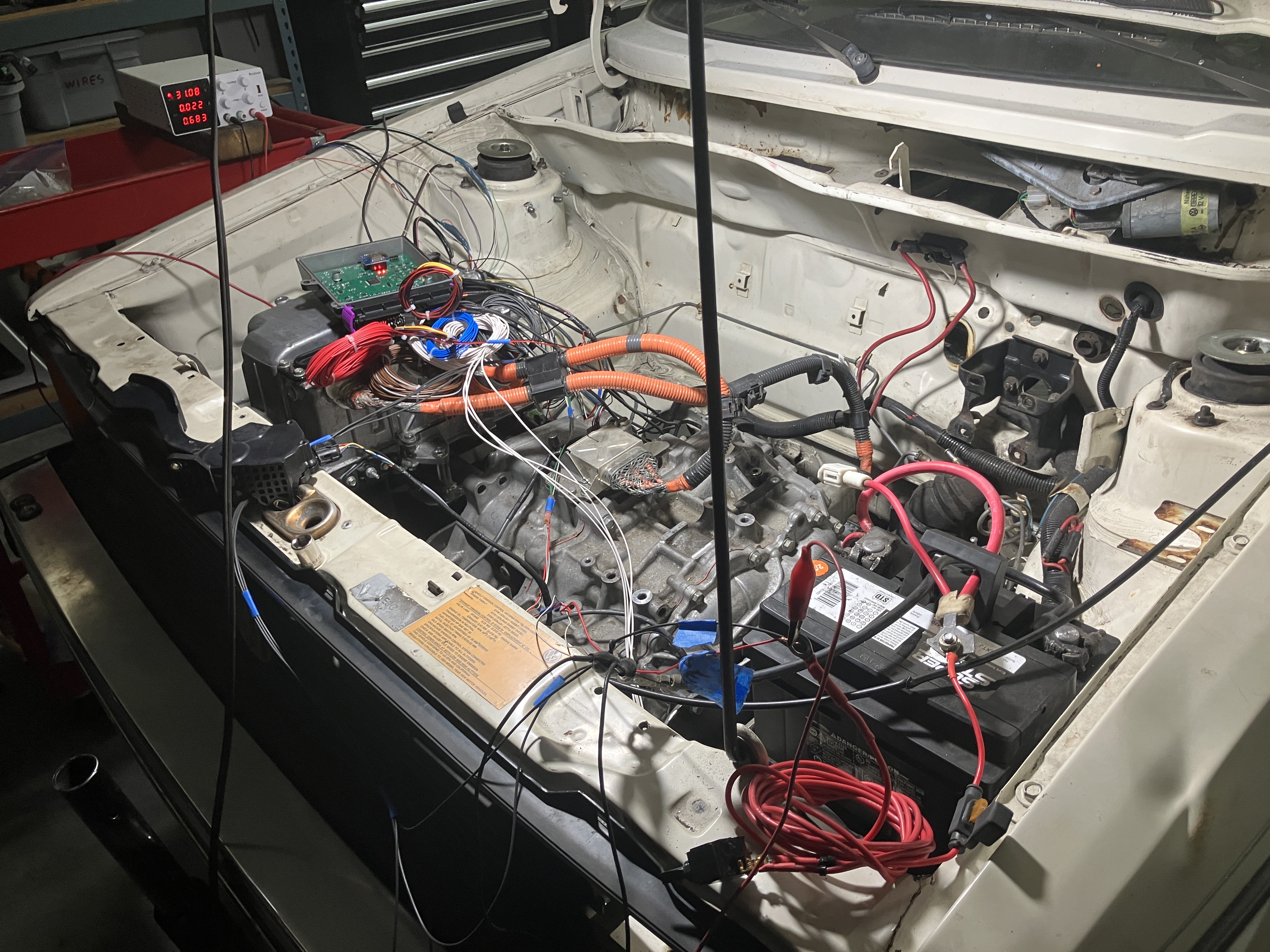

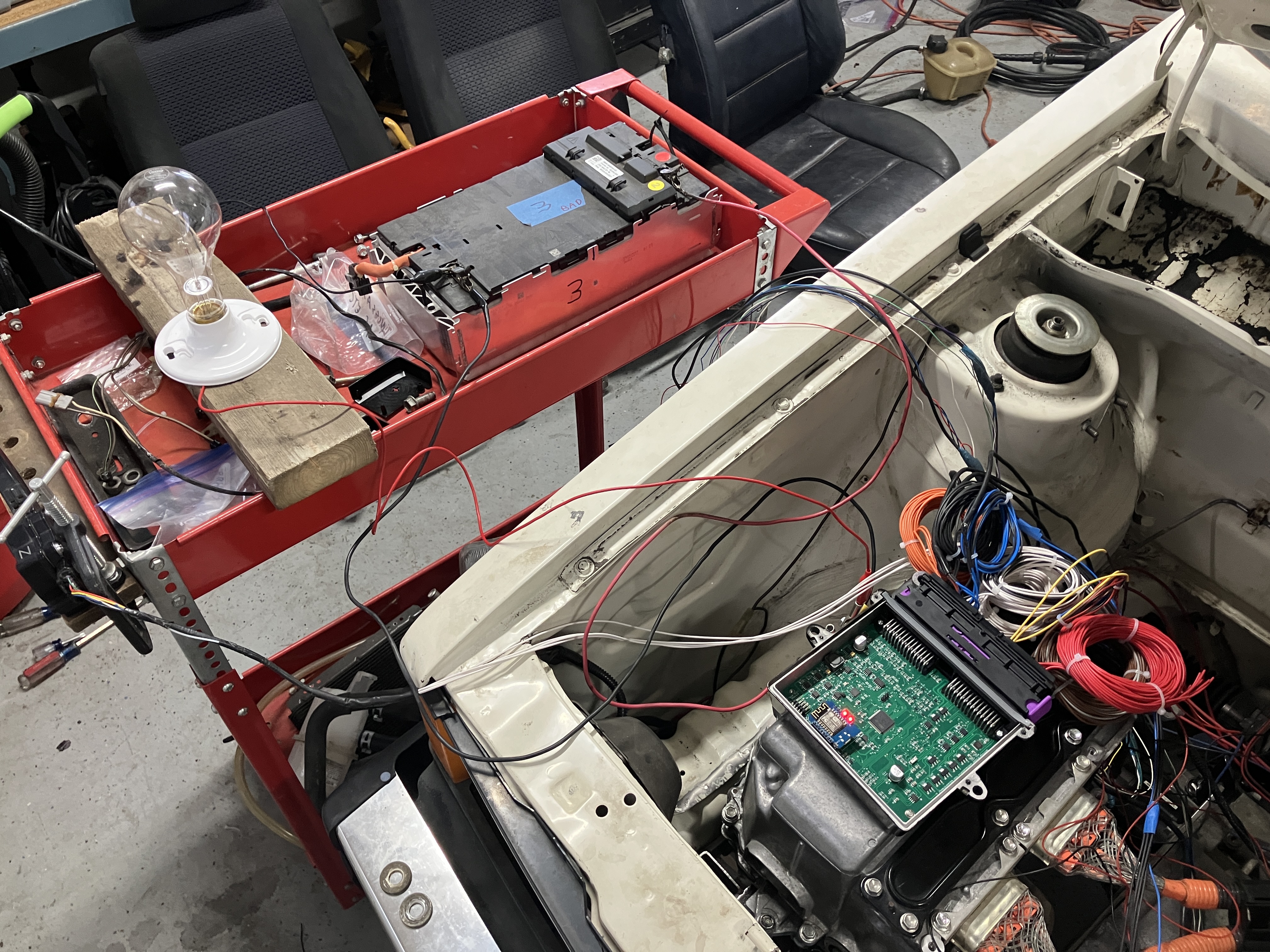

I would really appreciate your help trying to figure out what is making the clunky noise in this Gen 3 Prius P410 transaxle as I try and spin the motors for the first time. Damien informed me that the Zombie spins both MG1 and MG2. My power split device is NOT welded, the guts of the transaxle are 100% undisturbed and stock. Parking Pawl is NOT engaged, this has already been confirmed. (When engaged manually by hand the transaxle is locked and won't spin at all). By hand the output shafts spin in opposite directions in either the Parking Pawl locked or open positions.
I am able to spin both output shafts by hand in the same direction and it feels smoot, no noise, however I am doing this at a glacier speed compared to how fast the motors spin them electronically.
Transaxle and Inverter are from the same vehicle a 2010 Prius
VCU = ZombieVerter ver. 2.05A
Power Source = 300 watt, 30 volt, 10 amp bench power supply
I will provide more updates in additional posts this is just a call for help.

Thank you Tom, tried it with a single battery module from a BMW 530e, these are roughly 60 volt modules with a big punch of current and thicker wires, still same noise

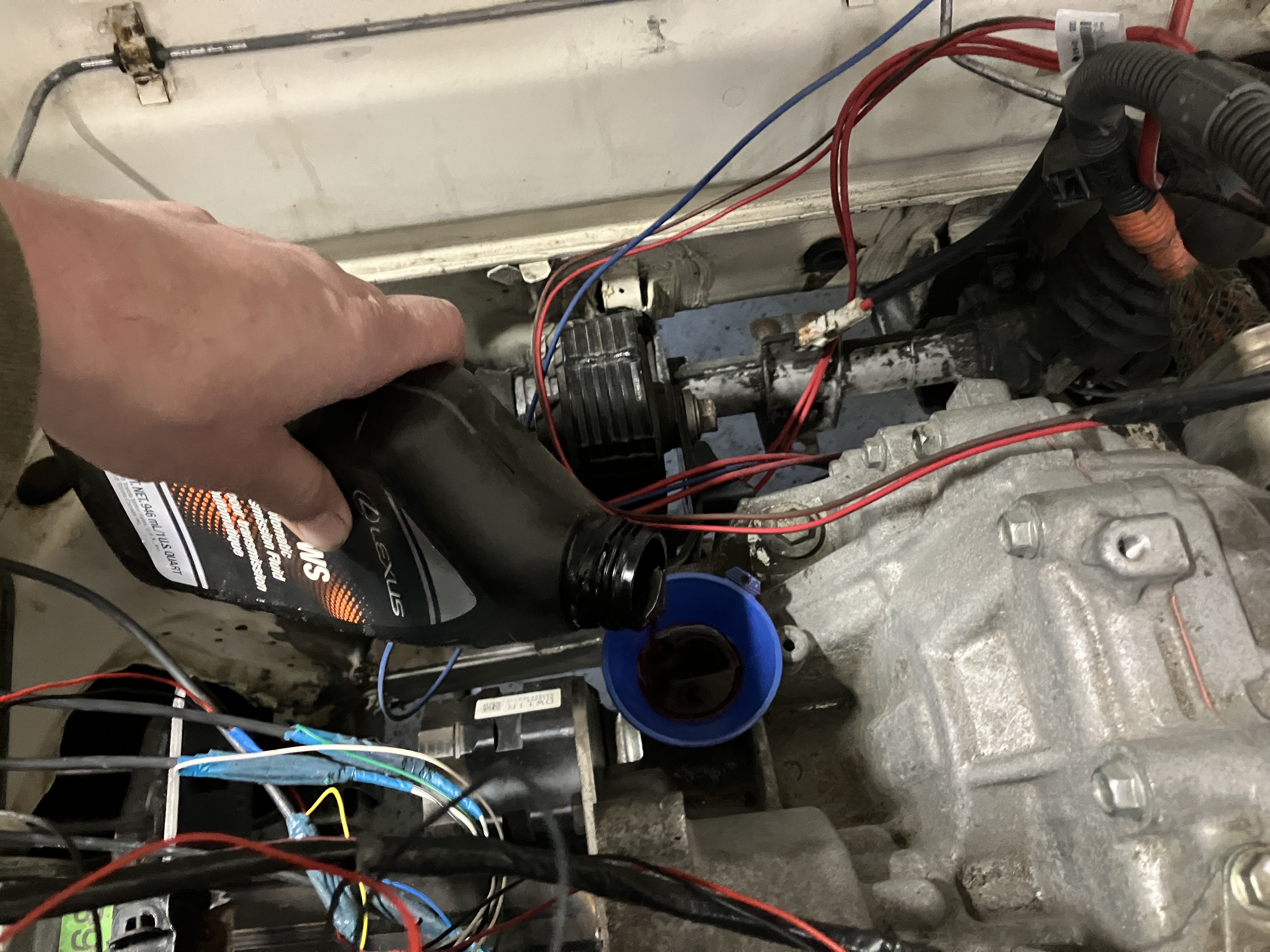

Is there oil inside you gearbox? As it could be MG1 and MG2 fighting through the PSD.
no fluid inside, adding some now
fingers crossed.jpg (9.65 KiB) Viewed 8357 times
Update from the future: 4 quarts in and still makes noise !!!

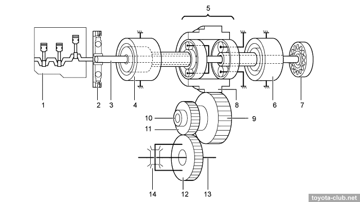

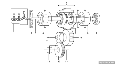

https://toyota-club.net/files/faq/21-12 ... n.htm#P410
Input shaft does spin oil pump and the PSD. So if you weld the PSD it means if you lock the PSD, input shaft spins with the MG1.
Here is the mechanical system diagram. gets quite complex due to the PSD
Good document with pictures and graphs and drawings.
https://digital.library.unt.edu/ark:/67 ... 432/m1/47/ https://digital.library.unt.edu/ark:/67 ... 007833.pdf

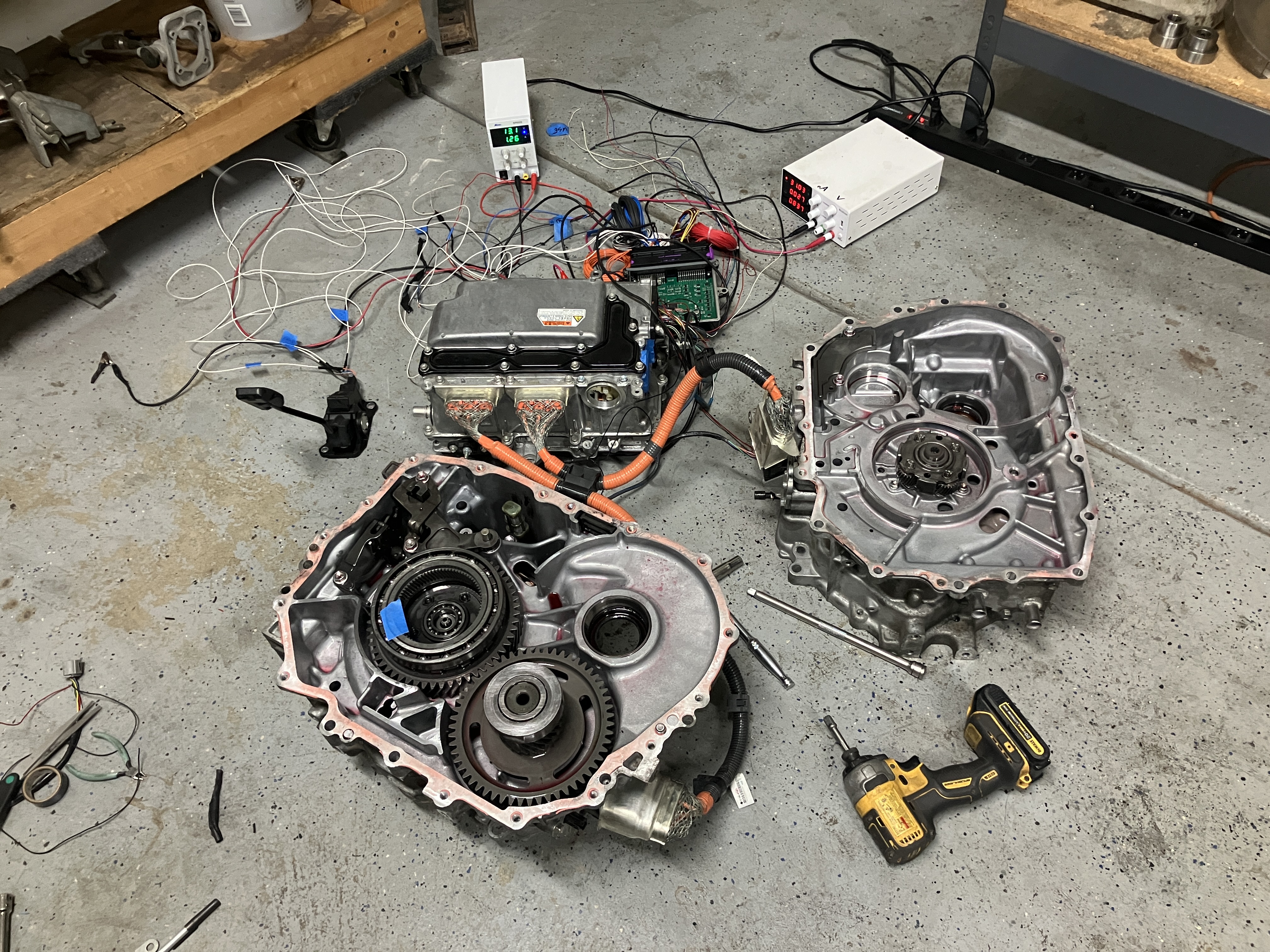

Re: Gen 3 Prius Transaxle P410 Makes Clunky Noise.
Post by Gregski »
so we went... Def Con 4
with the transaxle split into an open faced sandwich, spinning MG2 by itself with the final drive gear removed we noticed that it pulsates either always in the same spot or maybe two
we thought the Prius throttle pedal may have been bad, so first we recalibrated it, then we tried it in Single Channel mode, then we replaced it with a 2010 Honda Fit pedal and still same results
however when we spin MG1 by itself it spins smoothly no noise no pulse
I hope to upload the video tomorrow

Gregski wrote: Wed Mar 27, 2024 5:22 am with the transaxle split into an open faced sandwich, spinning MG2 by itself with the final drive gear removed we noticed that it pulsates either always in the same spot or maybe two
Do you hear any abnormal noises from bearings or gears when split apart like this?
There is going to be firmware soon that allows spinning of each Mg separately for even more testing.
I agree with Jamie on welding the PSD. Make sure to plop it in the ring gear on on the MG1 sun gear when welding so the gears are aligned.

tom91 wrote: Wed Mar 27, 2024 10:04 am Do you hear any abnormal noises from bearings or gears when split apart like this?
I do not that's what's bizarre, without the final drive gear what I call the differential it spins by hand smoothly like a Swiss watch. The reason I spin it without the diff is two fold, one it is easier, and two the diff wobbles a bit with only bearing support on one end with half the case off.
Also when spinning MG2 with electricity, out of the corner of my eye I saw my 30 volt bench power supply spiking to like 57 volts as if regen was pink ponging it back and forth.
