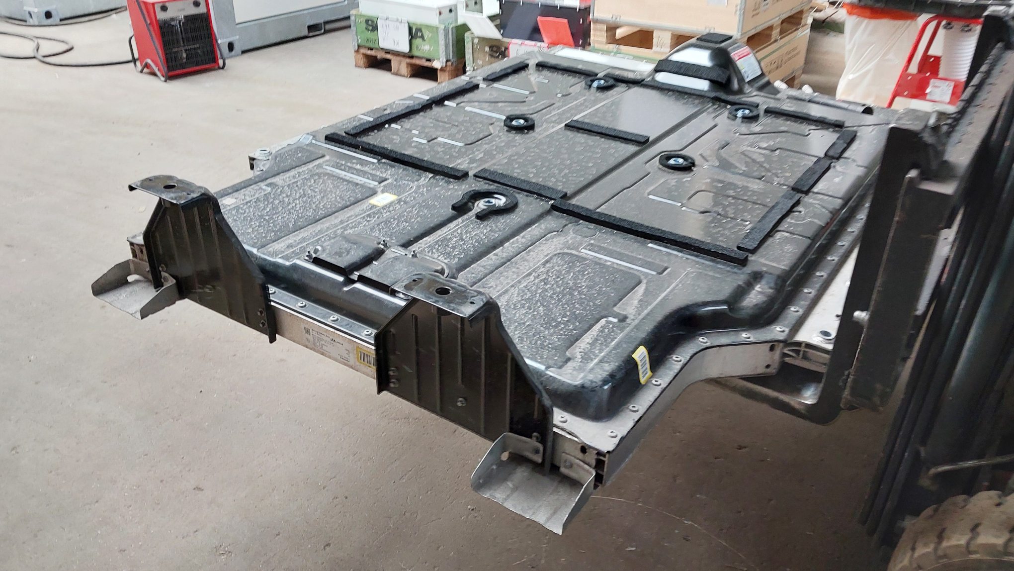

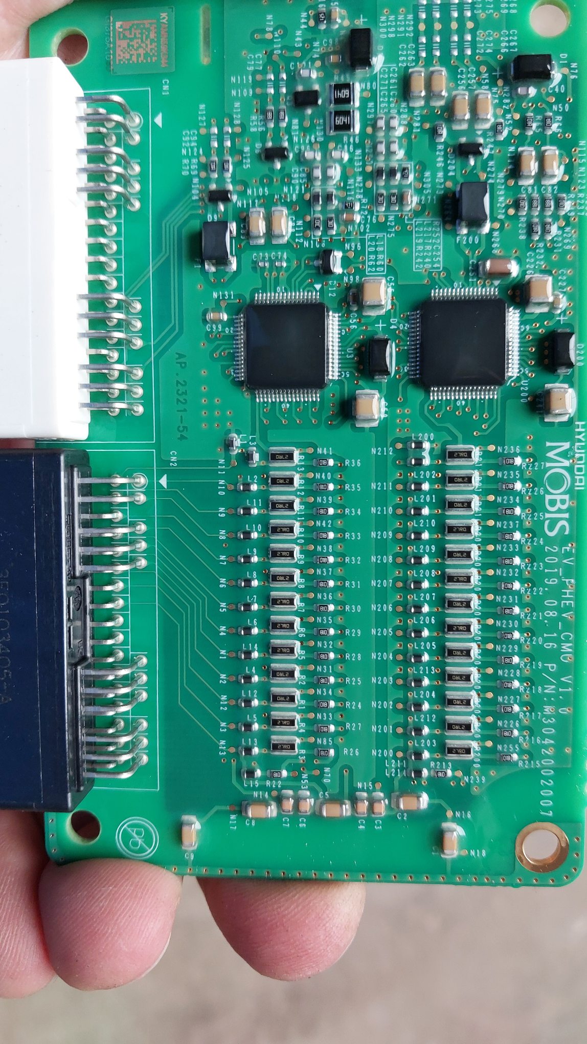

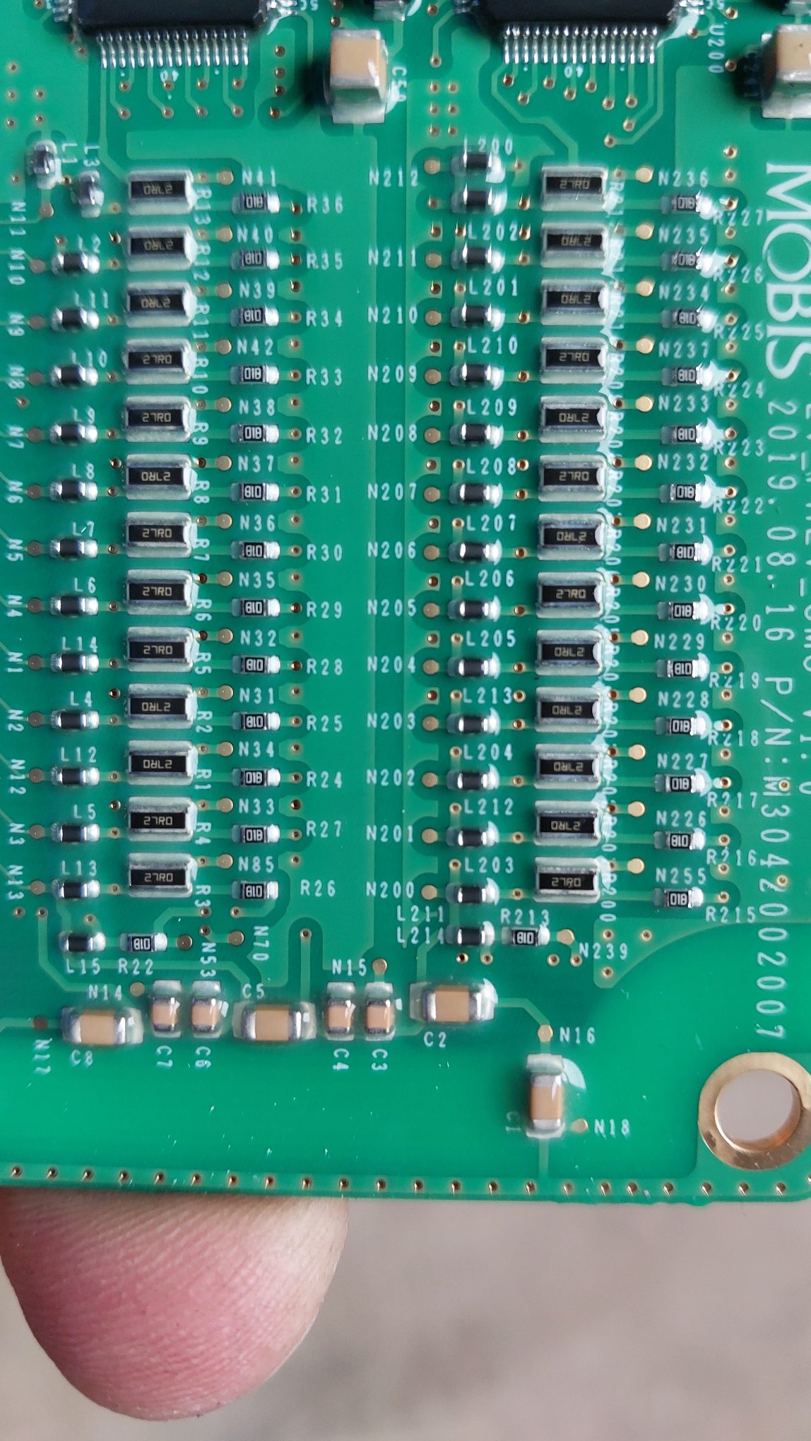

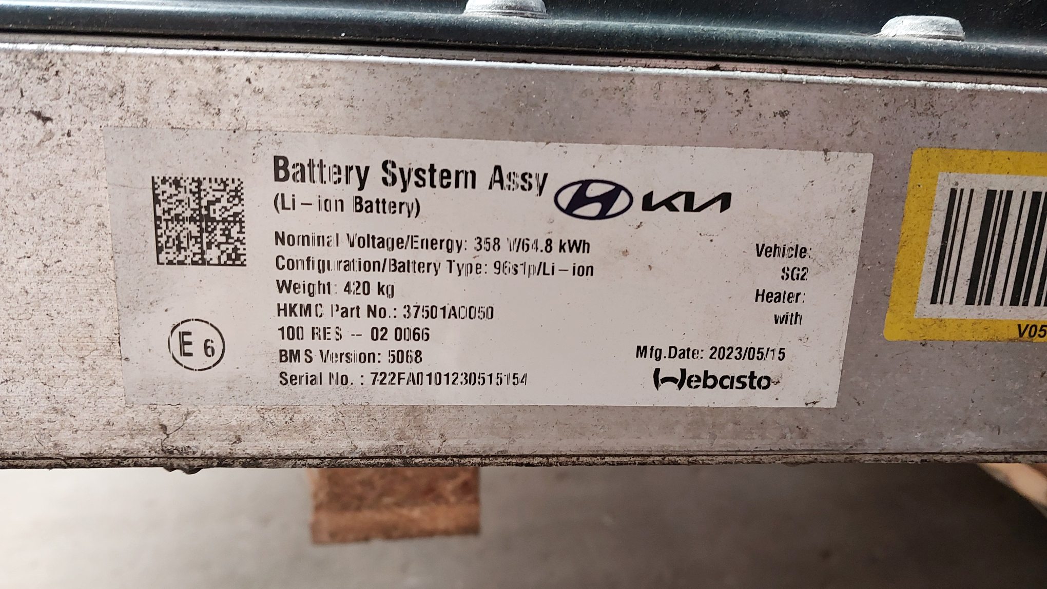

Post by boekel »
4 CMU's (max = wdr compatible)) each serving 24s.
easy to dismantle battery, very re-usable.

Hello!
Can someone please tell me, what is the type of the connector used on these modules for BMS wiring?
Thank you!
