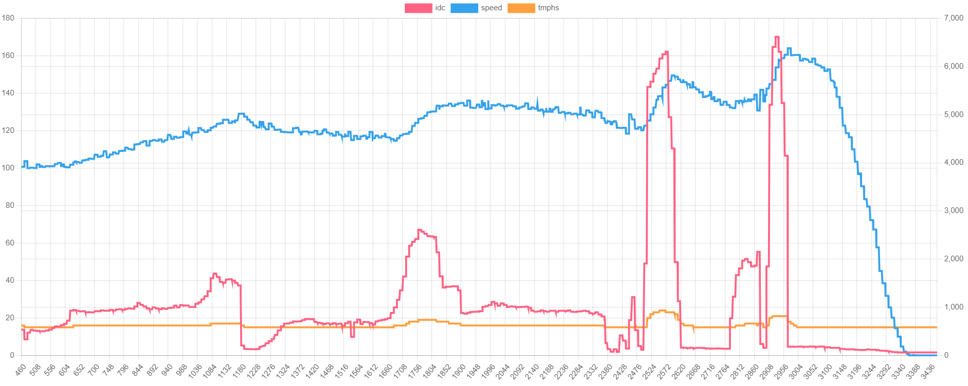

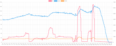

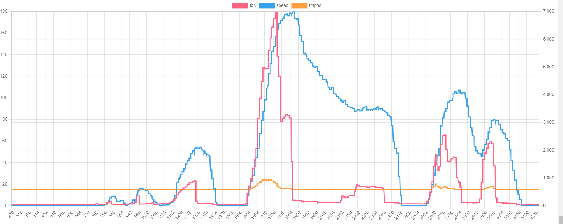

Considering the roads and traffic around here I actually managed to get some reasonably stable constant speed runs done this morning on some level roads

andybpowell wrote: Mon Apr 01, 2024 8:49 am Considering the roads and traffic around here I actually managed to get some reasonably stable constant speed runs done this morning on some level roads
I am terrible at reading charts. What are the axis values here? When you say speed are you referring to motor rpm or vehicle mph?
