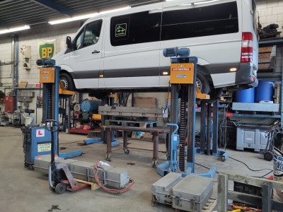

So, I bought an electric van that was broken, and it was made by a small German company that already went bankrupt.
This one was one of their last, in 2015.
It basically is a Mercedes Sprinter with a Siemens ELFA2 drivetrain (motor and inverter) mounted to the 6 speed gearbox. That wasn't really necessary, but it worked.
The battery was a whopping 200 Winston Thundersky cells giving 40kWh at 700kg :shock: so it was a nominal 650v system
The van could drive up to 120km.
It is in fact a 9 seater van, and heating was done with a diesel heater. Because there wouldn't be much left of the range in winter heating the whole van.
The battery gave out because 2 cells died and that's how I bought it, broken.
I couldn't bring the Actia BMS back to live. It was in some kind of error state, and there is literally zero support or information, even though talking to people from Actia who knew about this project!
But, the whole thing is CAN bus controlled with all kinds of black boxes with no info.
Since the BMS had errors, the whole system did not get operational. And it never will, because I removed the BMS.
Luckily, I got some CAN bus documentation on the Siemens ELFA2 drivetrain and some help from a Siemens person.
So I spent some time to create my own VCU which also imitates a battery, based on an Arduino with CAN shield.
There is a start-up sequence to do, the Siemens drivetrain asks for Precharge and so on.
This week, I finally got it driving with the VCU using the original Mercedes throttle pedal.
Just around the parking lot. That was quiet the milestone for me!

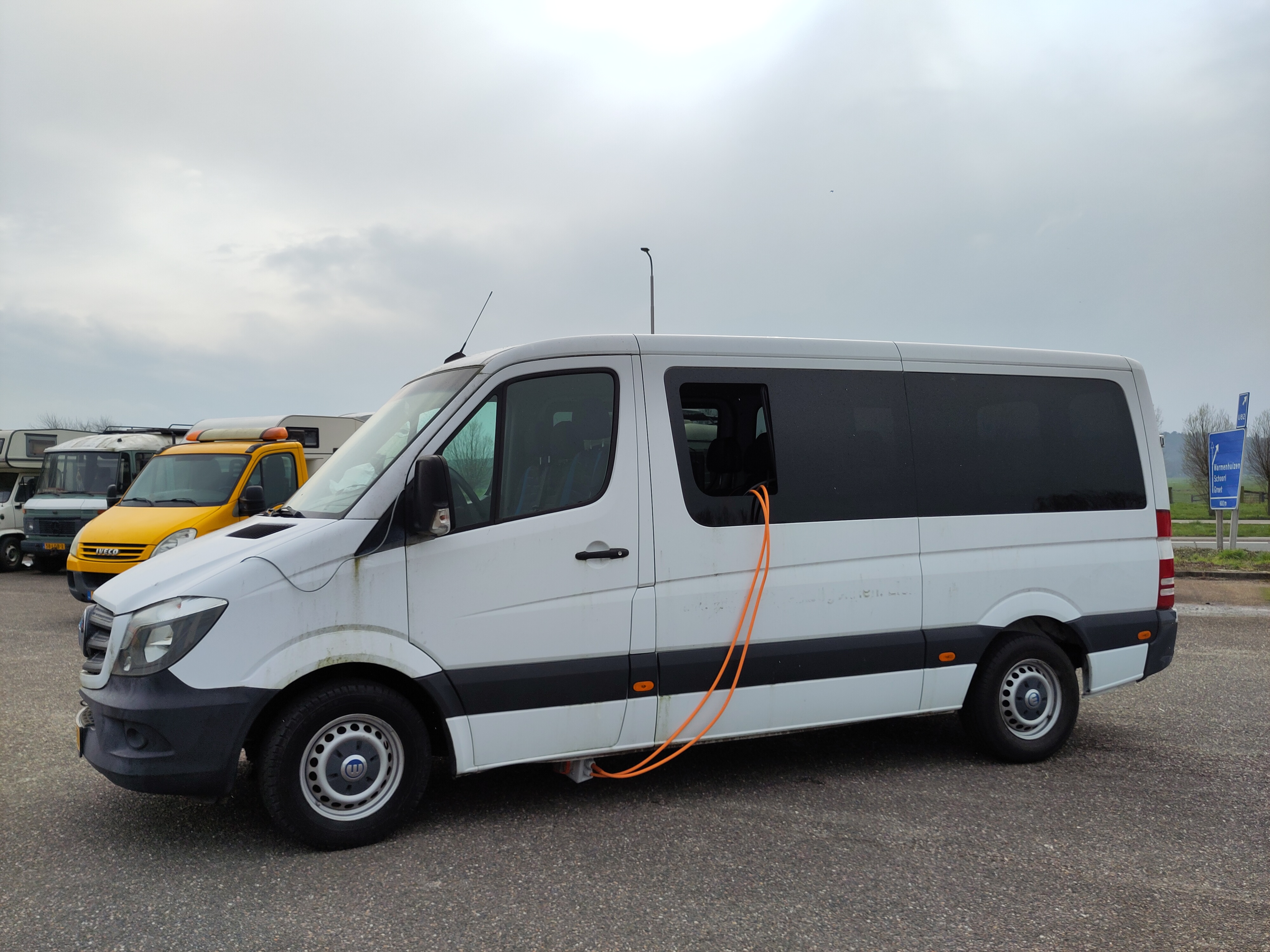

Doing some basic testing, with some questionable cabling :mrgreen:
The cables are shielded though, and I'm just driving 50 meters and stopping again.
PHEV battery pack for testing on a pallet, forklifted in the rear of the van. Convenient.

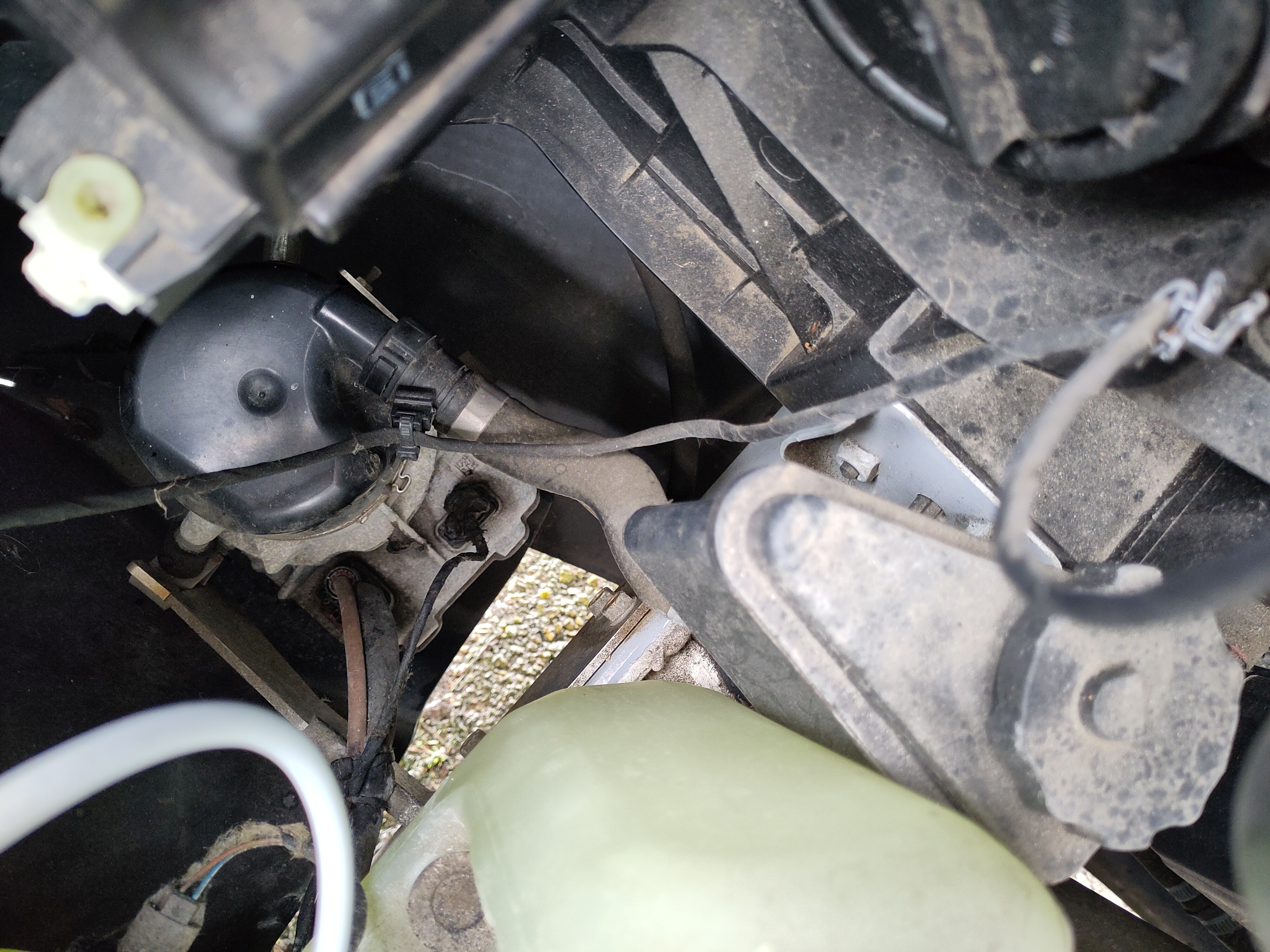

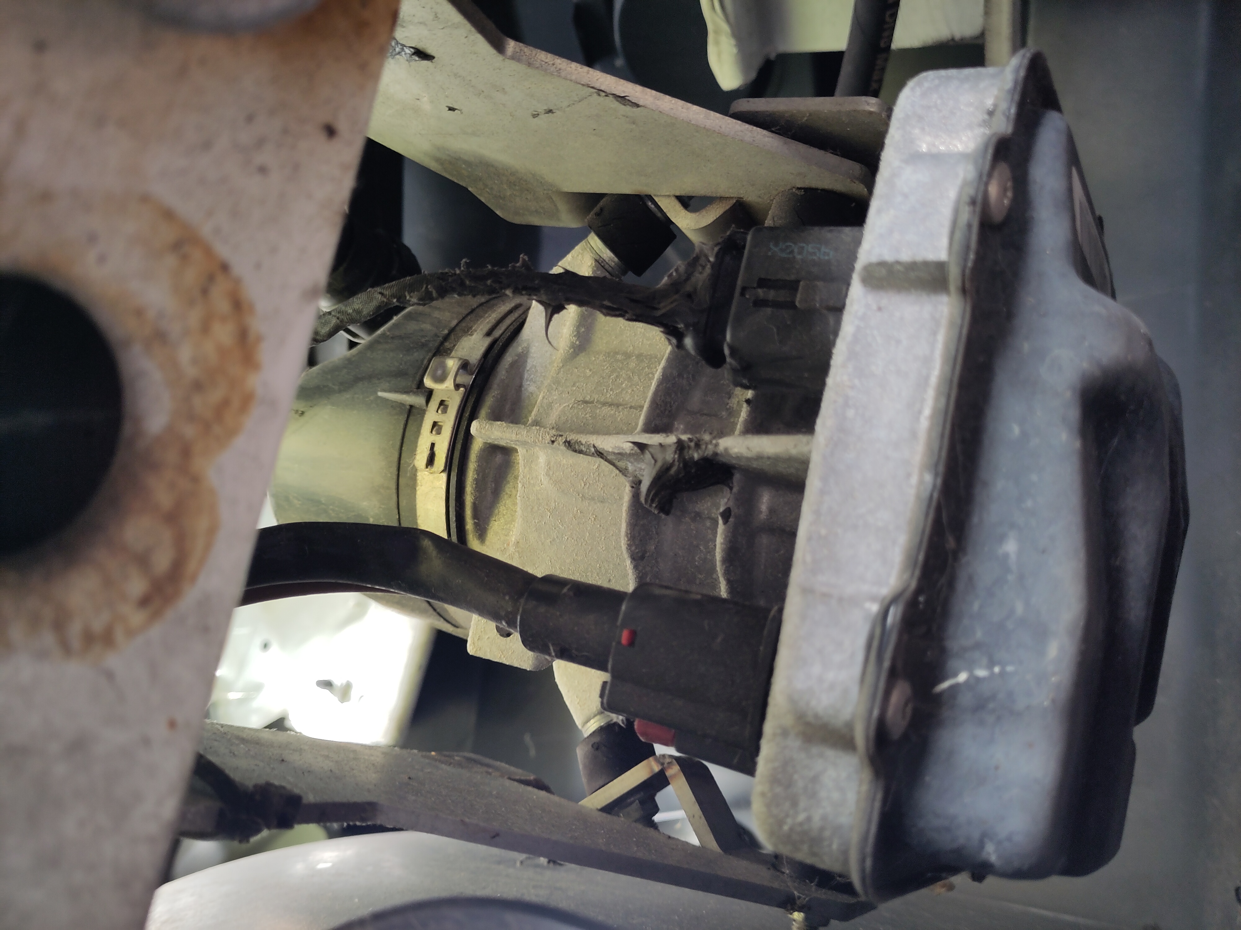

Now, I've got to figure out this electro-hydraulic steering pump.
It seems like something that ZF offered, but maybe somebody else really produced it.
There isn't any clear labeling on it.

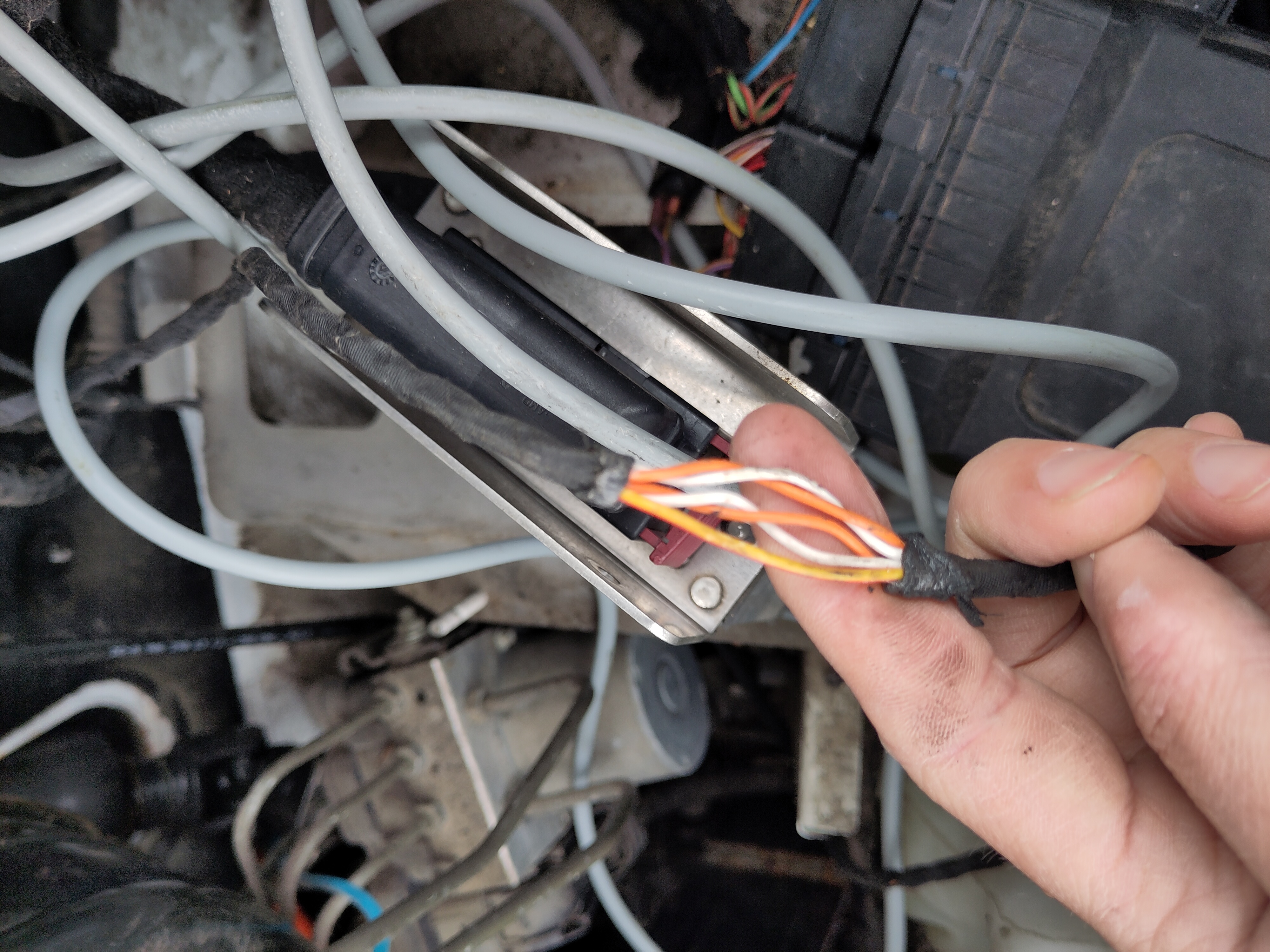

Next to the big 12v power supply, there are 5 cables, obviously a 12v signal cable and 2 bus systems.
I will check them this week, I'm afraid that they are CAN bus and LIN bus.
But since it is steering, it could be redundend CAN bus?
I only have CAN tools so I will check it that way.
The red-yellow wire does get 12v on it when the key is on, and the pump is still silent.
Since this is a pretty big van, I'm afraid taking a dumb EHPS pump from an Opel or something will not be powerfull enough.
On the other hand, if these dumb pumps with the wires connected to each other go to high output, it might be good enough.
