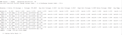

I've finally got the BMS on the front pack restored to working order, and one pack of the 6 is 150mv per cell higher across all cells than the others.
I've verified the accuracy of the reading by swapping the bms module and i'm comfortable that it's correct, but i will check with a meter.
I have a version of simpbms code running on a teensy and it says its balancing but i don't think anything is happening.
Is this code known to activate balancing OK on the BMW packs ?

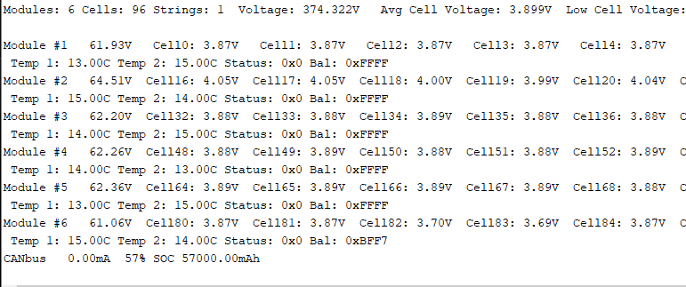

Re: BMW 330e pack balancing
balstat indicates which individual cells are being balanced. 1 balancing, 0 not balancing. It's one digit per cell so 0xFFFF is all 16 cells in a module balancing.

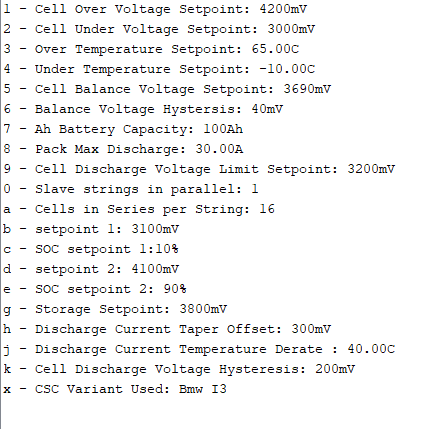

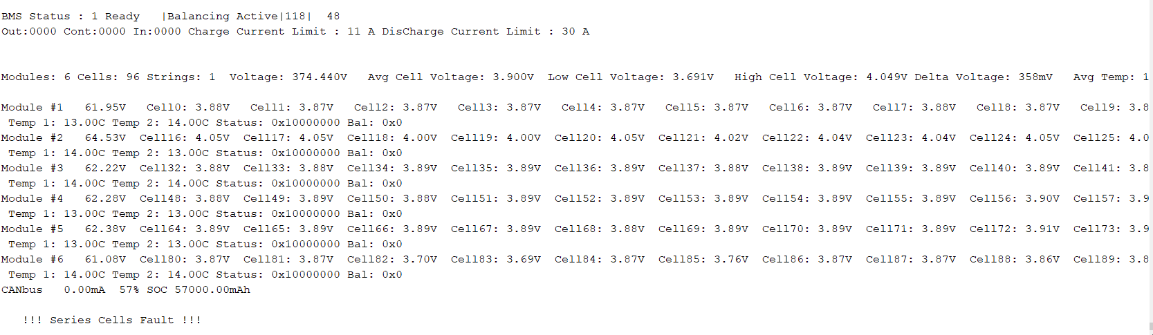

thanks for that. I have my settings set to:-
which if i read it right is no balancing going on.
Should this work as configured ?
and my output showing:-
i note the 'Series cells fault' note, but I can't at the moment understand what is causing that to appear as I have series cells set correctly to 16.
Great - that started in balancing if i read the output below correctly.
I note it cycles balance on/balance off every minute or so. Is this intentional to let modules cool or something. Could i increase the duration here ? The modules are warm to the touch, but not hot.
