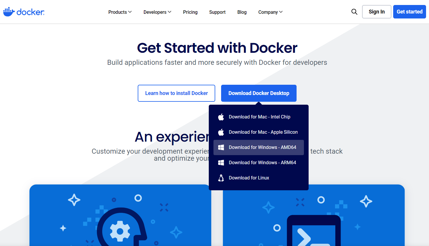

I just went through this again on a new laptop and found a couple of things that would make it easier for future installs & big thanks for setting up the Git and links as they are very helpful.
Can I suggest the following.
your link to the windows docker installer doesn't have a windows intel version listed (yeah yeah yeah) however it can be found here https://docs.docker.com/desktop/install ... s-install/
add the instruction to "download ZIP" from the Git 'Code', unzip the contents into what will become the projects base folder and then run the SetupContainer.bat
thanks again.
TED

Re: How to setup a PC to edit and compile a bin that can be uploaded to the VCU or Mini board
"AMD64" is the version for all x86_64 processors (including Intel), so the link to the Getting Started page is correct:
The README is already updated.
I could add the instructions how to download the zip archive, however I did not anticipate that that would be an issue.The README is already updated.
