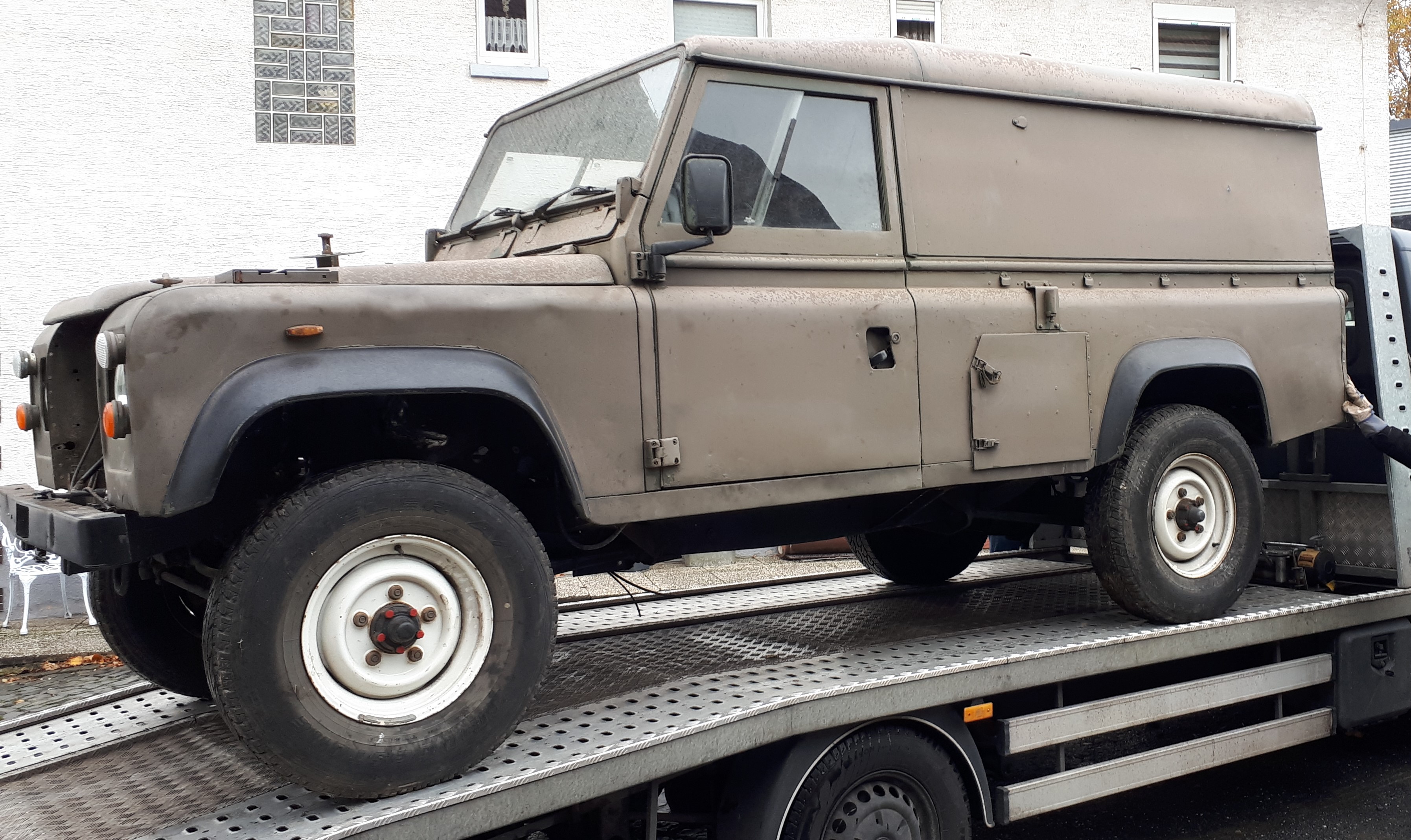

Vehicle: So, when I came back home and had earned some money, I bought a Land Rover Defender exMoD from 1988 (actually they called them simply "one ten" back then) with an engine issue and comparably few rust holes, following this community's first rule and having learned from previous projects.
(Turned out that I had to weld the whole bulkhead)
