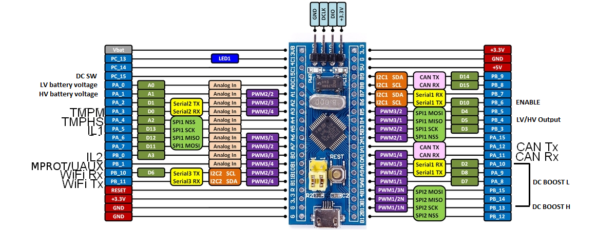

What i need is software that would control the main board to use the input (for example 60Vdc battery in a trunk) and boost that voltage to 360Vdc in a car or a house etc...
While one side is evidently present as the wiring for boost charger on Johannes site, the other side would have to be attached to some of the inputs of existing board. We could change input for example throttle input for sensing voltage and regen for sensing current on the 2nd battery side.
Charge converter/pump would start with ignition (enable signal from DCDC converter in Ampera). It would then be dormant until voltage of main battery would reach some minimum where pump would start its function. Concept of control would be continuous loop where charger would try to follow one reference. That is voltage of main battery. 2nd battery would then be depleted down to some value where proces would stop and converter would wait for recharge.
Recharge could then be started by plugging converter to 3phase voltage (car is parked) and two connectors would disconnect main battery and connect AC input! Then the reverse process would start. Voltage over 500Vdc would go into buck side of converter and on the other side regulated 60Vdc would come out untill 2nd battery would be full. Very Prius like.
I recommend next inputs to be changed in software:
Throttle input becomes 2nd battery voltage sense input
Regen input becomes 2nd battery current sense input
Start pin would accept 12V enable signal
BMS input would be used to signal if battery is high or low
Presence of AC or DC voltage (Buck boost direction) would be indicated by FWD or REV pins.
Any other suggestion for SW change?

So as a start I'd suggest you wire up just one half bridge module on, say, PWM1 output. Add the inductor to have boost in one direction (extension to car) and buck in the other (car to extension). Put one current sensor on output, one on input. Use two isolator modules. Most important is voltage on car side as it decides the direction of energy flow. Input voltage isn't even so important because you need a BMS to avoid over/under charging.
Other input would be enable input. I think charge/discharge threshold voltage must adjusted with changing SoC. So 4 parameters: chargestart [V], dischargestart [V], chargecur [A], dischargecur[A]. And of course miscellaneous parameters for tuning.
For charging from 3-phase you'd either come up with something separate or swap input and output of the converter using relays.

Hi Johu
I had some time to think about charge pump hardware and how to couple this to Prius gen3 inverter.
I see several possibilities and i would like to ask for some explanation of your contact table in wiki.
Lets standardize some things....
1. Assume we will be using STM32 blue pill chip
2. We will only use this as charger, not motor controler, therefore i will activate only buck/boost module
3. Original current sensors i think replacing in favor of 5V ones.
4. Power supply will be standard 9V - 30V buck down to 5V
5. Drivers are integrated in Prius inverter and need only 5V(3V3) signal
6. I will setup the board so it will work with 12V converter if battery is in range.
Now come the questions:
1. Will we only use two PWM pins? Which one do you think to use for Buck and for Boost side? EDIT: i see you declare PWM1 channel in wiki. Does that mean PWM1L goes to DC BOOST LOW and PWM1H to DC BOOST HIGH?
2. How many current sensors do you think i will need? Only one or two? One on MG side and one on battery side? I think i can hide one sensor on battery side, but i will have to think how to measure current on MG side (rectified current that is).
3. How to connect HVDC side (MG contacts)? Ie. will i connect +360V battery to contact L1 which has current sensor and -360V battery to contact L3 which does not have current sensor? Then when we use 3phAC system is assumed to be simetrical, but with DC do we connect current only on one line?
4. Voltage inputs i will just make as variables with 3V3 resistor divider yes? But in code we will have to calibrate range and gain for both.
5. Wifi integration... will this work directly as in any inverter?
Any sample of code to try with blue pill? At least only as buck charger?
EDIT2: i prepared a schetch of bluepill contacts. Can you verify or correct me? Some of the pins from wiki i couldnt fit on bluepill. Can you suggest what to use for: AC contactor, HV contactor output
What is LV/HV Output? Is it an interlock relay function meant to tell inverter when to buck or boost?
tnx
