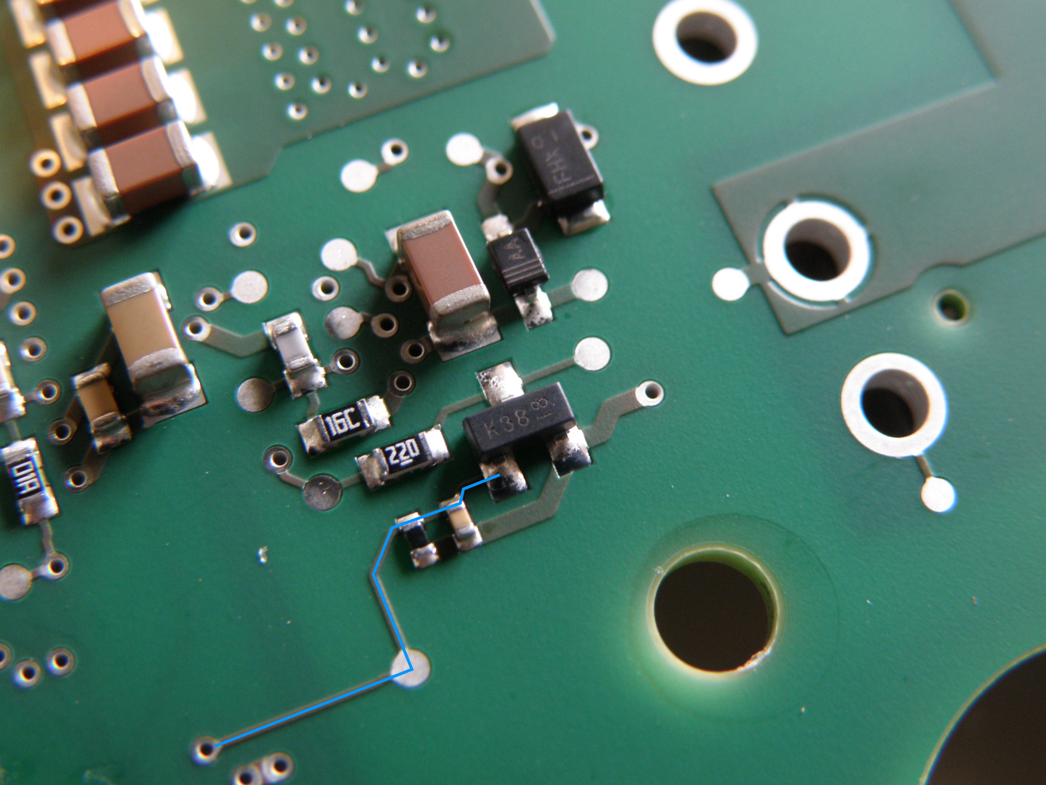

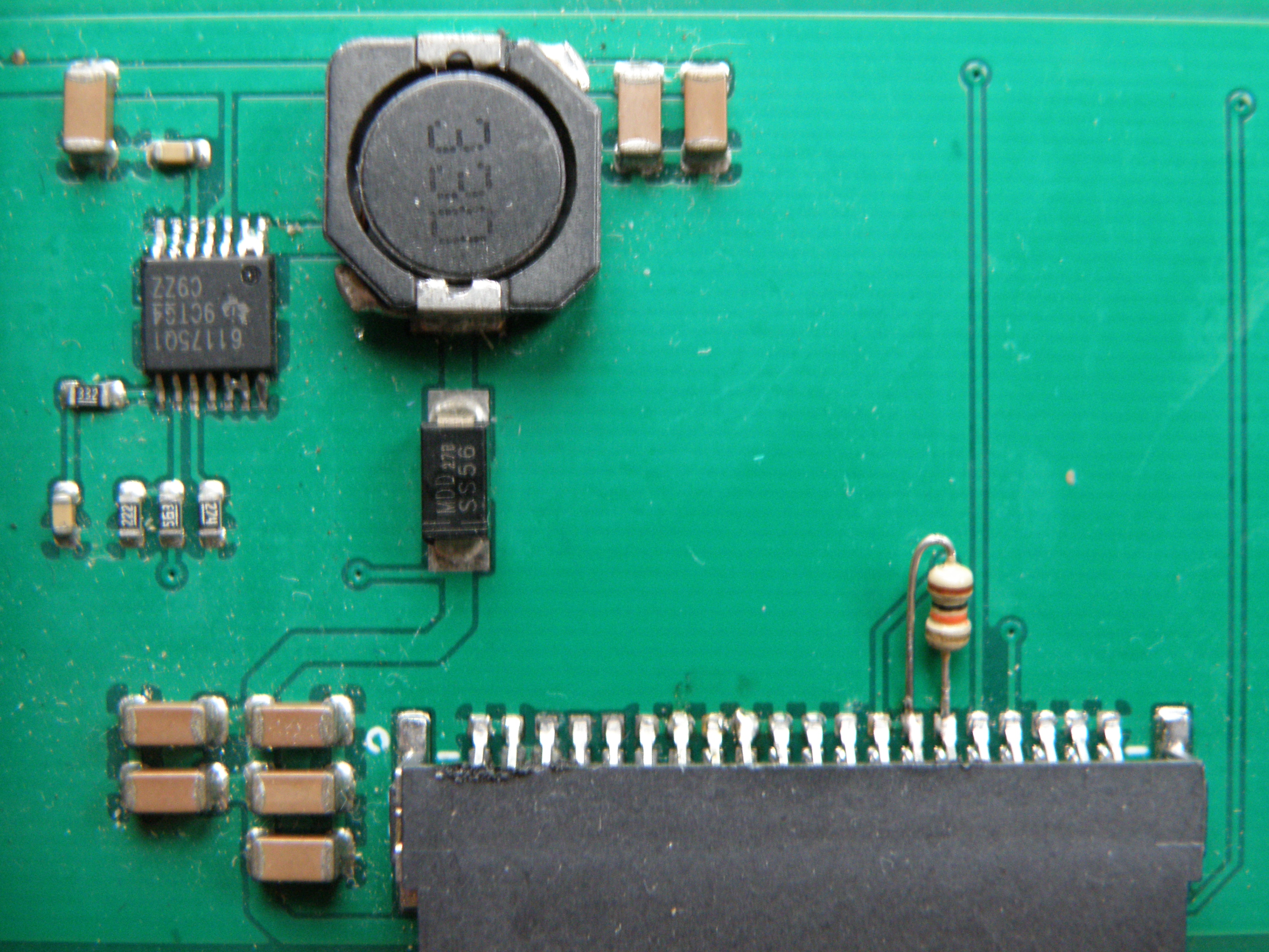

Had a go at tracing pin 35 on the gate driver board and looking up datasheets to get a better idea of what's going on here with a view to hopefully confirming that a 12V supply to this pin is correct. Information below with the caveat that I have a fairly basic understanding of electrical circuits and have best guessed the component identifications.
Having checked every solder pad, pin and via on the underside of the board, aside from a few vias that appear to be for routing purposes pin 35 appears to be connected to a mosfet gate (blue line on image below). Assuming it's a BSS138, the datasheet seems to indicate the gate can accept up to 20V, though presumably there would be little to no ongoing current draw. The source pin of the mostfet seems to be connected to ground:

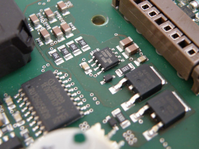

The drain pin of the mosfet is connected to pin number 1 of an International Rectifier 2085S half bridge driver chip on the other side of the board that's linked to a pair of FR024N power mosfets. The datasheet indicates this pin is a current sense input:

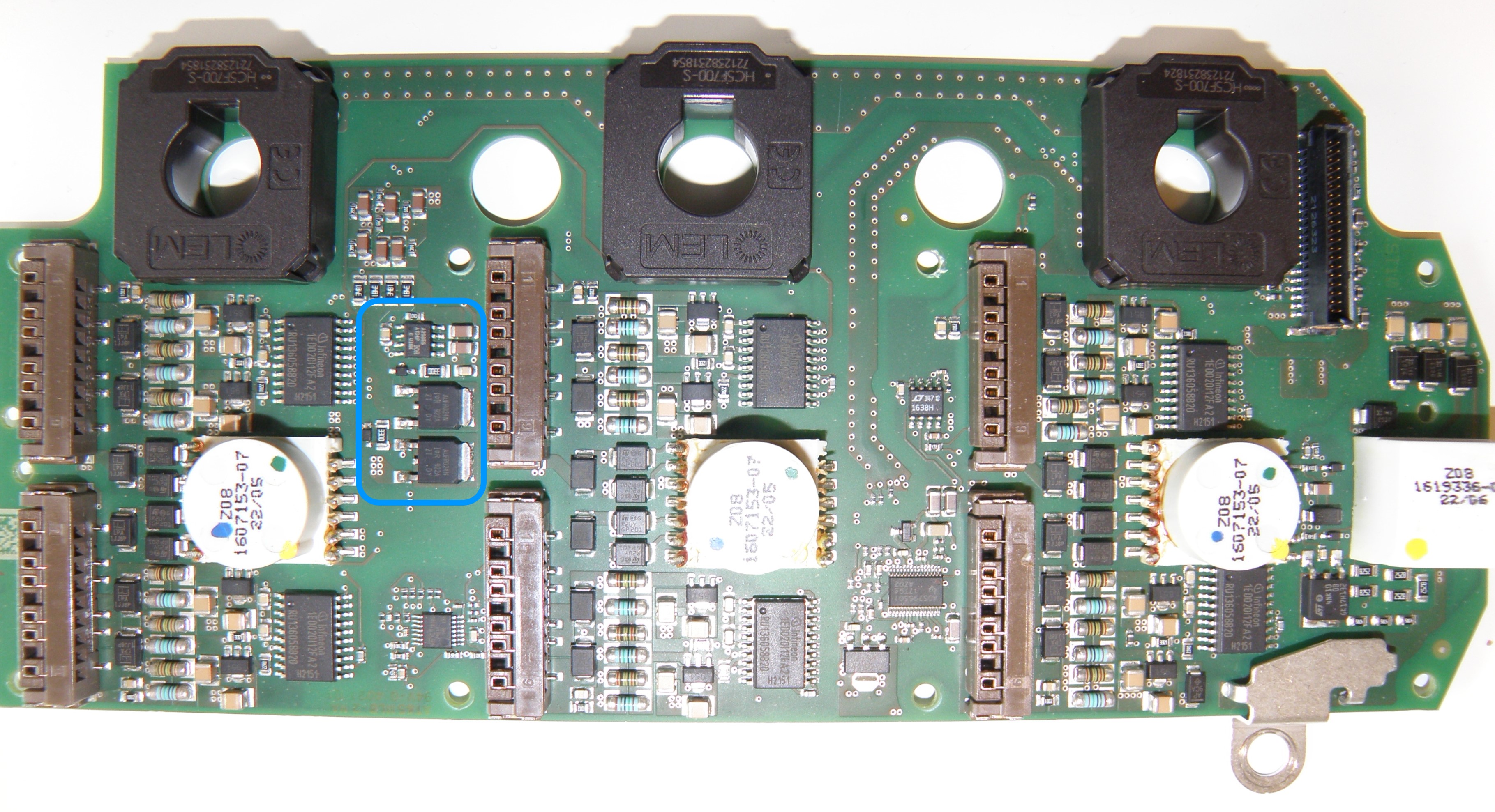

Full images of the gate driver board below with component locations:
Damien's original notes, below, also suggest this pin is for enabling the IGBT PSU, however looks more like 5V than 12V to me:

I'm planning to run some tests on the mosfet gate over the next couple of days, to measure the current draw and try running it off the openinverter's 5v supply (via a 500mA fuse). Will try adding a 10k resistor as well.

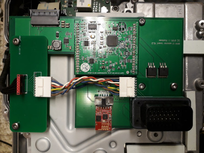

The resolver was hooked up with the connection order based on various notes, multimeter testing, and hand-spinning the motor based on Johanne/Damien's youtube tutorial (posted on page 9 of this thread). The connections are summarised on the i3 Wiki page. If you need one of the drop-in boards I made (pic below) to pick up these connections I can share the design files or order some more and mail one. Note I got the Sin Hi/Sin Lo order wrong on the first batch of these boards, so the blue and brown wires need to cross over between the two PCB's - this has been fixed on the latest design.

Today I ran the motor again, this time powering pin 35 on the Harwin connector with 5V from the openinverter board via a 10K resistor and registered no current draw on the multimeter.
Will plan to use this setup going forward as seems safer to use the regulated power supply on the openinverter board to power the mosfet gate than the 12V coming in to the drop-in board from elsewhere.
I am pretty sure the mosfet is a BSS138, as the lettering/numbering format matches a datasheet for that device from Diodes Incorporated, see below.

This is the final fix I've implemented after testing.
Pins 33 and 34 on the Harwin connector are both connected to the 5V 500mA output on the openinverter board. Added a 10K resistor between Pin 34 and 35 to provide power to pin 35 and the mosfet gate on the gate driver board.
Possibly it would be fine to just solder 34 and 35 together, but keeping the resistor in there to be safe on Mr X's advice.

Upon reflection, it looks like there is a pull-down resistor on the mosfet gate, so might reduce the gate series resistor to 100R to avoid creating a voltage divider that reduces the gate voltage too much. Will pull the gate driver board out again next weekend and try to measure the pull-down resistor value.
Been thanked: 1914 times
Re: i3 controller hacking from diyelectriccar.com
I should check my board and find out why it works without the patch. Where on the board is that part of the circuit?

johu wrote: Sun Apr 28, 2024 4:20 pm I should check my board and find out why it works without the patch. Where on the board is that part of the circuit?
It is located on the underside of the gate driver board, tip of the blue arrow below:

Measured 4.7K across the pull-down resistor on the mosfet gate today, so will be swapping the series resistor on pin 35 of the Harwin connector for a 100 Ohm. That should limit current to ~50mA while minimsing voltage division.

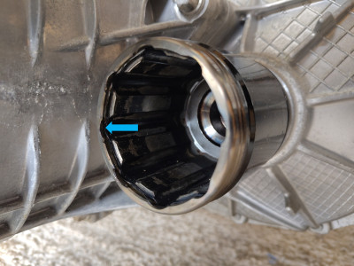

A bit off-topic from BMW i3 inverters, but for anyone needing to take the inner CV joints on the i3 motor apart, the cage, inner race, and balls are retained by an internal snap ring that runs around the inside lip of the housing, indicated by the arrow on the image below. Easily removed with a small flathead screwdriver.
The snap rings on mine were covered in grease so not immediately visible. Posting in case this helps others as the 'hammer method' for removing the housings would not be effective!
