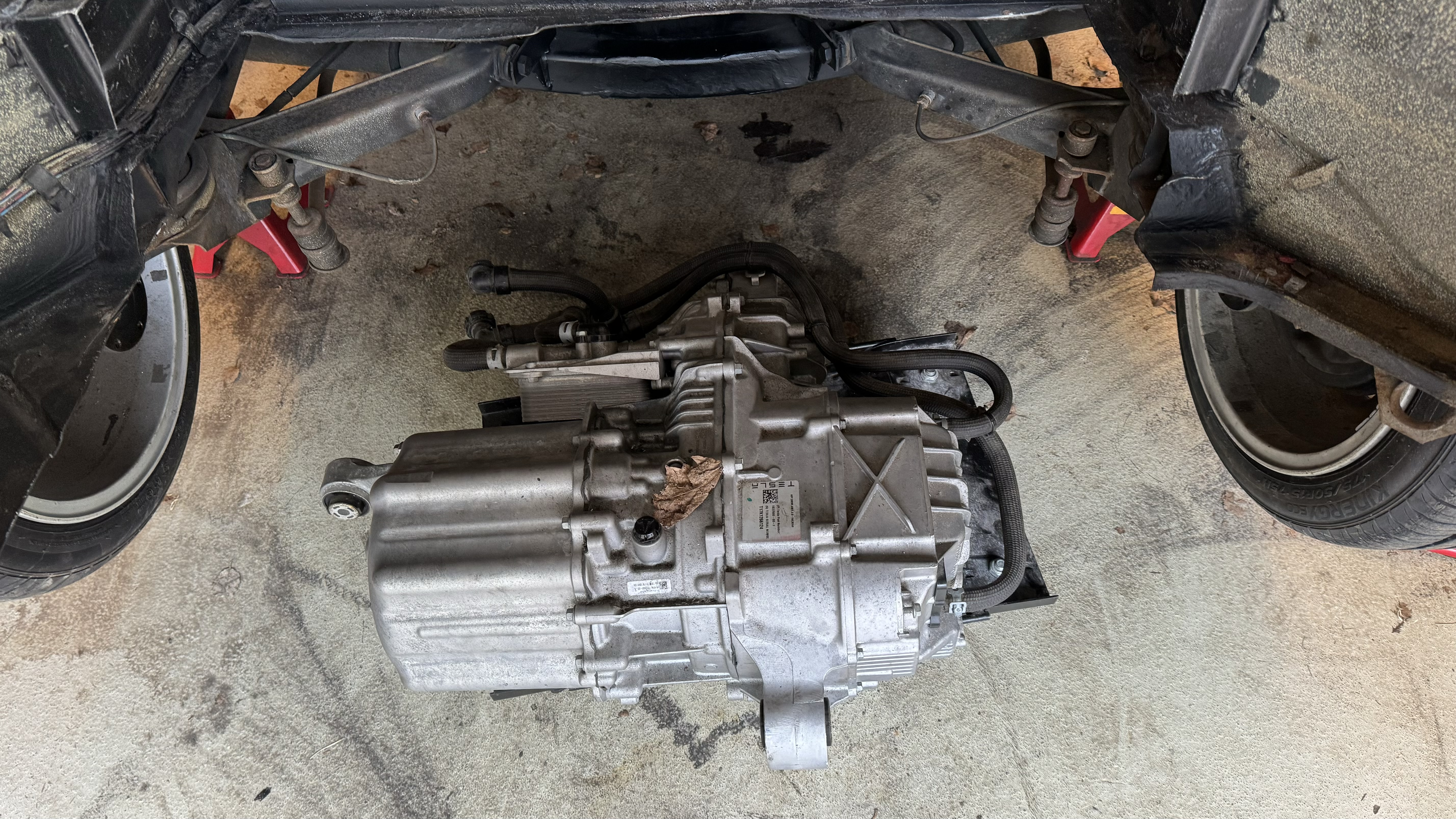

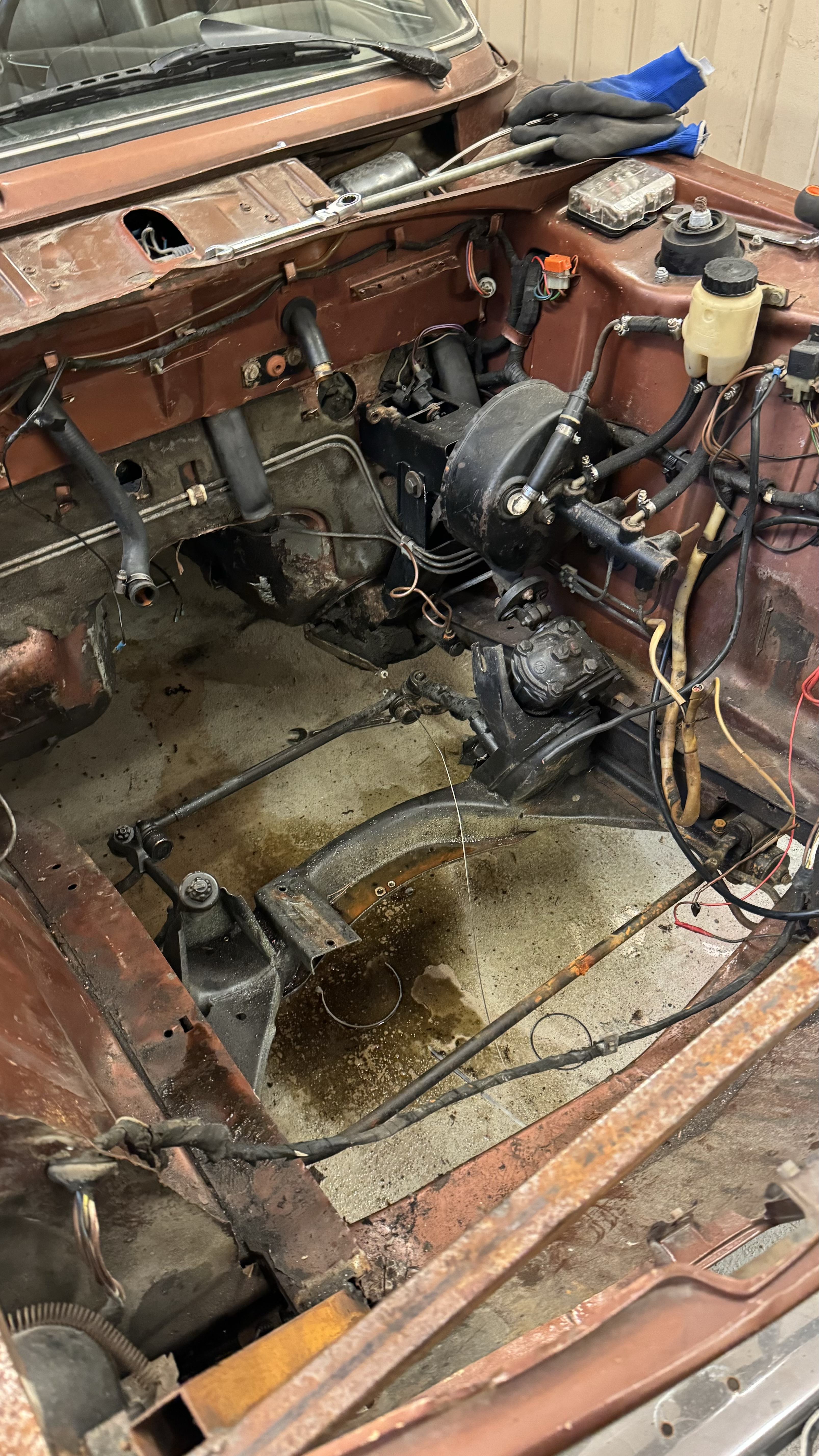

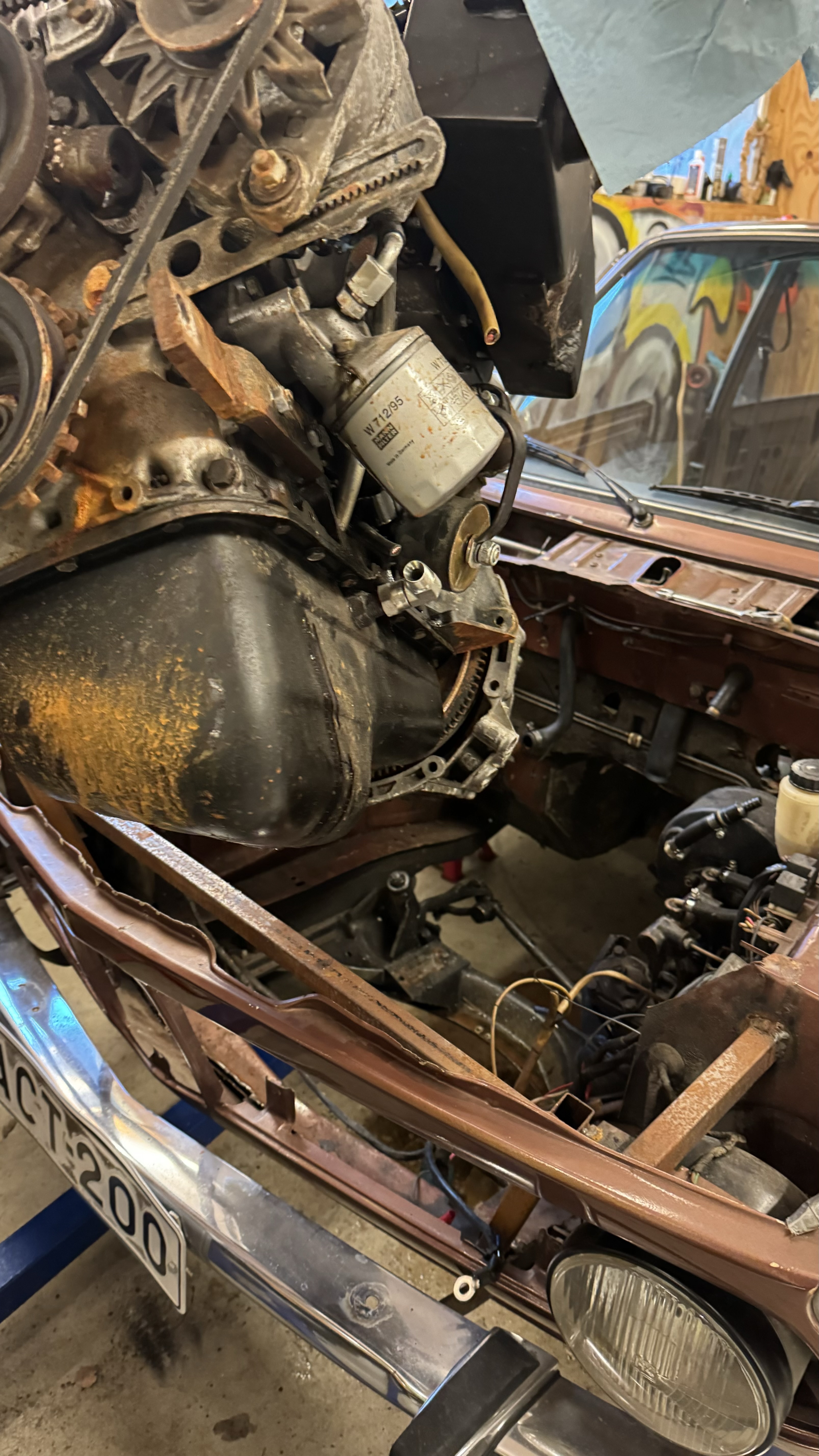

Motor removed.

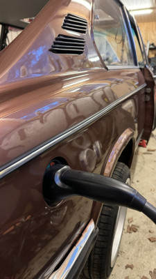

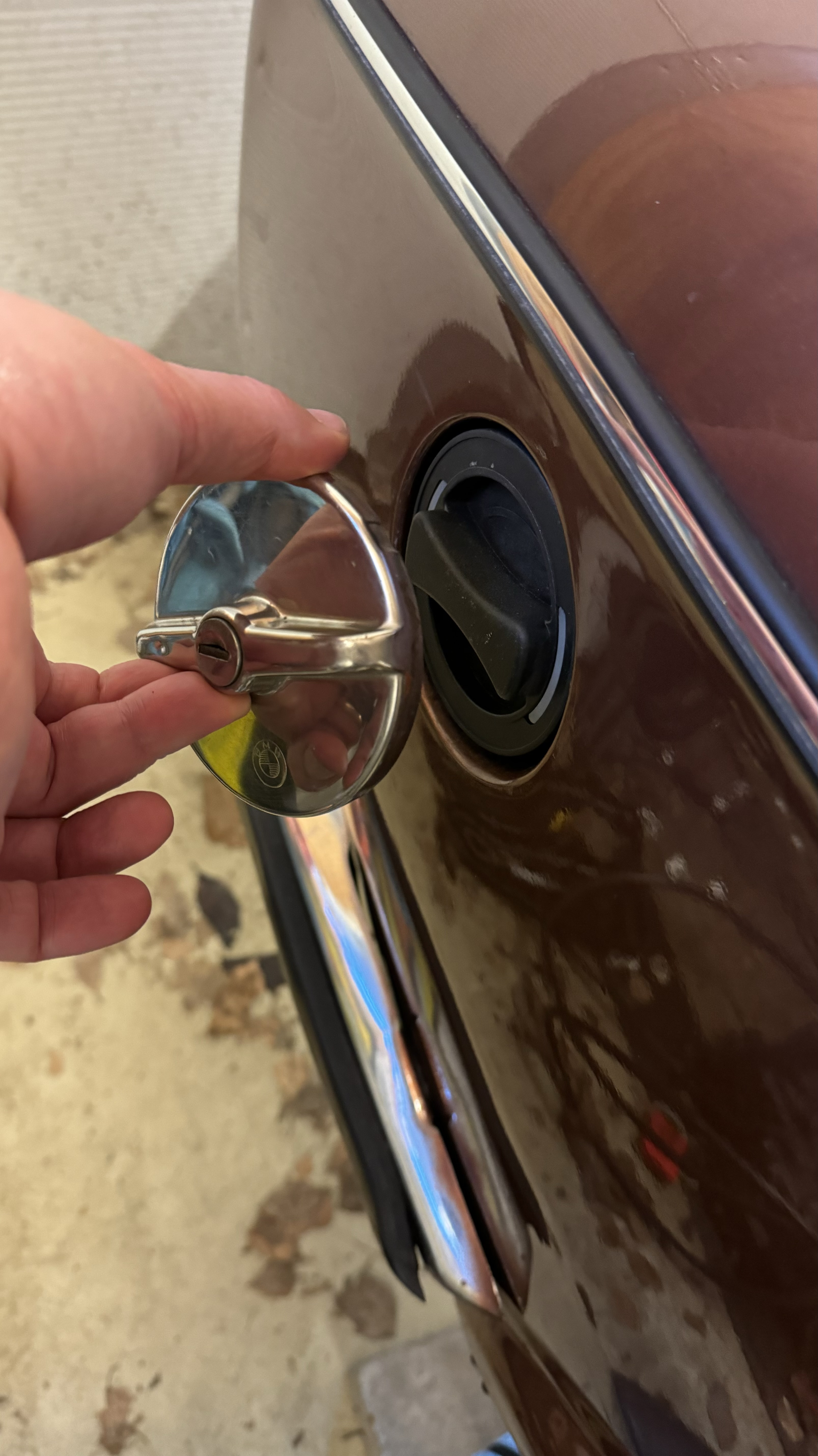

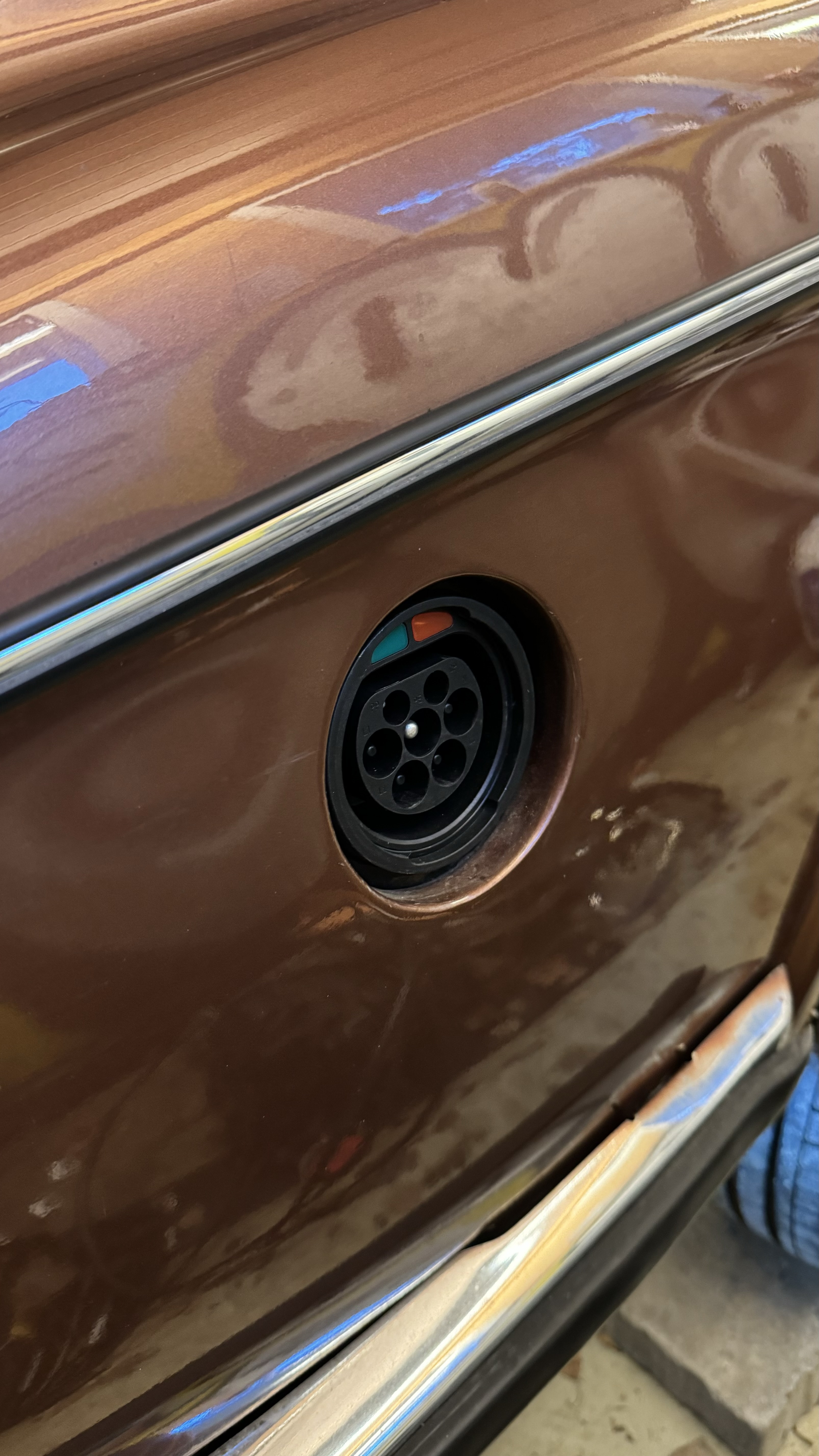

Type 2 charge port installed. Really nice fit. Need to invent something for attaching the original chrome cap to that plastic one.

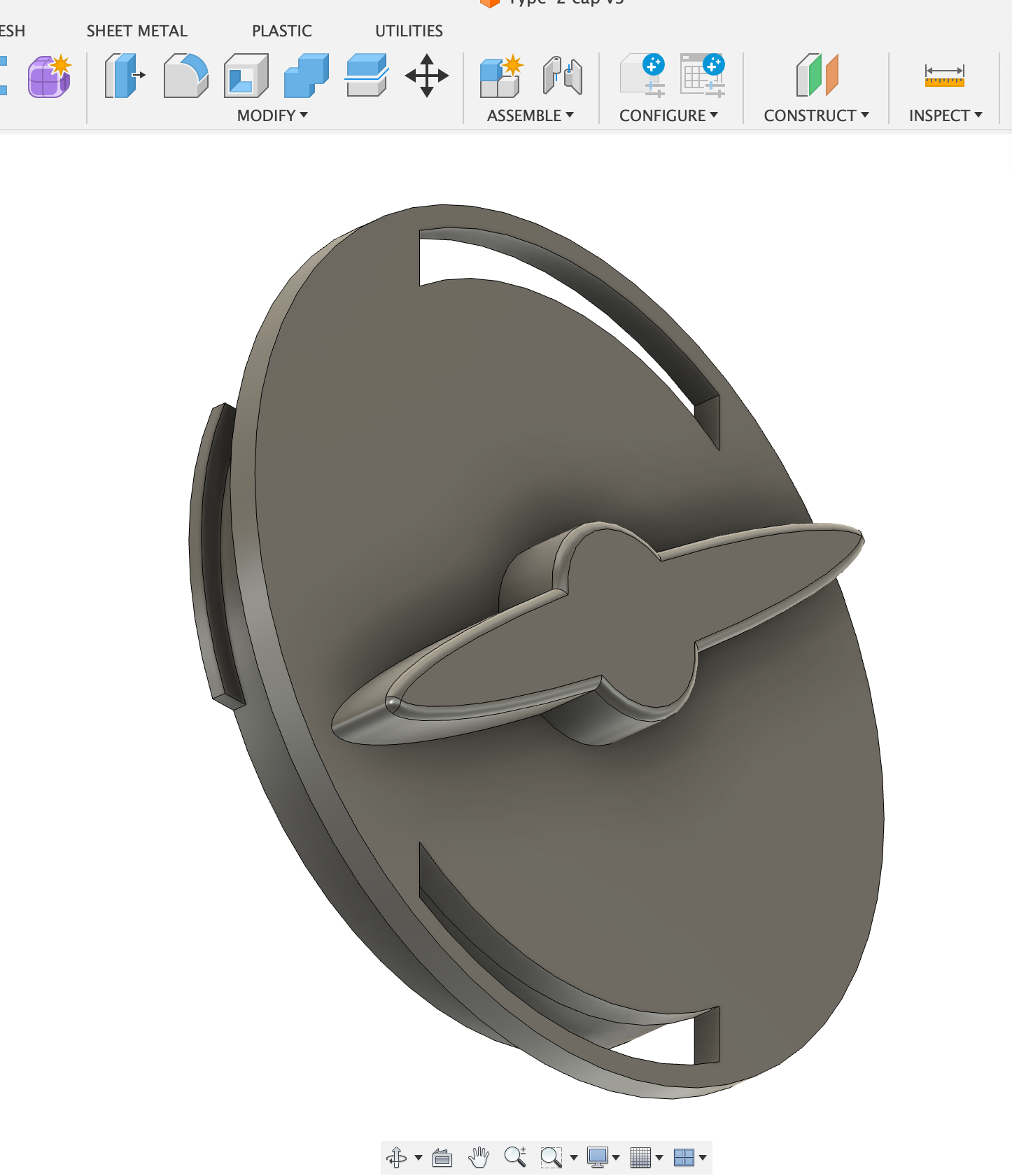

3d printing type-2 charging socket cap that goes into chrome gas filler cap housing.

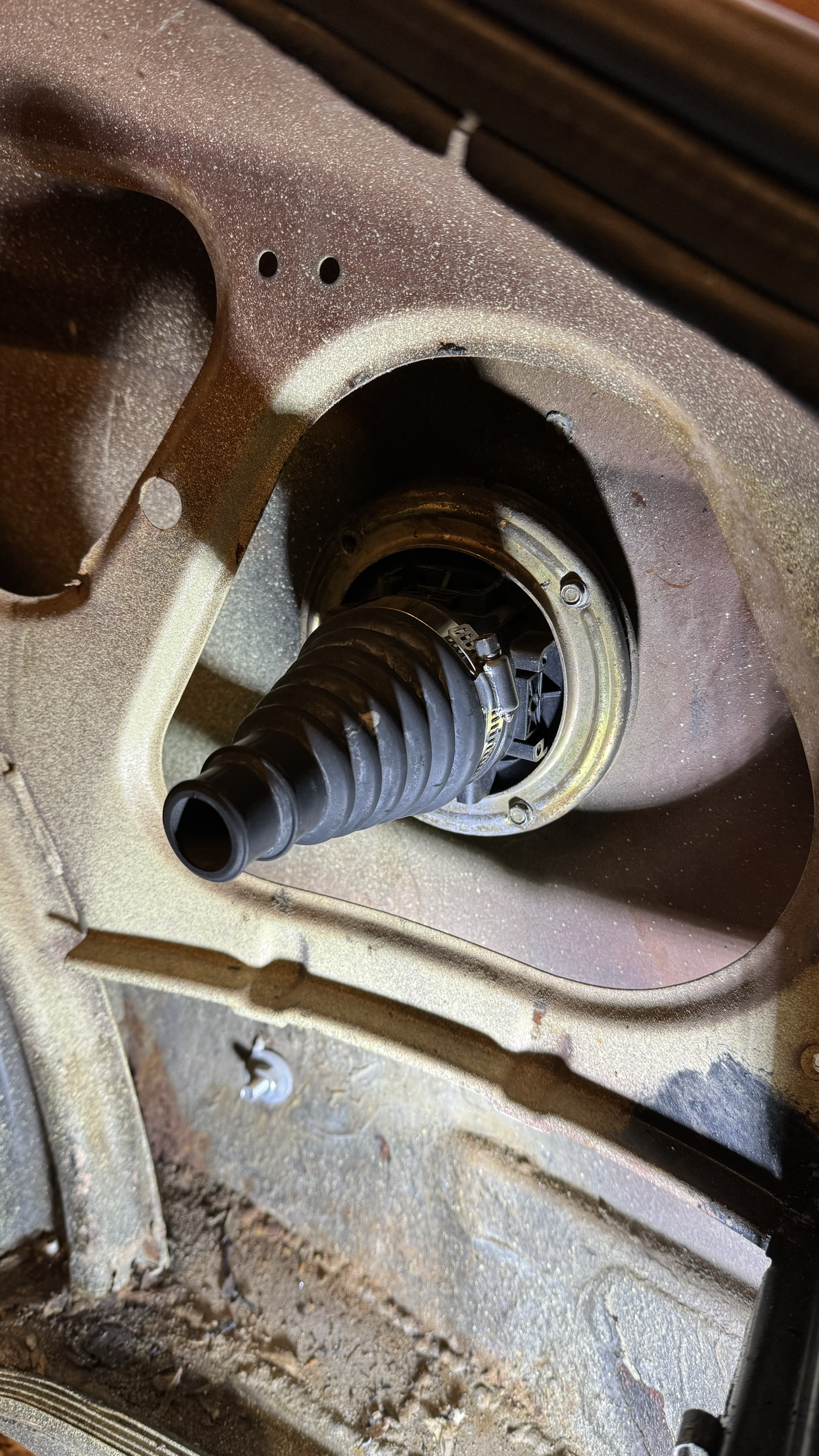

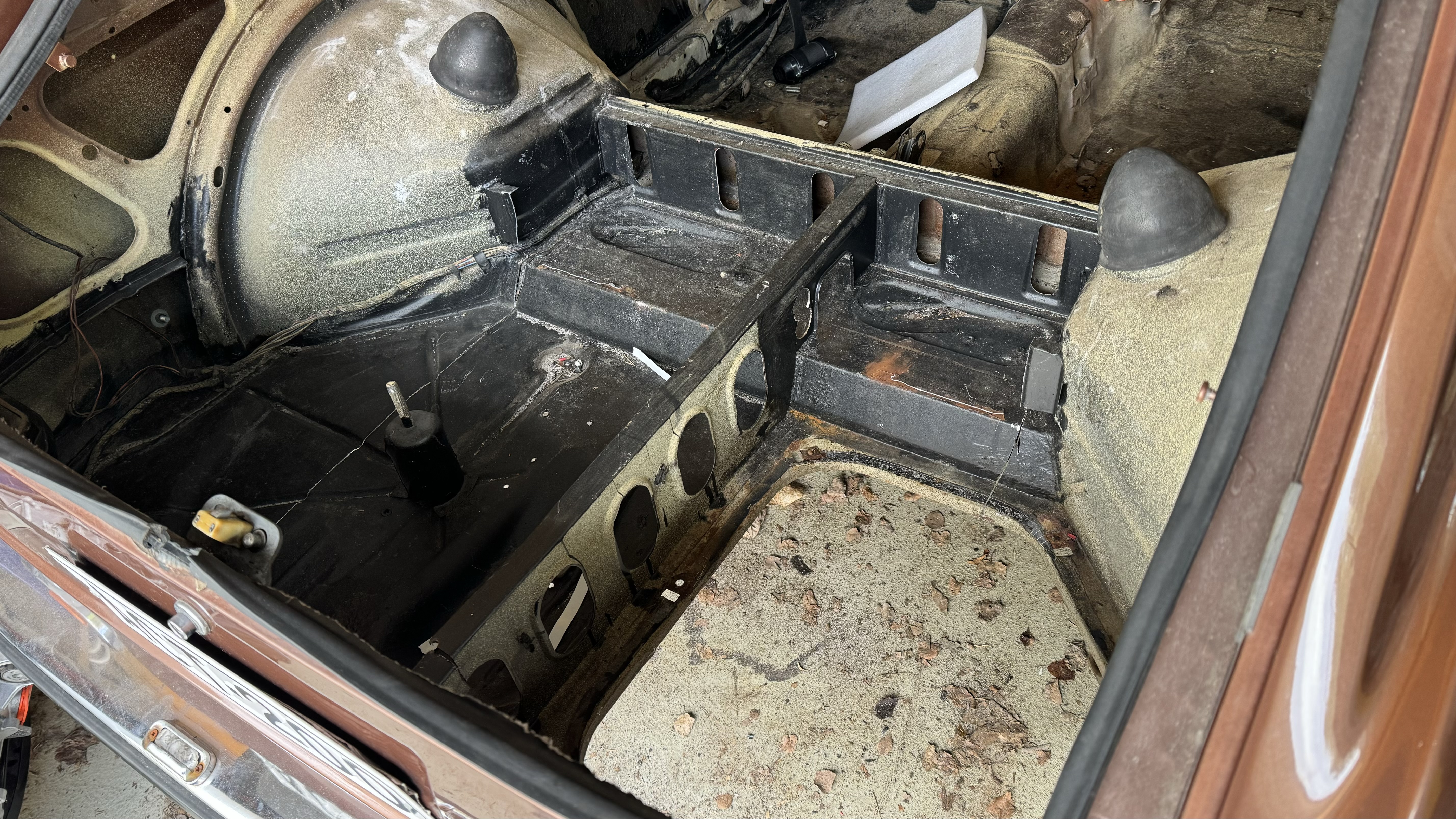

Cutting the trunk and subframe for making space for the motor. Next up, buy some metal profile for strengthening the rear and create mounts for the SDU.

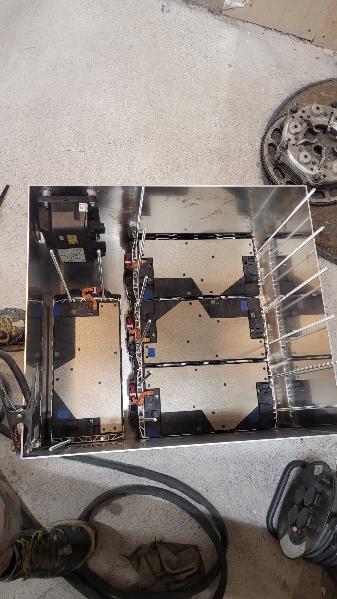

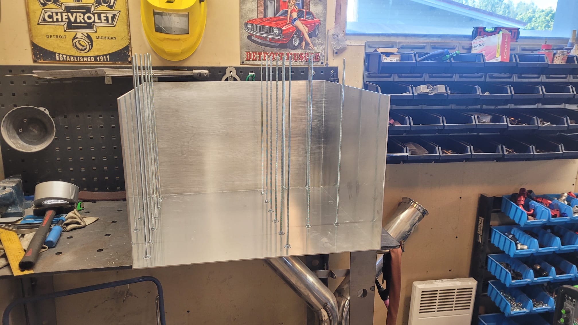

Battery box in works. 12 of these X5 modules will fit in engine bay, including safetybox. 3 levels of 4 batteries. Each level will have its own aluminum plate to help heat exchange.

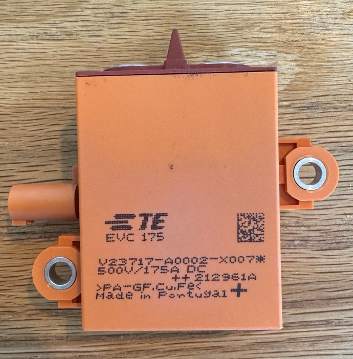

I'm planning to use BMW SafetyBox but now when opening it up I can see that contactors in it are rated for only 175A. (TE EVC 175). I have Tesla small drive unit (SDU) which can pull 600-700A for few seconds.
I was thinking that these contactors were rated for too low amps but looking at the specs https://www.te.com/commerce/DocumentDel ... F1308008-1 it says "Short term current rating: 500 A / 0.5 min; 1,500 A / 2s". So I think these contactors will work with SDU and even with LDU, as it won't pull 1500A more than few seconds.
What do you guys think? Anyone have experience on these with SDU?
AMP3R
Posts: 125
Been thanked: 53 times
Re: [WIP] BMW E6 - 2002 Touring
Post by AMP3R »
They will be welded
mane2
Posts: 251
Has thanked: 40 times
Been thanked: 41 times
Post by mane2 »
AMP3R wrote: Thu Jul 04, 2024 8:48 am They will be welded
Do you know for a fact or just guessing? Looking at the specs, they shouldn’t get welded.

mane2
Posts: 251
Post by mane2 »
That is different contactor from different SBOX. BMW 330e box, this is X5 box.
That Panasonic contactor specs say:
“ Max. Carring Current 120A Continuity
225A 3 min.
400A 30 sec. (38mm2 wire)”
This TE one is beefier and according to specs, it should cope.

mane2 wrote: Thu Jul 04, 2024 9:13 am That is different contactor from different SBOX. BMW 330e box, this is X5 box.
225A 3 min.
Did the Greg ever say how or why the contactor welded? I know he had a shot precharge resistor somewhere along the way, that definitely could have injured the contactor if it's all the same group of events I'm thinking of.
It's not easy to build things like this at the edge of a spec. It's definitely easier to overbuild it.
The rest of the bus bars, etc inside the box are likely built to the same current specs, so it would likely be use the group or do something else in it's place.
Will your battery be able to put out that much current? And with that light of a car and that much power you'll be at top speed in what, 14 seconds?
If you're carefull with your inverter current settings you might be ok for road use. But it might fail if you're doing an autocross / track event. You can keep an eye on it knowing you might have to upgrade it or do it now.
I'd try to use it as it's and datalog a bunch.
And make sure the precharge resistor is good before you install it.
mane2
Posts: 251
Post by mane2 »
Thanks for the tip. I'll check the precharge resistor.
I'm using 12 of those X5 modules, I don't know how much they can put out amps, but as there are double amount of parallel cells compared to 330e and 530e batteries, it should give me double the amps that those batteries can put out. Not sure if anyone has tested these.
Busbars seems to be sturdy on the box. I don't think that's going to be a problem. But those BMW specific spade connectors seem bit flimsy side. Not sure how much current those can take. They are short though.
Yeah, I'll start upping the max current once I have everything in place. Maybe add temperature meter inside the sbox.. Or maybe sbox already has one?

I think Greg swapped the BMW contactors for Leaf ones as they were better rated and were a direct drop in but don't quote me on that... Ask @Gregski

mane2 wrote: Thu Jul 04, 2024 7:38 am I'm planning to use BMW SafetyBox but now when opening it up I can see that contactors in it are rated for only 175A. (TE EVC 175). I have Tesla small drive unit (SDU) which can pull 600-700A for few seconds.
I had one of those inside Jaguar Ipace contact box. I am sure it shouold work with 500A. It also include economiser inside...
Its just that contct surface is a bit smallish...

arber333 wrote: Thu Jul 04, 2024 8:50 pm I had one of those inside Jaguar Ipace contact box. I am sure it shouold work with 500A. It also include economiser inside...
Thanks, very good to know! Then it will definitely work with SDU as the Ipace puts out a lots of amps!
