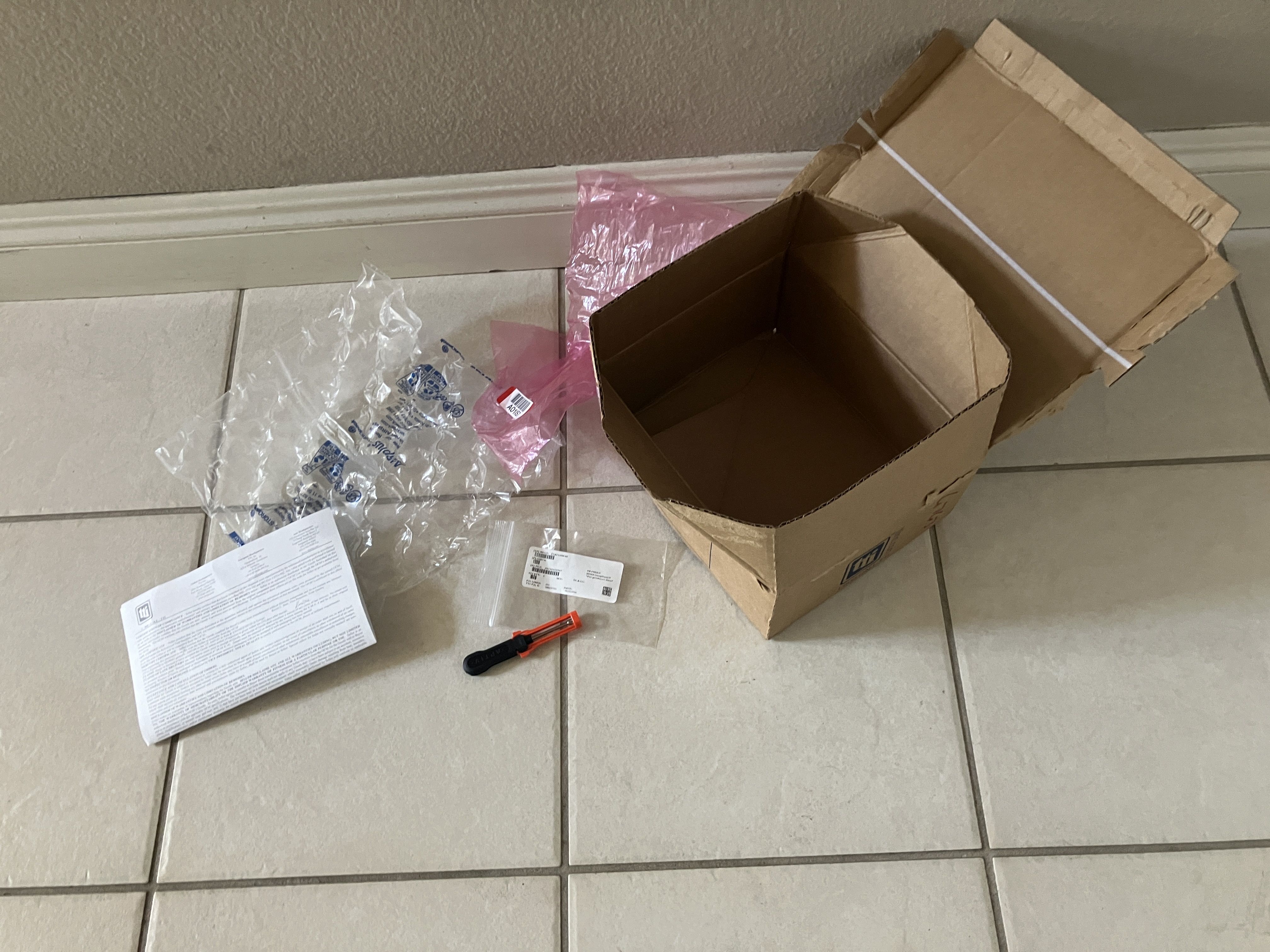

not sure where this belongs so dropping it here, hope it helps somebody out
REMOVAL TOOL FOR FEMALE TERMINALS
Manufacturer: Aptiv (formerly Delphi)
TTI Part Number: 210S048
Mfr Part Number: 210S048
Price: $65

used for depinning this type of harness from AliExpress
the orange thing appears to be just a shield to either prevent the tool from getting damaged or you from getting cut, maybe

Thanks for info, have been removing some with less sophisticated jewelers screwdriver method.

thanks gregski! This feels like something that should be documented in the wiki, but where would a good spot be?
update: I added it to the hardware section immediately after the prewired connector w/ leads line item
unfortunately formatting is terrible because I don't really know what I'm doing

a Specialty Tools section wouldn't hurt
