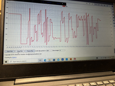

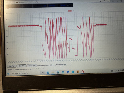

I am now pretty sure that this is an issue with my syncof value, because when I change it the behavior changes. At syncof 12900 the motor spins smoothly in the forward direction, and yields good throttle Controll, but seems slow, and if I put it in the reverse direction it runs away immediately. I tried adding 32,768 to the value, but this did not solve the issue. I am having a lot of trouble finding the correct syncof value. It appears there is one trough around 10k and another around 45k. My testing battery is only ~75 volts. I am wondering if anyone can comment on how this resolved feedback looks? I have tried changing the resolver wiring configuration without success. The first photo is with Data points 1000, burst length 10, and the second is data points 10000 and burst length 100. Thank you very much!

Re: Need Help: Inverter goes to full throttle during testing
See if you can find my Prius thread from when I started with Prius motors etc. on mobile so can’t link to it easily.
The upshot is there are syncoff points which look right but only one is really right.
There is also a Prius thread about achievable output and on the back of that I swapped to a phev setup before I installed anything.

I now have snycofs at 10,000, and when field weakening was disabled the unloaded motor spun well in both directions, with the same resolver as provided the plots above.
