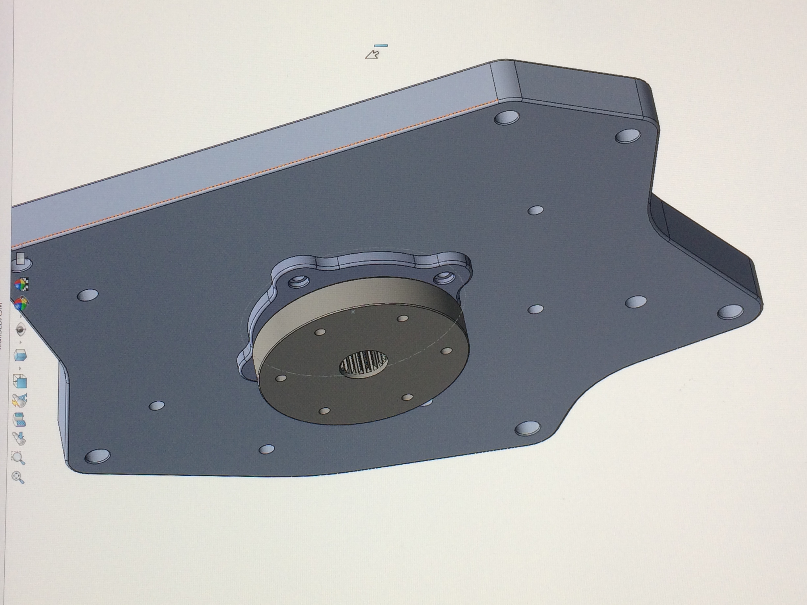

gen1 (em67) and gen 2 leaf motor (EM57) shaft coupler
4149 chromoly steel
-designed to optionally mate with a 7208b angular contact bearing (removes any loads on the leaf motor shaft)
additional machining required
Adapter plate CAD :https://github.com/angusjo/leaf-splines ... ate.SLDPRT
When the bearing is utilized, mounting flywheels or drives shafts is possible.
260$ CAD + shipping
I hold no liability for any results occurred from the use of the coupler.

Whats the plan on cutting the splines? EDM or broached?

Broached currently, still looking at edm services.
Cnc service is the most streamlined/best cost from what I’ve seen

Broached will likely be the cheapest in the long run (after the cost of the broach is overcome).

I’m thinking of leaving out the bolt pattern, so it’ll be blank. So what ever pattern anyone wants they can mill it after the fact.
Also making it compatible with a variety of 1 1/2 bearings so you can connect a flywheel or drive shaft.

That's probably ideal. Any common machine shop should be able to do any desired pattern, but EDM or broaches are few and far between. Im in for one for sure with no bolt pattern on it.

Ill try to dig out the specs. Spent a good amount of time setting the coupler up to be fairly universal for most people’s needs
What I currently access to.
was ether a 3in or 2.75 di plate with centring marks that match the rotex gs38 bolt pattern.
couple will nest in an angler bearing, with renting clip. For those wishing to run a clutch or drive shaft.
