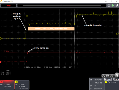

First, the wakeup sources
  1. Wakeup pin - bidirectional - level triggered (12V)
  2. Button - level triggered (GND)
  3. PP - optional via solder bridge - level triggered
  4. CP - Edge triggered
So the first 3 inputs will force the Foccci on. It can't turn itself off as long as that wakeup source is active. The last input will only trigger when transitioning from invalid to valid PWM and then Foccci can decide how long to stay awake. All modes always work regardless of software settings - except PP wakeup which can be turned off in hardware.

wakeup via PP disabled, WakeupPinFunc=PulseOnValidCp. Here we have a bidirectional wakeup bus. Any ECU connected to it can send or receive wakeup events and the individual ECUs can decide whether they are needed for a particular task or not.
  1. Foccci turns on as soon as CP PWM starts. So either a cable is being plugged in or is already plugged in and now wants to charge
  2. It then turns on the wakeup output for 1s and wakes up all other ECUs
  3. The relevant ECUs will detect that we want to charge and stay on, the other ones turn off
  4. If we turn on ignition the VCU is already on and in charge mode and can inhibit drive
  5. If charging is paused (i.e. cable plugged in but no CP PWM) and we turn on ignition the VCU wakes up the Foccci and queries PP status. If something is plugged in drive is inhbited
  6. If Foccci detects an error e.g. welded relays, it stores that error to flash. When woken up by the VCU it report its non-zero error code
  7. When charging is paused, ALL ECUs can turn off and no 12V power is consumed. When CP comes back, the cycle restarts

Foccci will then sleep 10s after CP stops pulsing and wake back up when it starts.

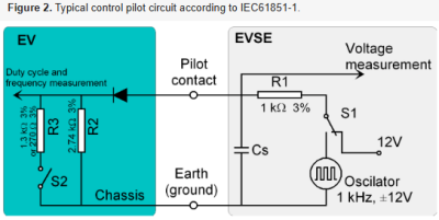

If your charging station tells you a CP error, it want's to say that it did not detect the circuit in blue box.
I see three potential root causes:
1. The charging station is defect and tells bullshit.
2. The wiring between the charging station and Foccci is wrong.
3. The Foccci does not behave like the blue box.
To find out, which of these is the case, I propose that you grab a diode, two resistors and a switch, build the blue box, and connect it to the charger. With this you can find out whether (1) is the true. And then connect the same circuit instead of Foccci, so you can check whether (2) is true.
The resistance measurement at the vehicle inlet is tricky, because there is the series of diode and 2k7, so depending on the multimeter it shows "something" above 2k7 in the one direction and "infinite" in the other direction.

uhi22 wrote: Fri May 31, 2024 6:58 am image.png
I tried with 3 evse. One is working and charging. Second is giving cp error. Also i guess evse ac charge station is like second.
I have small evcc for ac charging. Charger is working with it.
It is true. Because other charger is working and charging.
Why is charging one charger. Why is not behaving like blue side? What can we do
Also i connect 2.7k and switch and 1.3k. Charger is working with it
Also i measured the cp side with oscilloscope, pwm values are 26-27. That is no problem about it

Two ideas:
- check the voltage levels of the PWM with the oscilloscope. It should be -12V and +9V after plugged-in, and later, when the charging is active, it shall be -12V and +6V.
- Foccci does not contain more than the blue box. But if Foccci would have closed the state C switch, some chargers may complain because the switch should be open at the beginning and close later. Some chargers may not be interested in this, and may working even if plugging-in which state C is already closed.
[Edit] and another test: use a 12V power supply and a 1k resistor, to simulate the charging station. Connect this to your vehicle CP and PE. Expected is 9V in this case.

uhi22 wrote: Fri May 31, 2024 7:35 am Two ideas:
1. It is showing 5.6 volt in state b. I think no problem between states on focci.

5.6v is not state B. B is 9V.

uhi22 wrote: Fri May 31, 2024 8:18 am 5.6v is not state B. B is 9V.
Sory. Focci in state b, charger cp voltage is 5.6v
uhi22
Posts: 1117
Location: Ingolstadt/Germany
Has thanked: 206 times
Been thanked: 618 times
Re: Foccci wakeup/sleep discussions
Post by uhi22 »
This is the error. In state B the Foccci should have only 2k7 resistor, which leads to 9V nominally.
[Edit] On Foccci there is a LED for state C. You could try to switch this via the parameter ActuatorTest. This should lead to
- LED off, is state B, is 9V
- LED on, is state C, is 6V
[Edit 2] And check what the spotvalue AcObcState says. If it is "charging", the Foccci is expected to turn the State C on, and in the other cases it shall stay in State B.

I tried with 1k and power supply. As you said im measuring 8.76 volt on cp side. So we can say charger is not working properly.
Also i will look led for state c and obc state

Every time I plugged home AC charger to the car with Focci 4.5, I heard short contactor sound from the charging station. If Focci is already waken by button or before it goes back to sleep, charging station did not react.
Something to do with sleep, so I added pull-down resistor from STATE_C_CONTROL mosfet gate to ground and now Focci does not shortly activate CP.
Please, use resistors with mosfets, those are important while uC is waking. Second option is to use mosfets with internal gate resistor.

Does it run the latest or recent firmware? It instructs pull-down in boot loader.
Probably still a good idea to fit pull down resistors

Latest firmware yes and for bootloader could I have used the same v5.2 stm32_loader.bin as for zombie, I think so?
Post by uhi22 »
Confirmed the state C issue during wakeup. Which bootloader would fix this?
