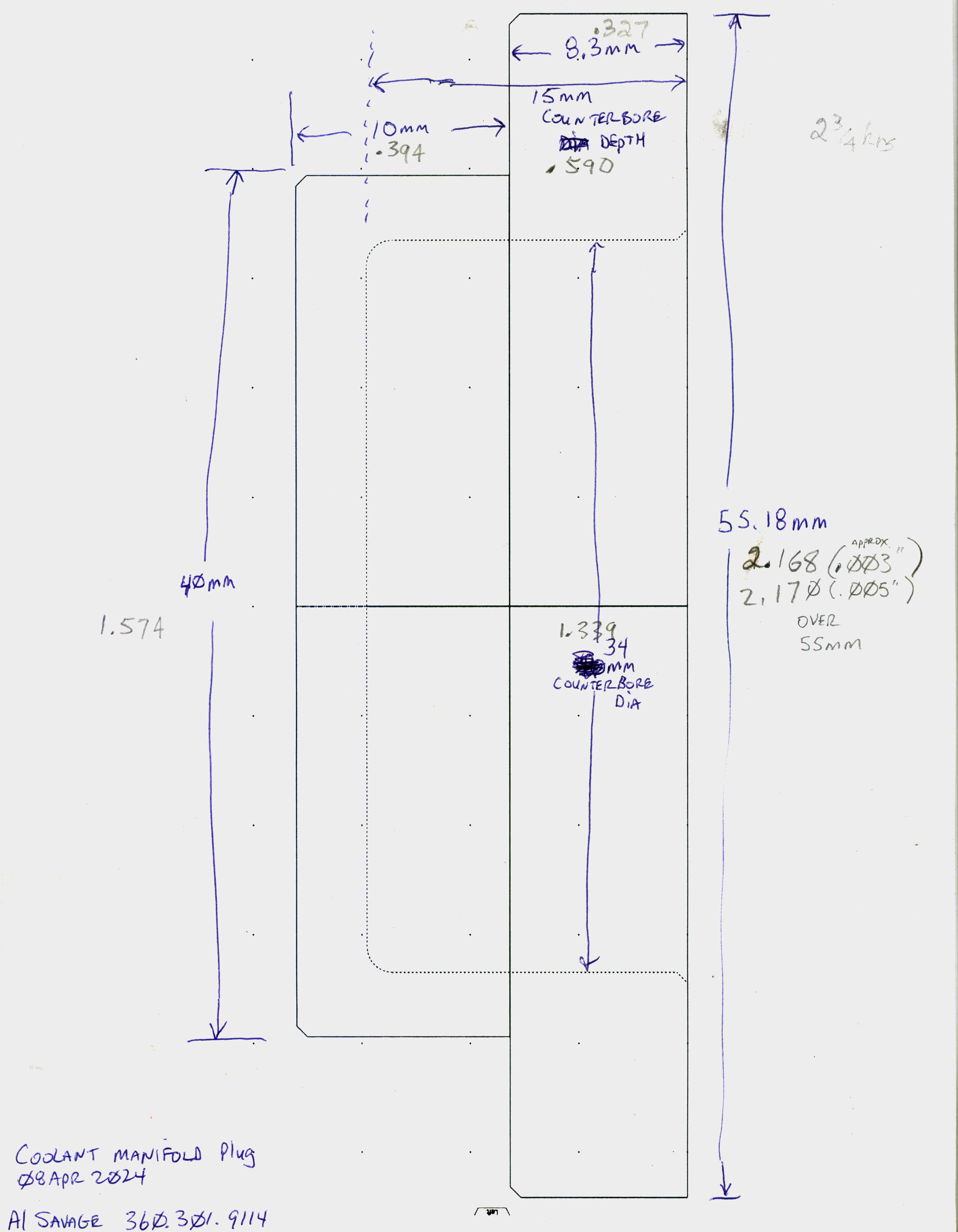

Bit of crossposting: coolant manifold plug of 6061:

I’ve bitten the coolant delete bullet too. Just fitted this from Revolt Systems in California. My car is used as a Daily, so didn’t have the time to have off the road whilst the existing manifold was modified. Took about 2 hours to fit.
What do you use for seal material (brownish on the maifold)?
And do you have any drawing or cad file for the plug you like to share?

That picture is misleading; if you follow the link, it makes more sense. The red gasket you see above is for the pressure test jig I set up to provide proof positive that the plug would not leak.
The red gasket is not used for mounting to the LDU.
Follow the link, please.
Howard & Mr. Hyde have a batch of SS formed sheet metal plugs coming, that will be cheaper than machined aluminum ones like mine. If you follow that link, you'll read that my two plugs were machined locally by a fellow who doesn't want to get into production; he does only one-off prototype stuff like this.
If there was sufficient demand, I could have a run made by eMachineShop.com . If I bought around (50), I could sell them for about $30 + shipping, but I doubt there will be sufficient demand, and the SS sheet metal plugs will be cheaper; most people will probably want to go that way instead.
I prefer the machined aluminum plug, myself.

Lots of places do machining. I got one easy quote from one place, got a ballpark figure, and I'm not interested in chasing lower prices or lower minimum quantities. I'm retired and don't need the hassle of retail sales again. I already "sell" pre-assembled ethernet cables for the Tesla Powertrain Diagnostics program used in the RAV4 EV, and that's been hassle enough. Plus the inevitable people who receive something and then don't like it/claim it doesn't fit/claim it ruined their LDU/etc. Not gonna be me.

Yup, could be done with an o-ring seal instead of Loctite 640 . . . but I discarded that idea fairly early on a year ago. A mechanical retainer would be required, as you noted. And there's no need to ever remove the plug for any reason, so why bother with installing a failure point (o-ring)? Gluing and pressing it in is adequate and has no downsides over an o-ring seal.

The second plug, .005" oversize + Loctite 640, passed 30 PSI for two hours with no leakage. 30 PSI pressure differential is at least ten times what that plug should ever see, so I was satisfied with the result.
I found a drawing (yours?):
Are these the dimensions you used? (you mentioned .005 oversize which would equal 0.127mm so perhaps reduce 55.2 to ~55.1mm)
I have a contact that can help me mill and lathe so I will go and try this.
Plan to seal the cap with loctite 638 or 648.

That's not mine, though roughly the right idea. Some of us batted around several sets of dimensions. You'll notice that there's no counterbore dimension on that drawing, and it's 2mm too shallow IMO. And I wouldn't normally specify outside radii such as that; from an engineering standpoint, I prefer chamfers on outside 90° edges, and radiused corners on inside ones.
This is the drawing I handed to my lathe man. mm in blue ink, inches in pencil. Scale is correct.
I believe that the SS formed sheet metal plugs coming are 55.2mm (.008" OS) and are designed to deform & crush into place, similar to a seal cage. I am skeptical that that much interference fit is needed/desired in a more-solid 6061 plug, so I started with .003" OS, and while that would have worked fine, I liked the fit of .005" OS better. I have a "feel" for this, but while I worked in a mechanical engineering department with real engineers, I'm not one myself, and am more of a cut-and-try man when it comes to this kind of thing.
Also, the lathe man agreed that .003" would be "enough", so I let him convince me
And, with the lightly pressurized system in the LDU, and an appropriate sleeve/bearing mounting compound, it would be.

LDU Rotor Temp Monitor update
Last night, I got a first run in with the temp monitor working. It's still a lash-up, things taped down to the console, running off a power tool battery, etc., but real readings. Summary: the highest reading I saw on a 30 mi. drive was 182°F (83°C).
At rest after sitting all night:
Back home in my driveway after 30 mi.:
