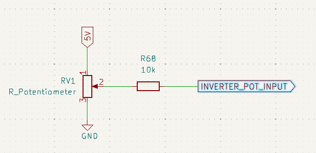

On many older logic board designs and that includes all Tesla boards, the throttle input is 0-3.3V. In contrast the throttle output of many typical automotive pedals is 0.8-4.2V. So it will max out the ADC and potmax must be set to 4095 to operate in such a setup. This disables the upper range check because 4095 is considered a valid pedal position and values greater 4095 are not physically possible.
To address this, a 10k resistor MUST be put in series with the pedal like so
This forms a voltage divider with the onboard pull down and results in a maximum valid throttle value of around 2000-3000 digits. With that configured the range check is active, will treat values > potmax+200 as invalid and cut out throttle/coast to standstill.
Addition: alternatively if you have a dual channel pot and only choose to use one, use the channel with the smaller 0.4 to 2.1V range
Then recalibrate your throttle setting.
While we do generally recommend using dual channel throttle wiring I also think it will not necessarily prevent the above just by itself. When both channels share a mutual ground they will both go fully pressed on loss of ground. Without a range check that is considered valid at least on one channel. Only completely separated ground wires will prevent a runaway.
On the software side I will limit potmax to 3500 in the next release and ship every new board with that limit to force people to implement the resistor mod.
On the hardware side all boards will receive the series resistor on board

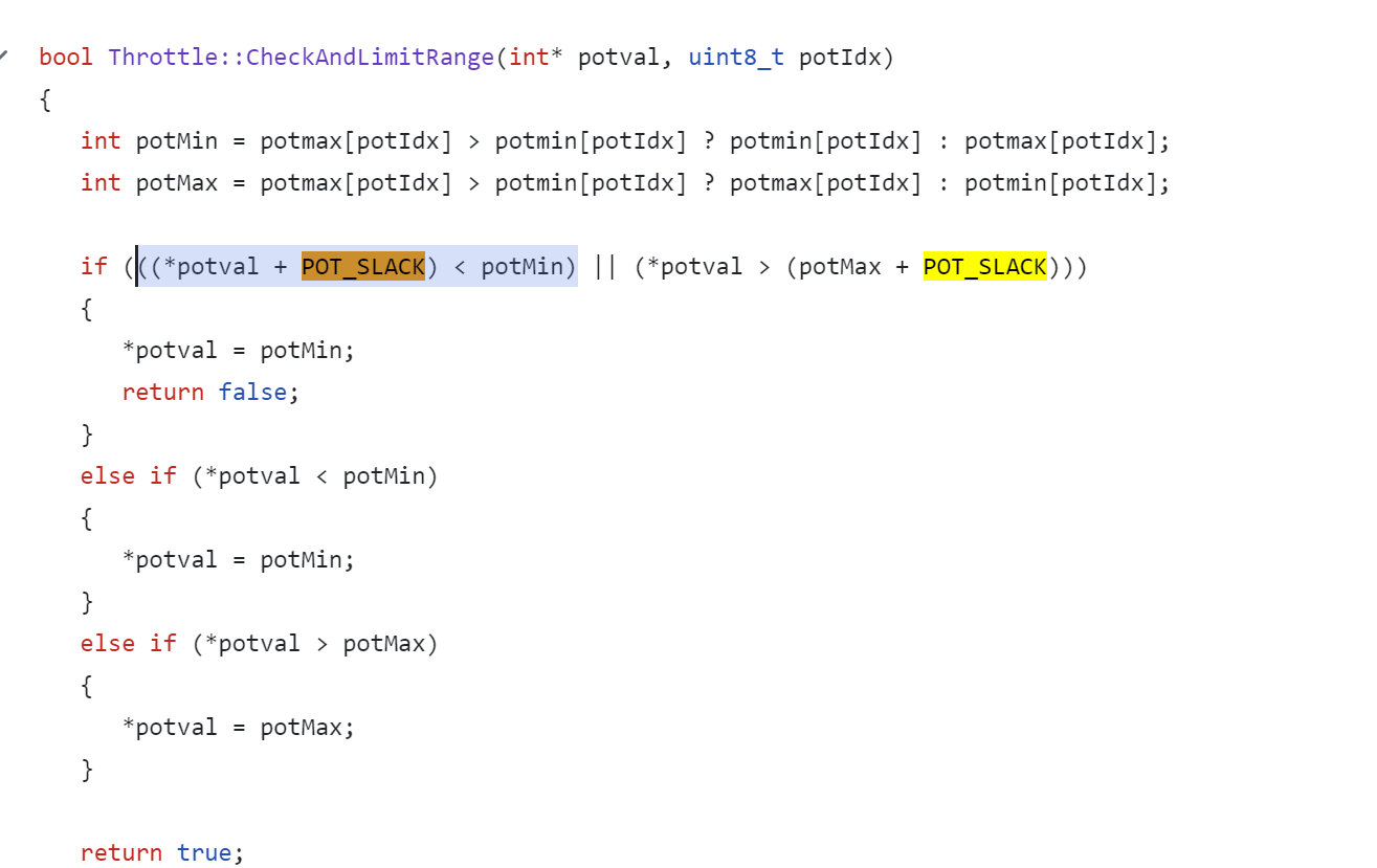

There is a 200 digit headroom above potmax. So anything above potmax will be interpreted as potmax. Once you cross potmax+200 throttle immediately returns to 0 because we assume that there is a wire break and the throttle value does not reflect the drivers command anymore.
That sort of points to "why 3500?". We need to be at least 200 digits away from 4095 which would be 3895. Now a loss of ground doesn't necessarily mean it jumps to 4095 because of the 10k pull-down. So lets move further away. 3500. Slightly arbitrary but spent some thought on it.
If the fault happens to be intermittent it will bounce around, yes. If it somehow fixes itself at least you gain control of your vehicle again. Hence why I don't just fully shut down on out of range errors. If you decide the vehicle is not drivable anymore you put it in neutral and coast onto the shoulder.

johu wrote: Wed Jun 05, 2024 8:59 pmThere is a 200 digit headroom above potmax. So anything above potmax will be interpreted as potmax. Once you cross potmax+200 throttle immediately returns to 0 because we assume that there is a wire break and the throttle value does not reflect the drivers command anymore.
Ahh. This is the piece I was missing. I thought it just immediately errored out and cut throttle. Okay, that makes sense.

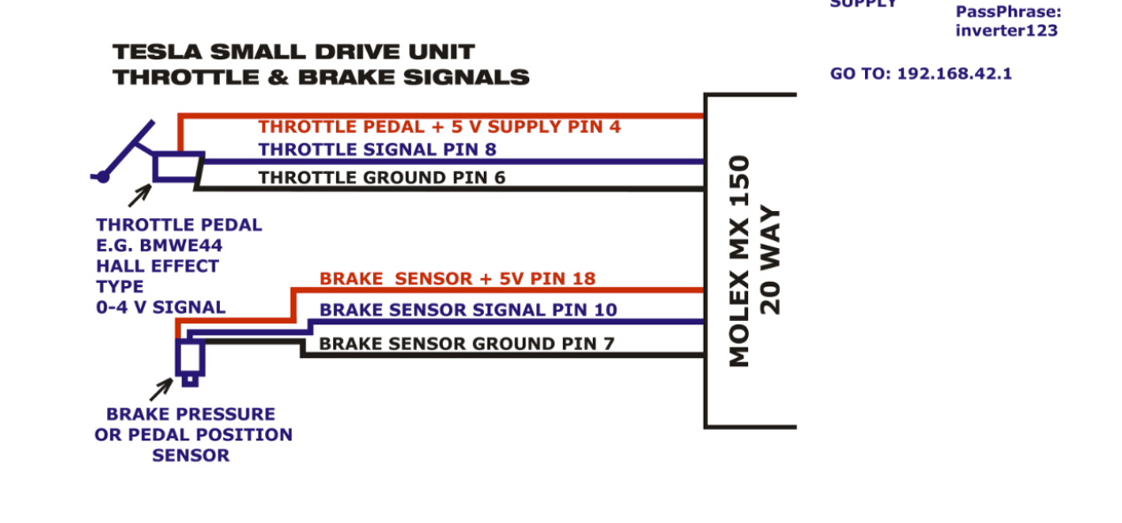

A bit confused on this point. If one follows the schematic (in my case SDU), the pedal (single or dual channel) are powered from the oi board. Are you talking about an instance when folks power the accel pedals from the external power supplies, not the oi boards? Else how can pedal output be higher than power supply.
Just checked the release. So the potmin should also be at least +200 points from the value when fully released?

alexbeatle wrote: Sun Aug 04, 2024 1:27 am A bit confused on this point. If one follows the schematic (in my case SDU), the pedal (single or dual channel) are powered from the oi board. Are you talking about an instance when folks power the accel pedals from the external power supplies, not the oi boards? Else how can pedal output be higher than power supply.
I have the same questions.

The board supplies 5V. So a pedal can deliver up to 5V signal. The CPU can only process up to 3.3V.
