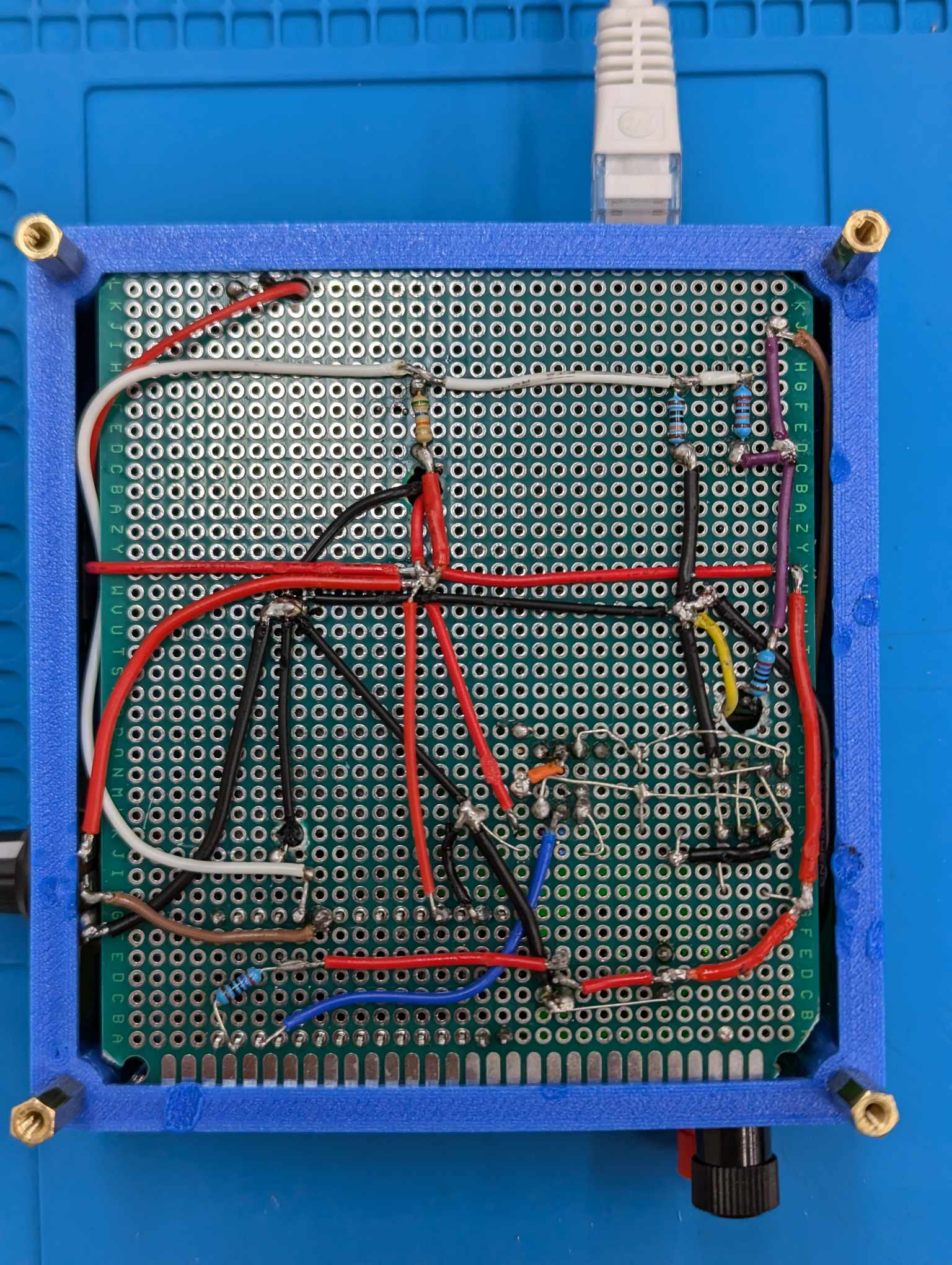

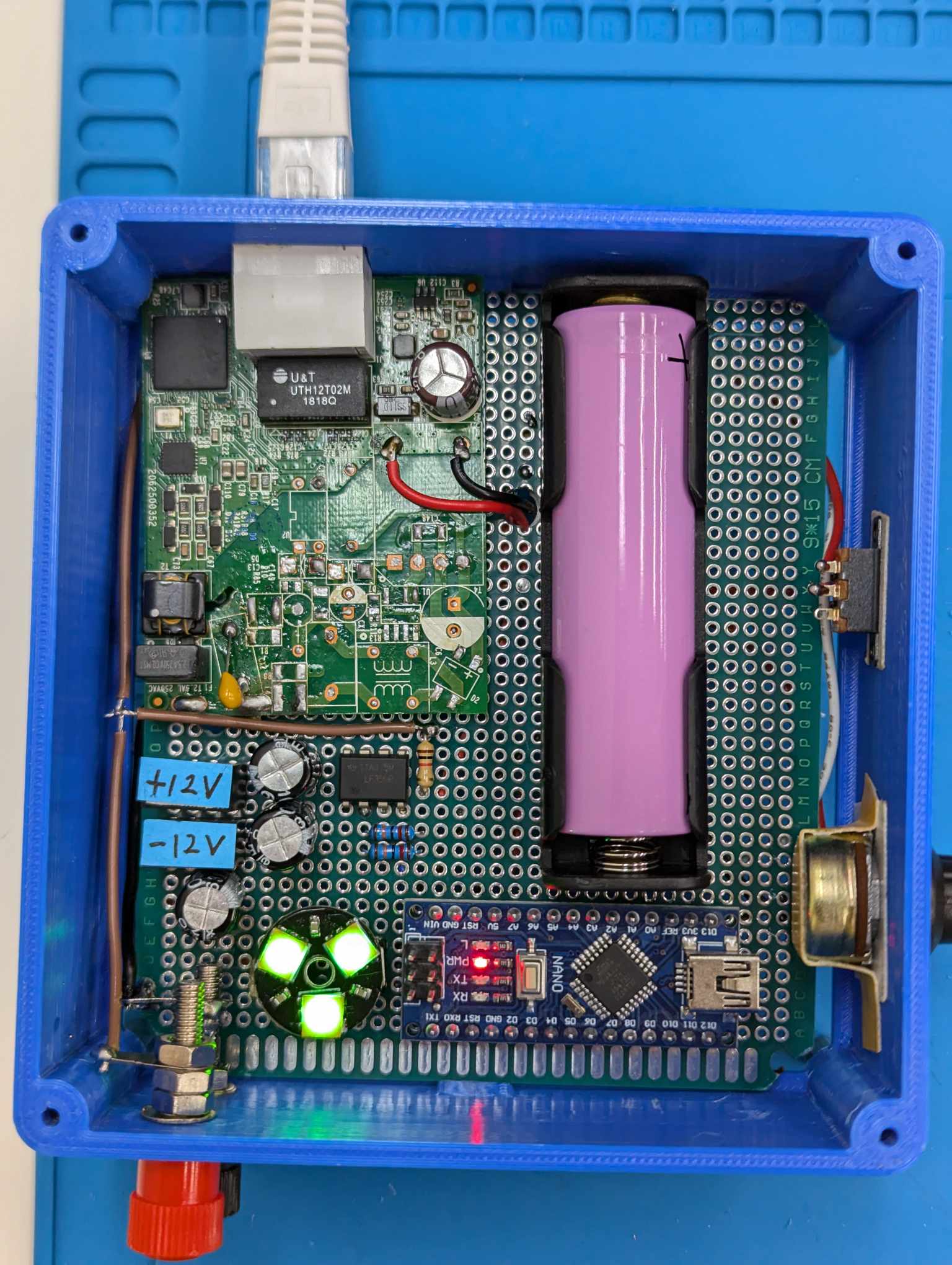

Building blocks
- controller: evaluates the voltage on the CP and generates the 1kHz PWM
- amplifier: gets the PWM from the controller, which is a 0V/5V signal, and creates a +12V/-12V PWM out of this.
- power supply: provides 5V for the controller and modem, and +12V and -12V for the amplifier.
- poti: lets the user adjust the intended PWM duty cycle. Gets 5V from the power supply and provides 0V to 5V to the controller.
- LEDs: show the status. Get a serial digital signal from the controller which selects the color and intensity of the LEDs.
- voltage divider: gets the CP voltage (which is in range -12V to +12V) and divides it to a range which the controllers analog-to-digital converter can process, i.e. between 0 and 5V. To be able to measure also negative voltages, the divider contains an resistor to plus, which create an voltage offset.
- homeplug modem: gets data from ethernet and modulates them according the Homeplug Green Phy (HomePlugGP) specification, and vice versa.
- homeplug coupler: connects the homeplug modem to the CP line. The goal is that it transports the radio frequency signal between the modem and the CP line, but also isolates the modem from the slow 1kHz 12V PWM on the CP.

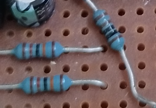

voltage divider
- 56kohm to 5V.
- 100kohm to ground.
- 220kohm to CP.
(The original schematic has 200kohm for R7, this would need a small adaption in the scaling factor and offset in the software.)
(pictures from https://github.com/uhi22/pyPLC/blob/mas ... vseMode.md and https://www.instructables.com/Arduino-E ... g-Station/ )

amplifier
is a LF353
The pin 2 of the opamp gets 2.5V from R8 and R9, 120kOhm each, between 5V and ground. (originally the R8 and R9 have 100k, but this does not make a difference)
The output of the amplifier goes via an 1k (R1 in the original schematic) to the CP.

The controller
- Arduino Nano
- Supplied by 5V
- Analog input A1 gets the scaled CP voltage from the voltage divider
- Analog input A2 connects to the middle pin of the potentiometer, to adjust the PWM ratio.
- Digital output 10 provides the 1kHz PWM to the amplifier
- Digital output 11 drives the WS2812 LEDs via a 270 ohm resistor
- Arduino code here: https://github.com/uhi22/WallboxArduino

The power supply
5V comes from an USB power bank. The 5V feeds the Arduino, the potentiometer and the WS2812 LEDs directly.
For the amplifier we need +12V and -12V supply. These are created by two isolated DC/DC converters, something like B0512S-1WR3.
To smooth the voltage, there are capacitors on the 5V, 12V and -12V. Something like 100µF.
