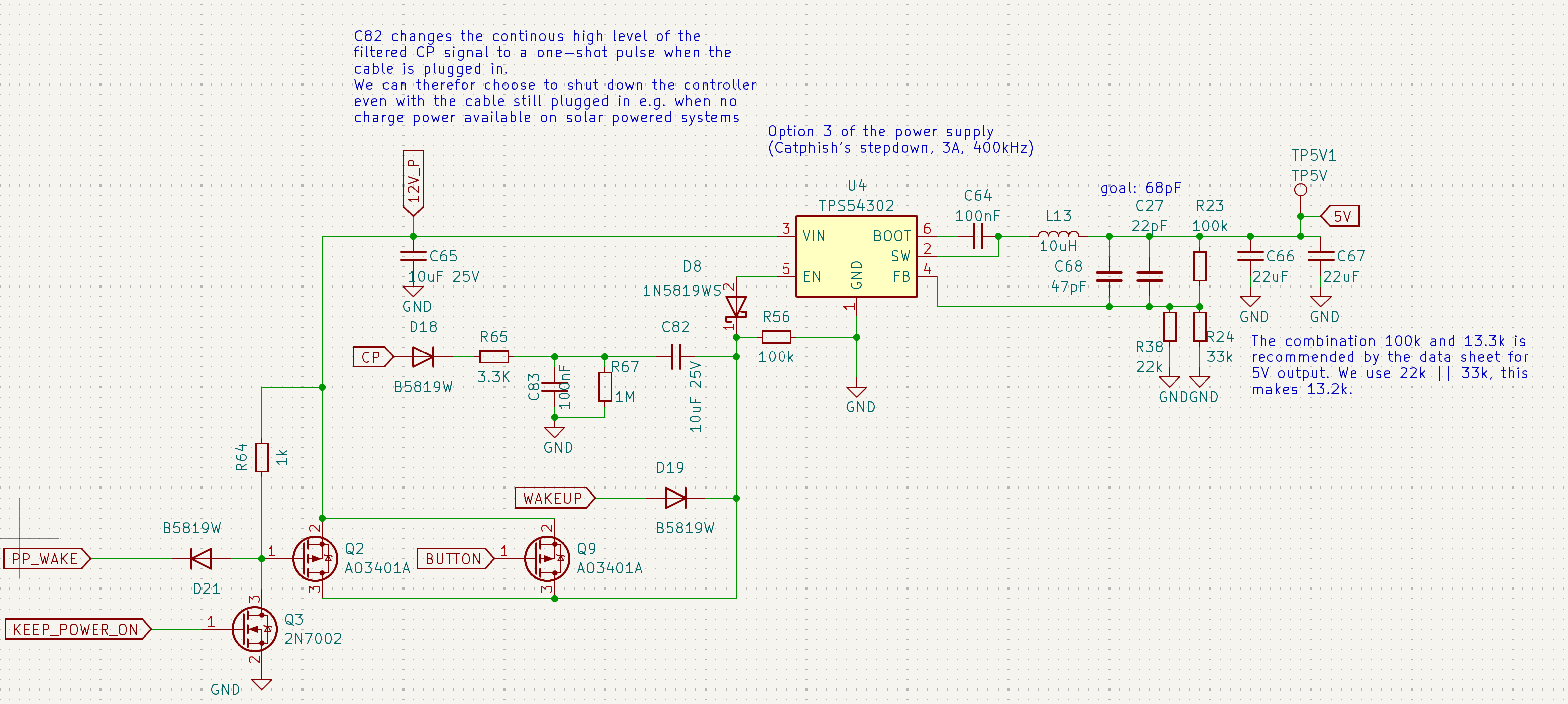

I try to understand the wakeup circuit.
The EN pin of the TPS54302 (U4) needs ±1.3V to power on. And it accepts absolute max 7V.
What does the 40V Schottky Barrier Diodes 1N5819WS (D8) with the 12V wakeup signal?
I would expect a voltage divider or an opamp circuit to limit the voltage for the EN pin.

Re: Foccci wakeup/sleep discussions
D8 ensures that EN is never driven high by anything. It has an internal pull-up. The various wakeup signals can allow that pullup to actually pull EN high. If no wake up source is active EN is forced low by R56
