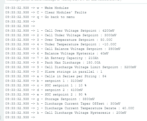

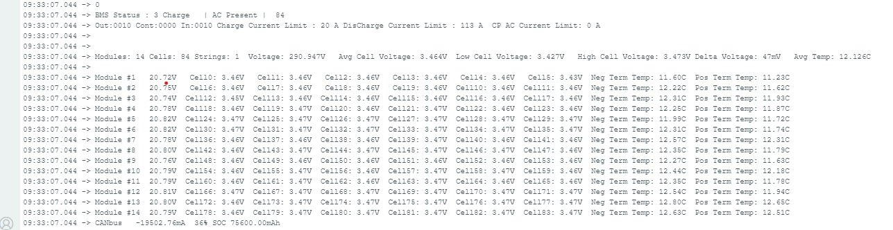

Hi, there.
Could you please help me understand. I don't quite see why my discharge current gets derated. I have max discharge set to 150A, but this morning BMS derated it to 30A. I didn't capture it at 30A, but below is the screenshot showing it at 113A as it seems to be slowly rising as I'm charging.
It's a cold morning, but the batteries where at 10C...11C temperature, when it derated the current to 30A. SOC was at 24%.
My understanding other than setting it to 0A, this is the only place in the code where the discharge current gets modified:
    //Modifying discharge current///
    if (discurrent > 0)
      //Temperature based///
      if (bms.getHighTemperature() > settings.DisTSetpoint)
        discurrent = discurrent - map(bms.getHighTemperature(), settings.DisTSetpoint, settings.OverTSetpoint, 0, settings.discurrentmax);
      //Voltagee based///
      if (bms.getLowCellVolt() < (settings.DischVsetpoint + settings.DisTaper))
        discurrent = discurrent - map(bms.getLowCellVolt(), settings.DischVsetpoint, (settings.DischVsetpoint + settings.DisTaper), settings.discurrentmax, 0);
However, looking at the snapshot of my battery cell volts and temperature, it looks as though it wouldn't fall within these conditions.
I'm on a forked firmware 230719, but the fork changes are related to the CAN messaging, and relay control.
Please let me know if I'm not seeing the obvious.

Posts: 2418
Location: Bristol
Has thanked: 209 times
Been thanked: 574 times
Re: Simp BMS
Literally here.
Your settings:
settings.DischVsetpoint = 3200mV
settings.DisTaper = 300mV
So if your cells are below 3500mV limit discharge.
The settings for Discharge Hysterisis is for allowing discharge again when the cells have risen by 200mV (your setting) from Discharge limit setpoint.

Looks like my coffee didn't slap me hard enough this morning to wake me up. Thanks for doing that instead, Tom :D
3500mV translates to 42% SOC per my setpoints (3100mV=10%, 4100mV=90%). I'm curious, do commercial vehicles start to derate at 42% SOC or my setting are too conservative?
