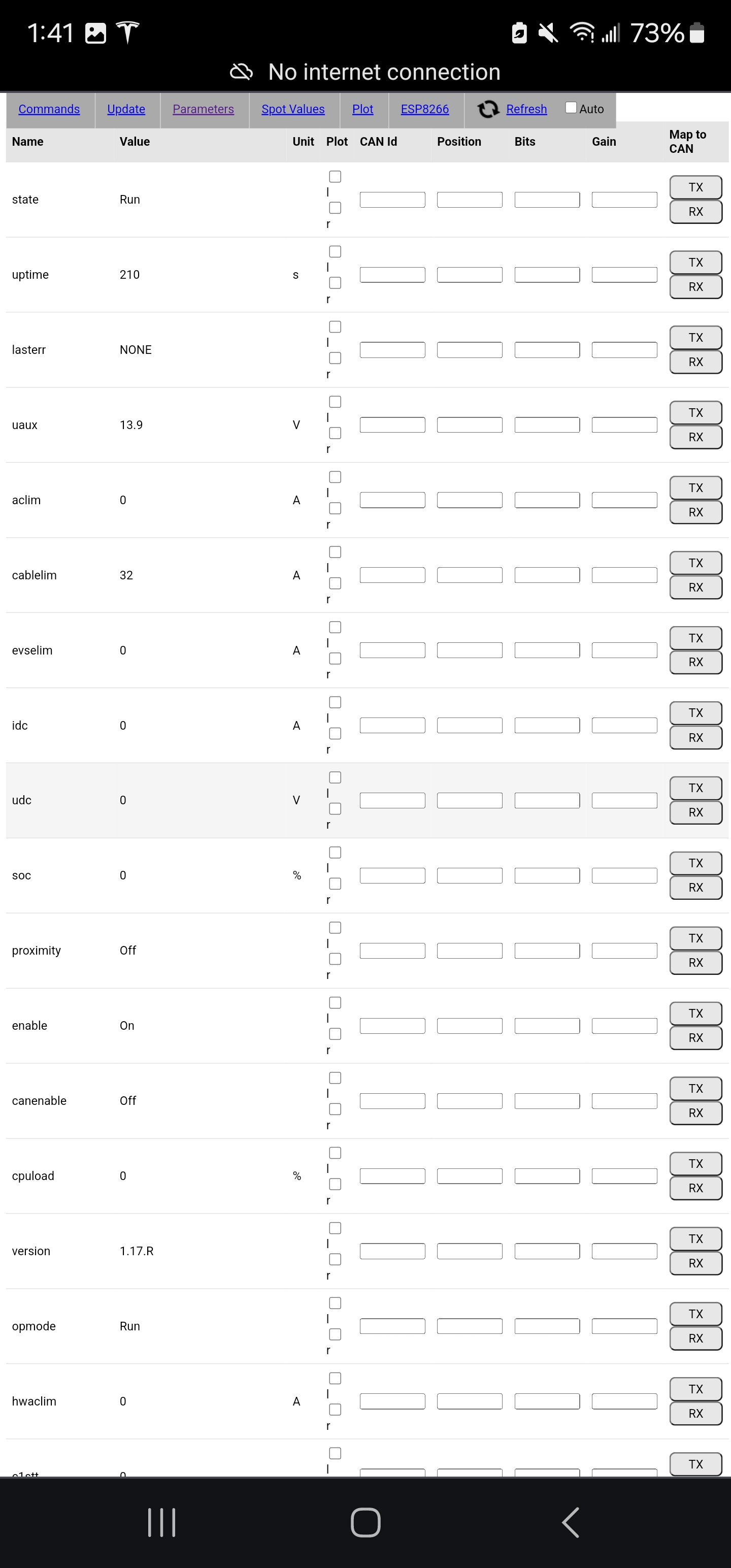

I have a Gen 2 tesla Charger with the open source board in it. I am using it with a Vero BMS and their j1772 charge controller.

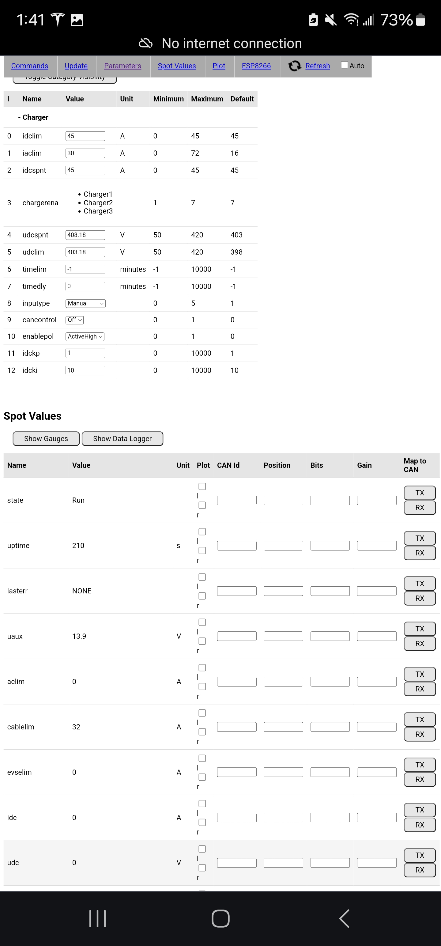

Since this is my first time using this charger, I set it up as simple as possible. It's in manual mode so once it receives power on the enable pin it should start charging.
My setup is as follows -
1)Charge cable is inserted into the j1772 plug
2) Vero bms outputs positive signal to begin charging
3) this positive signal actives j1772 port (through simp charge) and turns on Tesla charger. Tesla charger has power and enable wired to this positive signal.
I hear the EVSE click, and even see it flashing indicating it is charging. However, there is no amperage coming out of the Tesla charger.

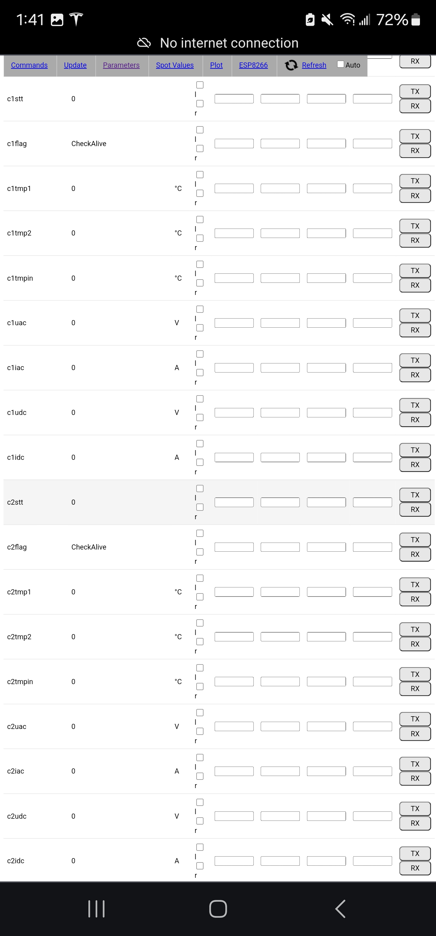

The tesla charger has red lights on all 3 main boards, and everything else seems to be fine.
I will upload my parameters as well as spot values while I am attempting to charge.
Anyone have any ideas as to why its not charging?

Maybe you dont connect EVSE PP signal? In general you bring GND to PP signal to activate Gen2 charger. If i remember correctly connecting Enable signals will only light ONE red LED. When you show the charger PP signal it will activate another set of LED and start the process of charging.EVsRock wrote: ↑Mon Jul 01, 2024 10:02 am I have a Gen 2 tesla Charger with the open source board in it. I am using it with a Vero BMS and their j1772 charge controller.
Your charger will also require Cp signal to determine the amp limit...
I am not sure if manual charging will work like that...

None of your info for the phase modules populate also there seems to be no HV connected to the charger. Please also not HV to the charger and the AC voltage being applied must happen at nearly the same time, within a few seconds or the charger may not work.

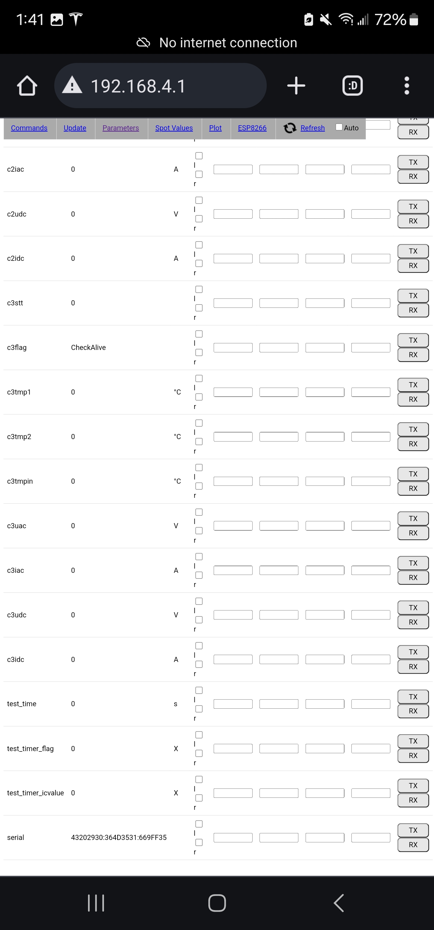

I also suspect a CAN termination issue or bus short circuit as the control board receives absolutely no data from any if the three charge modules. Even if the battery is connected correctly you wouldn't see it because... No data
