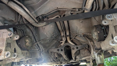

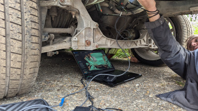

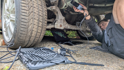

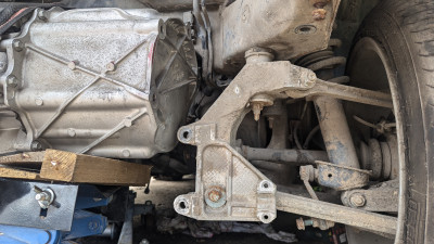

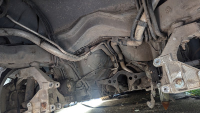

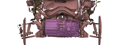

Here are some of our efforts in scanning the underside of the car, and some attempts to fit the model 3 rear motor (in its native orientation).
Long story short it won't fit without a lot of chassis mods, and there are no solutions which enable it to be run in reverse currently, so out of the question.
The Tesla, SDU, by contrast looks like it might fit with little / no mods.
Check out the 3D render...

In terms of proximity to the sub frame, yes this fouls on the sub frame mounting points left and right, but it can be raised quite a bit. I took a photo of the underneath to illustrate -- the large coolant lines above the current motor location can be moved / removed, allowing it to be raised and tilted forward. I'm hopeful I'll be able to make it fit with minimal / no sub frame modification.
Mazda RX-8

I would say a Tesla RDU wont really work without massive changes to the aluminium subframe members which I would steer clear of. Also massive lack of clearance around it to the subframe even if you remove the mounting points for the rear crossmember.
Possibly a Front Drive Unit will work given it is angled back. I do not have a reliable model to position in the scan. EDIT found one https://grabcad.com/library/tesla-front ... -3d-scan-1

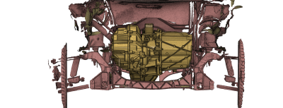

Here is what I taught with a Front Drive Unit, it is tight to the body above the subframe but alot better as you are in a wider subframe section.
You would want to rotate the drive unit down from having the cooler horizontal, till you get clearance.

My fusion skills are very weak, but i've been doing some playing with the models and it looks like it might fit...just...

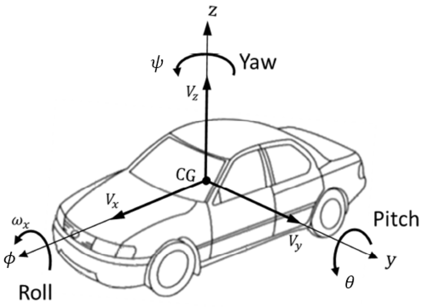

I had to pause the YouTube video after each step to learn how to use blender for this and do it a bunch of times. I still end up pulling up this video occasionally for the keyboard shortcuts still.
As for origin, if you are doing automotive cad look up ISO 8855 and SAE J670e, I use iso 8855.
This way it's oriented properly for say suspension analysis but check the tool you plan to use for which method(s) it's compatible with.

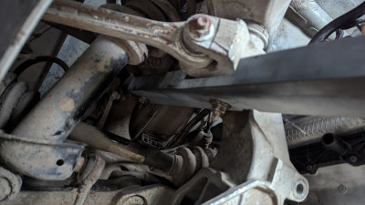

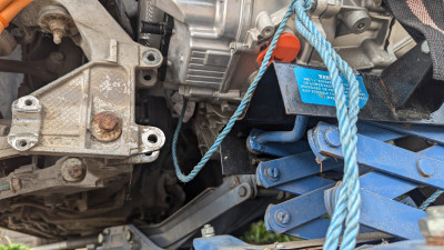

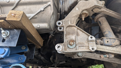

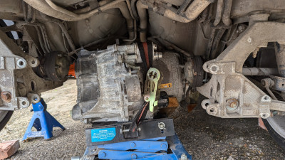

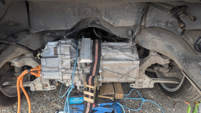

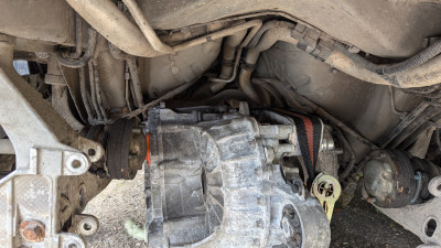

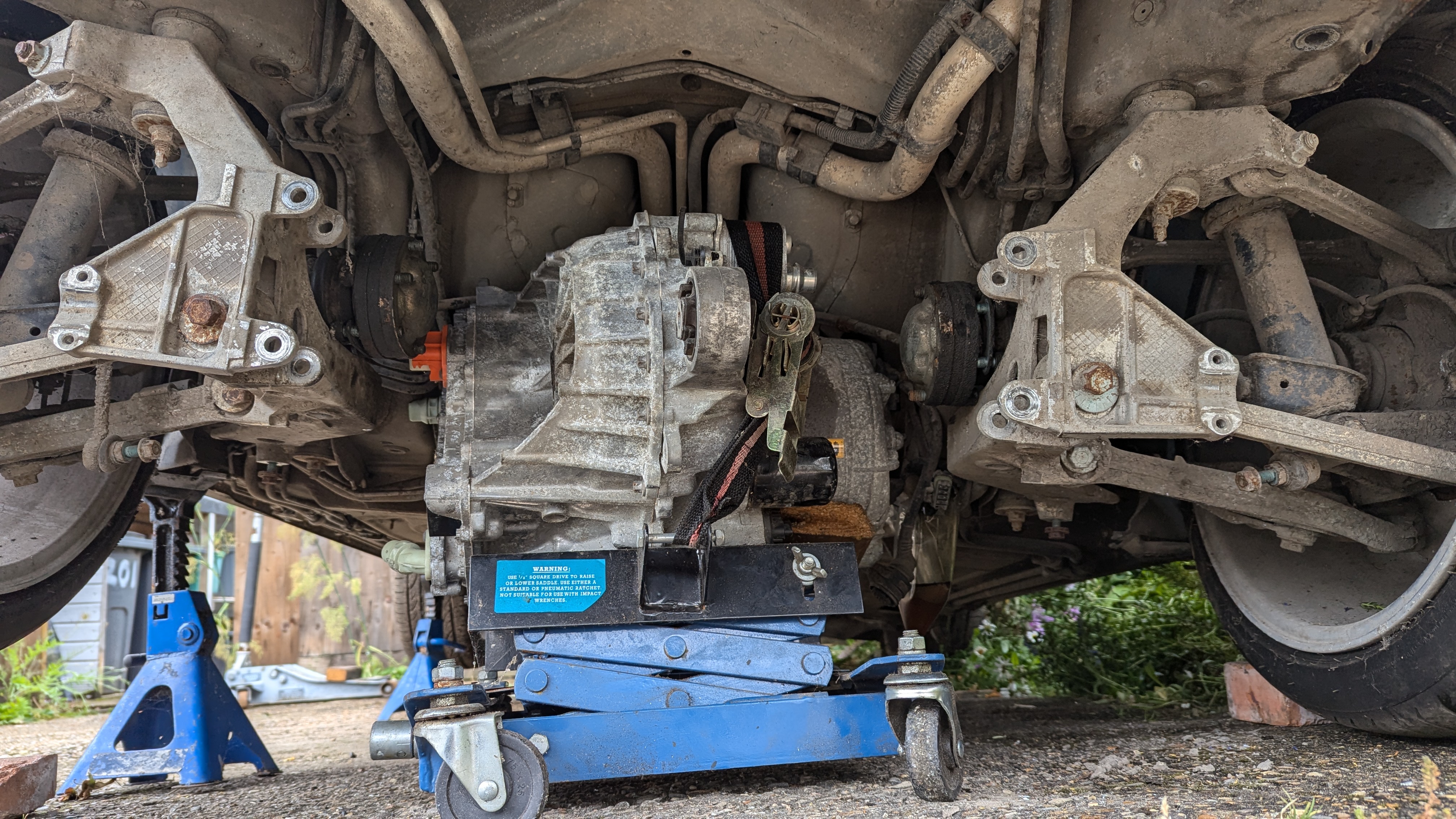

Well it's going to fit. There's no replacement for doing it for real so i got a friend to help test fit and plan some mounting strategies. There isn't a huge amount of space but there's enough, and plenty of options for mounting.

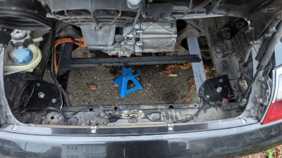

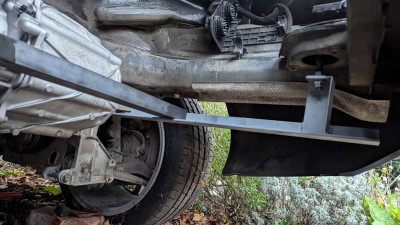

So I've been working mainly on my RX8 project but haven't forgotten the Porsche. I've been focusing on trying to design a frame which will require no body modifications.
Here's what I've come up with. Two parallel lengths of 60*30*5mm angle mounted on both subframe bolts and the rear hanging from where the original engine mounts once lived.
The rear mounting design will change to avoid using the threaded rod but for now it helps with adjustment, and this design was based on using the existing engine mounts which i subsequently decided against.
There will be two cross - beams (one pictured). The one next to the motor will house a motor mount and act as a front mount for the battery box which will bolt up into it. A similar cross beam at the back will be the rear battery box mount.

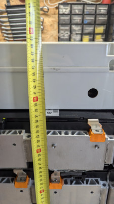

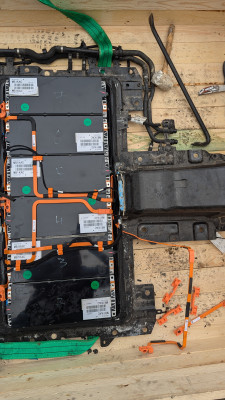

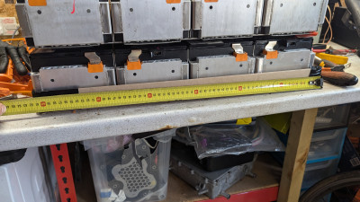

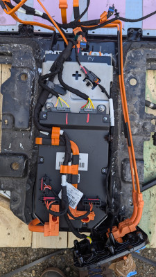

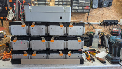

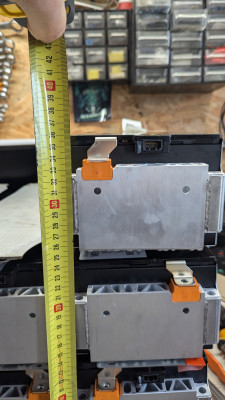

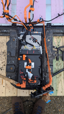

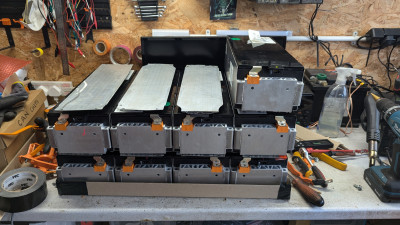

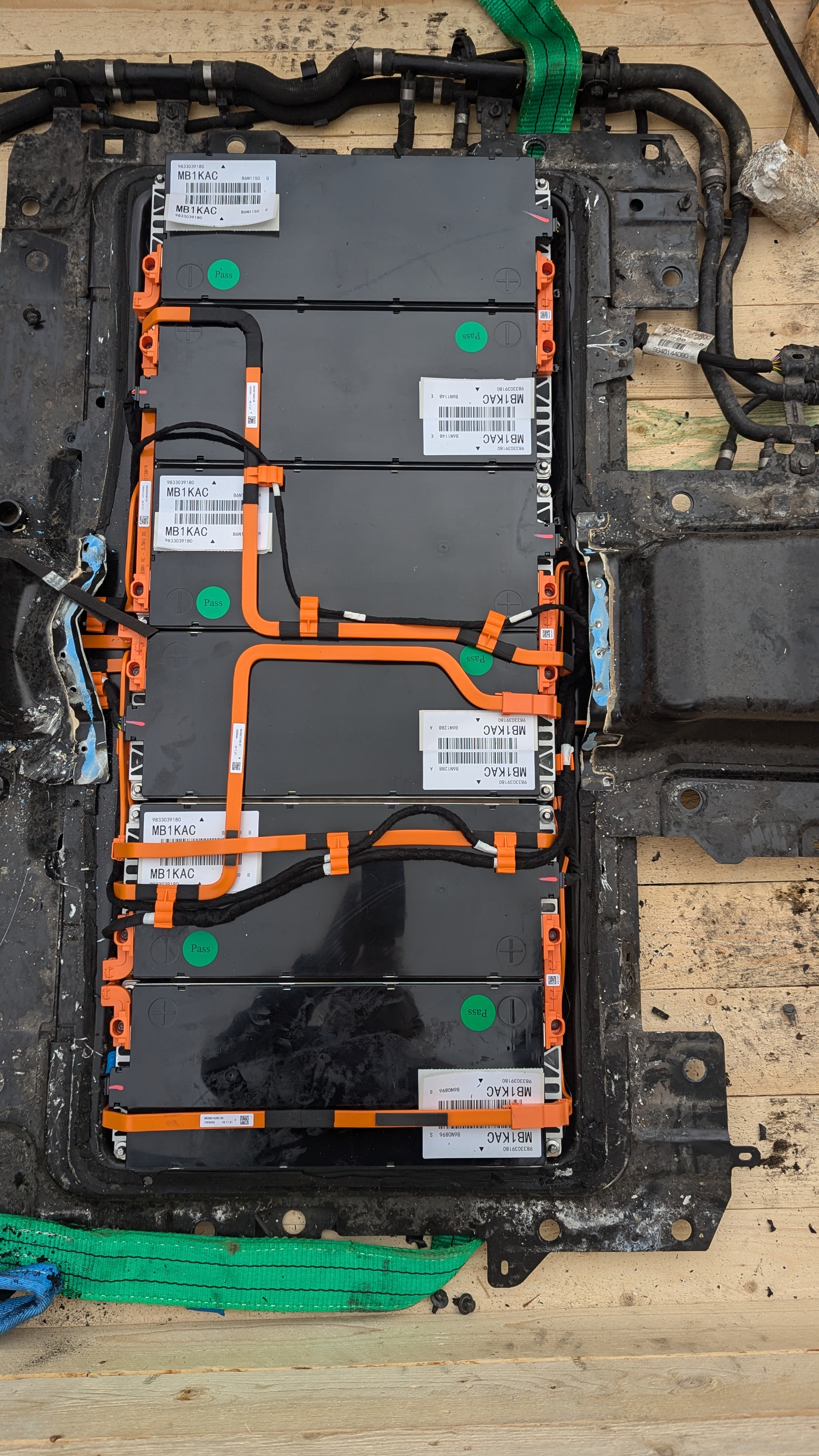

I've chosen to go with the ubiquitous stelantis 50kwh pack. This example came from a Citroen ec4. I picked it up for £1100 delivered. The lid is glued down so its a right pain to open.
Ive started mocking up the rear box, containing 12 of the 18 modules. The rear will also house the HVJB and charger, sitting above the battery.
The box will be raised into the car from the bottom, bolting to the cross beams pictured above.
