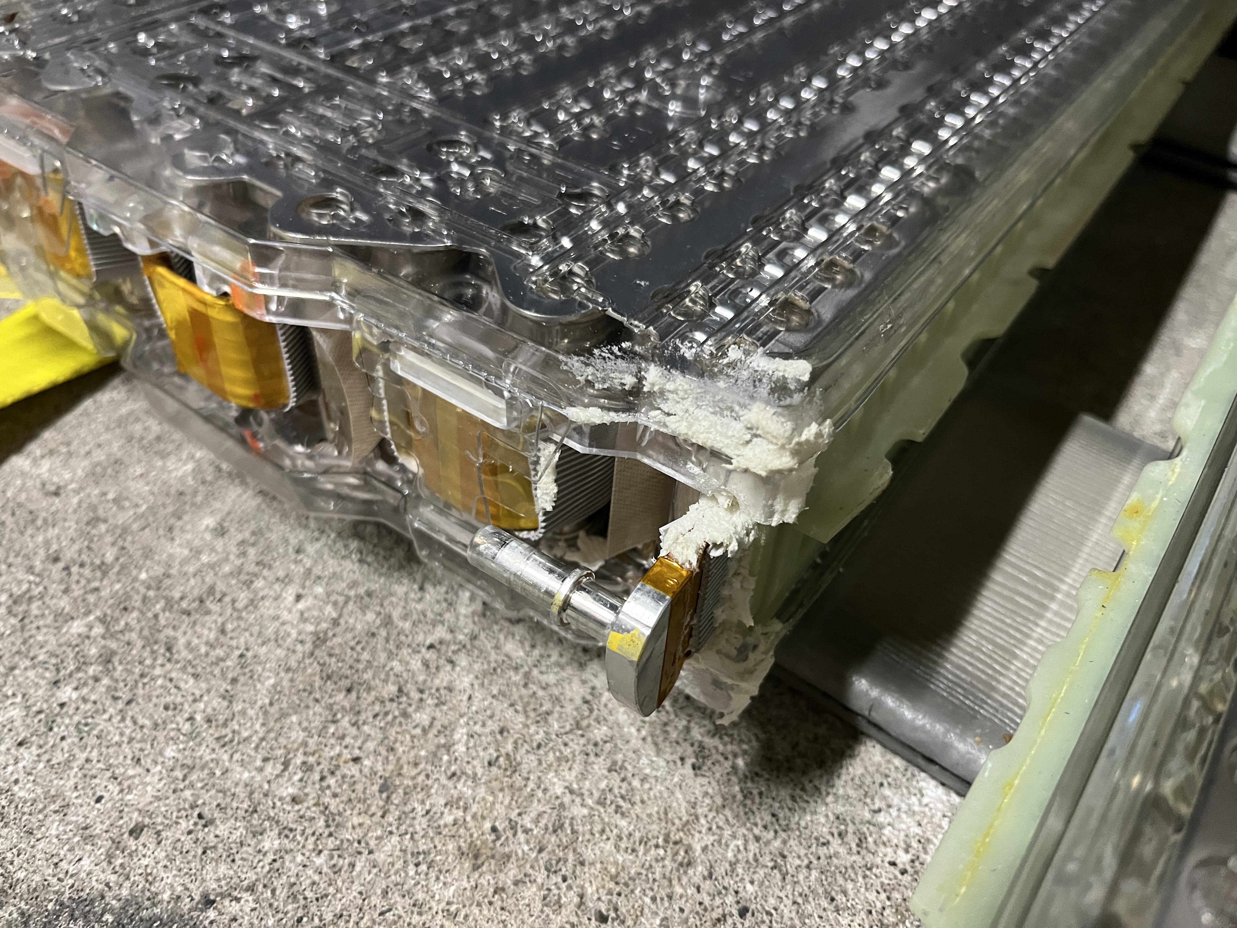

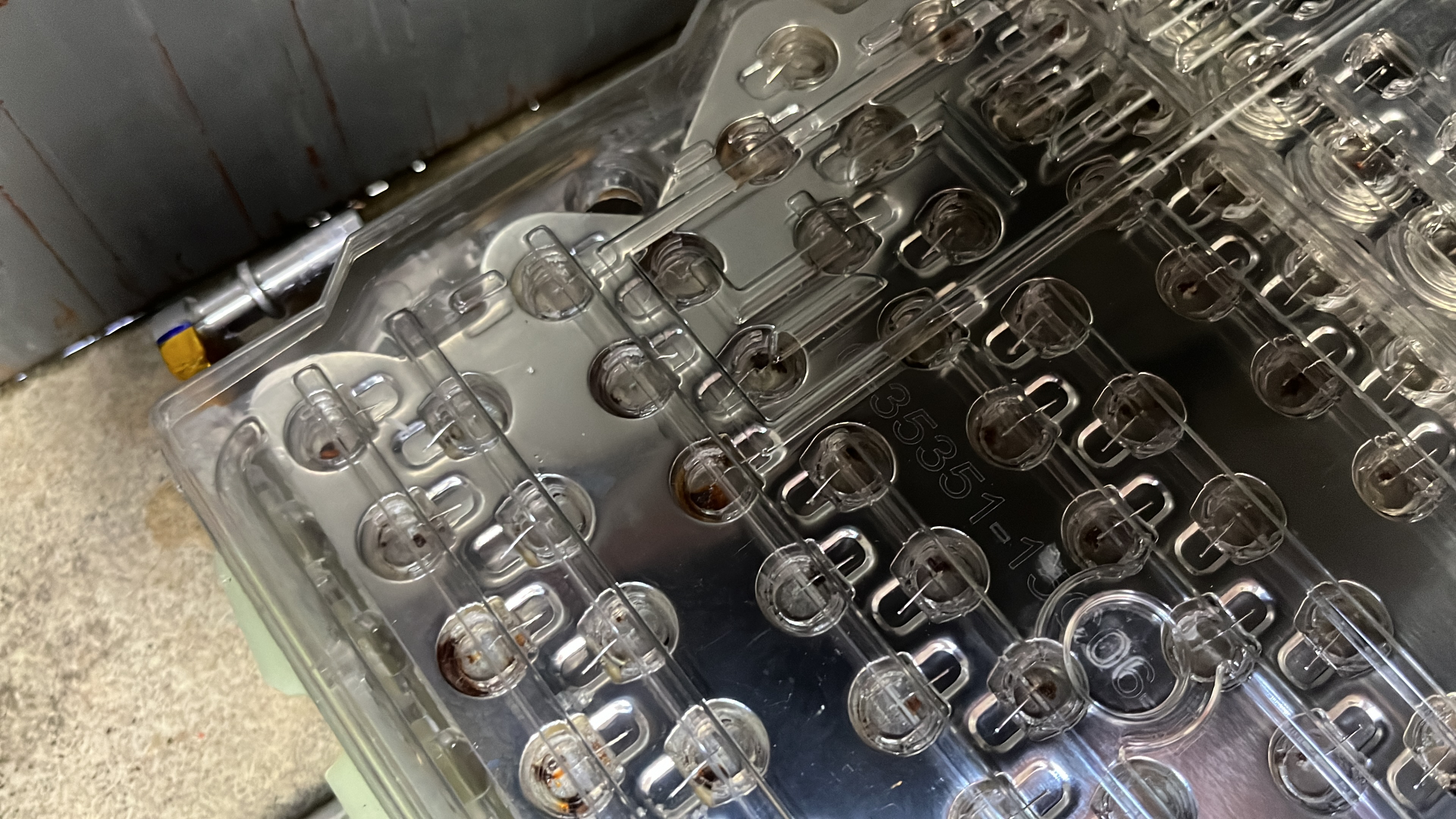

It looks like the pack must have had a small leak at some point that allowed a small amount of water in, which then condensed on the surface of the modules. As a result, most of the modules have some rust on the tops of the cells,....
...and one module has this white stuff on this corner:
Should I be worried from a fire safety perspective?
Is this module more likely to catch fire spontaneously ?
Is there anything I can do to sleep a little better and feel confident that these things wont spontaneously catch fire?

What rust? Can you post more clear pictures?
Are all modules like this, it looks like it might have been a coolant leak. Those modules are not to be used in anything as they might have self discharge going on.

It looks like the white stuff is left over drywall from poking a hole through. It's odd that it looks to be on top of the battery cover. Is it dusty, greasy, silicone like?...
The rust is sketchy. A close-up would help.

jrbe wrote: Sat Jul 13, 2024 6:25 pm It looks like the white stuff is left over drywall from poking a hole through. It's odd that it looks to be on top of the battery cover. Is it dusty, greasy, silicone like?...
Yeah its weird, Its on top of the cover, but also seems to be inside the pack as well on that corner. I couldn't tell if it originated from inside our outside the module. It reminds me of a little of some kind of spray foam insulation from home depo that comes in a spray can that you would use to fill in small gaps and cracks etc. Or maybe some kind of glue..

jrbe wrote: Sat Jul 13, 2024 6:25 pm The rust is sketchy. A close-up would help.
What are you trying to do with these? If you're swapping out rusty cells pull them now.
Do they all look this bad?
So 6/16 seem to be okay (no rust or other oddities).
The other 10 have varying degrees of rust on the tops of about %10 to %30 of the cells.
After reading a few posts about how 18650s can be dangerous if there is corrosion + moisture, I ended up moving those 10 to some boxes on the front yard, as far away from everything else as possible, and started giving them away to anyone local that might want/need one.
