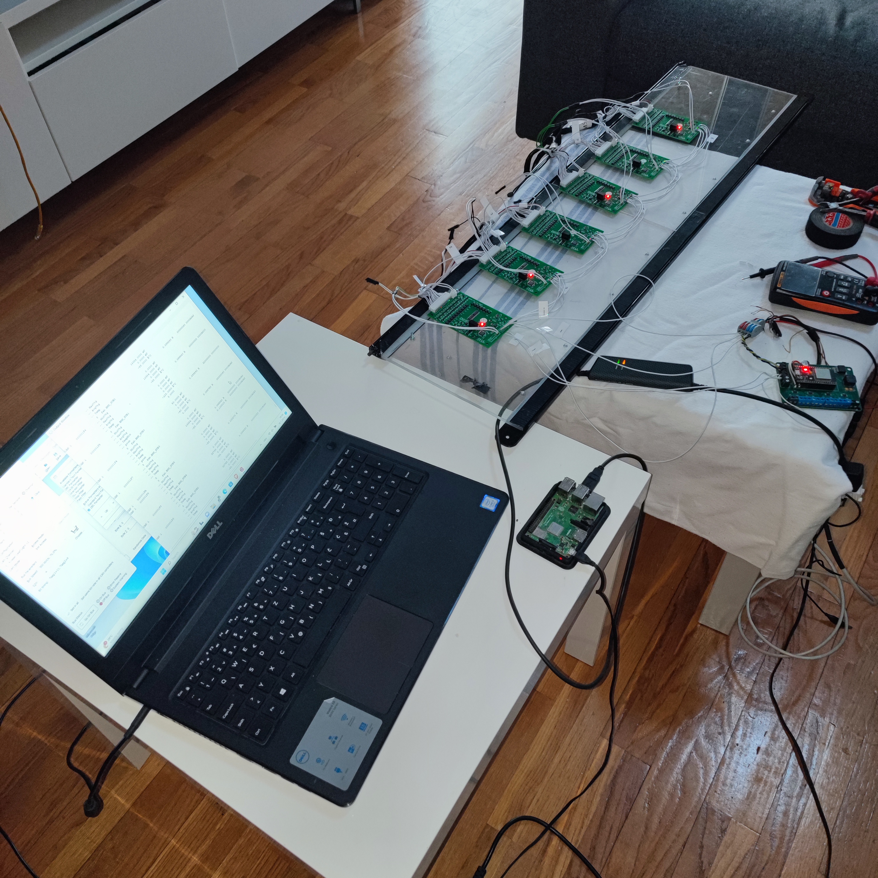

Hello everyone,
I have a 96s battery that I want to monitor and balance using Flying ADC BMS. I'm using 6 boards from OI shop and have them chained together using CAN.
BMS is connected to vehicle CAN in a BMW e39 and because there is BMW DSC message with 0x1F5 id, I would like to change default master pdobase id to 0x1E4 because default BMS address for submodule 1 is 0x1F5.
Problem is that pdobase parameter change on master board is not persisted after changing it with oic write and repowering BMS board.
I'm using RPi5 with SocketCAN and oic tool connected to CAN using Kvaser Leaf Lite HS v2 adapter.
CAN communication is working great.
Here is output of oic scan command:
I'm changing address on nodeId 10 - that should be master board.

Here is result after setting parameter to 1E4
oic -n 10 write pdobase 448
oic -n 10 pdobase
pdobase             : 448 []
And after restart we are back:
pdobase             : 500 []
The BMS units I received from the OI shop were shipped with firmware version 0.16.B pre-installed - thanks @johu.
I would like to do this before connecting BMS to the battery and I appreciate any insights or suggestions you might have.
Thank you in advance for your help!
test setup
test setup

So the write command only writes to RAM! To make it persistent you need to issue
oic -n 10 cmd save
You only need to set it on the first node and it propagates to the sub modules.

Oh...
Now it looks obvious. :)
Everything works like a charm now.
Thank you very much...
