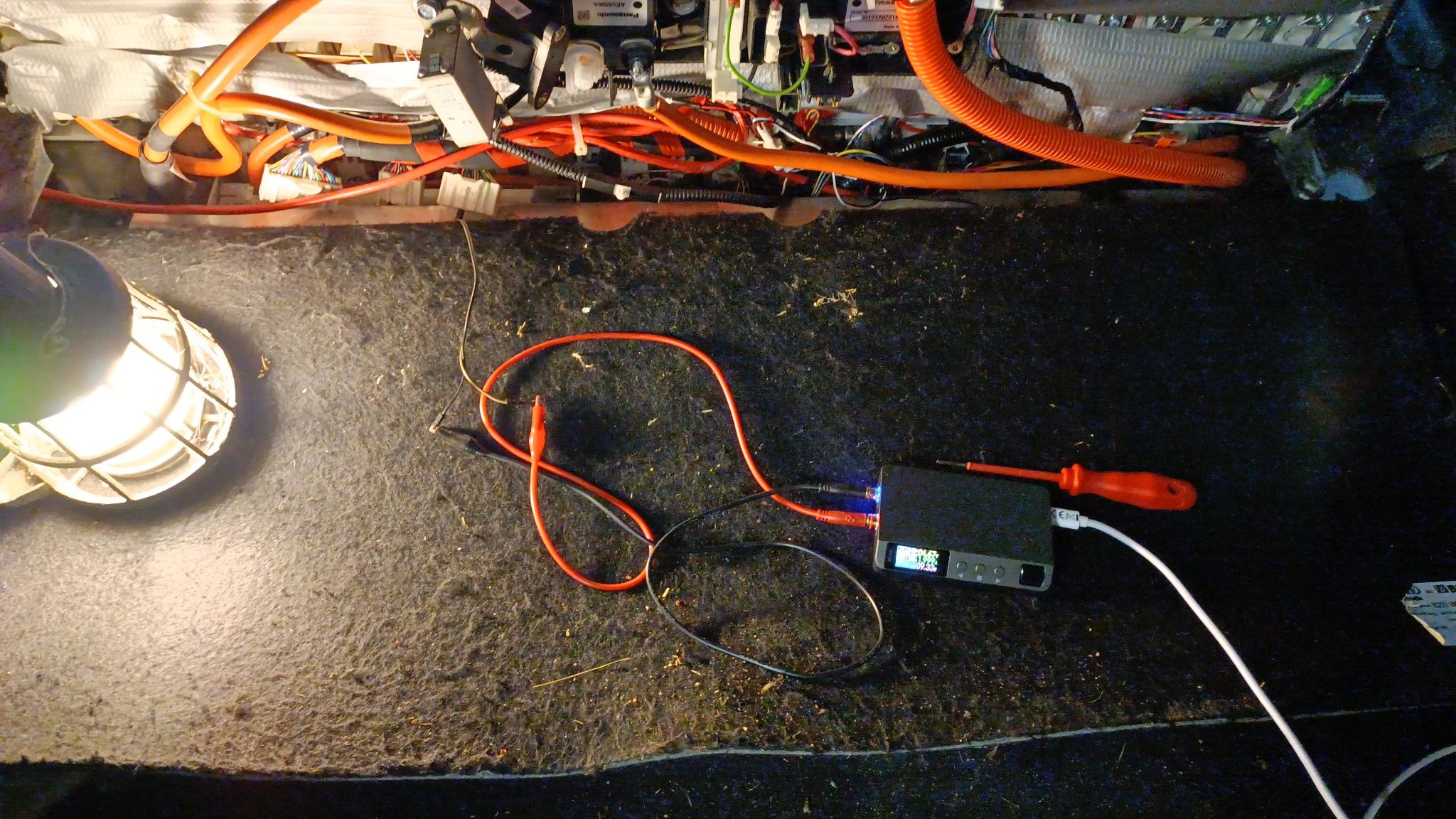

Since I was pretty sure that the CAN connection between VCU and inverter was problematic we recrimped the short 40 cm cable run. I used the car for various shorter trips and it charged and drove normally without dropouts. I did notice though that one cell reached 0% when all the others were still at 40% or something. Bear in mind this was at my dads place, not at home where all the facilities are.
Luckily I had received a tiny USB-C lab supply just before the trip so now I set out to bump up the low cell: It took a whopping 8 hours at 2A to even it out. So 16 Ah missing! I'm not sure whether the BMS had simply decided it wasn't capable to balance this out or if the very first Nissan BMS is just not very well thought out.

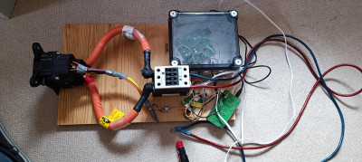

I then re-purposed my old CCS-to-CHAdeMO adapter as an on the fly CCS charge port that I connected directly behind the main contactors. The trip back was 400 km. The range from full is 100 km if you push it. I had some stuff to do at Kaiserslautern (50 km) during which I put 2.5 kWh back (that is like 25 km!). I visited two friends in Mannheim another 130 km into the trip where I recharged to almost full.

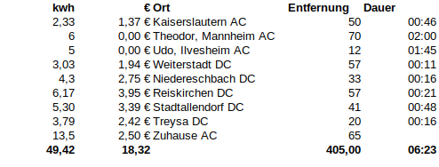

Only after 190 km did I need the first DC charge, which apart from the low speed went well. See for yourself how the rest went:
So I spent 4:30 hours on AC charging while doing other things and 1:52 DC charging. This is dominated by the second-to-last charge stop that kept failing on me and I had to restart like 10x. This happened on various chargers at that location so I somehow reckon it was something with the vehicle.
