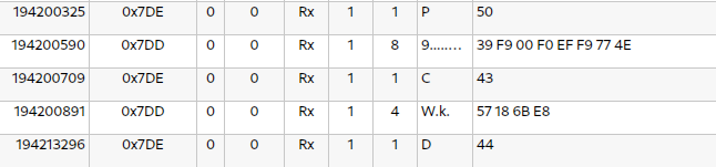

The STM32 bootloader enables the independent watchdog and the firmware is expected to feed that at least once a second or so. If it fails to do so, the STM32 is reset.
This is used to recover from a failed update. If a firmware is just partially flashed it is usually not runnable and won't feed the dog. The STM32 ends up in a reset loop where the boot loader asks for an update like every 2s. The works fine with the update over uart (both python script and ESP), it also works with the CAN python script but it doesn't work with the ESP32 CAN.
Now I simulated the situation by pulling down the STMs reset pin, starting an update and then releasing the pin. Everything looks good:
The boot loader sends it 0x33 hello message with serial number, the ESP32 reflects the serial number, the STM asks for size (S), the ESP replies with 0x8C or 140 pages, the STM asks for the first page (P) and then the ESP32 successfully transmits 1024 bytes.
It becomes dodgy afterwards: The last 8 bytes are requested (P) and transmitted, the CRC is requested (C) and transmitted but then instead of requesting the next page with "P" the boot loader reports update finished "D". Consequently the ESP also goes into done state.
This is the code snippet in question: Decrement remaining number of pages and if we reached 0 go to done state. So it seems like numPages is set to 1 instead of 140.

Found it! It's indeed a timing issue:
The CAN messages come in so fast that "if (state == PAGECOUNT || state == PAGE)" hasn't been reached. Instead we are in state CRC, the entire block is skipped and we proceed straight to sending "D".
Ok, will do something about it in the boot loader but also in the ESP for backward compatibility

Easy fix. Just included the PROGRAM state in the if
The PROGRAM state can only be left by the actual programming routine, so that is now safe. Now just have to worry about a backward compatibility hack.
if (state == PAGECOUNT || state == PAGE || state == PROGRAM)

Added a sub version number. The new version now advertises '3', '1' instead of '3', '0'. When '0' is advertised the ESP will insert an additional delay before sending the page count.
