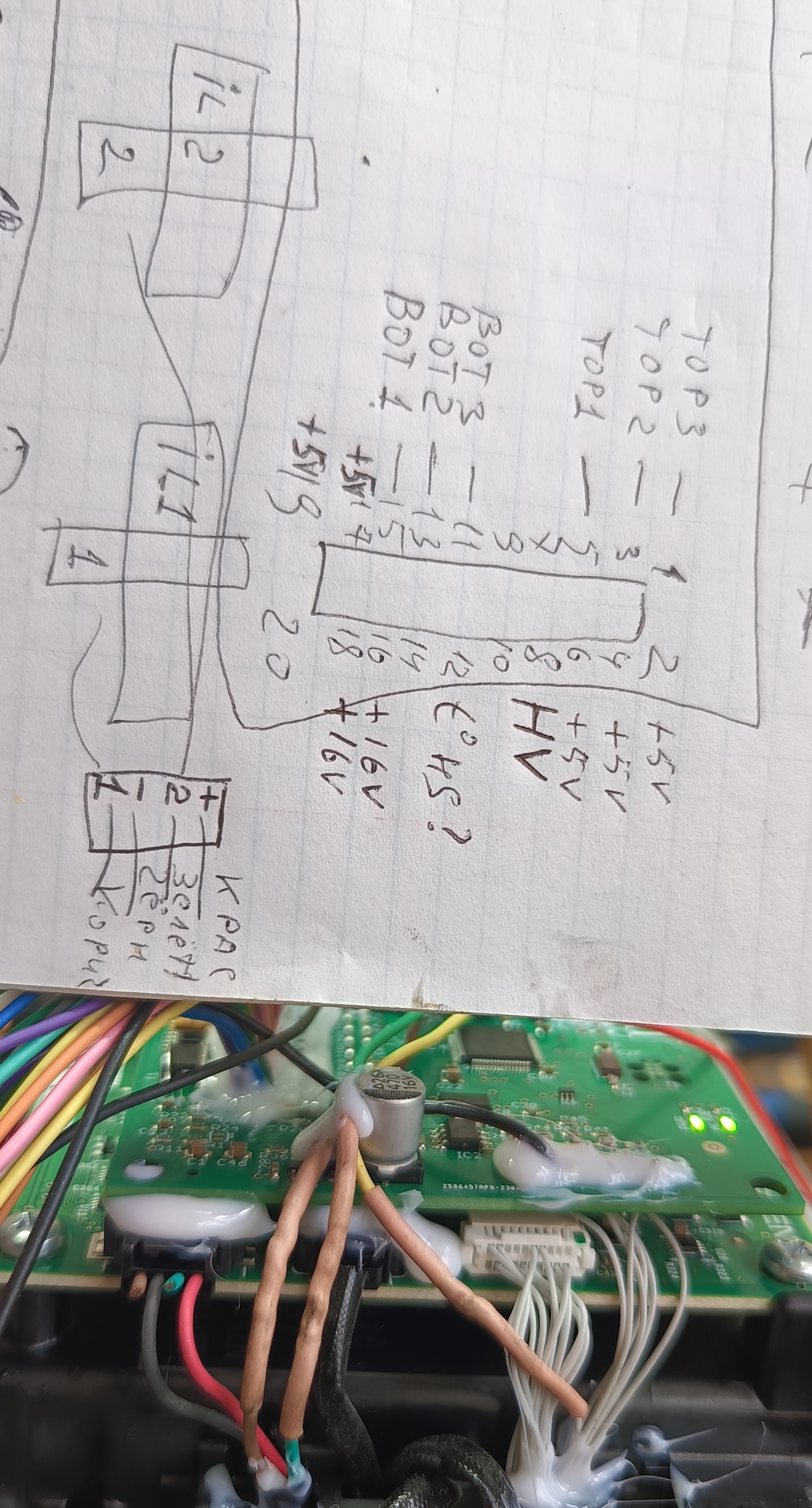

Romale wrote: Sun Aug 04, 2024 8:10 pm For example, I control these inverters only with OI v3 johu boards and in my opinion this is the best solution!
How does that work? So you use the small board V3 with its I/O interface as VCU directly wired INSIDE inverter casing?
Or do you build your own VCU case? Some photos please.

8-)

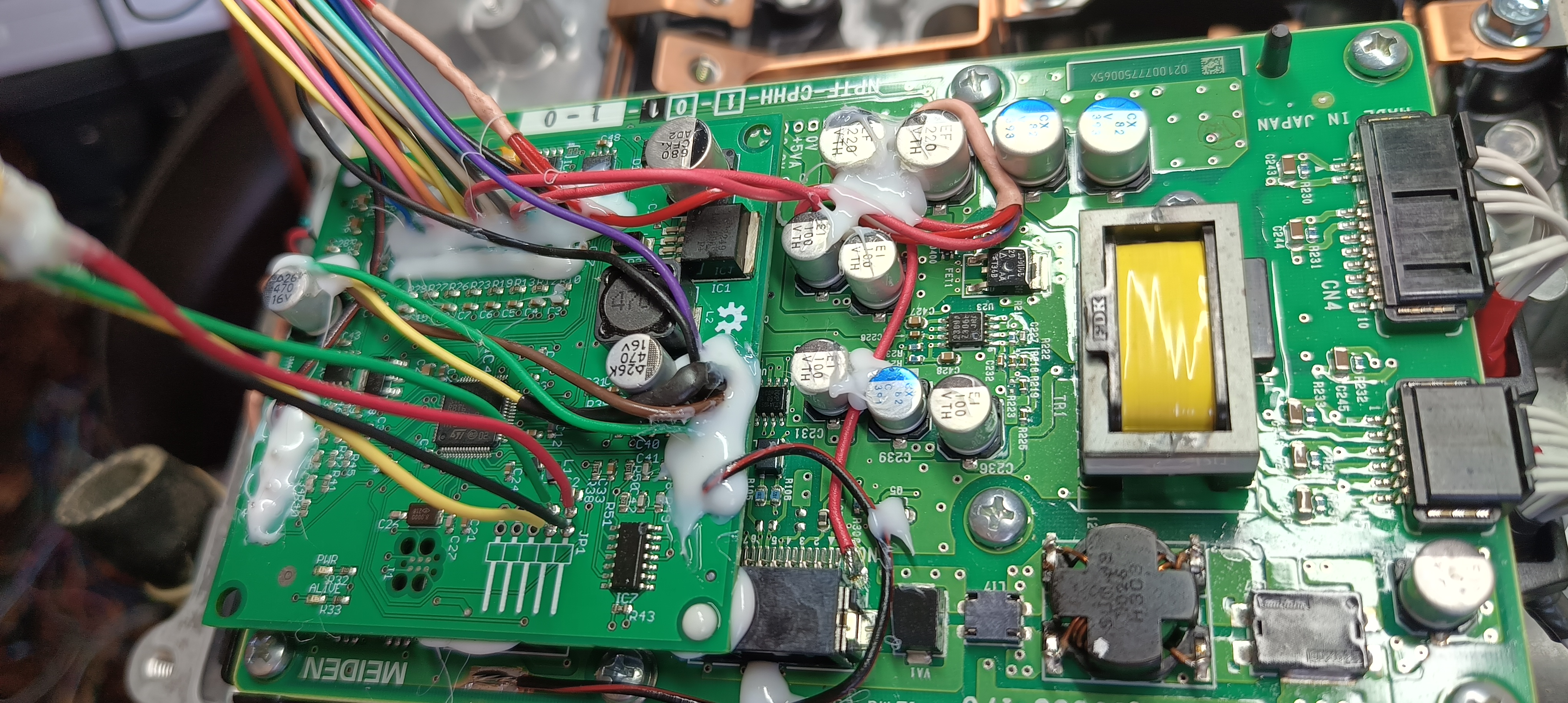

pay attention to the 0.1 uf condenser mounted on the shutter and the GND . this gives a delay in switching on the contactor and it OVERCAME the problem of arbitrarily turning on the contactor for a fraction of a second when 12 volts are supplied.

Romale wrote: Mon Aug 05, 2024 12:23 pm IMG20240805150512.jpgIMG20240805150533.jpgIMG20240805150548.jpgIMG20240805150624.jpg
Oh... you need to load those photos as attachments.
Otherwise good point i was annoyed by relay chatter myself and i simply had to pull 12V for running contactors from a different source.
edit: Maybe you can post link to your webpage? It is just my curiosity as i was thinking of using the STM chip for a simple VCU and i see V3 has everything there already.

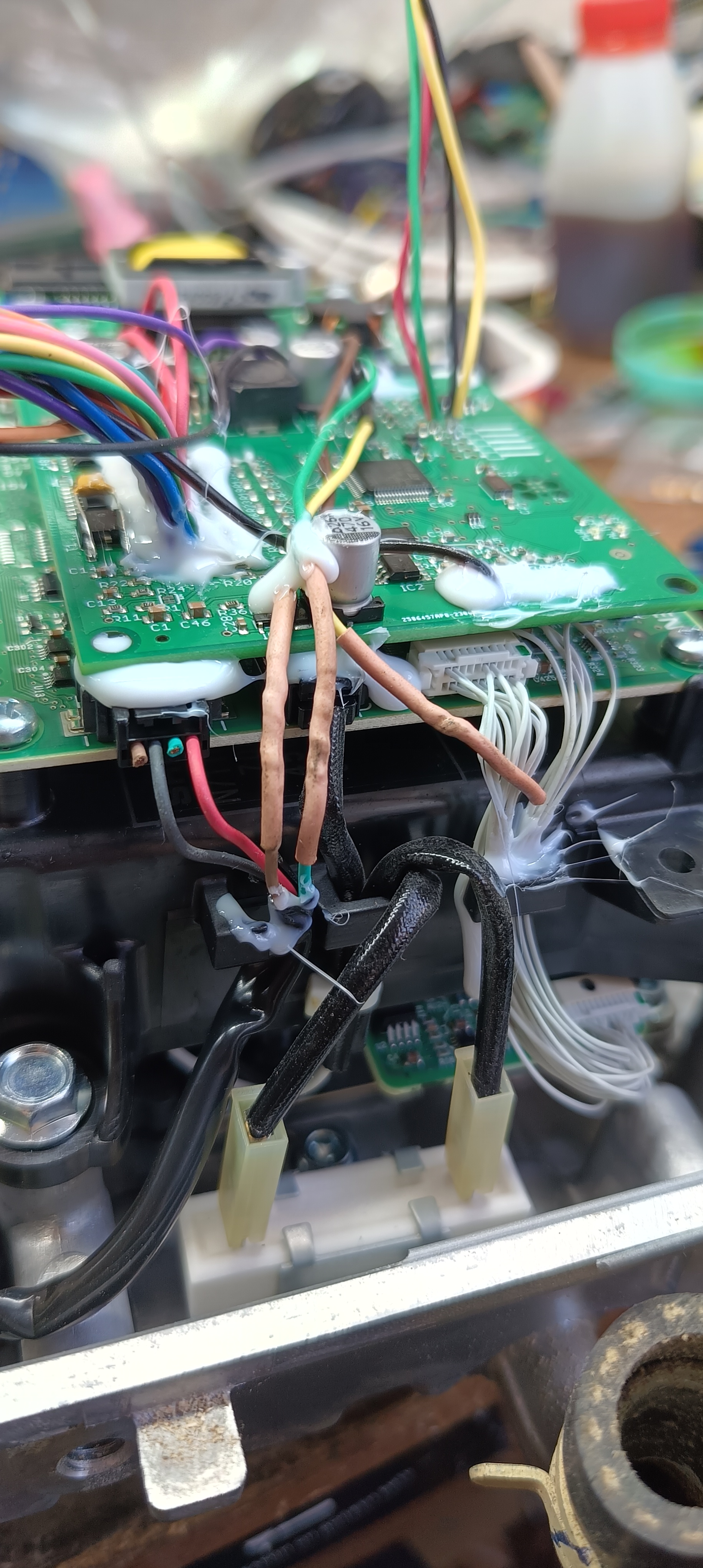

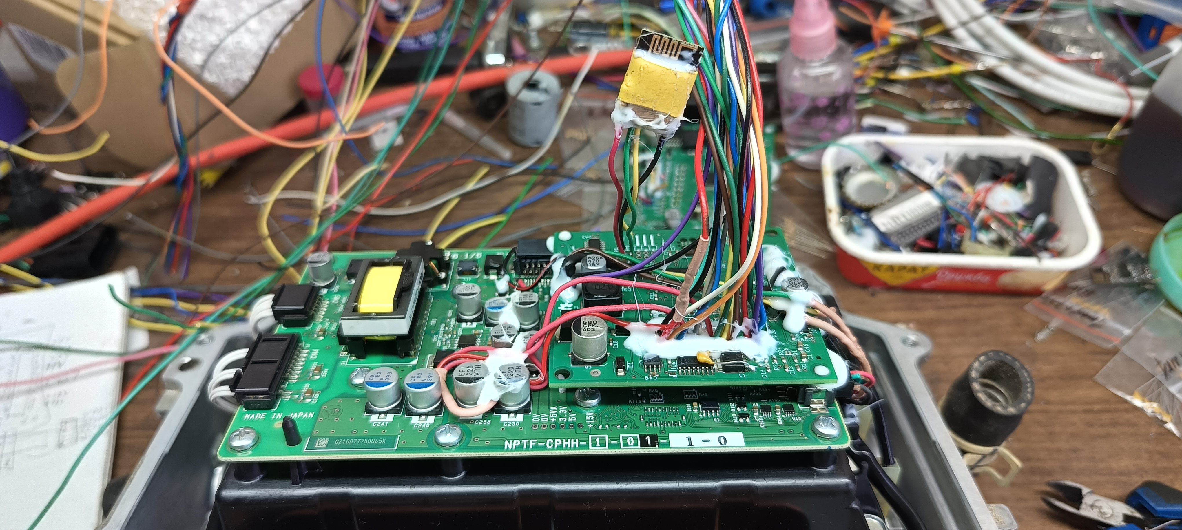

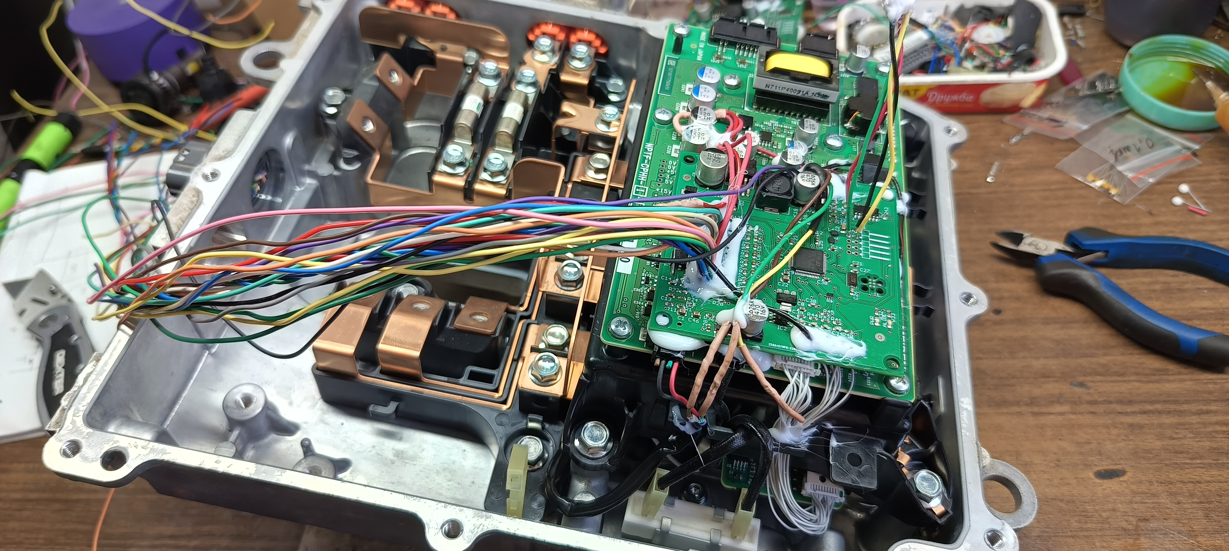

Romale wrote: Mon Aug 05, 2024 12:32 pm IMG20240805150624.jpg
Ok, now you surprised me.
So you are using OI V3 board as control brain? Do you have a wiring how to connect to Outlander power section on the inside?
EDIT: This would mean you can get 100kW from the motor for sure!!!

arber333 wrote: Mon Aug 05, 2024 12:35 pm Ok, now you surprised me.
tnx
Even more! I have recorded 127 kW on the wattmeter!

Romale wrote: Mon Aug 05, 2024 12:40 pm Even more! I have recorded 127 kW on the wattmeter!
WoW really nice! So that white connector is drivers...
Some questions:
1. are the transistor signals positive or open collector?
2. Do you use transistor fault signal for anything?
3. Do you use resolver with OI or do you leave it connected to outlander control board?
4. How is HV signal read? Is it 5V analog signal or do you require any special signal?
tnx for data
Romale
Posts: 530
Location: Romania
Has thanked: 313 times
Been thanked: 81 times
Post by Romale »
1) The control signal is negative
2) no, I have not found how to use desat
3) I connect the resolver to the johu board
4) high voltage is one wire, it can be seen in the photo (connected to the yellow wire) and it is signed by me on the diagram.

Romale wrote: Mon Aug 05, 2024 1:01 pm 1) The control signal is negative
Hi just want to clarify point (2)... As I'm aware we can get confused when we all try to write in our non native language...
You have either:
(a) not found any signal yet that goes high/low during desat and your essentially running the inverter blind (from a desat point of view).
(B) The drivers self shutdown on a de sat occurance.
Romale
Posts: 530
Location: Romania
Post by Romale »
item "a".
evil neodymium :twisted:
