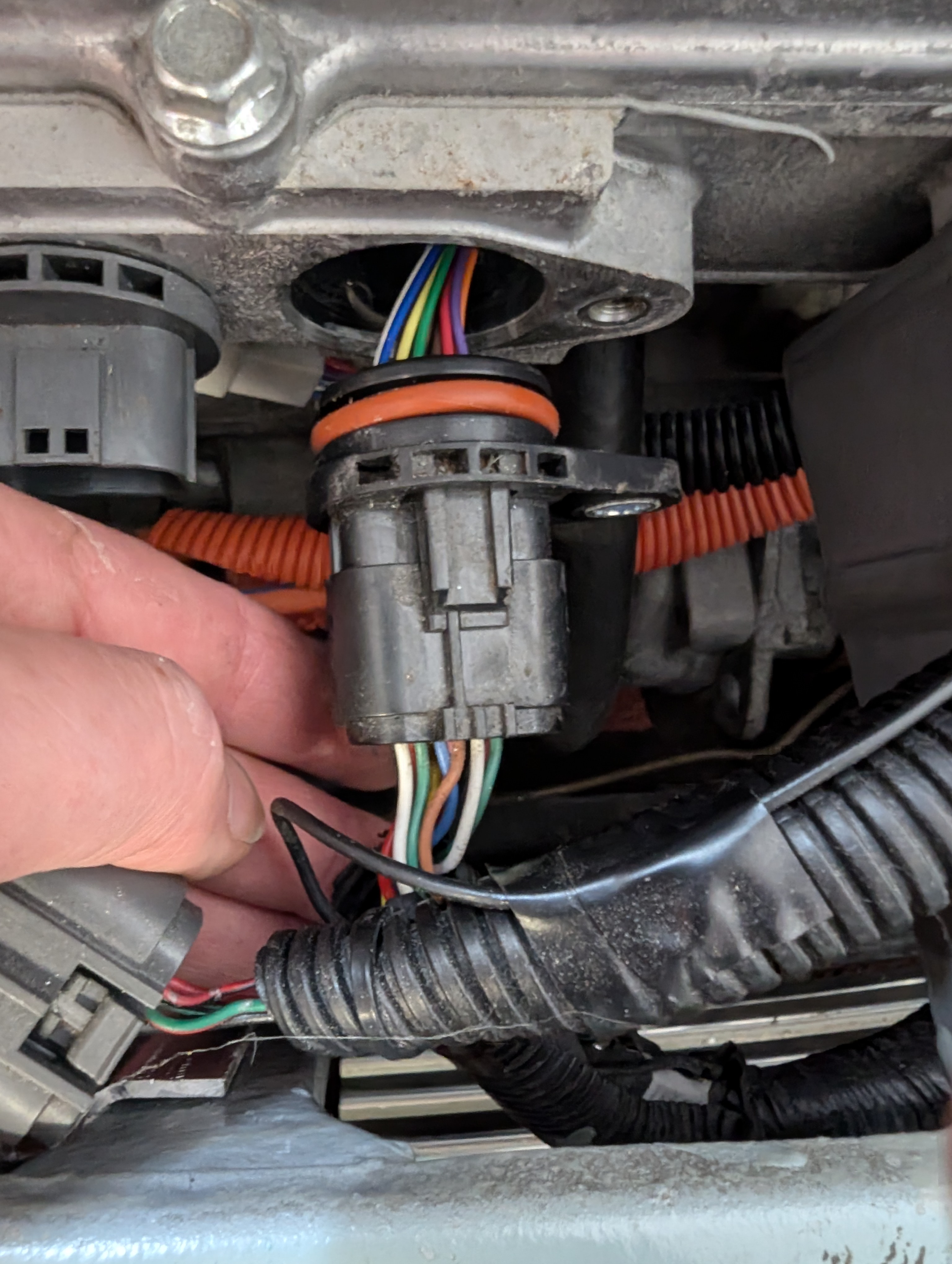

I have Rear Inverter with the socket missing does any one know the wires i should use
Can Bus and low voltage I have the following wire colours green,black,white,grey,violet,blue,yellow,brown,orange?
needed to connect it to ZombieVerter

Thanks it only shows the wire on the external car loom lead. I need the pinout from the pcb inside the inverter header with these coloured wires

Re: Rear Inverter with the socket missing
Here is the power and CAN connector from my inverter:
Outlander Rear Inverter
Images of the power and resolver connectors which may be of use..
Pin Number Loom Side` Inverter Side Payload
6 GREEN/RED Black CAN L
5 RED/BLACK Green CAN H
12 LG/B Yellow RSDN
4 BLACK White GND
13 RED Blue IGN POWER
I wired it up and its working fine, but the is no 120ohm termination in the inverter?
