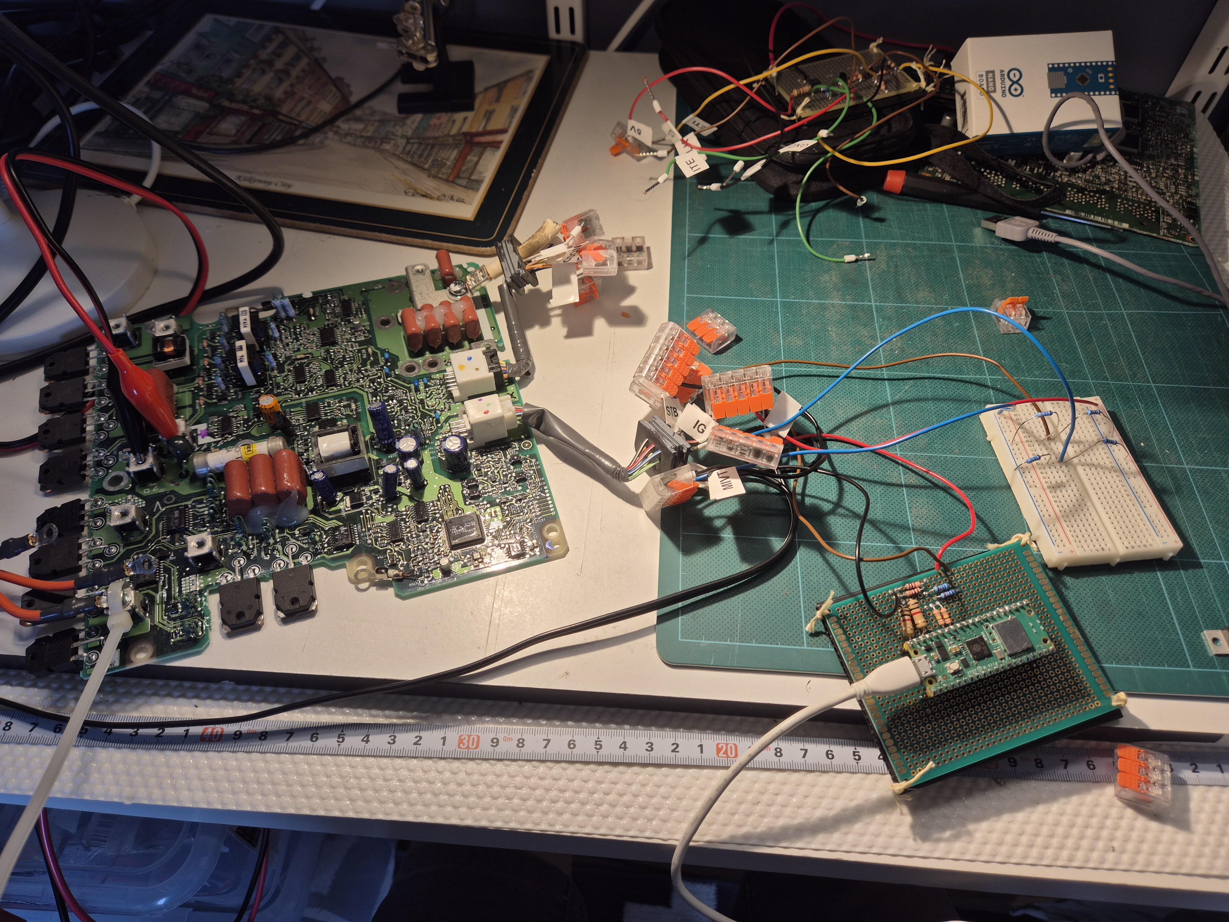

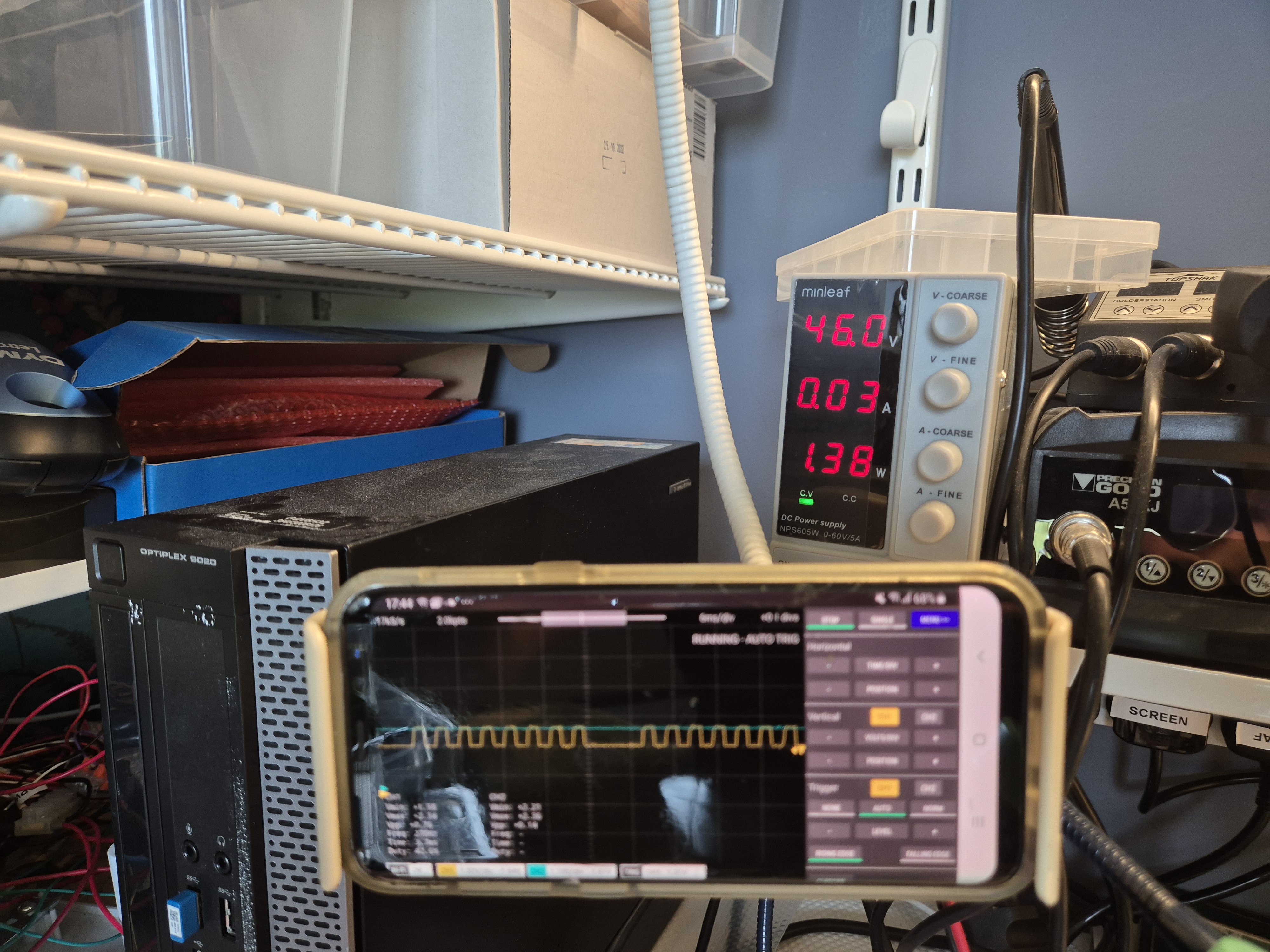

Finally managed to capture logs of the A/C turning on for real.
I did this using my 5V logical analyzer with a CD4504B voltage level shifter.
There was some noise, which I filtered out.
Now, I'm trying to figure out the CRC and send back ETI messages using an Arduino Nano.
Sigrok files attached.
Videos how I captured
CD4504B pin connections

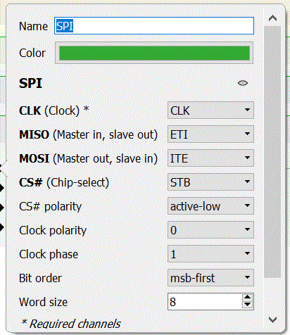

Decoder settings
ac on for real video2 20250201 edited MISO ETI.txt
(3.32 KiB) Downloaded 508 times
ac on for real with tis video 20250201 edited.zip
(13.44 KiB) Downloaded 510 times

turnip73 wrote: Sat Feb 08, 2025 6:16 pmVideos how I captured
What in the unholy Cthulhu hell of Mom's Spaghetti...
I noped right out of trying to understand it, and skipped right forward to appreciating whatever it is that was done.

Success! It Works! 🎉
We can now control the Gen2 A/C compressor inverter! 🚗💨
🔗 Arduino code & logs: GitHub Repository
Also, I figured out the CRC codes using ChatGPT:
Byte 5 = (B1 ≪ 1) ⊕ B2 ⊕ B3 ⊕ B4
📌 Next Steps
1️⃣ Create a wiring diagram in KiCad.
2️⃣ Decode the log: AC on for real - video
- Update the Arduino code to send continuous messages instead of replaying recorded log messages.
- This will allow full control of the inverter.
3️⃣ Update the Wiki with the latest findings.
4️⃣ Start testing with different inverter versions & car models to ensure compatibility.
