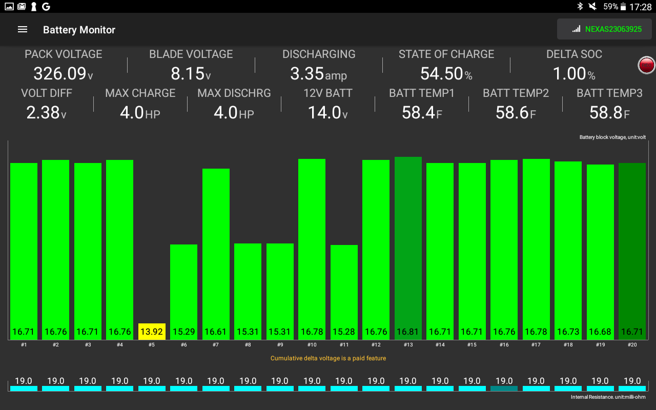

I stumbled upon an old 450h with around 375 000km on it.
Got it for cheap as it has (according to the fault codes) a defective aux oil pump of transmission and a single cell block failure of the NiMh battery.
The car is driveable, but goes into some safety shutdown every now and then.
I was planning on trying to replace the battery with Li-ion and include a charger.
Also, it would be great if one could drive 80km/h speed in EV-mode.
Here is a picture from Dr. Prius app. Cell block #5 is weak.
I also took some data logs in the hopes of spotting that lower voltage cell block as a starting point of the can hacking.
I think I need to play back that recording to the OBD Bluetooth dongle and take out messages one by on. This way I'll hopefully see what messages are used by the app (battery data).
Or does somebody already have the 450h battery CAN messages hacked?

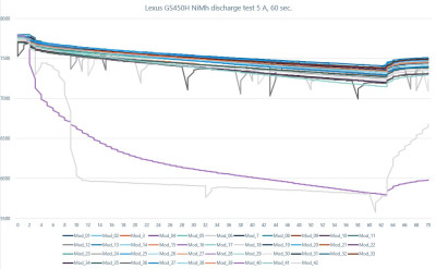

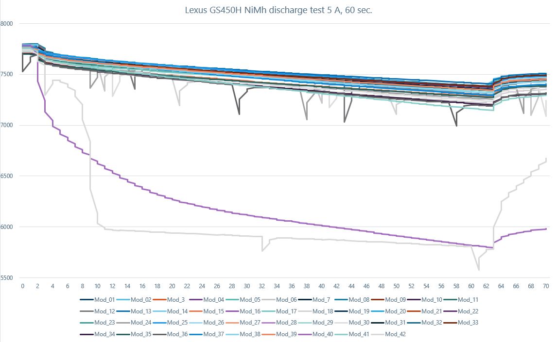

Been slowly repairing the car every now and then.
When making a loading test with an electronic load, the NiMh battery turned out having 7 defective modules out of the total of 40. I managed to get some (9pcs) replacements and redid the test. I balanced all modules (over night) to the same voltage first and then made a load test. Here you can see the combined result of all remaining original modules (33pcs) and the replacements (9pcs). Two of the replacements are bad, but luckily I had 40pcs "relatively" equal quality modules, i.e. just enough for the full pack. The odd looking spikes are induced by my DIY measurement setup. Next item to fix was the transmission oil pump. The most common failure in these is seized bearings, so I dismantled the unit only to find out that the bearings where not that bad. Replaces the bearings anyway, but the pump was still not working. Apparently the problem is in the rotor position sensors. All HAL sensor lines are sitting at 5V all the time. Might try to repair the internal PCB at a later time, but at this point I purchased a replacement pump and finally got the pump related DTC erased. After this, there was still the issue of fixing the rear brake lines that where rotten through and leaking brake fluid.
After all of this, I finally got working car and actually passed the MOT today.
I feel like I've been working on the car for quite along time already. Now I finally have a working car that I can start reverse engineering.
